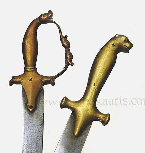

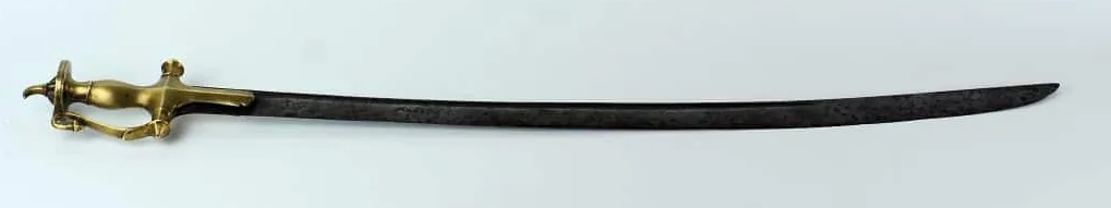

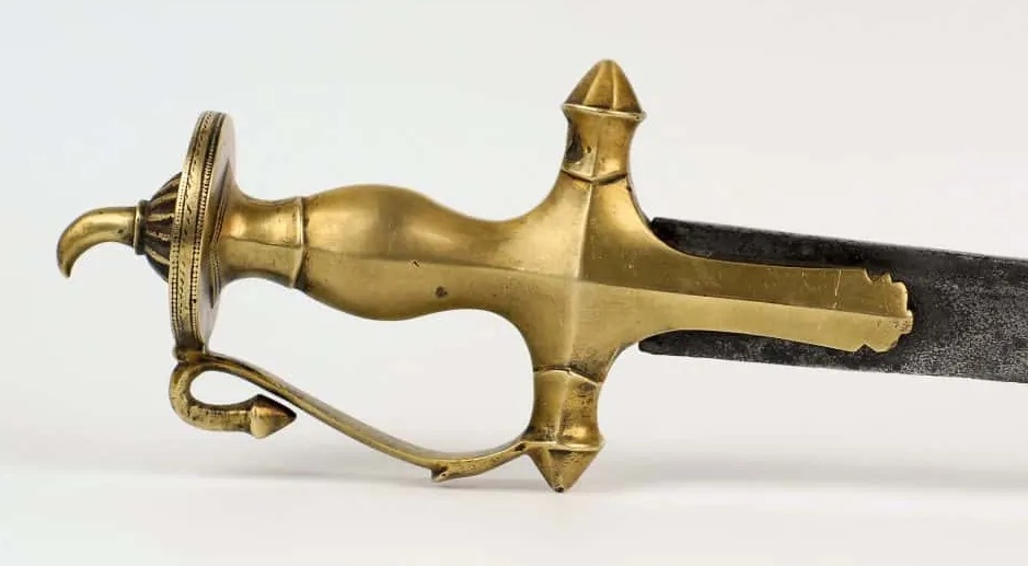

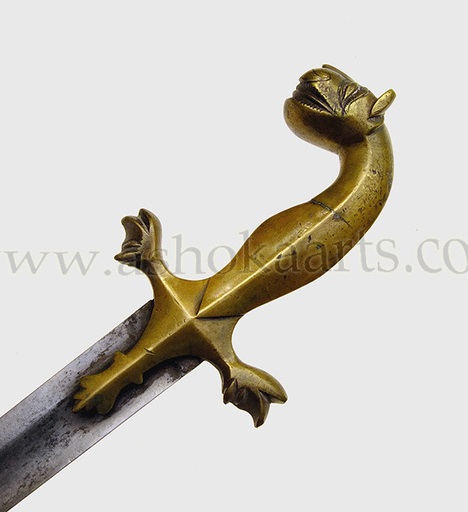

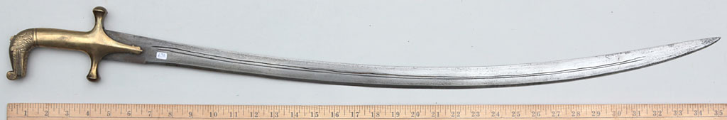

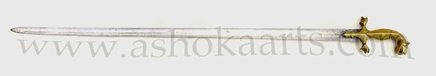

Yes, many European swords have brass hilts.
Thanks for the link and I found another one here
http://www.vikingsword.com/lew/w0167/w0167.html
It seems that these brass hilted swords come from Southern India, Malabar, Mysore... But I don't think it's always the case.
