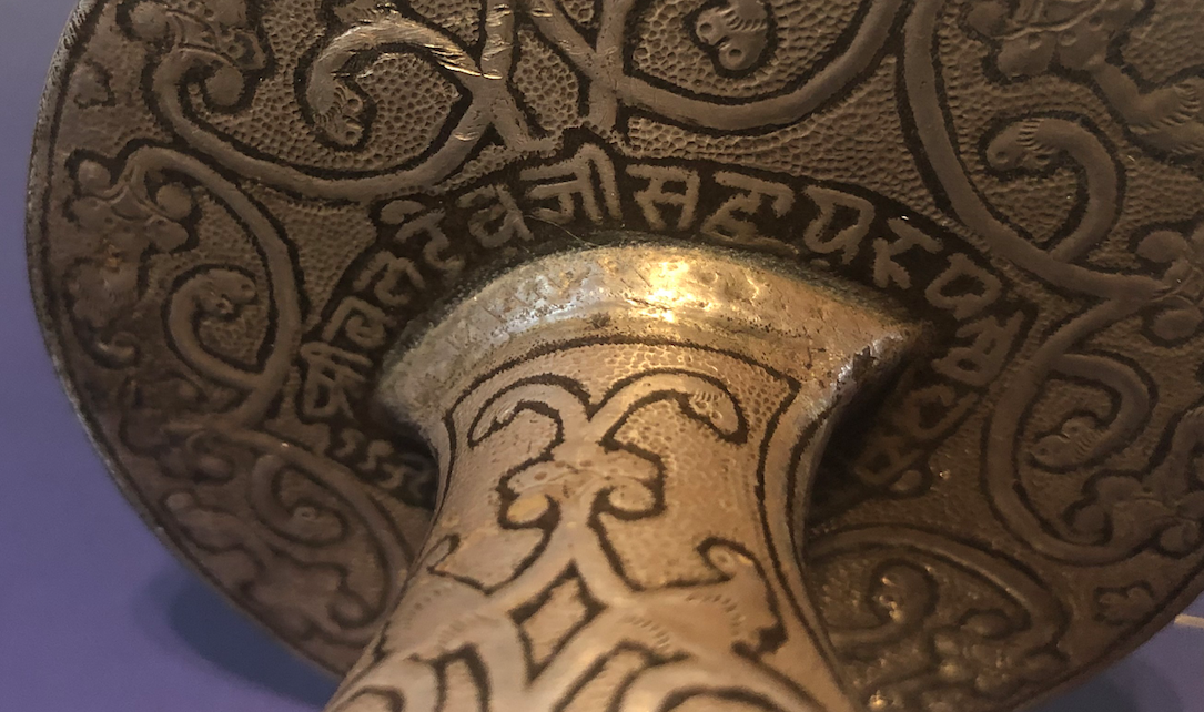

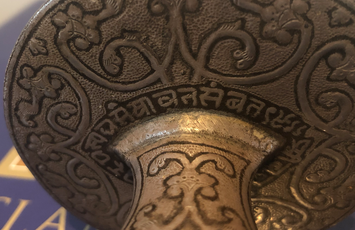

hello forum members.
I need your assistance in deciphering this inscription, which I believe is devanagari. I have picked out a few words such as 'sri baldev ji sahai' and 'samvat'.
Is anyone able to assist with this? much appreciated! images are attached. there seems to be some date at the end? especially since 'samvat' is written before it...

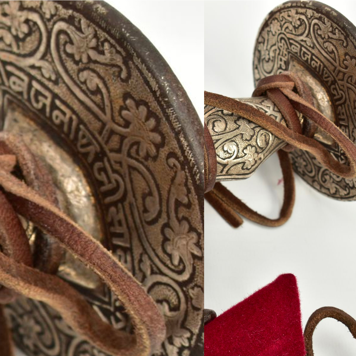

I can't help you with the translation however i've spotted a tulwar with identical koftgari work and similar characters, perhaps it could help you with translation?
Sorry i can't be of more use.

A friend in India has helped with translating the text.
Shri Baldevji Sahay Rup Singh Sangawat Samb(v)at 1911.
Shri Baldevji is the Deva to whom obseience is paid. Rup Singh is obviously the ownern of the piece who belongs to the Sangawat Rajput clan. Samvat is V.S. the Northern Hindu year.
The year looks crudely done (maybe a local variant of numerals) VS 1911 So this is around 1855 AD.
I have a tulwar from Alwar/Ulwar with a closely related text dated VS 1856 - 1799-1800 AD.
thats fantastic Jen! Might you know who Rup Singh Sangawat is? I also noticed 'sri baldevji sahay' is on a shield at the V&A which belonged to ram singh of kotah. So maybe its 'region'/rajput specific?

In the case of the "owner's inscription" exactly in this place of hilt I only trust in such a sword of raja and an inscription (attached). I am talking about swords of 19th - 20th, when, apparently, such a fashion appeared. In Gold we trust.
