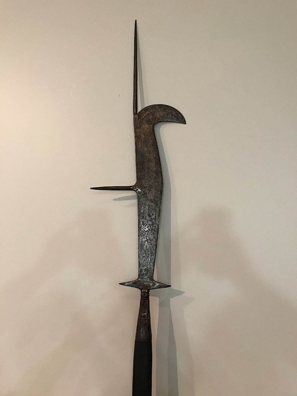

I am trying to find more information on the lance in the attached photo. It was reportedly acquired via de-accession from the Metropolitan Museum of Art in 1972 and it is pictured in George Cameron Stone’s “A Glossary of the Construction, Decoration and Use of Arms and Armor“ on page 500. (I misplaced my book and ordered a new copy.). It was reportedly from Stone’s collection.
Does anyone have any information, particularly photos of other examples, that even remotely resemble this type? I have never seen the side-mounted blades before.
It will likely be several weeks before the lance is in my possession.

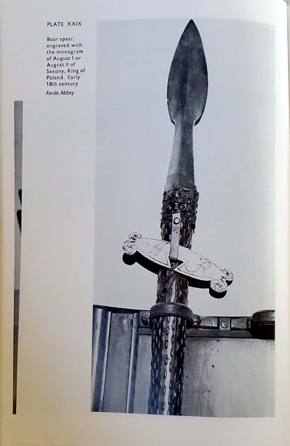

Well, I got to my 'Stone' finally and had been barking up the wrong tree entirely as Stone (p.500) shows this among 'pikes', which have nothing to do with lances or Polish hussars. These are of course infantry weapons, but do have basic similarities to many lances of course in that it is a pointed spear head attached to a haft or pole, usually using the langets extending down to attach with screws.
I have not seen those side 'wings' nor the curious hooks on the shaft on anything, and I have gone through every weapons and arms & armor reference I can think of. While lances were indeed used in Eastern Europe long after they had fallen out of use in the west, the Polish hussar lances were hollowed fir halves glued together a ball type vamplate mid shaft, looking mostly like medieval tilting lances.
There is the possibility this is a boar hunting spear, which often have 'wings' to prevent the prey from coming up the shaft, though these elongated side 'blades' seem contrary to the extended wings typically seen.
Whatever it is, it is certainly 'one of a kind' and having something of Stone's, one of the pillars of arms & armor scholarship, is outstanding!!!

Thanks for looking into it!
The Kopia is the hollowed lance with the ball, and I’m not convinced this is the remains of one. From what brief reading I’ve done, there were likely shorter, solid spears used in second wave attacks (infantry). Kopia were also single-use items, and this appears to have too much effort out into it to be disposable.
The hooks are too far down to be for overpenetration.
I should get some better info when it arrives.
Jim, your suggestion is food for thought but this weapon does not fit the functional criteria exhibited by every boar spear that I have seen in person or in the literature. The head on this example is much less substantial than the norm, keeping in mind that a boar spear is designed to deal with a thick-skinned animal with a low center of gravity, consisting of several hundred pounds of muscle and bad temper that power a set of tusks that will disembowel any man, horse, or dog that gets close enough. The long blades on either side of the shaft don't do much good because the spear head, properly designed, is what does the job. The wool tassels are superfluous. A simple cross-piece (either forged integral with the socket as common in southern Europe, or a piece of antler or iron lashed or riveted to the shaft below the head in the German lands) suffices as a limit to excessive penetration.
Here are two "classic" examples of boar spear of a style common to the German-speaking countries, with antler-tip crosspieces lashed on with rawhide. The leaf-shaped blade on the left is a variation encountered in other northern and eastern European countries as well.

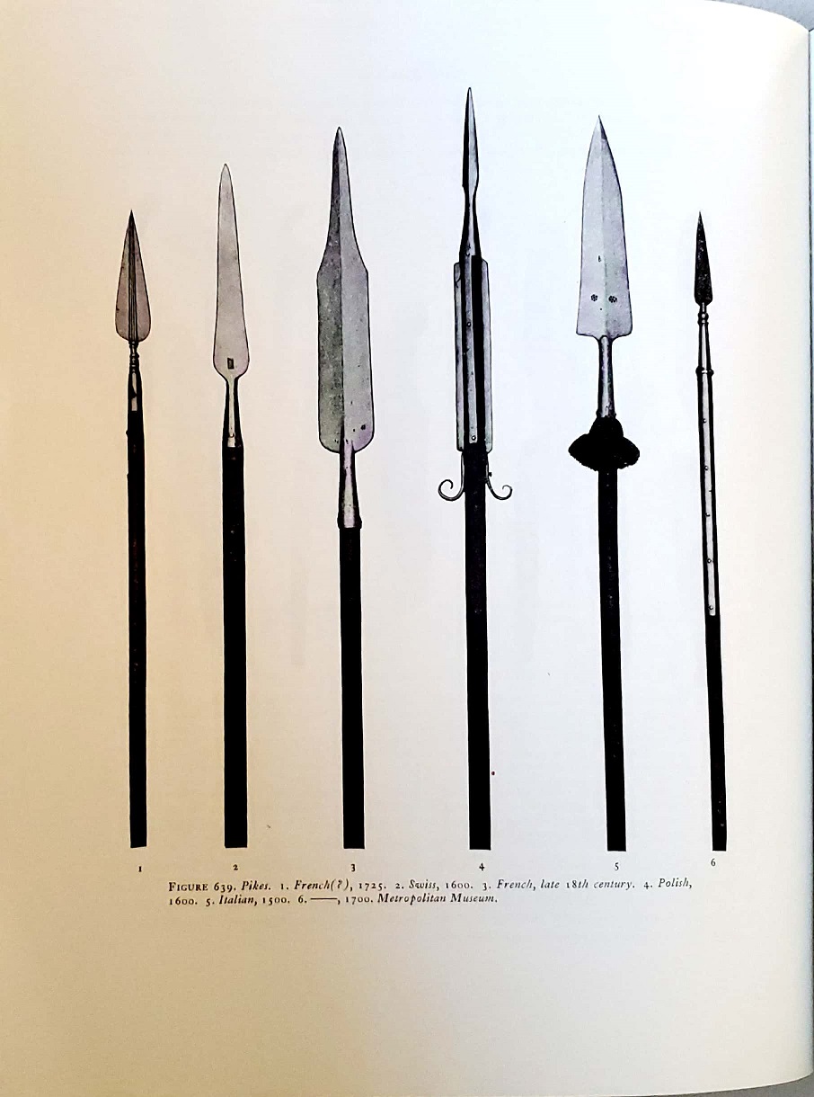

Good idea Phiilip, we need more detail on the character, dimensions etc. before speculating further.

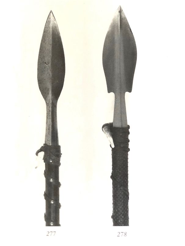

For reference, here is p.500 out of Stone (1934) with the item in grouping of pikes.
The other is a boar spear from a JAAS article just to establish the character of many of these.
Thanks for the picture!
I will certainly be checking to see if those hooks are actually connected by metal to the side blades. Wouldn’t THAT be an interesting development... with the hooks, blades, langets, and head all being forged together as one piece. I’d be stunned if that’s the case.

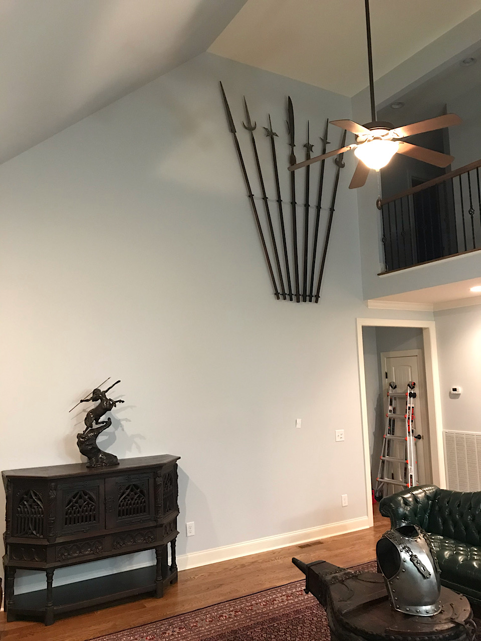

I’m very excited for this to arrive. I am currently hanging polearms in my new house and will have to rearrange the order around this item.

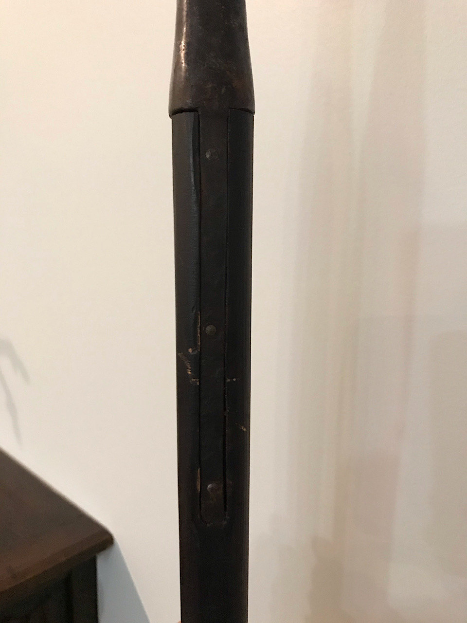

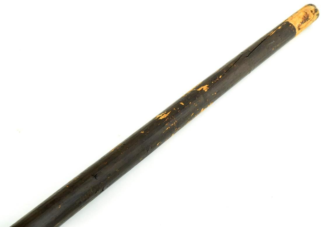

Attached pic is the non-business end, and is presumed to be shortened as the whole thing is only 90 inches.
The cracks are interesting, as is the undetermined treatment to the butt.
If this is a hollow shaft, it will certainly answer some questions.
Thanks! We're looking to more detail once you have it in hand.
Hollow or solid? Diameter? Type of wood? (as you say, the cracks are interesting, might be related to grain structure and hence the species of timber...)
Butt end does look shortened. 90 in. is short for either a cavalry lance or an infantry pike, but not unreasonable for some other type of spear or spontoon. But who knows how long the shaft was originally? Tell us something about how it balances in your hands and that might be instructive as well.

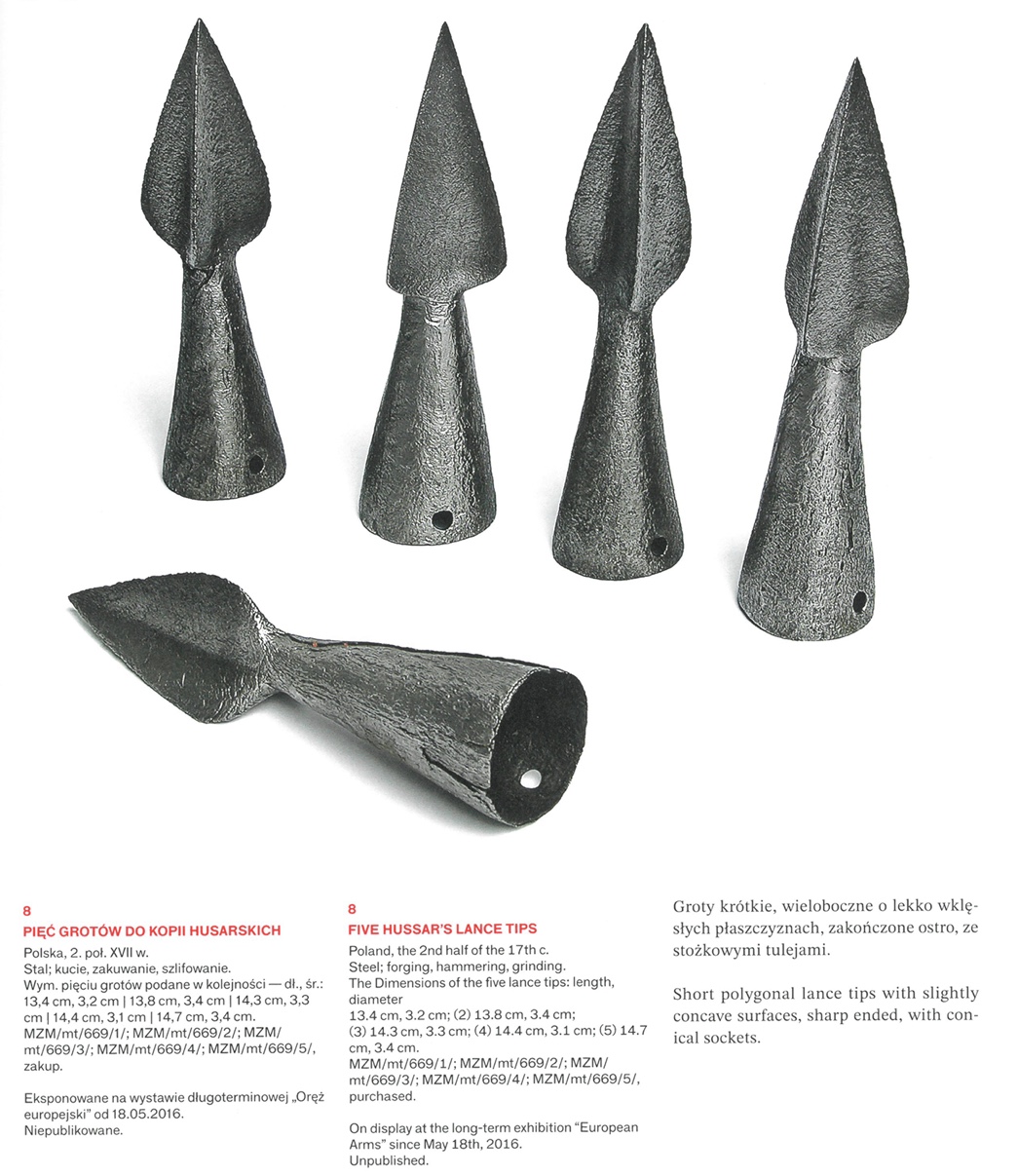

I found this snippet from a book. These examples of Kopia heads certainly back up the “disposable” idea. My spear is different in every possible way, except that it’s pointy.

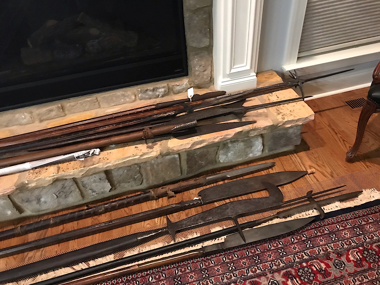

Old 11th November 2020, 04:38 AM   #24
BUCC_Guy
BUCC_Guy's Avatar
Join Date: Jun 2019
Location: Tennessee, USA
Posts: 52

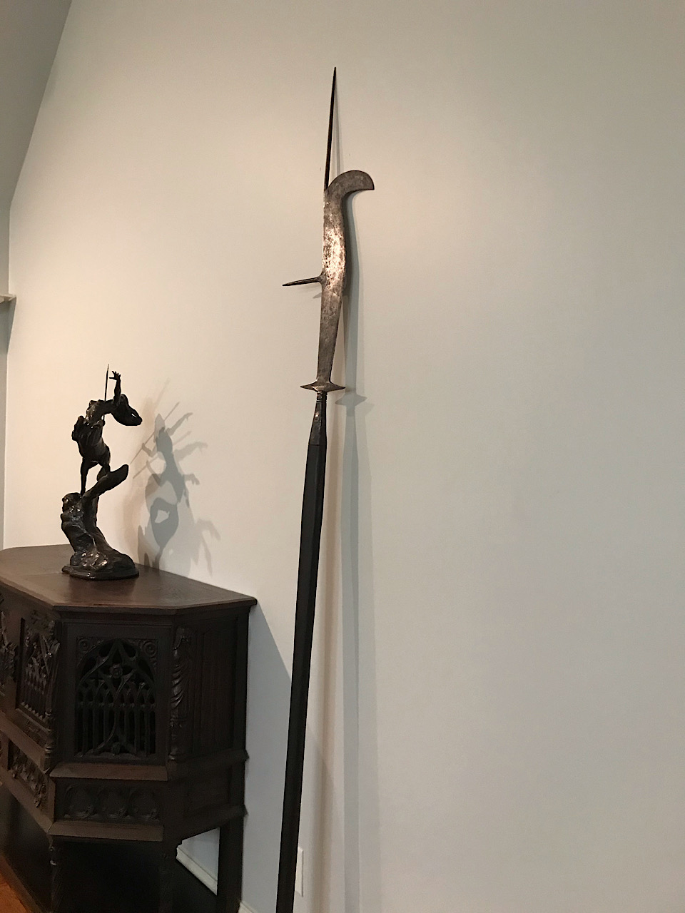

Originally Posted by Philip
Wow, please post it after it's fully unwrapped and you have had a chance to brandish and have some fun with it. I am a fan of these too; in general I try to stay away from polearms (mainly because I don't have high enough ceilings in my house!), but these are awfully tempting, as are spetums and corsesche a pipistrello.
I’ve attached some pics. I’m not sure what order they will attach in, but I have an overview of the roncone, a closeup up the blade, a view of the original langets (partial, I assume), the benefits of high ceilings, and the rest of the children waiting to be attached to the wall. Should have 18 total, I think.
I like to arrange them with similar heads opposite each other, so I’ll likely put the Polish pike on the end, opposite the large boar spear, and have the roncone opposite the large Glaive.
This was another reason I was excited to get the pike in this thread. It is going to balance out the display with my other spear, I hope!
I lost a corseque at auction this weekend, which would have matched my 15th century Italian lance. Sad, but I have to keep money in reserve for a large painting this weekend.
I need a decent corseque and spetum. I’m always looking for a traditional pollaxe, but at $8-12k, that’s a... commitment. I just bought this new house so my play money is disappearing quickly.
BUCC_Guy is offline   Reply With Quote
Old 11th November 2020, 08:51 PM   #25
Philip
Philip's Avatar
Location: California
Posts: 1,036
Default bellissimo!
Thanks for posting your new treasure, it really deserves a thread all its own, hopefully we can have other members chime in regarding the development of the bill in other European countries besides Italy, with examples of same from their own collections!
Your roncone is indeed a wonderful example of the genre, its form quite nicely preserved, without visible damage, repairs, or alteration. The extremely long dorsal spike is a nice feature. Let's see it after you clean it up, (should look spectacular!) and get a dedicated discussion thread going.

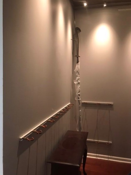

Old 11th November 2020, 10:31 PM   #26
Victrix
Victrix's Avatar
Join Date: Apr 2017
Posts: 767

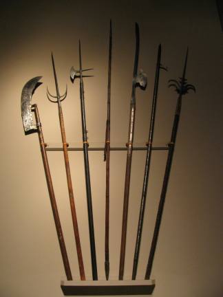

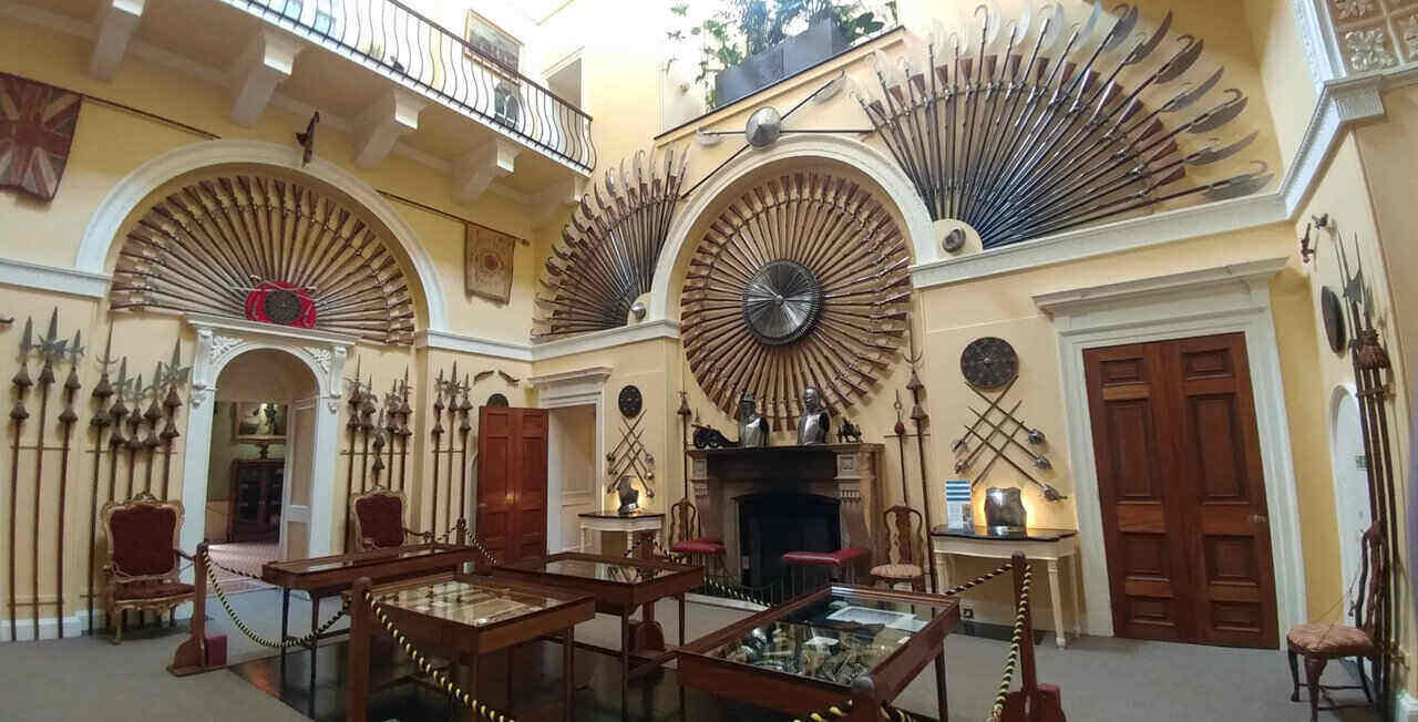

Excellent wall display! Congratulations. Looks really great. Here is a picture from Inverary Castle in Scotland for inspiration.
Old 12th November 2020, 04:40 AM   #27
BUCC_Guy
BUCC_Guy's Avatar
Join Date: Jun 2019
Posts: 52
I started a thread on it before it even arrived. I just bumped it with more closeup pictures.
Old 12th November 2020, 04:46 AM   #28
BUCC_Guy
BUCC_Guy's Avatar
Join Date: Jun 2019
Posts: 52
The castles make me depressed, because I will never have enough for the repetitive displays of 40 of the same item. I really like the fans and circles made up of muskets and polearms. I’d love 8 swords crossed like they have, but, money wise, I’m likely targeting just two to three swords in the future.
I used the Higgins Armory (now closed) as an example for my display. I would have done a full half-circle if my ceiling wasn’t slanted.
I have more to hang, and I’ll make a thread about my hanging system, which I’m very happy with.
Old 12th November 2020, 10:35 AM   #29
Victrix
Victrix's Avatar
Join Date: Apr 2017
Posts: 767
I think the Victorian collections bordered on the obsessive. No need to overdo it but it can generate display ideas. You will be surprised how much you accumulate and it already seems you have quite a bit. Luckily you have plenty space.
I decided to only display in one personal room in my flat (cozy office/TV room) for consideration to my wife, and so as not to alarm visitors in Sweden which is appallingly PC. My collection is ever increasing and my wife presented an ultimatum: either you don’t buy more stuff or we need a bigger home. But I acquire more items by stealth and then ask her to wrap and give it to me for Christmas and birthdays. The problem is where to hide a 2.7m long halberd for 6 months...
Old 12th November 2020, 10:32 PM   #30
CSinTX
CSinTX's Avatar
Join Date: Apr 2014
Posts: 235
Display looks great! Showed it to the wife and she gave the seal of approval. Love the bellow coffee table too!
