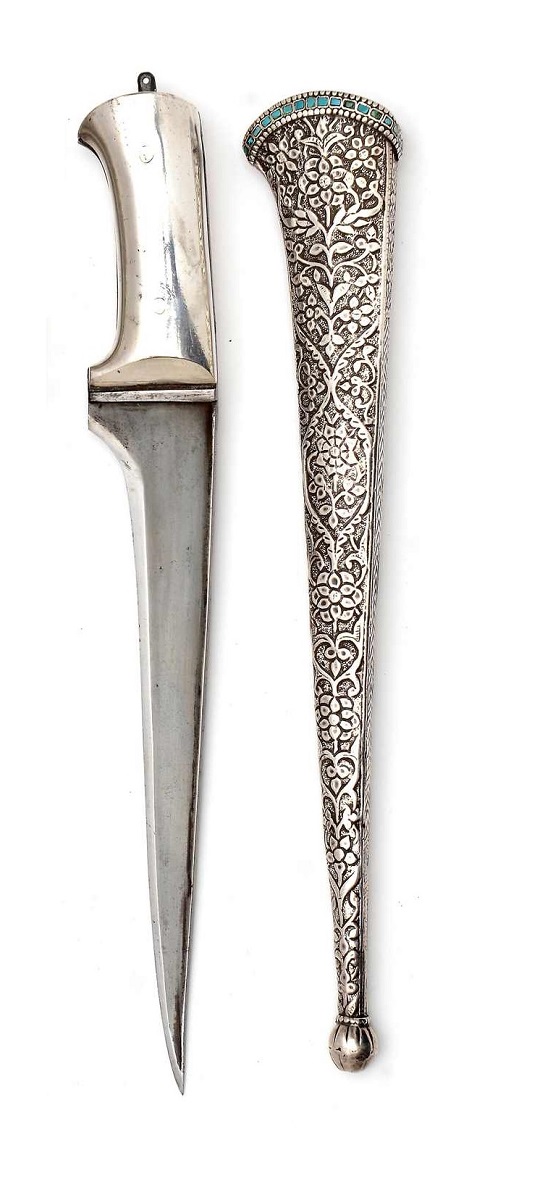

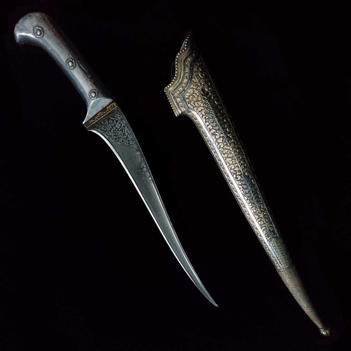

I have been looking for years for a high quality persian style peshkabz and finally I was able to acquire one (two actually), although it took a kamikaze-like approach to get them.
The blade is very typically persian, with a ladder pattern and nice chiseling, 18th century I would assume, but the dress is not what we usually see.
The grip scales are hollow and made from silver and the scabbard is heavy silver with wood lining and elaborate chasing, gilding and niello with three niello inscriptions.
The auctioneer listed the provenance as Dagestan, which I don't believe is plausible, I tend to think either central Asia or simply Iran.
The cartouches are two makers' marks and what I assume to be the owner's name.
I am very interested in what you all think, and if you can again help me with my flailing attempts to translate (I know you are around kwiatek )

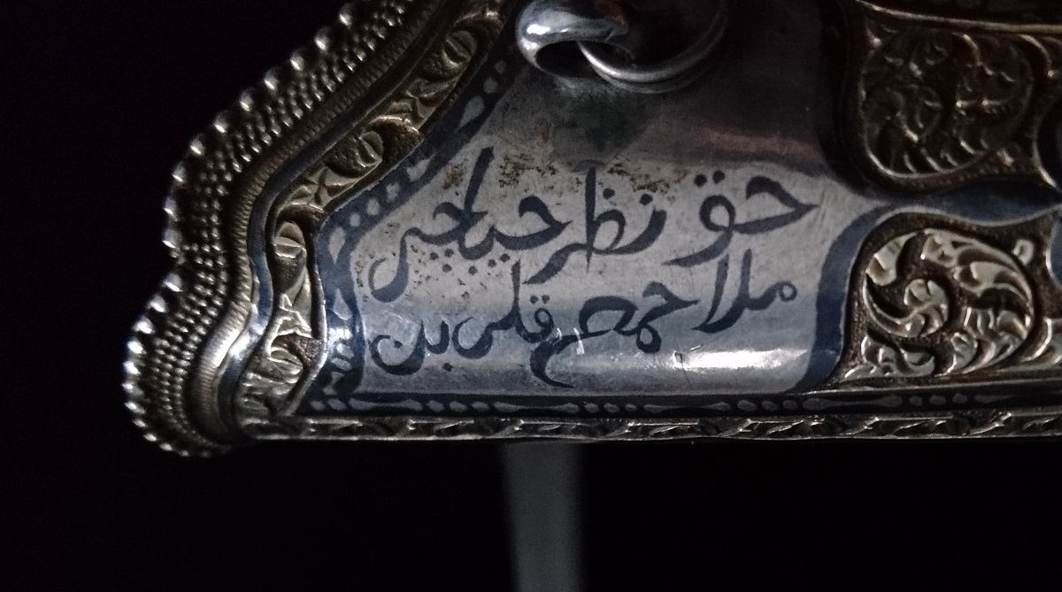

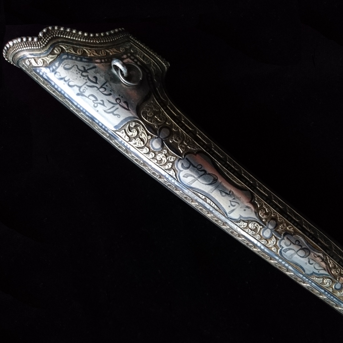

The big cartouche I can partially read, but I do not get the meaning:
it starts حق نظز (haq nadhar), both are words which I know, but not their meaning in this context. After that I am less sure, I would transliterate the next word as حیباچی (h[e?]ibachi?), but except for a Japanese stove I came up empty for that so I am probably wrong.
The second line starts with ملا, Mullah which makes me think it is followed by the name, where it again becomes difficult for me. I would guess جمحم قلی بن (Djamham Ghali Ben???), but I am less than sure.

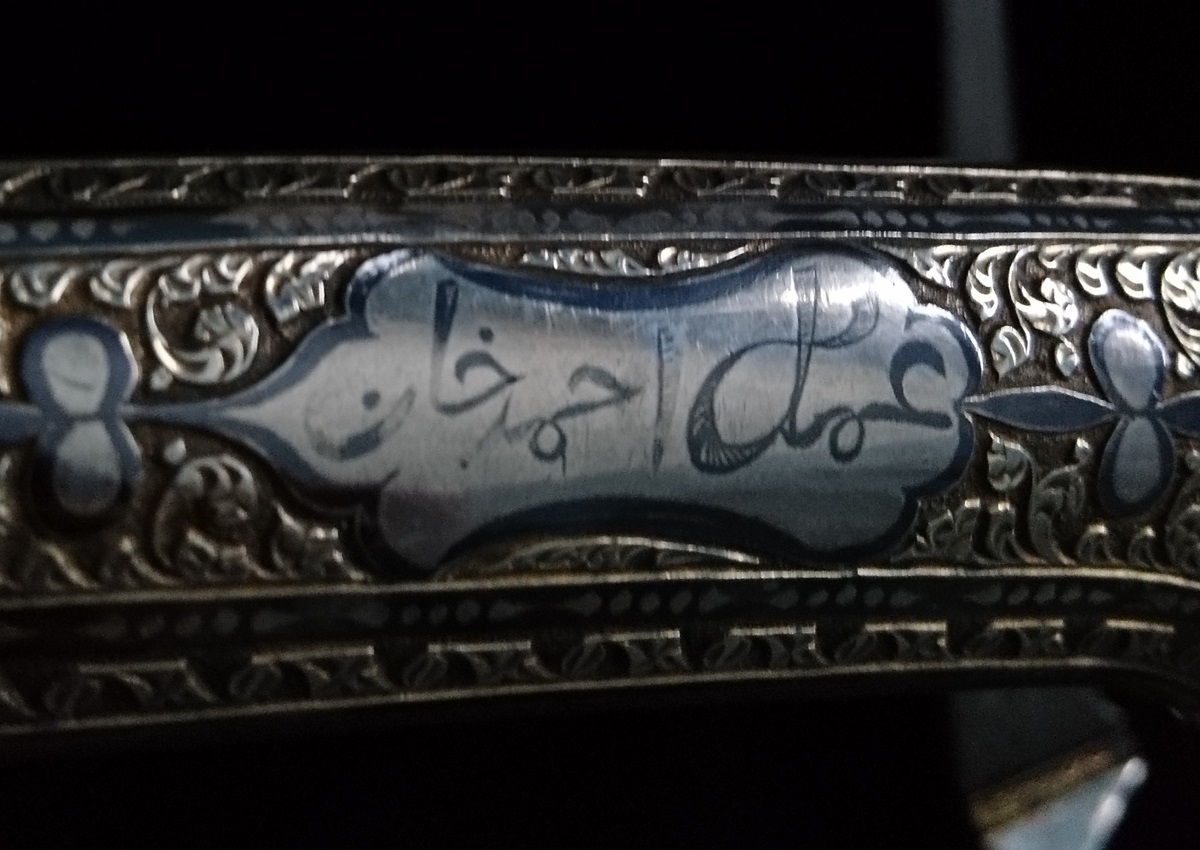

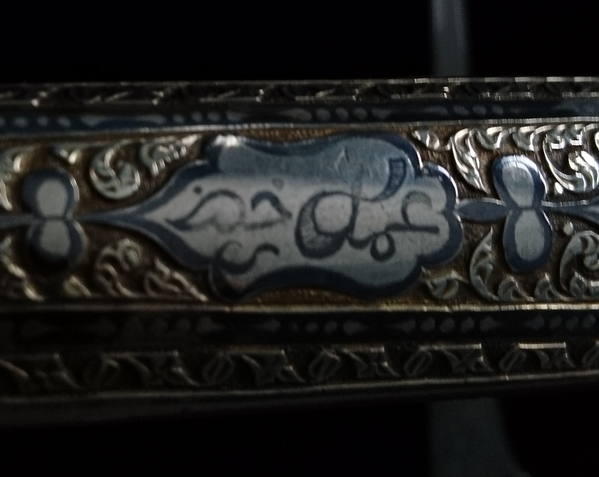

The first maker's cartouche I read as امل احمد خان, work of Ahmad Khan.
The secend maker's cartouche I can not make out at all, there seems to be an unusual flourish in the calligraphy that I have never seen before.

Very beautiful knife! Congratulations for this exceptional acquisition!
As you said, the blade is typical Persian 18th to early 19th century.
Both the hilt and and the scabbard may be later replacements and don't look very Persian to my eyes.
The scabbard looks more from the Caucasus area (which was a part of Persian empire throughout the history). I have seen exactly the same style of silver engraved decorations with niello panels and wire wrapped tips on kindjal scabbards.
The hilt is very similar to some I have seen on North Indian knives.
Let's hope for a translation!

Thanks, I am still pretty stoked I got it.
I agree that caucasian scabbards have similarly decorated fittings, and I am sure that is where the attribution by the auctioneer comes from, but I have never seen a peshkabz from that area before. The decoration also strongly reminds me of kard scabbards like this one though, and these are usually attributed to central asia.

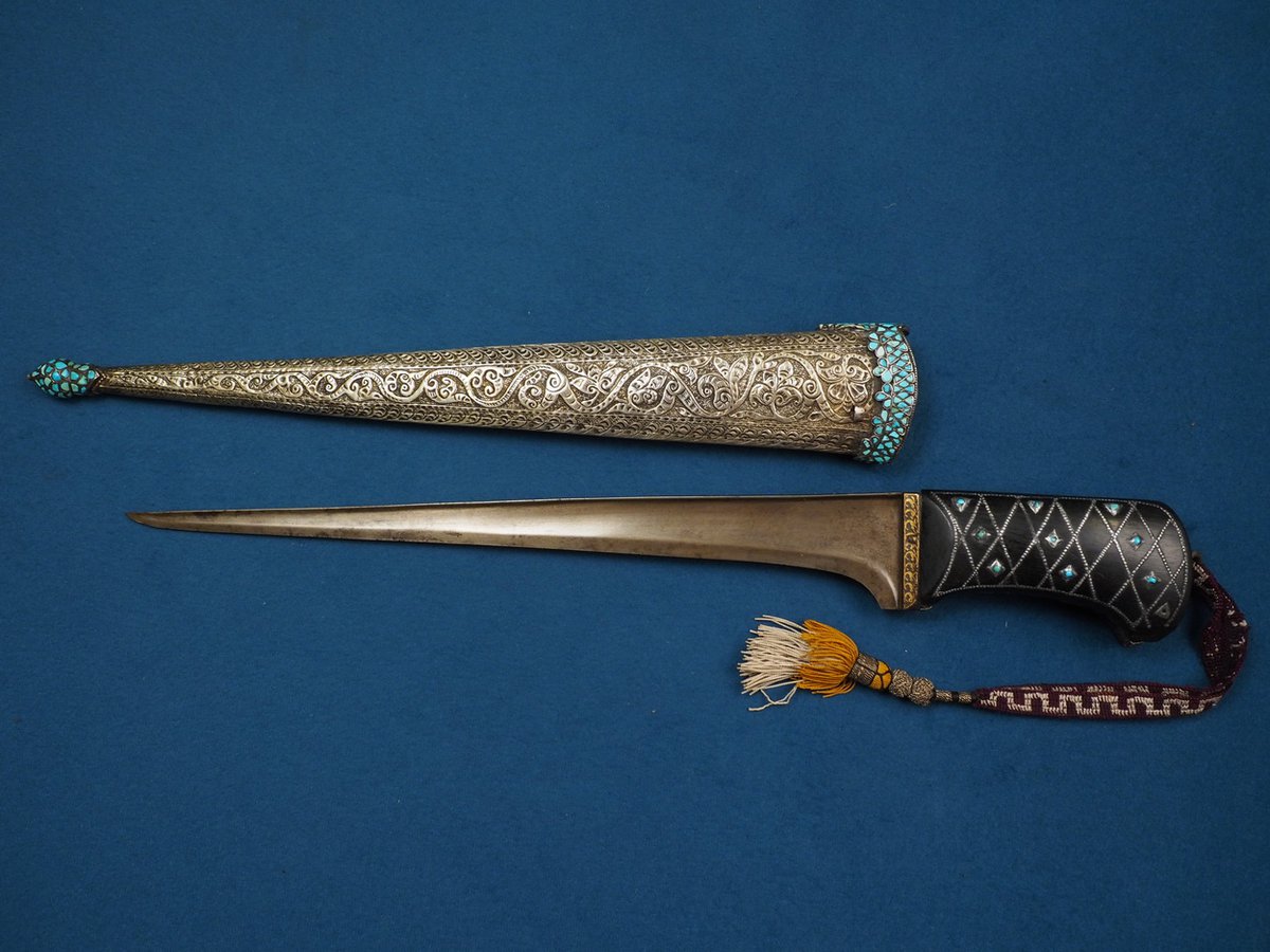

As for the silver hilt scales, there was also this peshkabz on sale in the same auction featuring a definitely central asian scabbards with typical turcoise cloisonne.
GePi is offline   Reply With Quote

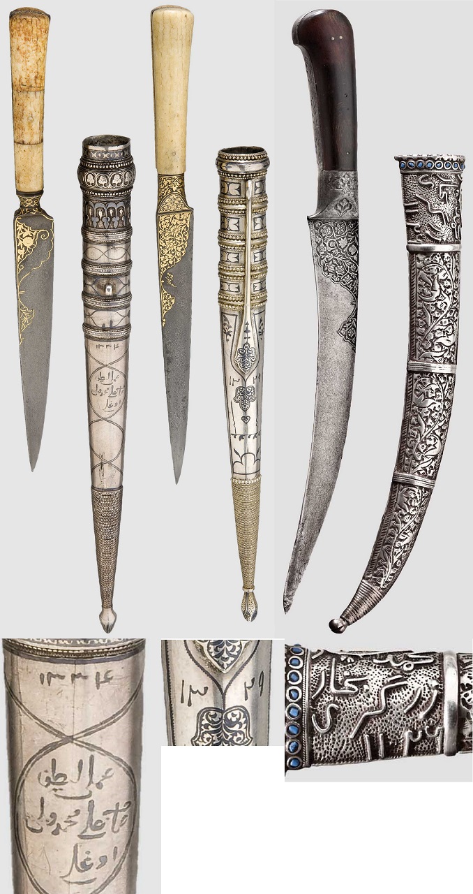

I am certain of that as well, it probably had a walrus hilt at one time, but where and when it was changed, who knows. The koftgari motive on the bolster reminds me of this Pesh/Karud, so for me central asia is not out of the question. I will certainly test the silver content of the grip scales sometime.
All that said, while the dagger fits the scabbard perfectly, I have since learned from secure provenance that they are a late marriage, which I don't mind very much, because both are still very nice in their own right.
I have also looked through my image collection a bit further to find dated central asian scabbards and have not found very many but at least these three from Hermann Historica.
The first is dated 1334 AH - ~1915 and has the maker and owner inscribed
'Amal-e Lotf, Saheb Ali Mohammad ???Qali Adghali???'
The second is dated 1329 AH - ~1911
The third is dated quite early, 1126 AH - ~1714, with the maker's name unfortunately not completely depicted
Mohammad *unreadable* Zargar (Goldsmith) Buchara (Buchari?)

Thanks for posting these. Interesting pieces. I would read them as you have done and give a reading for one of the names:
1334 AH (1915-16)
Work of Lutf (Latif?), owner ‘Ali Muhammad Vali Oghli (Veli Oğlu)
1329 AH (1911-12)
1126 AH - (1714-15)
... (Sayyid?) Muhammad Zargar Bukhari

Thank you very much for the correction. I was very unsure about the name because I lack the linguistic background you obviously have.
Did you also see the other kard scabbard in the same fashion that I showed a few posts above? It has the same makers' names inscribed as on my example. So seeing how similar in style they all are, I think it would be reasonable to assume that they are all from around the same time and place of origin.
