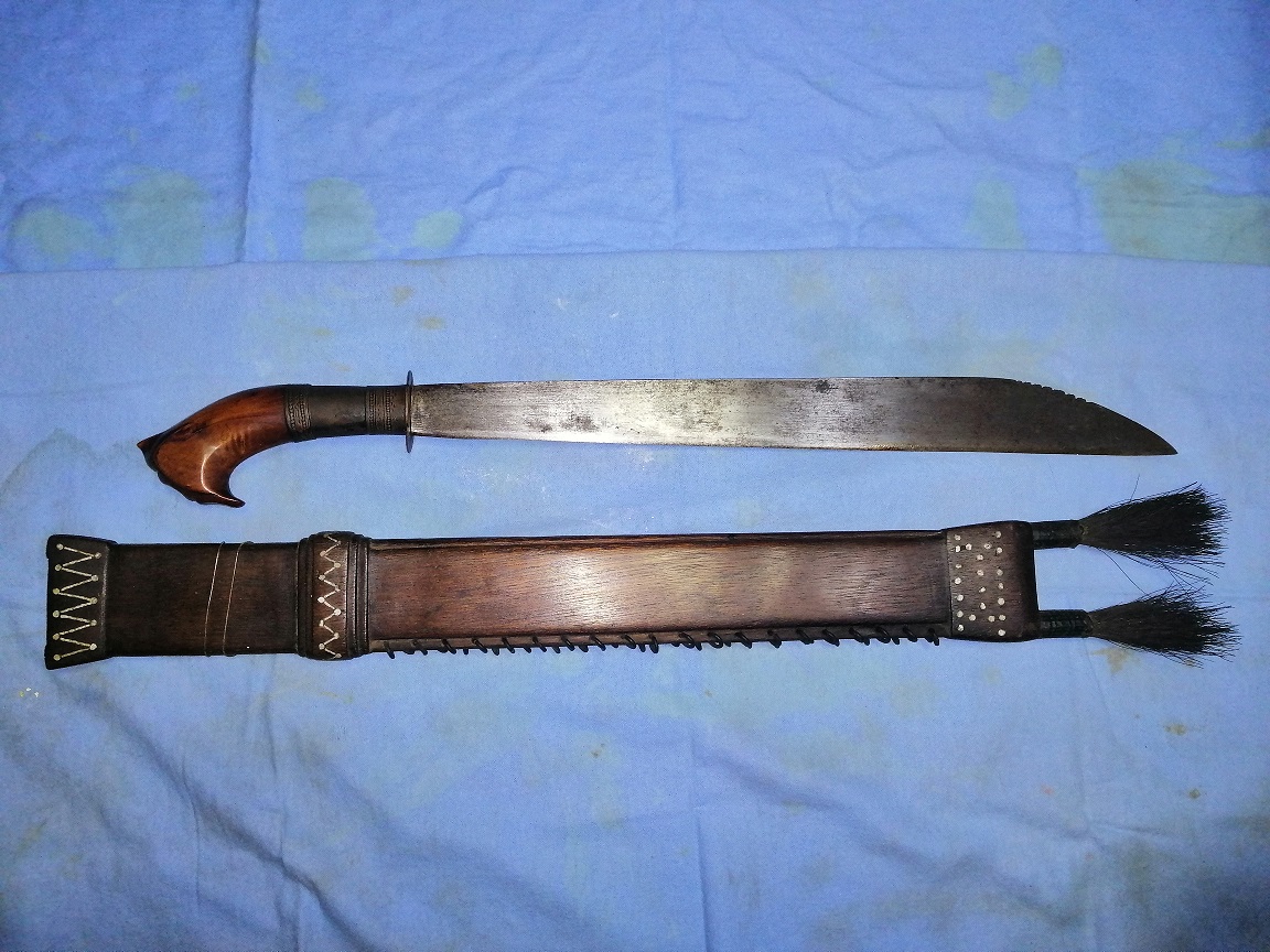

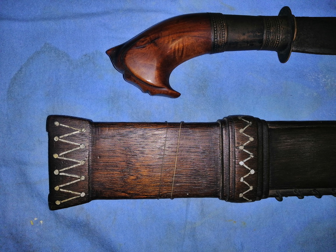

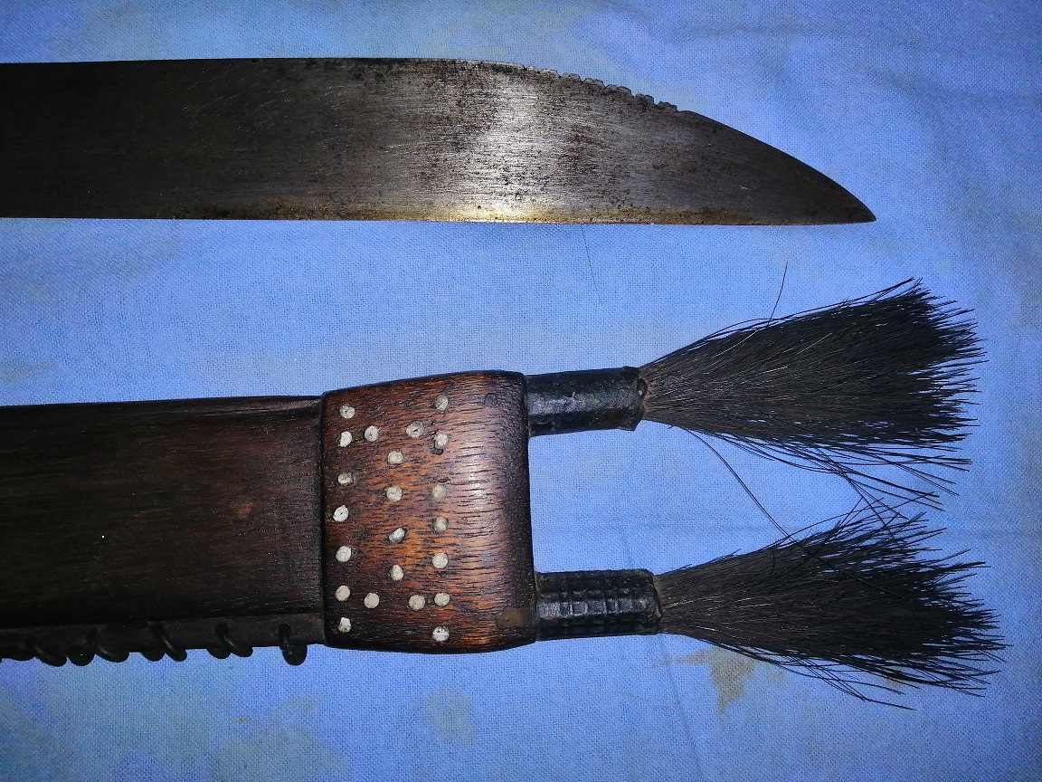

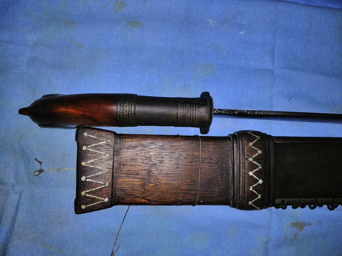

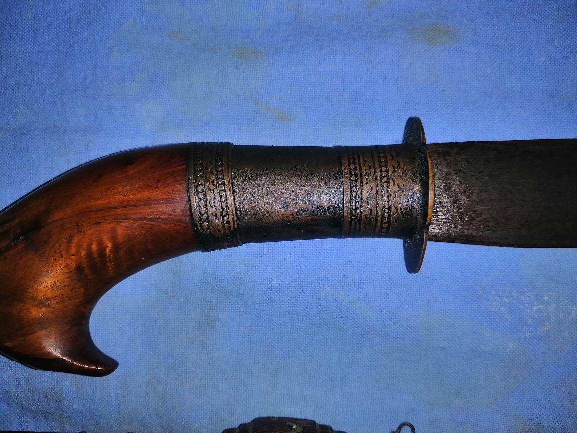

Sharing a lumad kampilan. At first glance, it looks Bagobo to me. However, there's a small tag on the scabbard which state 'b'laan.'
According to my father, this was bought in the early 90s in General Santos City.
Appreciate your inputs,
Kind regards
Yves

I'll let others weigh in with their opinions on the sword and hilt, but will note that the scabbard appears to be a nicely carved Blaan piece.
I think it's important to use the word Blaan and not B'laan, Bilaan, etc. This is a very important and emotional issue for the Blaan people, which we can recognize and respect. Thank you.

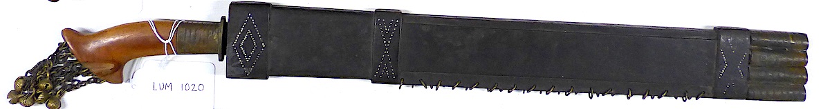

Here is another similar example. The scabbards share a common structure, with wooden "panels," metal tubes at the toe, inserted metal dots and segments that define geometric shapes, horse hair attachments, and a row of chain rings down one side.
The hilts have small thin disk guards, a brass/bronze ferrule with shallow incised designs, and wooden grips and pommels. The blades are very similar: small kampilan-style blades with rounded ends featuring shallow file work.
All typical Blaan work. There has been a question whether they made their own blades or obtained them from the T'boli. I think at least some were made by Blaan smiths.

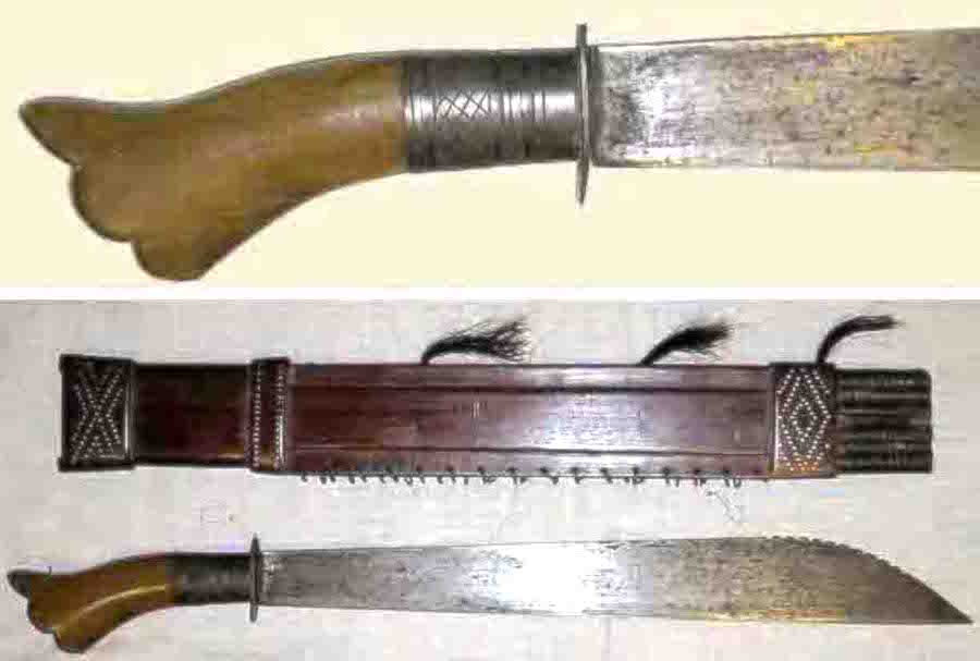

One more ...

Originally Posted by Ian
One more ...
now that is one beautiful piece!
