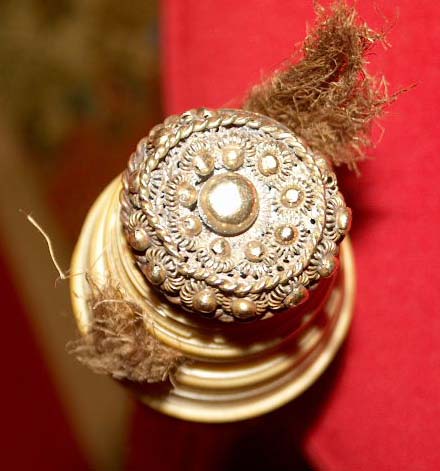

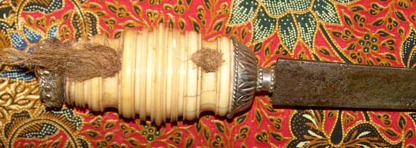

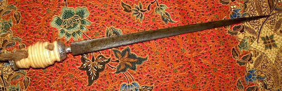

Bought recently this dagger. The triangular blade is forged, probably a pamor blade. At the base a very small mark that looks like a N and an A. The wooden scabbard is covered with silver. Ivory hilt and copper hilt knob.
Any comments are very welcome.

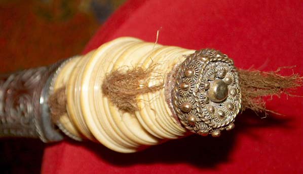

The decorative pommel cap reminds me of Indian jewelery. I will post an example.

It looks like a rehilted bayonet blade?
I have seen a rehilted bayonet in Madurese dress before, like a Keris.

In Central Jawa this blade form is known as a "sangkuh"; in East Jawa it is known as "buntut mimi".
The silver work in the pommel cap is similar to some work currently being done in Kota Gede.

Thanks for your pictures of the indian jewelry. It has similarities indeed. I think you can find this in the whole area. India, Philipines and Indonesia.

It was my first thought too when I saw the blade. A rehilted bayonet. But bayonets are as far as I know of plain steel and smooth. This blade is hand forged.

In Jawa I have never seen them mounted as spearheads. They are usually mounted in dress that is reminiscent of a command baton. I have seen one in very old dress that was mounted as a keris.I do not believe they have ever been mounted as a tombak in Jawa.
I do not think there is any Indian connection with the Javanese pieces. They have always reminded me of an old European bayonet pattern, and this may have been their origin, but I have not seen or owned any that were of European manufacture. All I have handled have been of Indonesian manufacture.

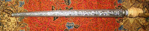

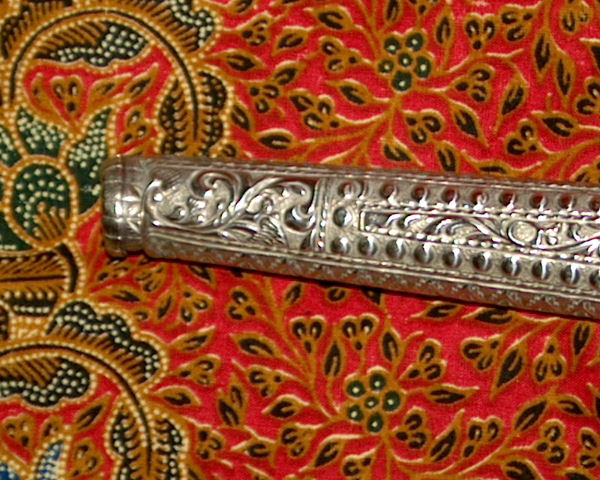

Would it be possible for you to provide clear close-ups of the metal scabbard cover. Do you know if this is silver, silver plate, or an alloy, such as mamas?

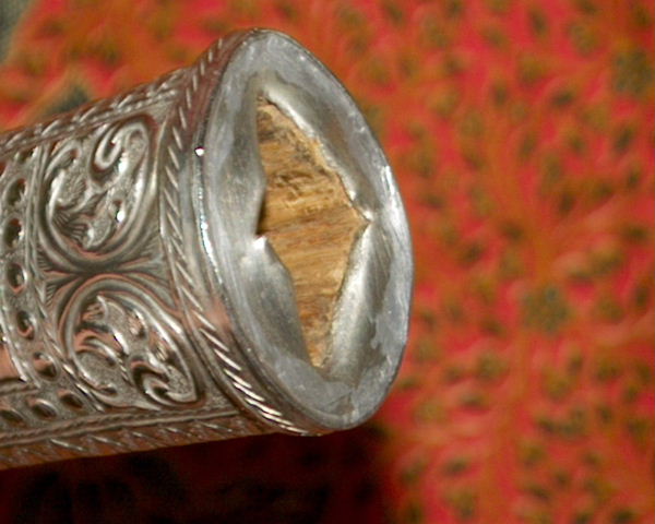

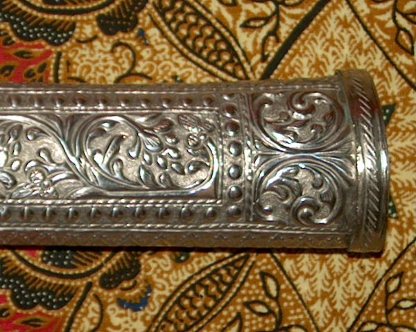

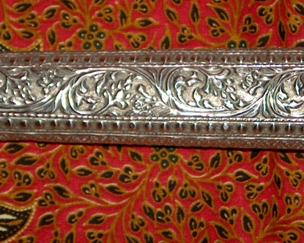

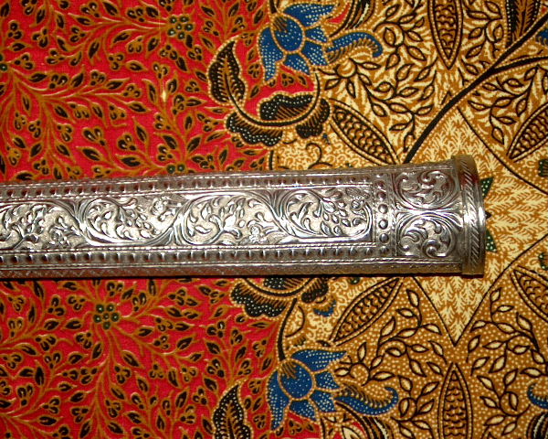

Thanks for your clear explanation. The blade has that triangular European bayonet pattern. As I wrote before it was my first thought. It is very likely that this is the origin indeed.
I made some pictures of the scabbard. I hope it will do.
I don't think it is pure silver used for the scabbard. It has a copper smell, so i supose it is silver plated or an alloy.
The question of Nechesh is a nice one too. Being dressed as a command baton it would be purely ceremonial, but if i look at the blade it isn't so ceremonial at all and will leave a nasty problem for the guy who's standing at the wrong side of it.
Old 24th June 2006, 10:17 AM   #11
Posts: 7,255
Thank you Henk.
I was hoping I would recognise embossing of one of the types I am familiar with, but I do not.
However, the construction of the pendok does look very Balinese; I am looking at the way the back panel of the pendok is folded up over the sides of the front panel.
Silver is very easy to test. You buy a bottle of silver test from a jeweller`s supplier. It is very cheap and lasts for years.

I think you have found yourself a modified european small sword in indonesian dress. The blade style is clearly not indonesian, but probably north european made (imported by the dutch?). It is probably cut (halfway) and resharpened.
The dress is indeed a recent creation, as you can see from the wood (at the beginning of the scabbard) and the metalworks (silver?)
There are plenty old european blades being modified in Indonesia, even in more recent times (1900's), your blade looks indeed a bit older. Try cleaning the blade propperly, maybe you still find more makers marks (Solingen?). My guess is its a mid to late 18th small sword.

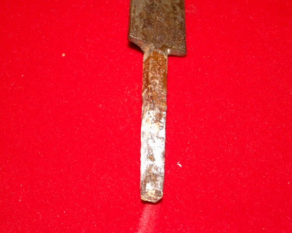

Hey Henk, is the hilt easily removable like on a keris. It might be educational to have a look at the tang.

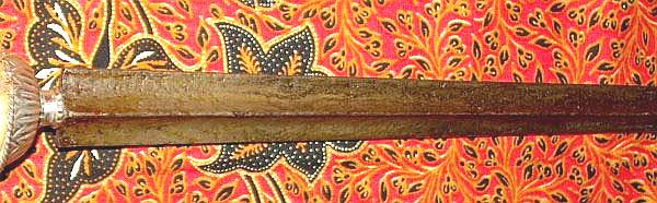

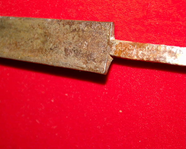

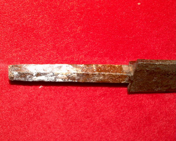

Nechesh, I could remove the hilt and made some pictures of the tang. During taking the pictures I noticed a very small stamp on the blade, hardly visible, but the pictures don't lie. It is very hard to see what the mark is even under a magnifying glass. I asked my daughter to look for me and she saw something like a N and a 4 or a triangle. On the picture I have a better image and I see something as PM or PN but it is very small and hardly to see with naked eyes.
Ki Jayamalelo showed a link of bayonets with a triangular one. If you look at such a bayonet it is attached with a round elbowformed tube to the socket.
The tang of my blade is square and doesn't show signs of reattachement to the blade.
As far as I know those reattachements or welding spurs are easily to discover. I've seen often reattached peksi's to keris. The place were the peksi is reattached is always thicker and visible.
I would like to hear your comments on these facts.
Alan, I hope you will react as well.
Old 4th July 2006, 07:19 PM   #26
Posts: 6,024
Which way up is the mark read????

Tim,
Now that I'm looking a bit better to the pictures you can read the mark with the point towards you as PM and with the angle towards you as NJ or something. I really cann't make anyting of it and better pictures than these are not possible.
