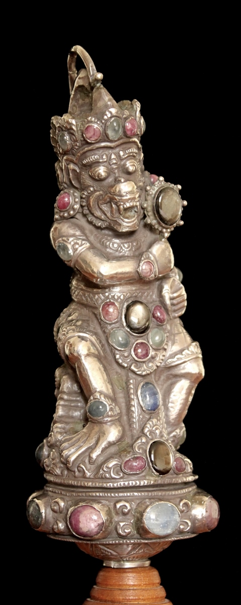

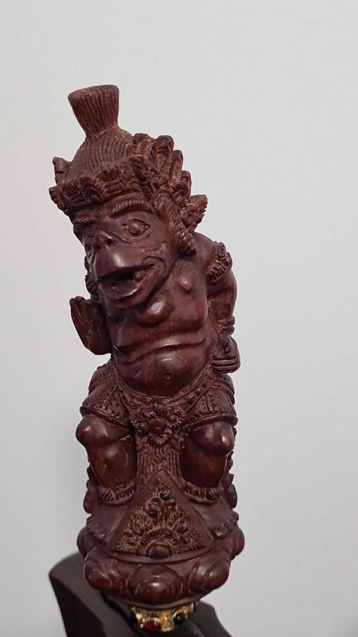

These hilts are not that common and most of them seem rather recent, see one typical specimen from my collection.

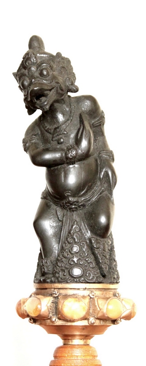

Hi, Thanks for the insight! I have seen keris hilt with the pony tail and arm positions to the sides and thought perhaps it is a Punokawan, but the facial features looked more like a Garuda or Hanoman. So from what I gather, in general Punokawan can be identified more by the hair on keris hilts whereas Hanoman can be identified with tail and more ornate mahkota. What about Garuda, are there some identifying tell tale signs it will be Garuda on keris hilt?

The first hilt clearly depicts Hanuman from the ape feet and the tail protruding from the back of the head.
The second hilt with the pony tail was identified as Jatayu (the nephew of Garuda) by a late Javanese expert because of its beak but it may depict a punakawan.

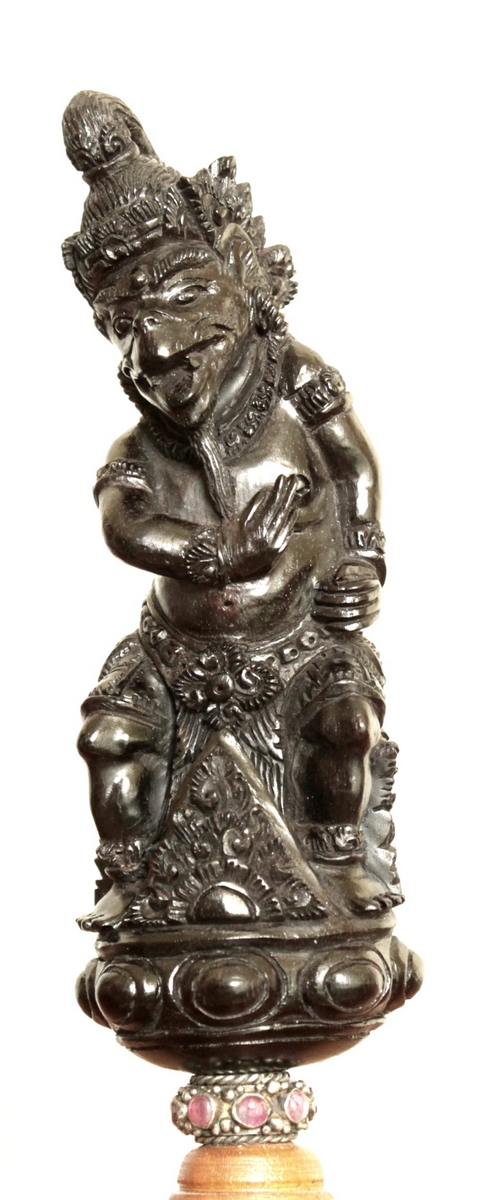

Jean do you have a side view and possibly a back view of the second hilt?

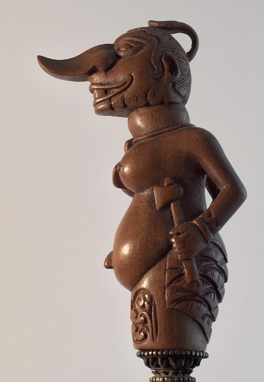

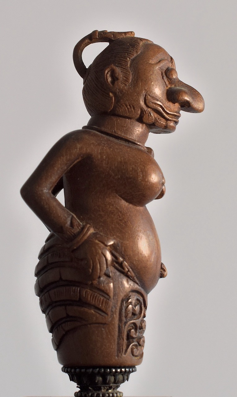

two recent Javanese punakawans by wood

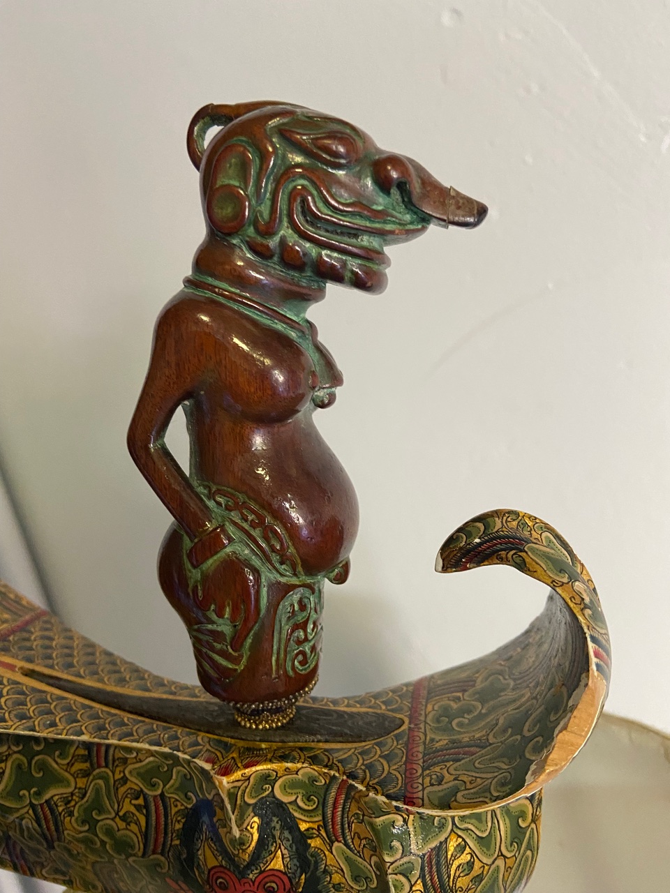

Posts: 301

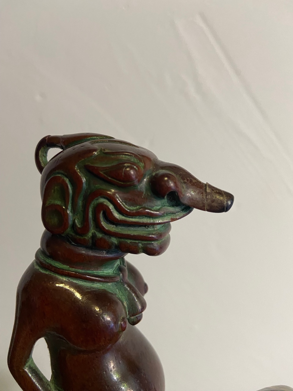

Default here’s the finest one I’ve seen.
i’m not showing the rest of the Keris, because it’s very personal. I actually found it in a pawnshop. I have reason to believe it may have been made for an artist. It’s extremely fine. I had dreams of it before I bought it.

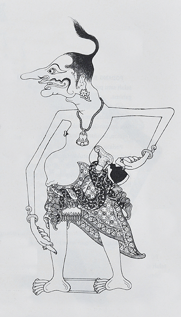

Posts: 7,263
Look like somebody you might know?
This is Petruk, taken from a reference on old Wayang characters form & nature.
Old 20th July 2023, 04:50 AM   #17
Montino Bourbon
Montino Bourbon's Avatar
Posts: 301
yes, and in his adventures, he had his nose broken; but that’s OK because my nose is broken too.
