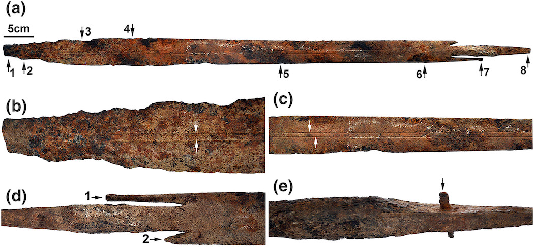

I have attached larger images of the sword, which appear as Figure 1 in this article and have the following description.
Figure 1
General appearance of the double‐edged iron sword under investigation: (a) general appearance, where arrows locate the spots from which specimens were taken for metallographic examination; (b, c) magnified view of the tip and the body, respectively; and (d, e) magnified views of the hilt.
