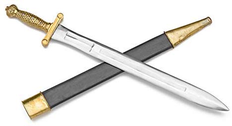

The sword shown in the pictures look very much like the U.S. model 1832 heavy artillery sword, though it is hard to see the distinctive fullers and wasp-waisted blade that would make identification more certain.
It is a little-known fact that, though the model 1832 sword was current military issue and therefore not readily obtainable by civilians, a number of them were made available to "free state" guerillas during the so-called "Kansas- Nebraska War" in the late 1850's. Whether this was done through official or non-official channels is unknown, but photographs from the era show them being worn by free state partisans, and the swords used to murder 5 "Jayhawker" prisoners during the Pottawotamie Massacre in 1856, though referred to as "broadswords" in newspaper accounts, were actually 1832 artillery swords. As the Kansas-Nebraska War took place in the middle of Otoe and Pawnee territory, it is possible that Indians obtained them from the Free Staters, or perhaps from whatever source supplied them to the Free Staters.

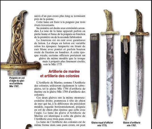

Of course there is 95% of chances that these short swords are US in origin.
But remember that the US artillery sword is based on the French model.
This model existed since the 18th c. and Lafayette with the models 1767-1771 and 1774-1783.
https://www.photo.rmn.fr/archive/06-...NU0P2WKB1.html
I'm not in the head of a 19th c. Indian, but a sword with an eagle head is a really cool totem... Think about it....
So you need to look at the photos closer, maybe these Indians had French swords.

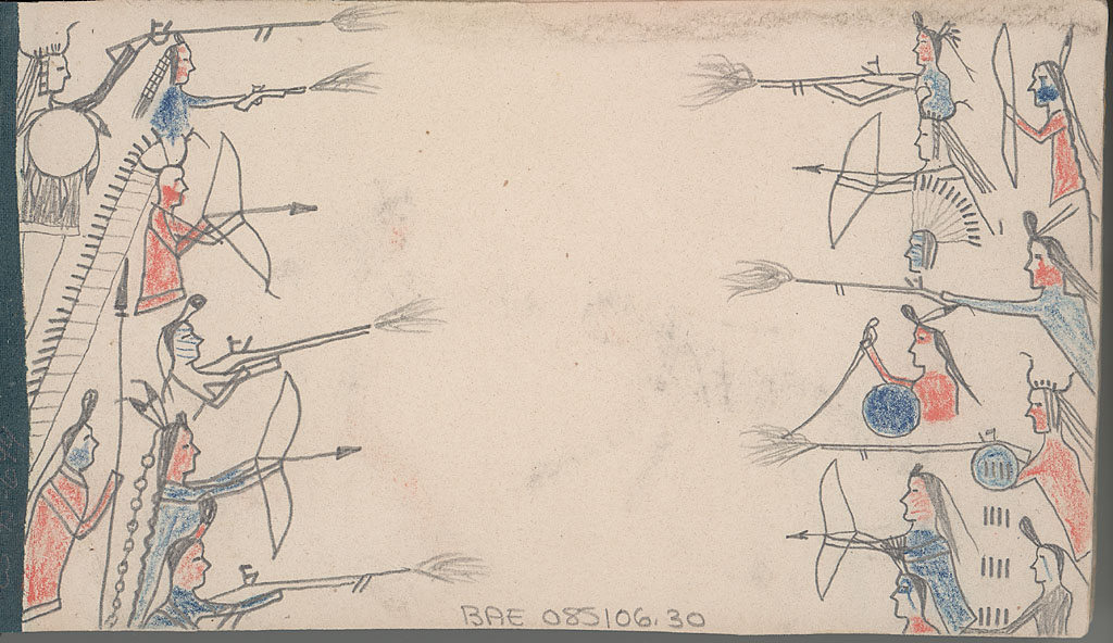

At the Solomons Fork (Kansas) battle in 1857, the Cheyenne medicine man convinced warriors that they were impervious to soldiers firearms if they held their hands up when fired upon. When the soldiers put carbines at ready, the Cheyenne advanced regarding the guns harmless. The Pawnee scouts must have interpreted what was going on and advised Col. Sumner.
He ordered troopers to sling carbines and draw sabers, and charge.
The confidence of the Cheyenne evaporated and broke in confusion, as they had no defense against the long knives.
In another case, a saber captured by a Piegan (of Blackfoot) warrior from Sioux was carried in battle, and when surrounded by Crow, he was said to have stuck the sword into a sage brush, where it burst into flame, and the Crow retreated.
At the Little Big Horn a Sioux was seen wielding a heavy saber taken from Gen. Crook's forces at Rosebud fight, and was probably the only saber on the Little Big Horn that day, since none of Custer's men carried swords in that fateful campaign.

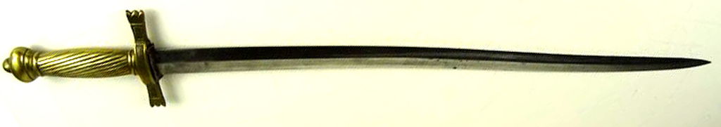

These swords (which were double edged so in fact broadswords by definition) were as noted M1832 and produced by Ames Sword Co. of Chicopee, Mass. in considerable numbers between then and 1862. While intended for use by the foot artillery, in 1834 and 39 they were ordered to be used by infantry as well.
Harold Peterson ("The American Sword" ,1954/73) notes these were unwieldy and completely unsuitable for combat. In their use they served mostly in a utility purpose.
