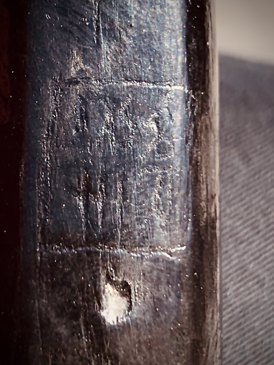

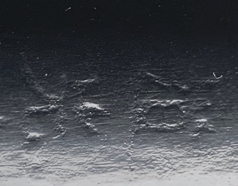

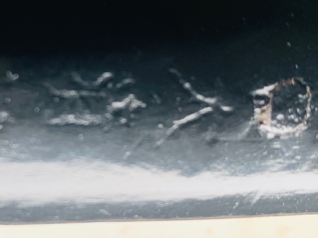

These are closeups from the cutlass length saber I posted. Please help with translation if possible. I think the characters give a reign mark, but unfortunately they were lacquered over, and are difficult to decipher. I will try and do a rubbing and see if that helps. It looks like the pommel was refit to tighten it up, probably when it was lacquered.

So the second picture down with the black lacquer and the two characters says "Da Qing", (i.e. "The Great Qing"). The two characters in the picture above that should give the emperor's name. Could it be Tongzhi? The inlay work has me stumped.

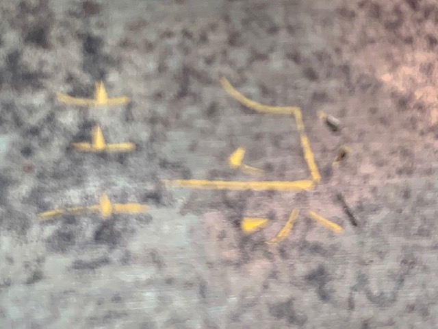

Lower character is "zhou" 州 - prefecture, province, administrative division (in old China).

Decrypted the first character, that's what I got 邠州 Binzhou (the name of the county located in the western part of Shaanxi Province, in 1913 renamed Binxian County 邠 县)

Thanks so much for your help. These might be better photos.
I have not succeeded yet with rubbings, but have manipulated the photos as best I can. If possible, please translate the lower character (not sure what it is?) Anything that can be deciphered would be greatly appreciated. Thanks.

The character in the photo below is similar to an imitation of a traditional Chinese seal - a square in which four characters are inscribed. The bottom two are similar to 州邠 Binzhou - the same inlay work on the blade, but in a mirror image (the usual order on old Chinese seals and many other inscriptions).
It looks like you were right.
大清道光卜 "Da Qing Dao Guang bu" - "The Great Qing Dynasty Emperor Tao Guang granted [this sword]" ("Dao Guang" reign period 1821-1850).

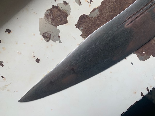

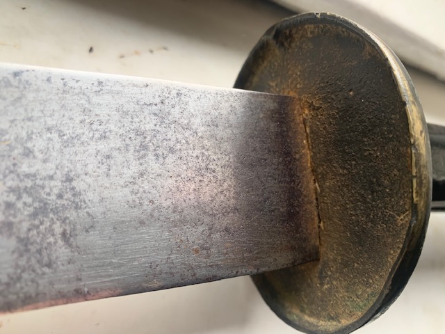

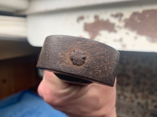

Finally got around to it.
As you can see, it is a wide bladed militia weapon. It has a feel like an oxtail dao, and a shape similar to some versions of the much heavier dadao.
It is interesting to think of this example having something like a "license", carved into its handle. The workmanship is very professional and solid with a tight grain and no forging flaws. My overall impression is that it is better quality than arms made in smaller villages.
