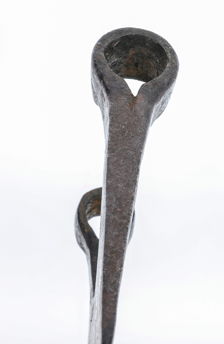

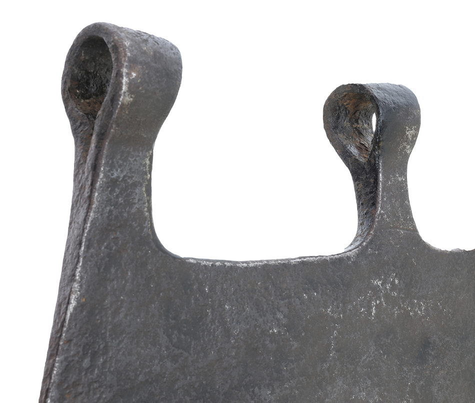

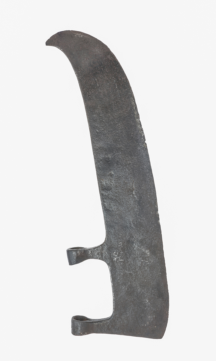

Early polearm or Lochaber axe or something else ?
Your comment are welcome
Overall 60 cm
Weight 3078 gr
Best
Cerjak

Posts: 1,071

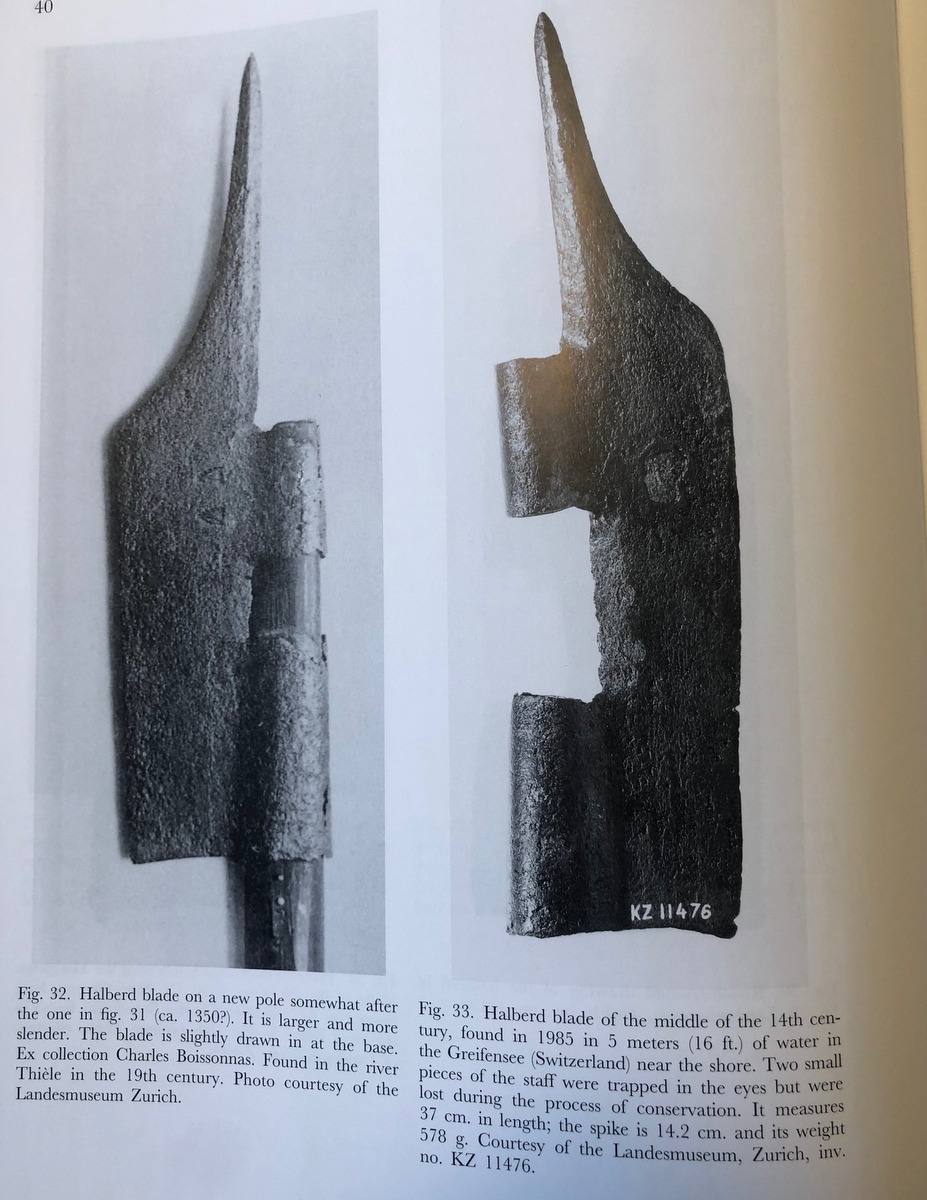

Hi Jean Luc,
I presume this is a so called whale blubber meat cutter with characteristic rounded point and eyes with a distance from the blade. 18 or 19thC
early halberds have a sharp spike and eyes close to the blade.
best,
jasper

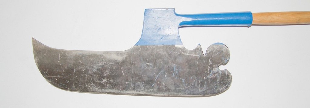

found this 'Croatian Bardiche' on a bing search

Originally Posted by cornelistromp
Hi Jean Luc,
best,
jasper
Which publication is this taken from? It looks good.

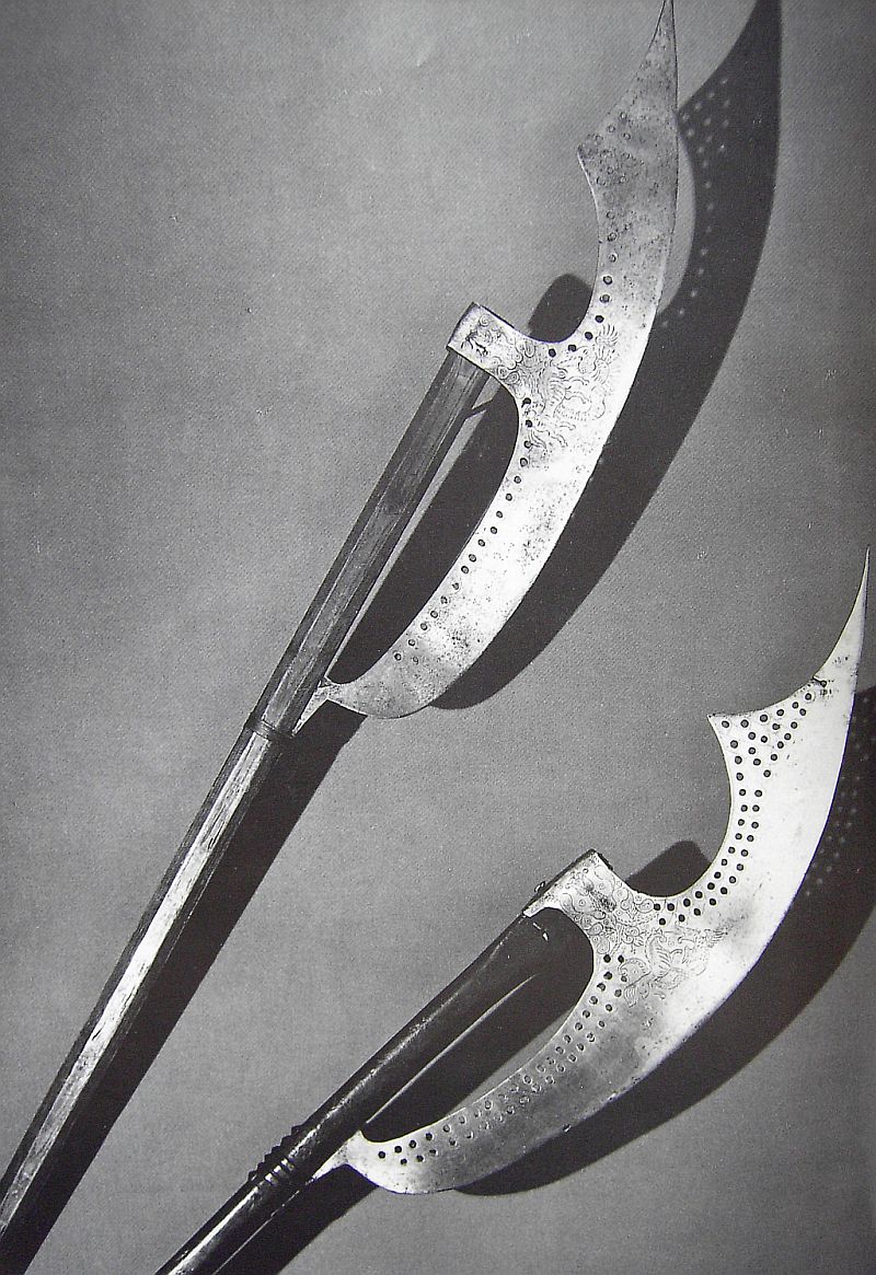

From the caption I think the bardiche on the left is described as Russian. The war axe on the right is described as Croatian.
Old 17th November 2019, 11:16 AM   #9
Yes, the search I did was for "Croatian AND Bardiche" just "bardiche" or "russian bardiche did not bring up anything useful. I Added "Croatian" based on another photo that appeared to be germaine, also no ref. noted.
The page says it's Russian, appears to be in German,title of the book was cut off. One of our more bookish experts who have exhaustive libraries may recognise it.

post 6 is from Europaische Hieb-und stichwaffen , Mueller koelling.
the early halberds of my post 4 are from Hafted weapons in medieval and renaissance Europe by John Waldman
best,
best,
Thank you for that, Jasper. I think Waldman and Snook are the classics when it comes to halberds. I had forgotten how good the former is -had to look it up again!

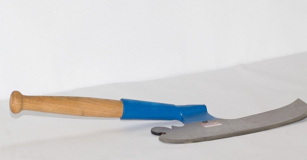

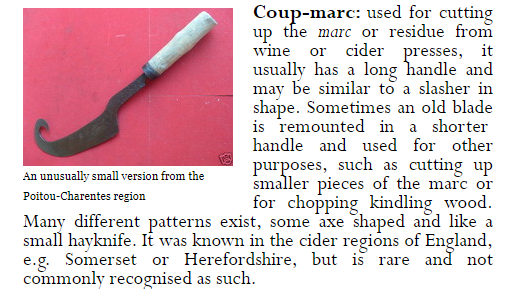

Sorry to burst the bubble, it is a French agri-tool called coup-marc.
Old 21st November 2019, 07:51 PM   #14
...and your source/reference/examples? many agri-tools were also weapons when required like bill hooks, early swiss halberds/ Scots axes, etc.
Old 22nd November 2019, 10:19 AM   #15
Kmaddock
Kmaddock's Avatar
Join Date: May 2014
Location: Ireland
Posts: 549
when i looked up Coup Marc I get the following
regards
Ken

Sure, well known fact. Sometimes it is pretty hard to tell between, sometimes there is no difference. As a collector and researcher, I also believed this fine example of blacksmithing was forged to be a weapon, but no. Too heavy and ill-balanced.
Years ago, a highly respected auction house even labeled a similar piece as "the ever ellusive French double socketed beheading axe", romantic but false.
Boucard, Daniel, 1998, Les Haches, pp. 210-211

Exactly my point: several patterns, abundant in cider regions like Bretagne.

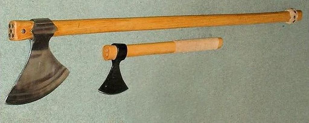

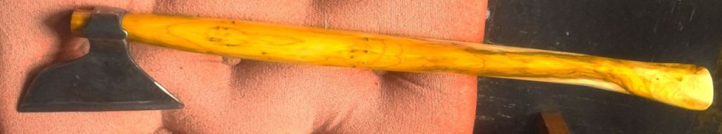

The Anglo-Saxon two-handed axes on the Bayeux tapestry are generally known as 'Dane axes' and had a haft about 5ft, more or less and a broad pointy blade that was rather thin and light compared to a wood axe. It was optimised for cutting flesh. The Gallowglass also used a 'Sparth' axe, also around the same length.
After Hastings, many surviving English Huscarls, now unemployed, migrated to the eastern Roman empire and served in the Varagian Guard of the Emperor in Constantinople, and were famous for their Axes.
My Dane axe is shown below, with a smaller viking style hand axe. My Sparth axe is shown below. Both are of course modern reproductions only shown to illustrate their appearances.
As the picture have the numbers 213 and 214, not 211/212, the left one is a war axe from Croatia (213) and foot war axe of ca. 1500 (214)
pictures 211/212 show the following arms:
Old 27th January 2020, 08:21 AM   #22
Victrix
Victrix's Avatar
Join Date: Apr 2017
Posts: 785
Yes makes sense.

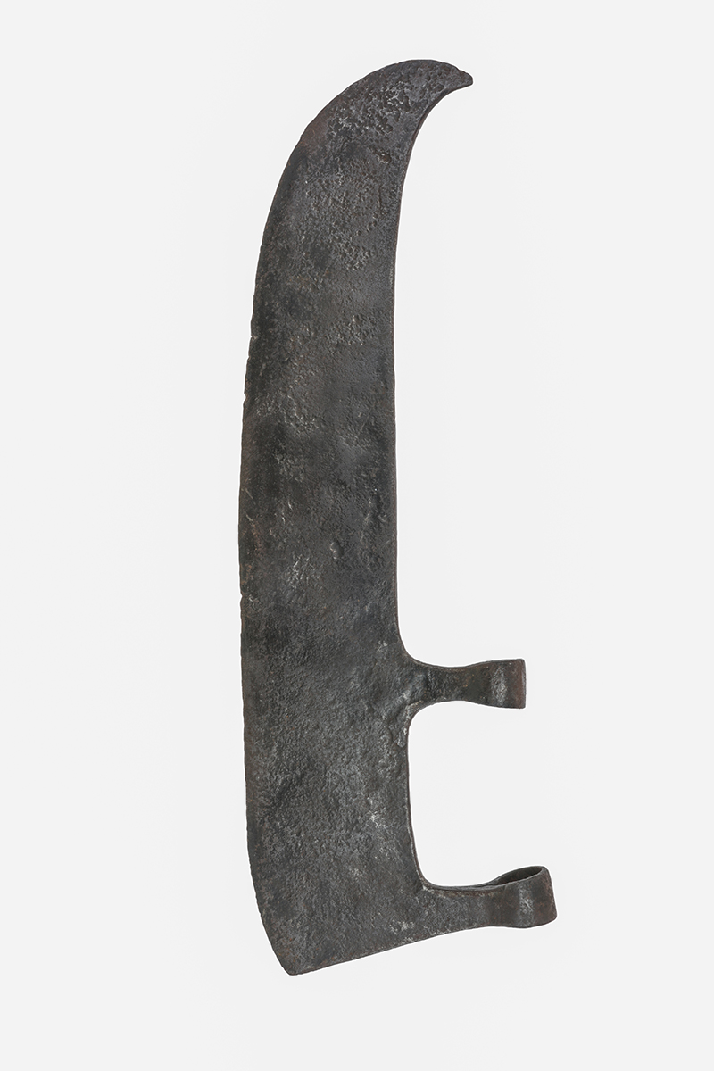

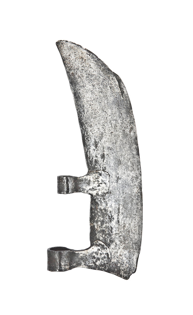

Default A LARGE IRON VOUGE STAFF-WEAPON HEAD
Description made by Christies in 2012
ALMOST CERTAINLY 15TH CENTURY
With heavy curved blade (tips reprofiled) struck on one face with a series of marks and on the other face with one corresponding mark, with two forge-welded sockets, the cutting-edge probably originally forge-welded steel (heavy discolouration and corrosion marking throughout)
18½in. (47cm.) long

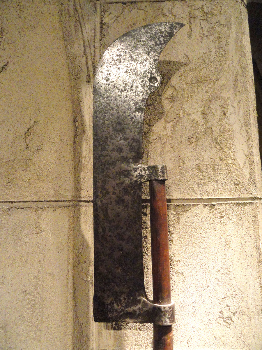

Default Exhibit in the Higgins Armory Museum, 100 Barber Avenue, Worcester, Massachusetts, US
Exhibit in the Higgins Armory Museum, 100 Barber Avenue, Worcester, Massachusetts, USA
Old 4th May 2020, 08:33 AM   #26
Yvain
Yvain's Avatar
Join Date: May 2017
Location: France
Posts: 181
This is indeed a coupe-marc / couteau à marc / couteau de pressoir, most likely from the XIXth century (XVIIIth being possible too). The shape is characteristic, and is one of the most widely used for this kind of tool.
Although some tools were indeed used as polearms, or evolved into them, this is way too heavy to be used effectively as a weapon.
Similar examples coming from museums in Normandie (a well known cider producing region of France):
https://collections.musees-normandie...b-8568daf8c665
