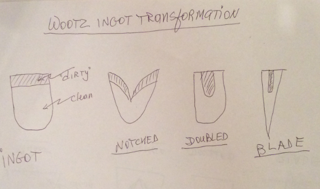

It so happened that I bought a wootz Pulwar about a year ago. It came ... broken in half. Insurance paid me back, but I'd rather have the sword:-((((
But there was an interesting feature : the break showed internal structure of the blade.
So, I have decided to show how the wootz ingot was transformed into a blade.
I drew a sequence of images. Just do not criticize me for bad artistry: I never had anything more than C- in my elementary school.
From left to right:
1. Ingot in its final form consists of 2 fractions: the bottom part has good wootz with all the dendrites. The upper part collects the junk, the slug etc.
2. The upper part is deeply notched
3. Then the notched ingot is doubled on itself, with the " dirty" part becoming the inner one.
4. The blade has its edge and sides made out of "clean" wootz, and the "dirty" one is open on the spine.

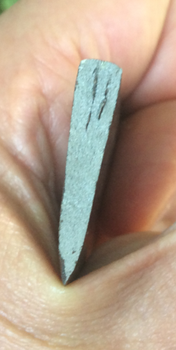

Next, picture of the broken blade: one can see the junky innards on top of the blade.

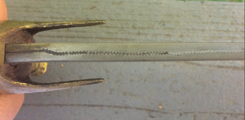

Next one,- another sword, with a "crack" on the spine. This is where the junky part of the blade shows. Then the smith fills the crack with a wire. Or not.

That is fully consistent with my “ scheme” that shows the final structure of the cooled down ingot: wootz at the bottom, junk on top.
I thought that seeing the internal structure of a wootz blade was kind of fun: not often do we have an opportunity to see cleanly broken wootz blade.
From the practical point of view, the crack at the spine of the blade is important: we often see patinated blades with no visible wootz pattern. But if we can detect a longitudinal crack at the spine, filled with wire or not, we can be sure that the blade is wootz and start polishing and etching it.
And you are correct: Nonikashvili is perhaps the best living wootz- maker.
Thanks for the comment.

You are correct: my diagram does not touch on the composition of wootz, it only shows what the smith did with the already manufactured ingot.
Nonikashvili’s method is unique and I am not smart enough to judge its faithful replication of the ancient process. But all old descriptions mention only iron ore and leaves ( a source of C).

But again, what I presented is how the old masters dealt with the ingot to maximize the use of real wootz component in the working areas of the blade, not how the ingots were made.

Thanks for the pic - could you try to get a macro shot, please? It seems to show 2 rather than a single cold shut from forging; I don’t think I’ve seen that before...
The folded structure of many wootz blades has been discussed here before. I agree with your general assumption that the wootz often got folded upon itself (despite having a tough time to imagine the forging work needed to end up with a neat elongated blade with intact internal configuration).
From what I’ seen of ingots, they seem to be clean steel also at the top. The dendrites seem to be better developed towards the lower part though. The folding may well be intended to expose this structure rather than hiding any impurities.
Since wootz needs to be forged at “low” temperatures, any cold shut after folding the ingot upon itself may well be from working at too low a temperature to achieve proper welding. It’s a thin line...

The break area on my example was not polished and etched.
There is a similar example ( polished and etched) in a Russian book by Kamil Khaidakov: much better resolution of the junky area.
Folding was not intended to hide anything: it just assured that the important parts of the blade used the best part of the ingot.
Quite possible the junky part was squeezed out through the crack in the spine. Just a thought.

Ariel, No need to notch the ingot...it folds at the top on its own during forging...for two reasons. One being that unless high forces are delivered it is the natural tendency for metals to move more at the surface that the middle and they "fish mouth" or "duck bill". After more light forging the edges of the steel touch and you get a folded appearance. The second is that the poorest part of the ingot is the top and it almost always had gas pockets from the cooling process and as such is less dense and moves differently under the hammer. Often collapsing onto its center as forging progresses.
I have yet to see a "sound surface" at the top of an ingot. All ingots have some surface irregularities in them in the form of pockets or bulges and if the porosity is not visible it exists in micro form with the most porous at the top.
Often the top of the ingot becomes the spine of the blade. I would call the folded over bit a seam and I have seen several where the seam wanders from the spine onto the flat of the blade. In one case it fell off and was cold riveted back into place.
Ariel...if that broken blade is for sale I would like to purchase it and do chemical, hardness and microscopic analysis on it to add to my database.
That goes for anyone else who has broken crucible steel blades or bits and pieces.
Edit: It is a simple matter to add silicon to the steel when it is liquid (very hard to stop if glass is present actually) and I have yet to see any glass survive in the bar once forged out to a blade. It all goes away when the ingot is being forged into bars. This is due to its liquid nature at temperatures used for forging and also that if allowed to cool on the anvil it is untempered glass which is very brittle and simply falls away when left to its own devices after a day of forging.
Edit Edit: I would guess that large grain size (and shipping abuse) was the cause of the fracture. If the break is at all black on the edges then it could also have been a flaw from the quench which waited for the stress of shipping to finally break. Cracks caused in forging or the quench or almost always black color due to high temperature oxidation. In modern blades if the crack is yellow or blue then the crack was in the tempering stage of manufacture...the color is again due to oxides, but lower temperature oxidation.

I can see islets of wootz pattern, and tried to photograph them with my iPad, but the camera was not able to catch the image: there is quite a lot of small pitting.
It has to be polished and then etched professionally (I am an amateur). I am sure Ric will be able to do it zillion times better when he gets it.
