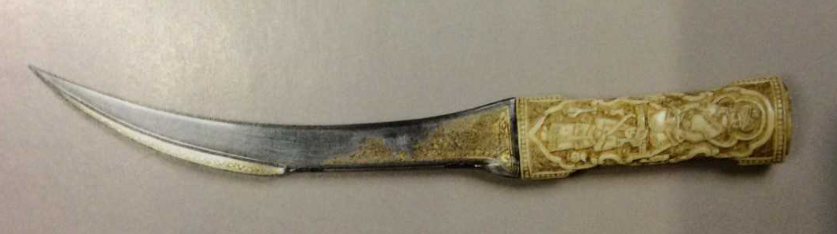

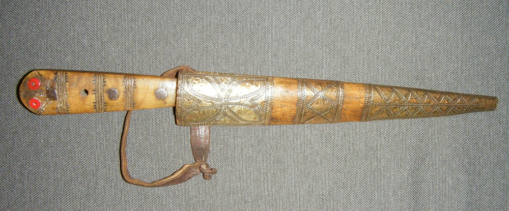

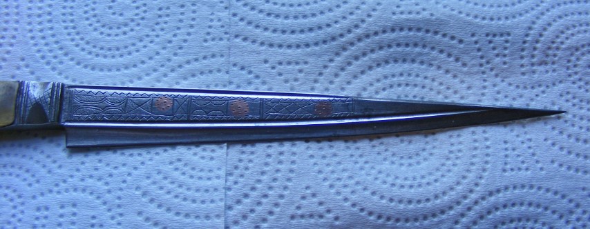

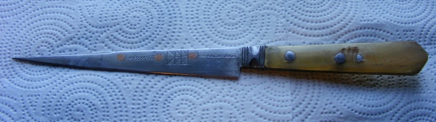

Hello members,
I've recently purchased a North African dagger, it remember slightly to the Algerian bou saadi or khodmi daggers but there are also differences. Could it be a Moroccan genoui? But the ones I've seen look also different. So what it is? It's 11,75" long with a 6,5" blade. Thank you in advance, Detlef |
#2 |
Join Date: Mar 2016
Location: Paris (France)
Posts: 420
For me is an algerian Bou Saadi. The genoui blades are longer and have a more symmetrical shape.
#3 |

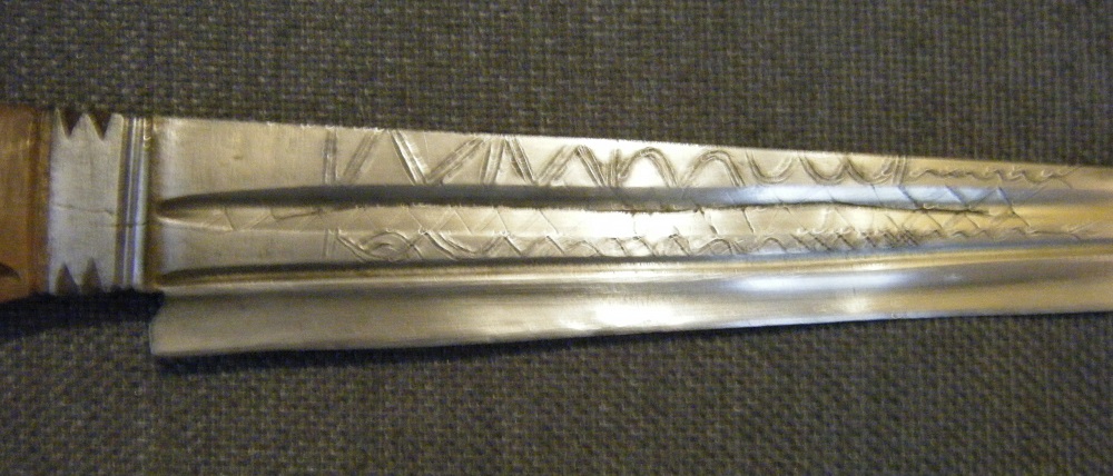

I agree its from Algeria but not Bou saidi but from Iflissen, a Kabyle tribe.
Please look at the tribal designs on your blade they are very close to the flyssa swords. They also have simple blond horn grips. Overall your knife is from the so-called Bousaidi style and definitively Algerian. |

Very khodmi-ish, tho the blade shape is less utility than Vendetta stylus style. Some Iflyssan saw a Corsican knife on line and made one in Bou-saadi.

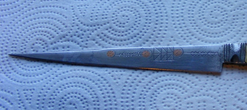

#5 |
Posts: 9,203
Hello Séverin,
Thank you for comment! ![]() |
#6 | |
Posts: 9,203
![]() Quote:
![]() Regards, Detlef |
#7 | |
Posts: 9,203
![]() Quote:
![]() ![]() Regards, Detlef |
#8 |
Genoui is just a koummya with a straight blade.
Yours is a Khodmi. |

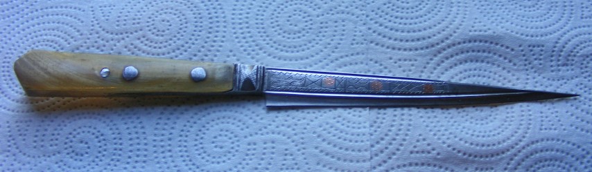

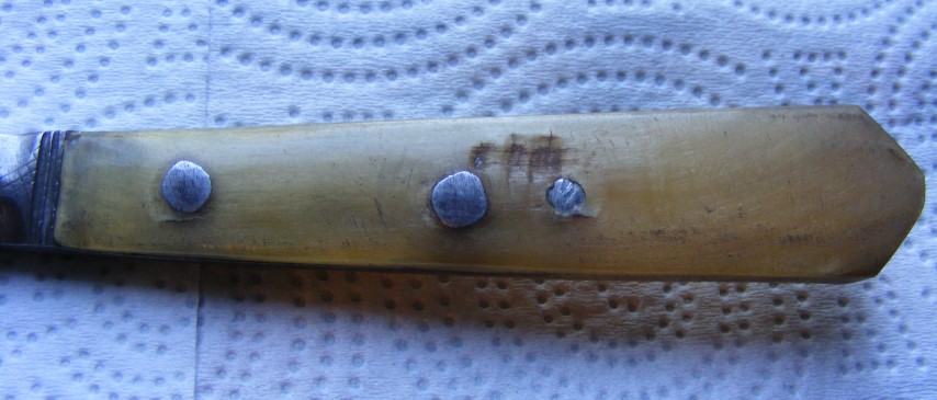

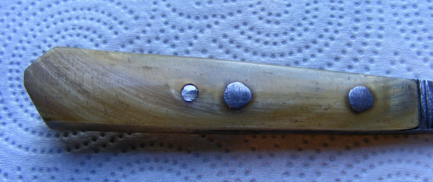

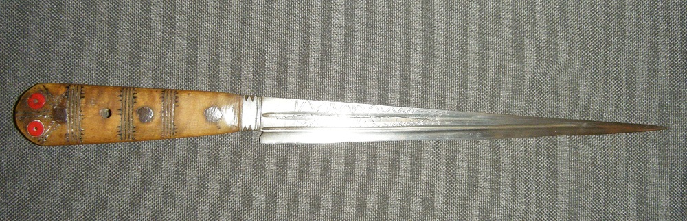

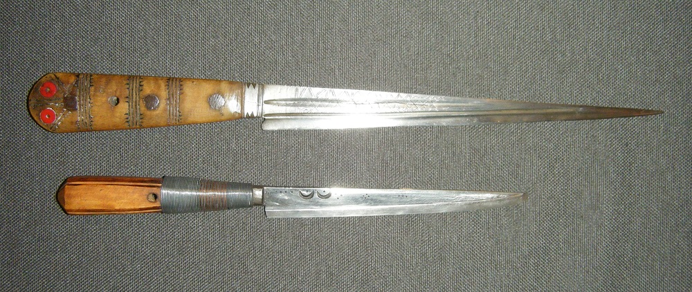

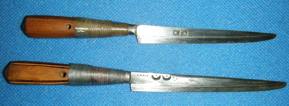

#10 |
Posts: 9,203
Can I assume that this is as well a Khodmi from Iflissen similar to the one the thread started?
Last picture show it together with a Bou saidi. Thank you in advance, Detlef |
#11 |
Posts: 4,396
Detlef,
The blade reminds me very much of a 19th C. Italian "vendetta dagger." Perhaps a copy of an Italian blade in Magrib fittings. Ian. |

#14 |
Posts: 4,224

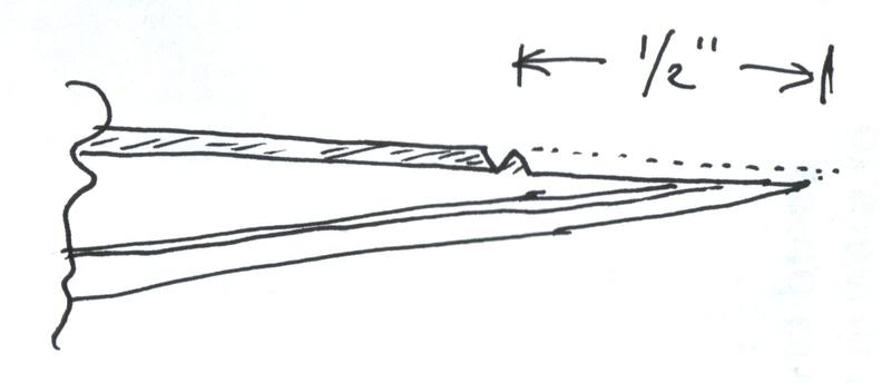

The khodmi almost universally have the wire wrapping on the grip, unlike the 'vendetta style ones. They may be Bou Saadi made tho. the spines on khodmi often have a tiny step and notch on the spine at the tip. On some this is worn newer ones seen not to have them. Some khodmi with wood/horn gips have been sold in Europe as 'Medieval eating knives'

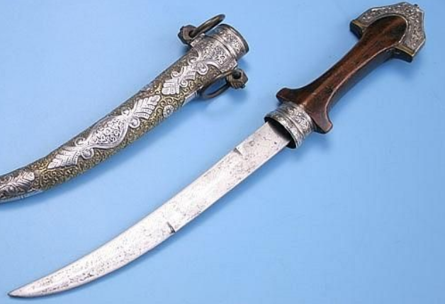

#17 |
Hi

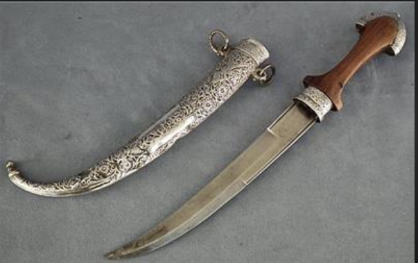

You have a North African pseudo pesh kabz. ![]() More seriously it's more a Moroccan janwi or genoui than a khodmi... The grip is very similar to the shula and the size to the janwi. I vote for Morocco. http://www.vikingsword.com/vb/showthread.php?t=24849 |

Well, to each his own. I also ordered Steel and Magic, even though it is not my area of interest.
But these days and for quite some time I am mostly collecting good books. There are so many things I learn from them! One thing I have learned from Eric's book is that nobody, but nobody, in Morocco calls a Koummya "koummya". It is a Khanjar. And that shorted some neurons deep in the amphibious part of the brain....:-) What always puzzled me is the peculiar, practically unique, way of sharpening the edges of Koummya. It is double edged, but the convex side is sharpened only on the distal ~ 1/3 , whereas the concave side has 1/2-3/4 of it sharpened. There are not very frequent examples of Persian khanjars with a very similar construction. Anybody has an opinion whether it is just parallel development or a borrowed idea, and whether the local Moroccan moniker reflects it? |

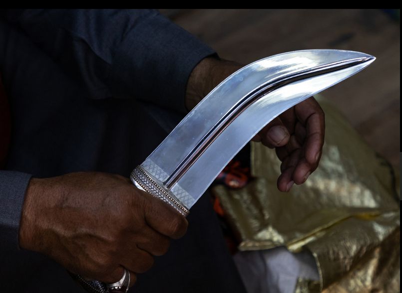

See also this western sword dealer/teacher's take on this, and read the comments below, especially what id now the first, "SamNam11 4 years ago I'm a descendent of a nomad tribe from the Arabian peninsula. To use correctly, after the small penetration with the tip forward the holder makes an outward cut like with a kukri. So it never intended to make a full stab in that way of holding. Btw holding it upward with the tip backward was funny to see because in my culture is a sign of lacking the experience with this dagger ![]() https://www.youtube.com/watch?v=fy9myTnFfUc Last edited by kronckew; 30th March 2020 at 02:18 PM. |
