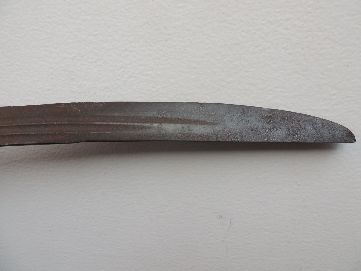

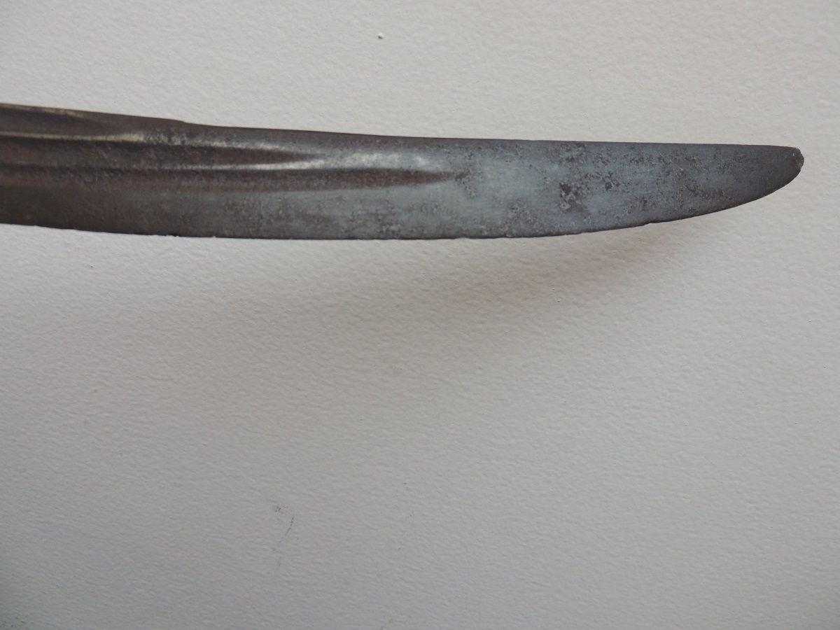

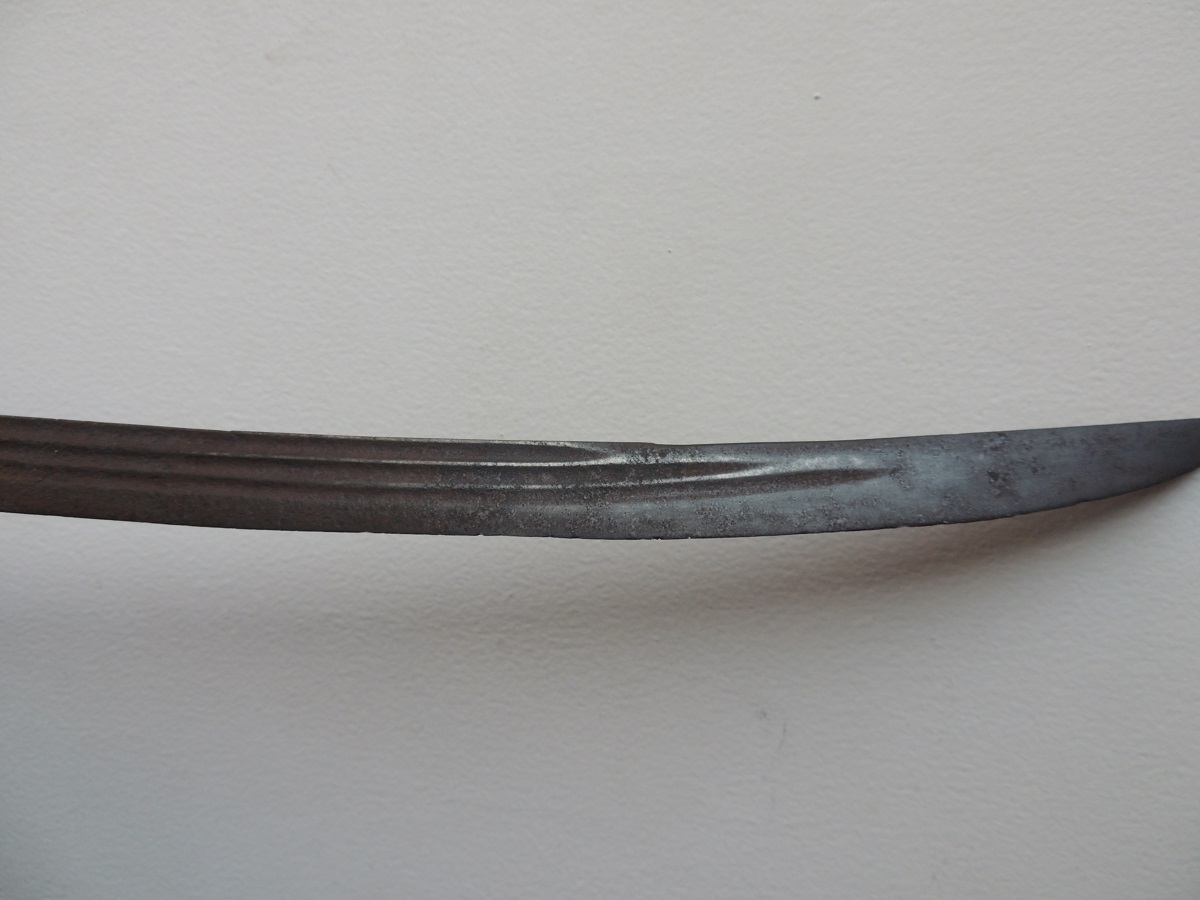

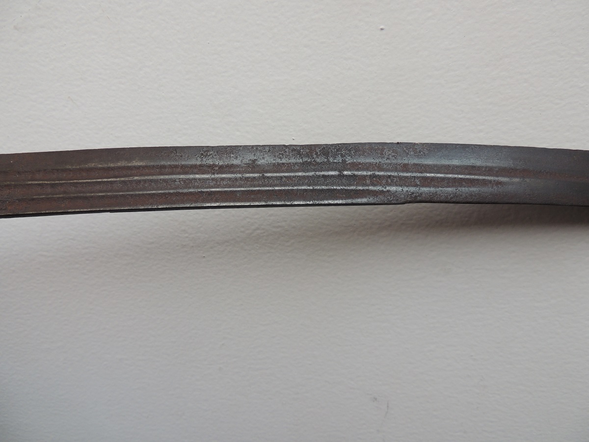

Recently got this one. It has a flexible blade and is still sharp.
I do not know is from Sumatra or Borneo.

It's hard to make out much detail with dark pictures and heavy patination. The blade could be quite old, but impossible to say from these pics and without cleaning the blade.
Old 31st August 2019, 12:35 AM   #4
Posts: 6,436
Judging from the last picture I can't recommend cleaning this sword. To get it clean you would be venturing into the territory of stock removal.
Old 31st August 2019, 01:40 AM   #5
Posts: 4,736
Good point Rick. The last few inches near the tip of the blade certainly seem to be heavily corroded, although the edges of the fullers show some underlying steel coming through the rust. Closer to the hilt, there is little pitting and there seems plenty of steel left to enable a clean. The fact that you could flex the blade and it sprang back (without cracking or breaking) suggests there probably is quite a bit of steel left to effect a reasonable clean.
I've found gentle abrasive blasting in a cabinet to be effective at removing old rust of this type. I use fine "Black Beauty" medium, an air pressure of about 60-70 psi, and short bursts from 6-8 inches to be effective, while the somewhat lower than usual air pressure allows the process to proceed fairly slowly. Mechanically removing the oxidation with abrasive paper puts more stress on the blade IMHO, and I have had thin blades crack under vigorous rubbing.
An alternative to cleaning would be to stabilize the rust with, say, tannic acid and leave the sword black.
Hope this helps.

Yes, the sword is quite bendable and bending is in the lower half. There is rust but I think is mostly on the surface, additional photos on a better light show that.
Before posting I already lightly cleaned the sword with a toothbrush, synthetic sewing machine oil and Pelikan rubber eraser (the blue part of the eraser).
The sword is for sure a trade steel, as there is no such steel in Sumatra.
Think I saw years ago in Jakarta History Museum similar sword with description "18-century Indian sword".

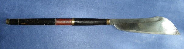

This toa from my collection http://www.vikingsword.com/vb/showthread.php?t=21189 was once similar heavy corroded. All cleaned only by hand.
