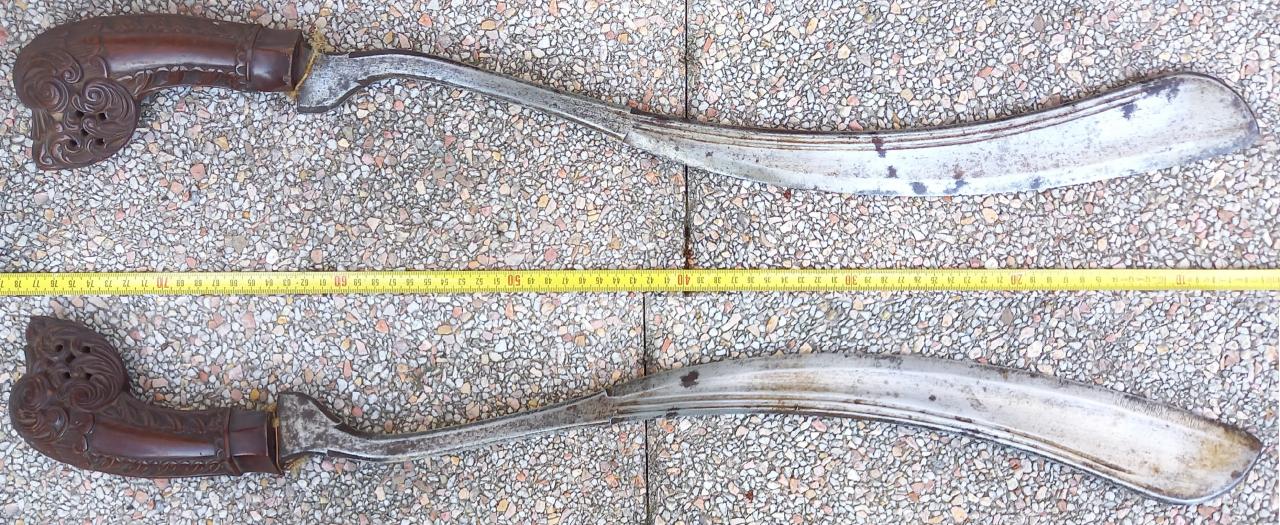

Default PAKARANG KASOENDAN (Weapons of the Soenda)

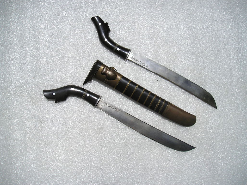

Hullo everybody!
The following may be useful:

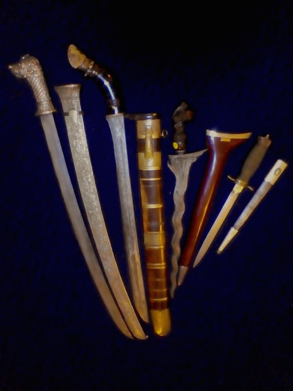

Pakarang Tjatoerangga, the four quintessential implements of the praboe(=warrior-noble) class.
Please excuse the poor-quality picture; it’s merely for simple illustration.
Referring from left to right:
1.Pedang Abet Pamoek (=leader’s sabre)
In this case:
Name: Ki Panoenggoel
Desc: Pedang Tilam Woewoengan SOEMEDANGLARANG 19thC .
Char: Djekong .
Blade: LxOALxWxT=58X69.53.04X0.83cm. Curved; Distal-taper.
Handle: Silver Toemang w/ ruby eyes.
Wt: 550g.
Sheath: Silver w/ embossed widjaja.
2.Golok (=bush-knife)
In this case:
Name: Ki Pamoengbang
Desc: Gobang Woewoengan TJIBATOE 19thC .
Char: Roeroentjangan , Djekong .
Blade: LxOALxWxT=51.5x66x3.95x0.72cm. V.slightly-curved; Distal-taper.
Handle: Horn tjeker-mentjek, brass-rivetted (3) to gagang, brass seloet.
Wt: 503g.
Sheath: Horn djamprak, brass simeut-meuting/daoen, brass bands(one w/ belt-ring) and sopal.
Comments: Gobang is a long golok kitted out as a sword, thus lighter but still functional as a bush-knife.
3.Doehoeng (=armorial/totem dagger)
In this case:
Doehoeng Panjinglar Bala (=wards off misfortune)
Name: Ki Rangga Panengah
Desc: Doehoeng Sampana Toempeng 13 Eloek SOENDA PAKOEAN .
Char: 13-eloek , Kembang-katjang , Kotjop , Widja , Oepih , Djanoer .
Blade: LxOALxWxT=35.5x40.5x8.77x1.51cm.
Handle: Wood, Laksamana(=Rama’s brother, known for his ‘magic line’).
Wt: 360g.
Sheath: Wood, Djongan w/ white-metal mouth & chape.
4.Peso Teundeut (=push-dagger)
In this case:
Name: Ki Panjeuhil
Desc: Peso Teundeut TJIKEROEH .
Char: -
Blade: LxAOLxWxT=22.5x34x1.93x0.71cm.
Handle: Wood w/ twine.
Wt: 153g.
Sheath: Steel w/ white-metal mounts.
Comments: Made by Ki Tanoedimadja, 1910.
It was brought to my attention that one may need the following refs.:
http://www.vikingsword.com/vb/showthread.php?t=19260
http://www.vikingsword.com/vb/showthread.php?t=24136

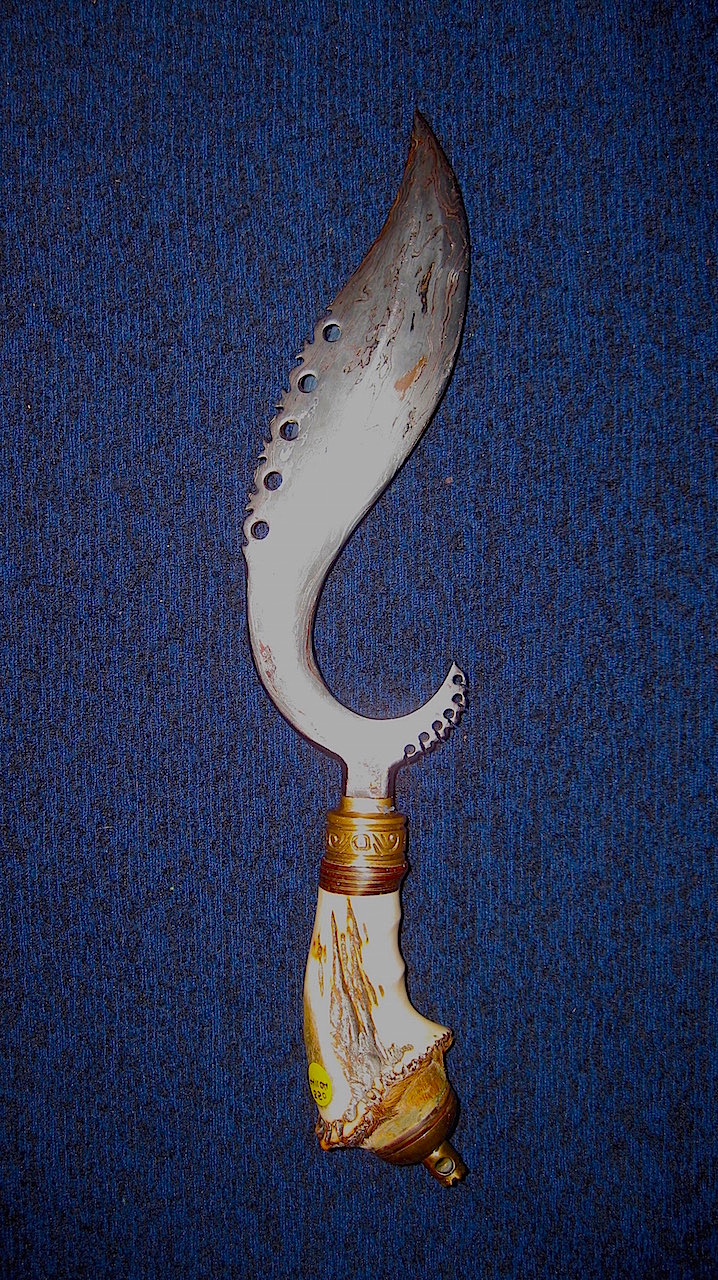

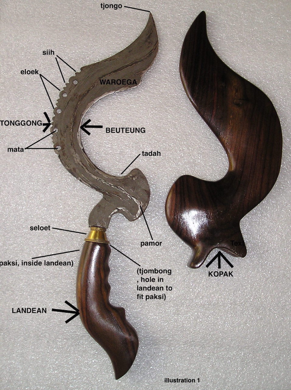

Default KOEDJANG / KUJANG
Hullo everybody,
FYI.

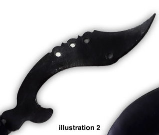

KOEDJANG:
The Koedjang is a traditional implement which has become synonymous with Oerang Soenda identity.
It started life as a simple farming tool (viz. the arit/sickle) and evolved into what it is today.
As a traditional symbol, its protocol virtually restricted the use of the variety of koedjang to the Pangreh Pradja/Prijaji (‘rulers of the realm’/governing bureaucracy), leaving only the basic farming-tool type for the common people.
Although the clergy were also allocated use of the koedjang, they were primarily as talismanic symbols of the clergy’s function: to nurture and protect the spiritual strength of the realm.
Koedjang Anatomy( ref. illustration 1 )
Waroega ( Body/Blade )
Tjongo/Papatoek ( Tip/Beak ), for gouging
Beuteung ( Stomach/Front Edge ), sharp edge for cutting/slicing
Tonggong ( Back/Back Edge ), sharp edge for cutting/slicing
Eloek ( Arc ), along the tonggong
Siih/Tjoetjoek ( Spur/Thorn ), along the tonggong; for ripping/tearing
Mata ( Eye/Eyelet ), along the tonggong (1-9, odd number); filled with precious metal. (Illustration 1 shows a koedjang-boepati, 5 eyelets)
Tadah ( Collector ), for blocking/disarming
Paksi/Boentoet/Paseuk ( Tang, inside Landean )
Seloet (Metal Spacer/Ring ), for firm handling
Pamor ( Damascene ), for poison retention
Tjombong ( Hole ), tang-hole in handle
Landean/Perah ( Handle )
Kopak/Kowak/Sarangka/Saroeng ( Sheath )
Basic Koedjang classification:
Tjioeng ( Whistling Thrush ): both illustrations are examples of this type
Djago/Hajam ( Rooster )
Koentoel ( Egret )
Bangkong ( Frog )
Naga ( Serpent )
Badak ( Rhinoceros )
Pamangkas ( Cutter/Clipper/Chopper/Slasher, a farming tool ): for common folk, typically a sickle or billhook
Bikang ( Female ): for females of nobility and those with definite functions
- Tjioeng
- Koentoel
Koedi: for females only
Boeta ( Blind ): has no eyelets
Koedjang Length: About two handspans (~ 42cm.), from point of blade to end of handle.
Koedjang Bikang: They were only half the size of the normal Koedjang.
Koedi: It is similar to the Koedjang, but with similar twin edges, serrated, with spurs and no beuteung or tonggong. It is the same size as the Koedjang Bikang. They are made of steel, finer than the Koedjang and like Koedjang Boeta, don’t have eyelets.
An anomaly:
The koedjang emblem for the regency of Bogor has FOUR eyelets.
This is because when the then Dutch governor-general created this regency (1689), (traditionally) it did not have the population to warrant a boepati/regent (5 eyelets). Thus the first ‘boepati’ of Bogor was a wadana (one level lower than boepati; 3 eyelets) but officially treated as a boepati. So actually, he was a kind of 'wadana-boepati', a thus-created new 'rank'. To reflect this, a fourth eyelet was added to the blade of his koedjang, but opposite the normal position ( ref. illustration 2 ). This koedjang indicates a rank higher than a wadana but lower than a boepati.

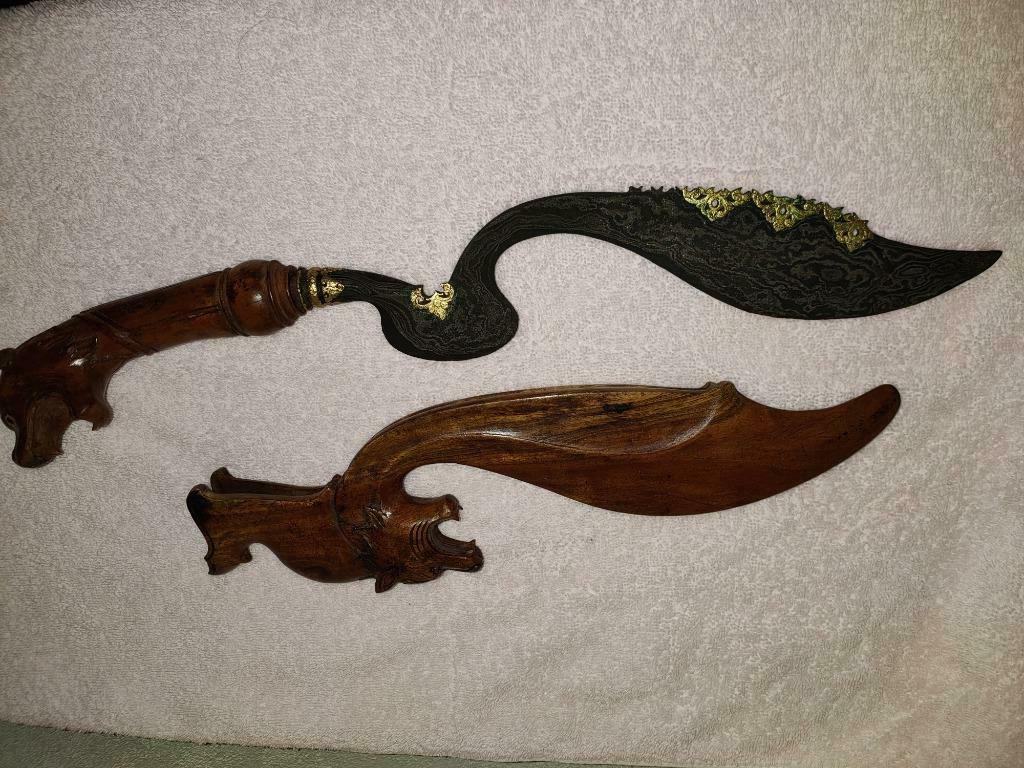

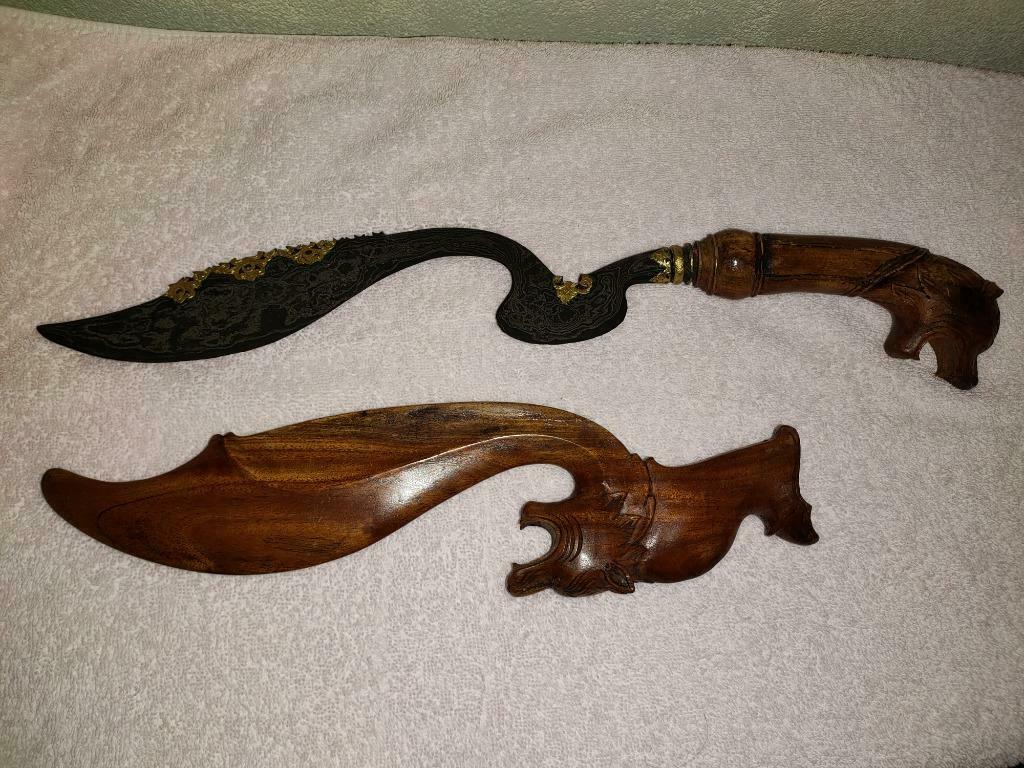

Default KOEDJANG ..... 21st Century
Hullo everybody!
Just to share:
A 21st century Koedjang Tjioeng Mata5.
It is traditionally folded and finished using modern tools.
The pamor is 'coloured'.

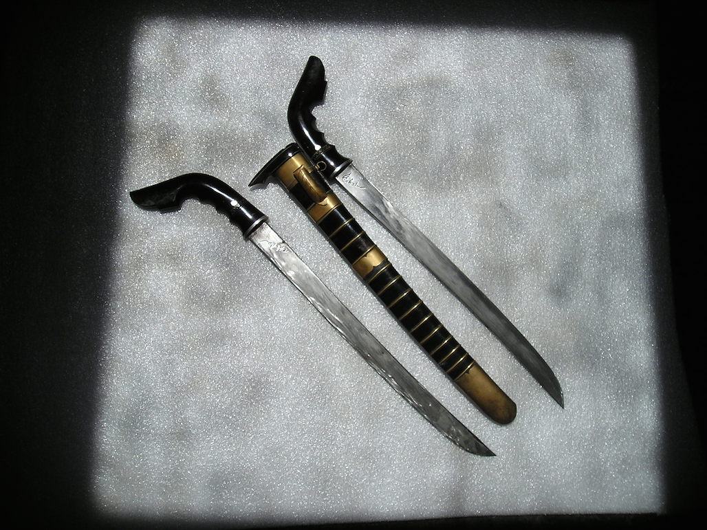

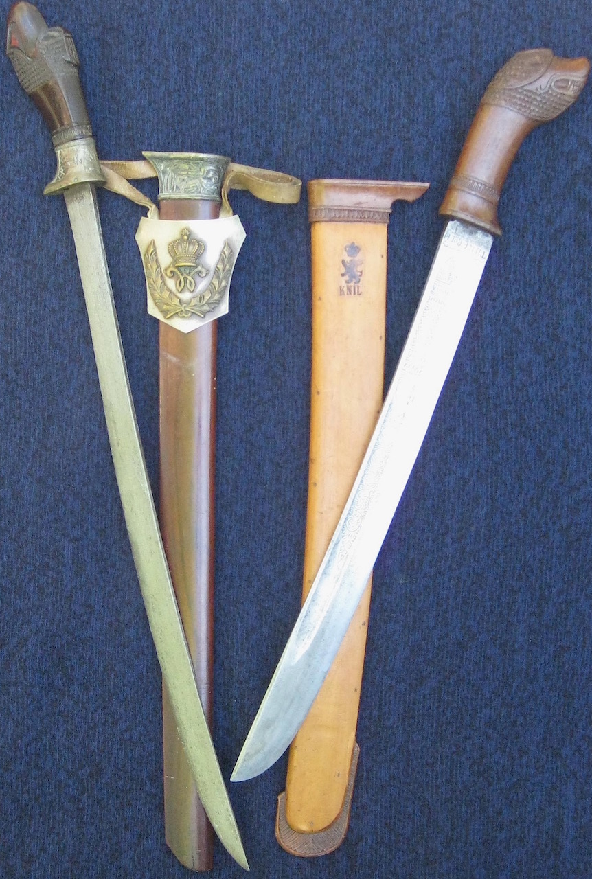

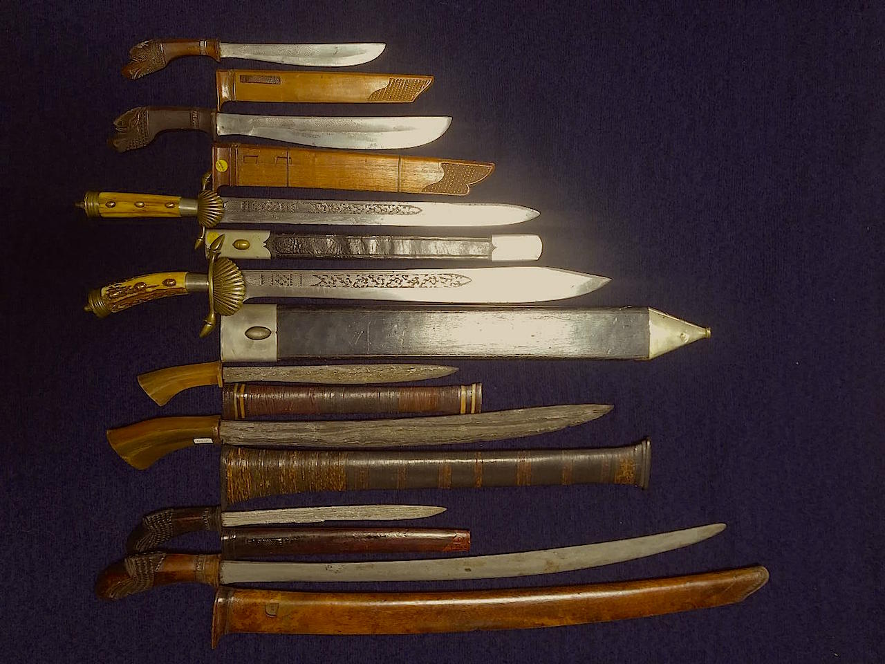

Default Colonial Relics
Hullo again everybody!
Just to share:
Left - pedang/side-arm of the original Korps Marechaussee.
Right - golok/side-arm of KNIL.

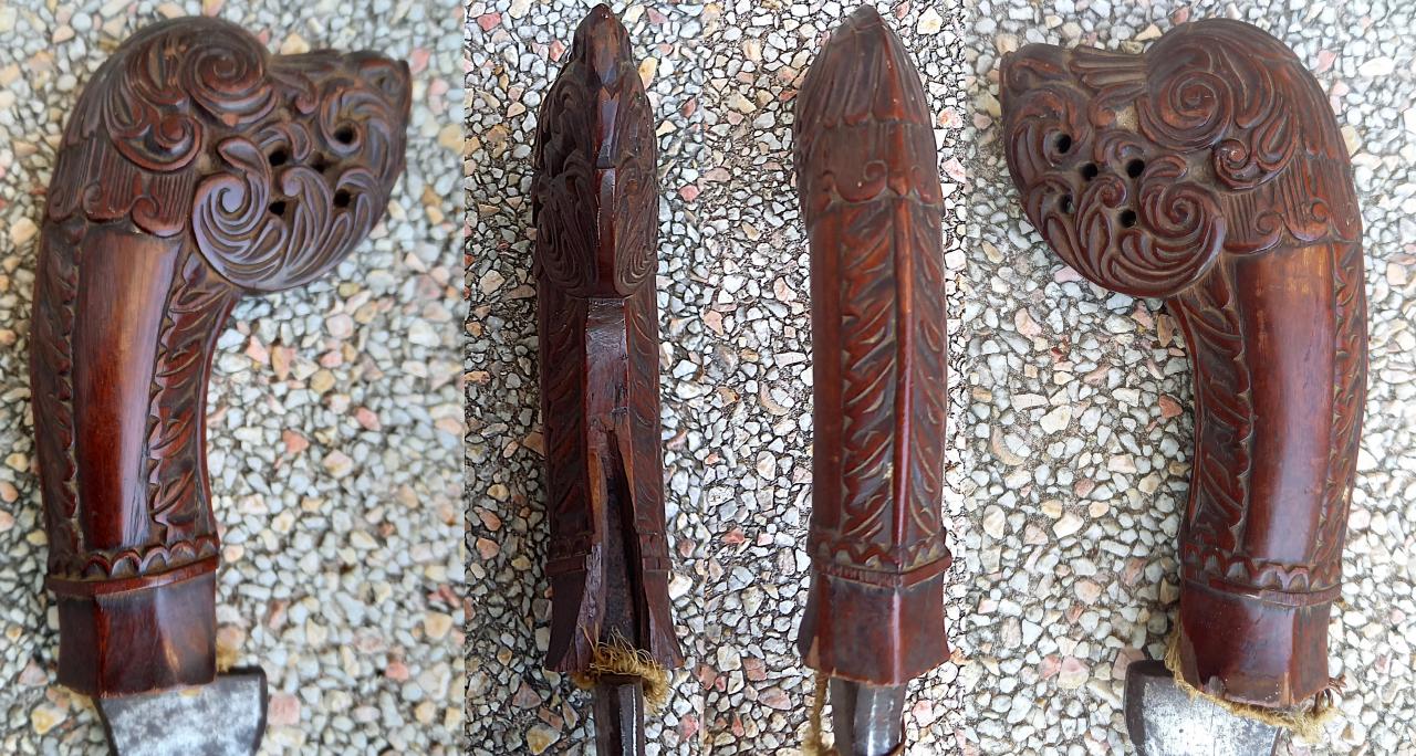

Are these part of your private collection or can they be viewed publicly?
I'm very intrigued by no. 3 - I've not seen this kind of handle before. Might you have other examples?
Also, why do you opt to spell using Dutch orthography? Is this part of the written form of "basa jero" that you've referenced previously?
Old 1st February 2020, 09:50 PM   #6
Amuk Murugul
Amuk Murugul's Avatar
Join Date: Feb 2007
Posts: 484
Originally Posted by jagabuwana
Sampurasun!
Rampes …..
I always try to post examples from my family collection; thus not for ’public viewing'.
I am not sure what you mean.
The handle on '#1/3.’ is just a bajang handle, of which there are several in the collection(it’s only out-of-focus).
‘#3’ is just a staghorn handle.
I choose the spelling system which best suits my needs. It gives uniformity and allows ‘freedom of access and movement’ within the Malajoe archipelago.
Tjag.

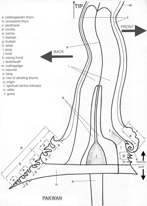

Default Holes in a blade
Hullo all,
I notice a bit of interest in this area.
Here's my contribution w.r.t. Koedjang.
As an example, the assignation of the Koedjang Tjioeng commensurate with the duties and function of the wearer/user (as opposed to the social status of the individual):
Koedjang Tjioeng, 9 Eyelets: Radja (ruler), Brahmesta (religious chief)
Koedjang Tjioeng, 7 Eyelets: Praboe Anom (crown prince), Mantri Dangka (border minister) and Pandita (councellor)
Koedjang Tjioeng, 5 Eyelets: Geurang Seurat (chief minister) Boepati Panangkes (military governor) and Boepati (regent)
Koedjang Tjioeng, 3 Eyelets: Geurang (minister)
Koedjang Tjioeng, 1 Eyelet: Goeroe Tangtoe Agama (advisor on inalienable doctrines)
Note: A person may carry more than one koedjang type. For instance, a general in the confederate court military (Koedjang Djago) may also be a ruler at home (Koedjang Tjioeng, Mata9).
BTW,
While doing this post, I came across a memory aid I prepared for a seminar so people could relate/remember better. (It's got 'Anglicised terms'. For comparison, the 'normal' schematic was posted in this forum somewhere a while back).
Nothing to do with koedjang, but I thought I'd include it here so I won't have to do another post.
It may be of use to someone. Otherwise, it's just garbage.
SCHEMATIC: Doehoeng (/ Kalis / Karis ) with Anglicised terminology.

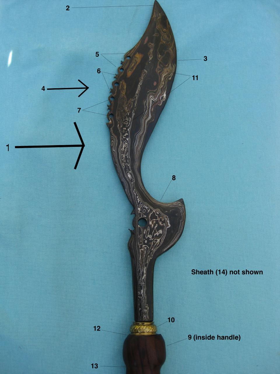

Hullo everybody!
Just thought I'd post a more complete explanation/protocol of the KOEDJANG.
Hope it's not too boring.
KOEDJANG:
The Koedjang is a traditional implement which has become synonymous with Oerang Soenda.
From humble beginnings as a farm tool, the koedjang had evolved to become pretty much what it is today.
There had been developed a pakem (protocol) governing the manufacture and use of the koedjang (similar to that of the doehoeng ).
This protocol virtually restricted the use of the variety of koedjang to the Pangréh Pradja/Prijaji (‘rulers of the realm’/governing bureaucracy), leaving only the basic farming-tool type for the common people.
Koedjang ( see attached diagram )
1. Waroega ( Body/Blade )
2. Tjongo/Papatoek ( Tip/Beak ), for gouging
3. Beuteung ( Stomach/Front Edge ), sharp edge for cutting/slicing
4. Tonggong ( Back/Back Edge ), sharp edge for cutting/slicing
5. Eloek ( Arc )
6. Siih/Tjoetjoek ( Spur/Thorn ), for ripping/tearing
7. Mata ( Eye/Eyelet ), filled with precious metal
8. Tadah ( Check ), for blocking/disarming
9. Paksi/Boentoet/Paseuk ( Tang )
10. Seloet (Metal Collar/Ring ), for firm handling
11. Pamor ( Damascene ), for poison retention
12. Tjombong ( Hole ), recess in handle to fit tang
13. Landean/Perah ( Handle )
14. Kopak/Kowak/Sarangka/Saroeng ( Sheath )
Basically, the Koedjang was classified according to shape and function.
According to shape (of the blade):
Tjioeng ( Thrush )
Koentoel ( Egret )
Bangkong ( Frog )
Naga ( Serpent )
Pamangkas ( Cutter/Clipper, a farming tool )
Bikang ( Female ):
Tjioeng
Koentoel
Koedi ( for females )
According to function:
Poesaka (sacred heirloom or symbol of potency)
Pakarang (implement for defence)
Pangarak (lance/polearm, for special auspicious ceremonies)
Pamangkas (chopping/cutting/slashing implement for farming)
The protocol also included the assignation of the Koedjang type commensurate with the duties and function of the wearer/user (as opposed to the social status of the individual):
Koedjang Tjioeng, 9 Eyelets: Radja (ruler), Brahmesta (high-priest)
Koedjang Tjioeng, 7 Eyelets: Praboe Anom (crown prince), Mantri Dangka (minister for states/territories), Pandita (counsellor)
Koedjang Tjioeng, 5 Eyelets: Boepati Panangkes (chief of general business), Boepati Pakwan (Pakwan regent), Boepati Loear (regent for area external to Pakwan/regional-ruler), Geurang Poeoen (leader of village-chiefs), Geurang Seurat (secretary)
Koedjang Tjioeng, 3 Eyelets: Geurang (group/community leader), Poeoen (village-chief)
Koedjang Tjioeng, 1 Eyelet: Goeroe Tangtoe Agama (expert/educator/advisor on inalienable doctrines)
Koedjang Djago: military personnel: Balapati/RanggaMantri (paramount war-chief), Loeloegoe/Rangga (war-chief), Sambilan (divisional-chief)
Koedjang Koentoel: Patih (chief executive): poeri (fortifications), taman (parks/gardens), tangtoe (sacred inalienables), djaba (external), paladjoe (development); Mantri (minister): madjeuti (fisheries), paséban (tributes/taxes), lajar (transport), karang (lands), djero (interior)
Koedjang Bangkong: Goeroe (expert/educator/advisor): sekar (flora), tangtoe (sacred inalienables), alas (forestry), tjoetjoek (brambles/weeds)
Koedjang Naga: Kandoeroe/PangréhPradja (ruler’s service), Djaro (district chief): awara (security), tangtoe (sacred inalienables), gambangan (music/culture)
Koedjang Badak:
- military officers: Pangwereg (cavalry/elephants), Pamatang (lancers), Palongok-panengen-pangiwa (scouts), Palajang (flying force), Pangwelah,(strategy). Bareusan (infantry unit): pradjoerit (general infantry), pratoeloep (blowpipes), pangawin (bodyguards), sarawarsa (archers).
- Kokolot (elders)
Koedjang Pamangkas: common folk
Koedjang Bikang and Koedi: females of the nobility and those with definite functions e.g. Dijah Poetri (Princess), court ladies: Amboe Soekla (lady chaperone), Amboe Geurang (governess), Goeroe Aés (female physician), Dajang Kapoetren (ladies-in-waiting), Soekla Majang (hand-maiden)
Koedjang Boeta ( Blind ): Koedjang with no Eyelets.
Koedjang Bikang: consisted of two basic shapes, Tjioeng and Koentoel, chosen for their slenderness. They were only half the size of the normal Koedjang.
Eyelets: Symbolises the mandala/levels of the religion of the realm (viz. kasoengka, parmana, karma, rasa, seba, soeda, djati, samar, agoeng; 9 levels).
Damascene: Soelangkar/Lines along blade and Toetoel/Spots
Koedjang as a status symbol:
The status of the wearer is determined by the number of eyelets, the damascene and its material.
Koedjang worn by aristocratic ladies of the Pakwan court usually had five eyelets with soelangkar damascene of selected yellow metal alloy (an mixture of iron, tin, lead, silver, zinc, copper and gold). Other females wore koedjang with three eyelets or less, with toetoel damascene of chosen metal.

Default Golok Kembar TjiBatoe (twin-goloks)
Hullo everybody!
My no.1 son, who has practised martial arts since he was 4, took up the golok at the start of the pandemic. He thinks he is now so proficient at it that he wants to graduate to twin-goloks (both normal and long versions ). He has asked for mine.
As I am unlikely to see them again (he lives too far away), I thought I'd post these rather bad pictures as the only record.
Old 7th December 2021, 04:34 AM   #16
Amuk Murugul
Join Date: Feb 2007
Posts: 484
Default PASANGAN (pairs)
Hullo everybody!
Another snap op.
From top-to-bottom: Bedog (chopper)TJIKEROEH; Pedang Moro (deer-/tiger-hunting sword)TJIKEROEH; Pedang Abet (sabre)PARAHIYANGAN; Pedang Abet (sabre)TJAROEBAN.
Enjoy!

Default Poesaka Tjatoerangga R. Ranggana Bratakoesoema
Hullo everybody!
Just an update.
An ensemble we put together for one of his offspring.
All items have been previously covered.
I thought of posting it here for posterity.
Enjoy!
Old 11th May 2025, 11:14 AM   #18
Athanase
Athanase's Avatar
Join Date: Mar 2016
Location: Paris (France)
Posts: 432
Hello Amuk Murugul,
Do you know if this strange "Golok" are a special function or name ?
