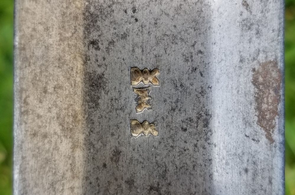

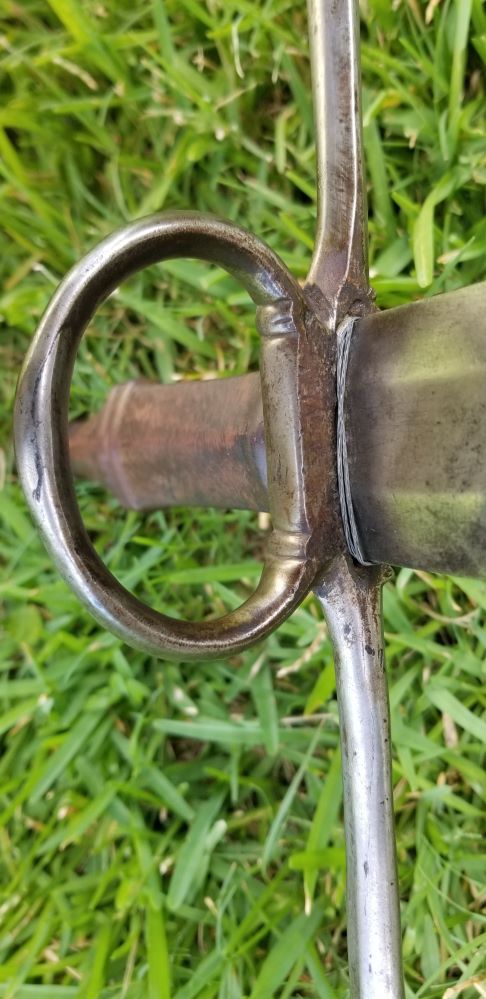

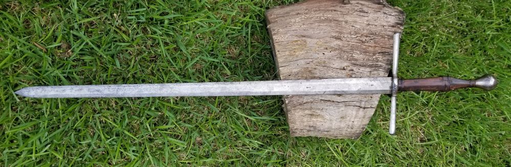

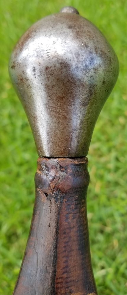

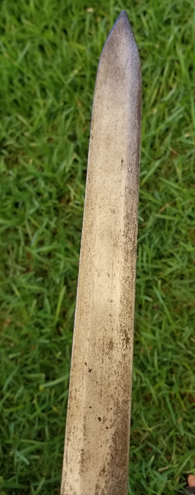

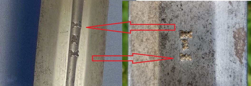

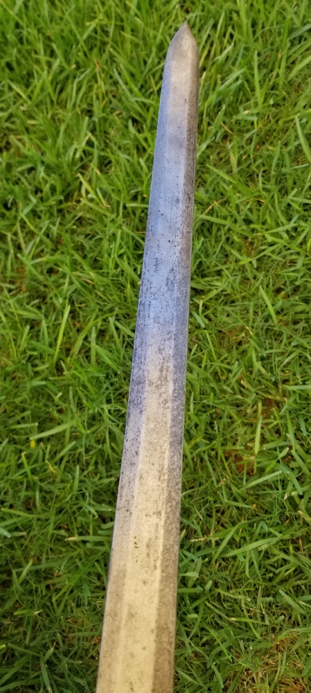

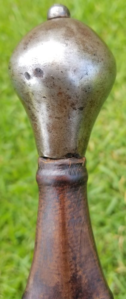

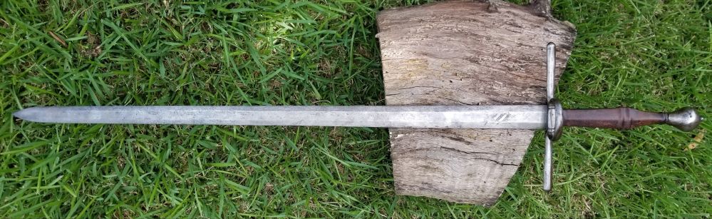

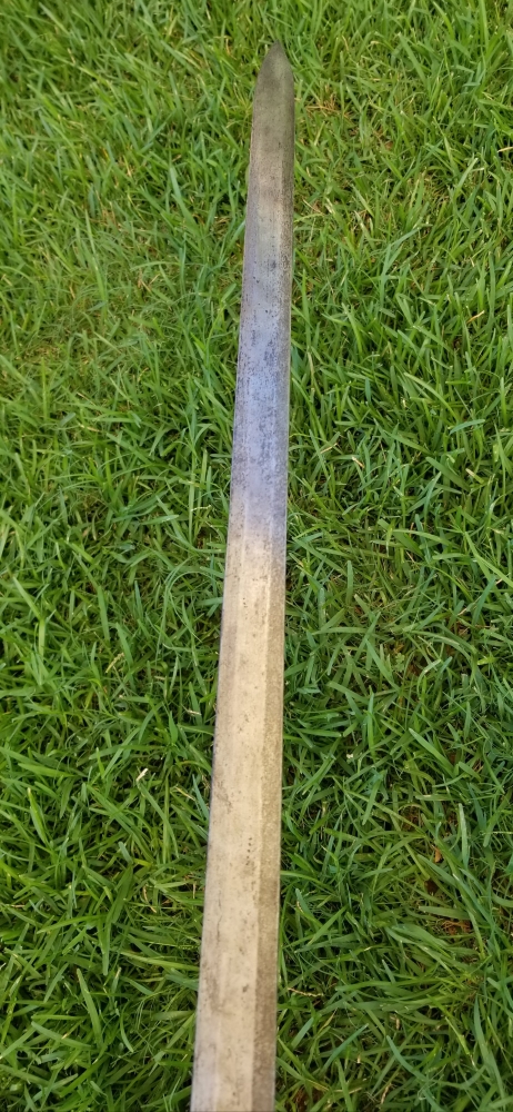

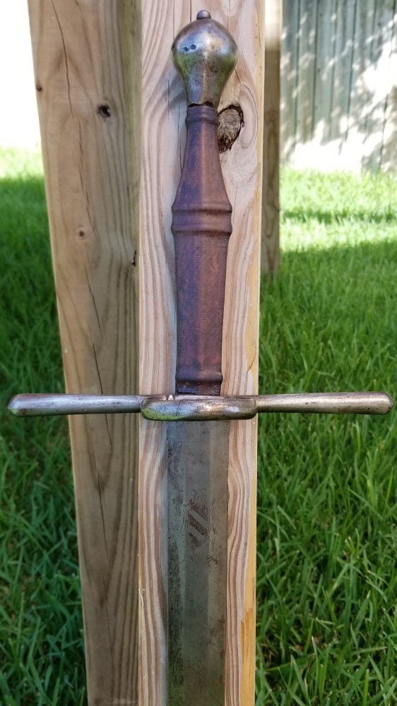

Recently purchased from auction. Got it in today and love it. Reported to be from the William Fagan collection. 130cm total length. 4.5cm wide at the base of the blade. Fairly massive yet light weight for it's size. Blade somewhat flexible and still sharp. Does anyone recognize the crest or three stamps in the blade? Any idea as to the date of the style? Other similar examples with hexagonal blades? It reminds me of some two-hander blades. Could the grip be original? Any comments are welcome.

Hi Casey ,
let me first congratulate you with this magnificent hand and a half sword !
This is one of the finest examples I have seen in years , these are rare and yours is in very good condition and with a wonderful homogeneous patina.
Everything is exactly how it should be, as you noticed it does not feel to heavy , swords for the field should feel well balanced and not heavy.
By that I mean one should be able to take them in your hands and wield them and it should feel comfortable doing so, no need to lean back to counterbalance the weight etc, of course with exception of some bearing swords , these can be heavier.
About the flexible blade , I found most of this wide type blades are flexible and for battle they should be, again the big bearing sword are less flexible.

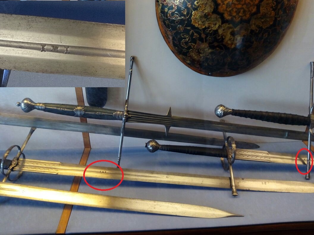

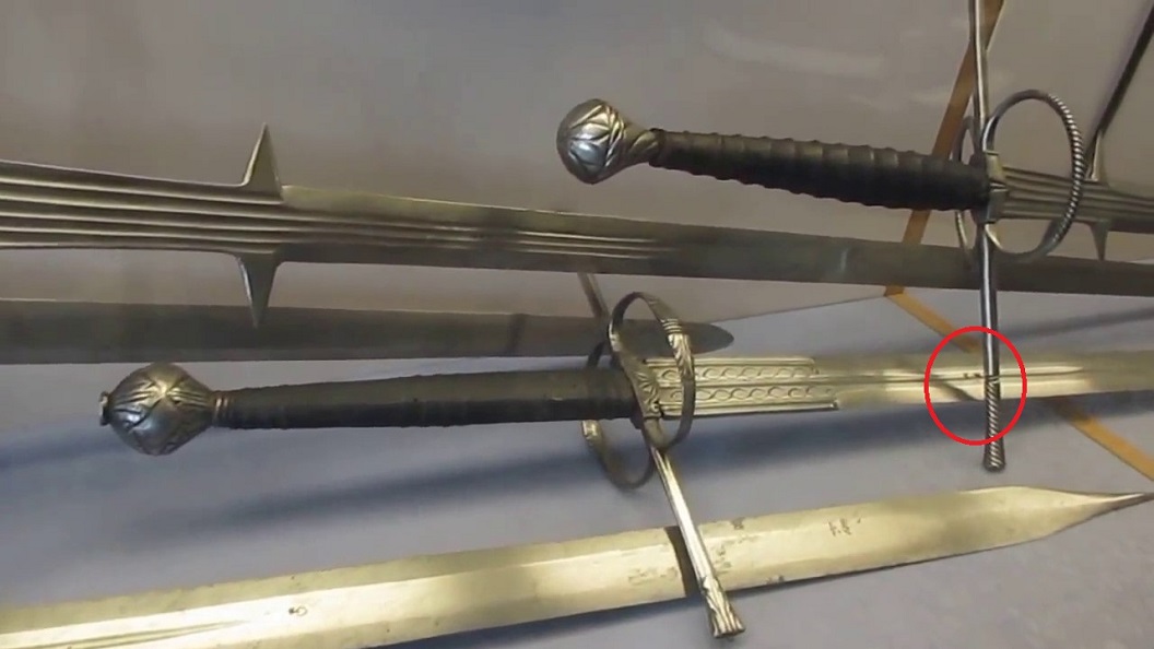

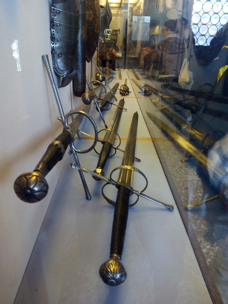

There are a few two handed swords in the Palace of the Doge in Venice with exactly the same blade marks and the blades have similar geometry , as you can see on the pictures.
The blade marks can appear on blades going 15th C until early 17th C , however I would say your sword is German mid 16th century.

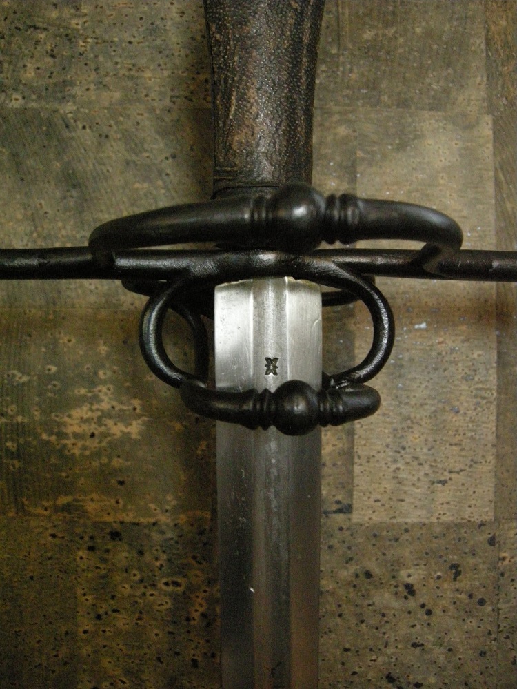

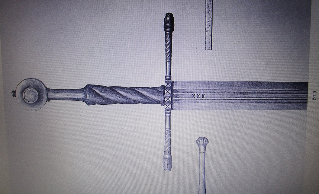

And a late gothic hand and a half sword circa 1500 with similar markings, in auction at Fischer almost 100 years ago , 1927.
And on a German hand and a half sword last quarter of the 16th C.

Thanks for all the info Dirk! I see some of the blades you posted also contain the eyelash marks which we know to be Italian. It seems the marks on my blade are more common than a simple smith mark. Sure wish we knew the meaning but it is probably lost to time.

well according to Staffan Kinman in the book "European makers of edged weapons , their marks" the marks are Northern Italy early 16th century.

It seems to me that the marks are slightly different; one is symmetric, the other is not. The catalogue from Sammlung Kuppermayr states that the mark is from the Northern Italian city of Turin.

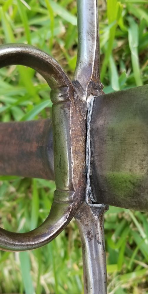

Is it normal for the cross guard to be so plain? The other examples posted have some decorations done at the terminals etc.

yes it is normal to have no decoration on the guard and or pommel, the other examples are even more exeptional swords.
More decoration cost more money and these things were very costly even in those day's. Blade marks don't have to be perfectly symmetrical, variations will occur depending on how worn the punch was and if the punch and the hammer were perfectly vertical when the marks were placed.

Link to previous post on Marca a Mosca mark: http://www.vikingsword.com/vb/showth...ighlight=mosca
To me the mark on the sword in post #1 looks different, but it could simply be a variation of this twig mark. All three stamps look different as does the example in the Kuppermayr catalogue.

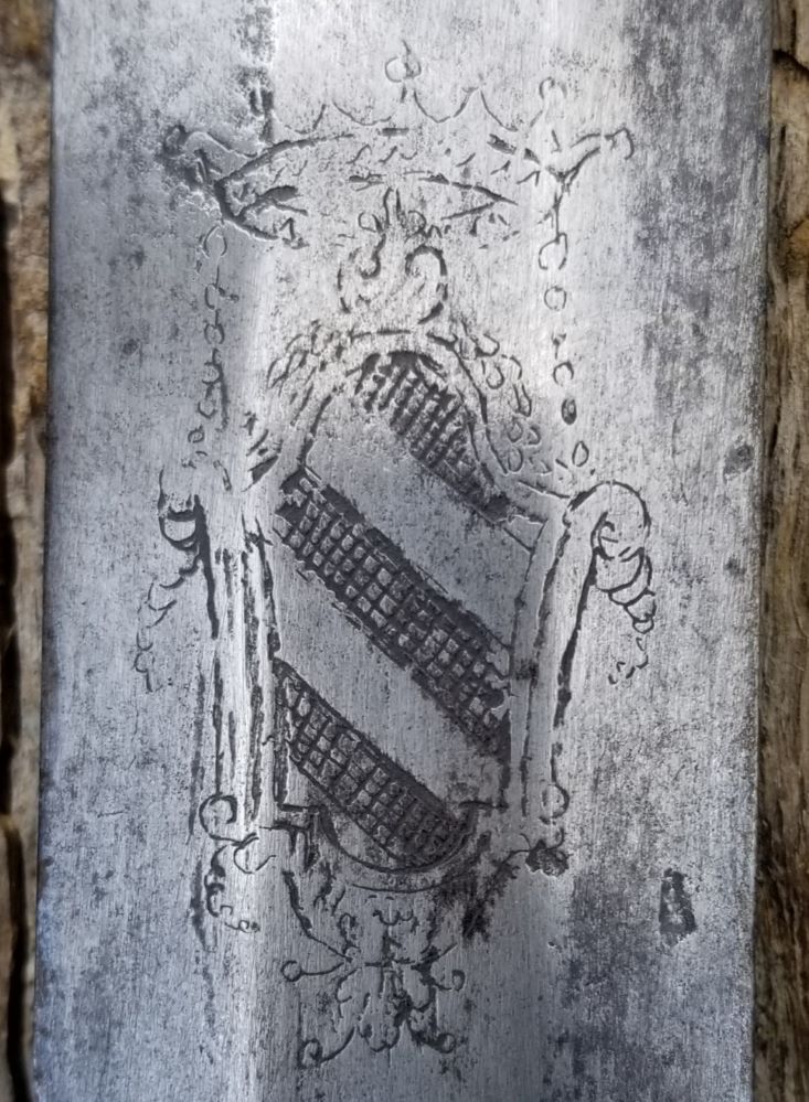

I have a small, privetly printed, booklet in Danish, saying thet the blank parts are meant to be silver and the crossed parts are meant to be black.
I am not a specislist when it comes to coat of arms, but maybe this can help a bit.

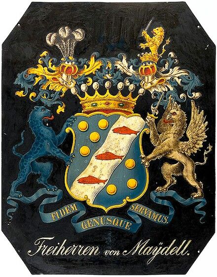

I’m no expert on heraldry but the attached seems to suggest that the coat of arms is that of a count (crown with pearls at the peaks). The shield itself, or rather its embellishments, looks somewhat Italian in shape?
Thanks for the info. It looks like mine has 7 points so that would coincide with a Baron or Freiherr.
A google images search turns up lots of examples but nothing too close.

Try to find a forum where they discuss coat of arms. They should be able to help you further - good luck.

Maydell is the name of a Baltic German belonging to Uradel gender, which was several centuries in Estonia and there was one of the notorious families. In documents and texts of the first centuries, the surname is sometimes given in the spelling Maydel or Maidel.

I believe the coat of arms is more on a style of the middle to late XVIIIth century. It does not make much sense in a battle sword in use, and possibly was added much later, when the sword got other functions, pageants and such.

I haven't seen it mentioned yet, but the three marks on the blade are ofthen associated with swordsmiths from Belluno, in the Veneto region of Italy.
