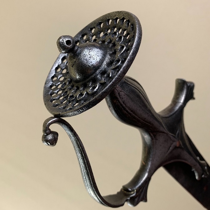

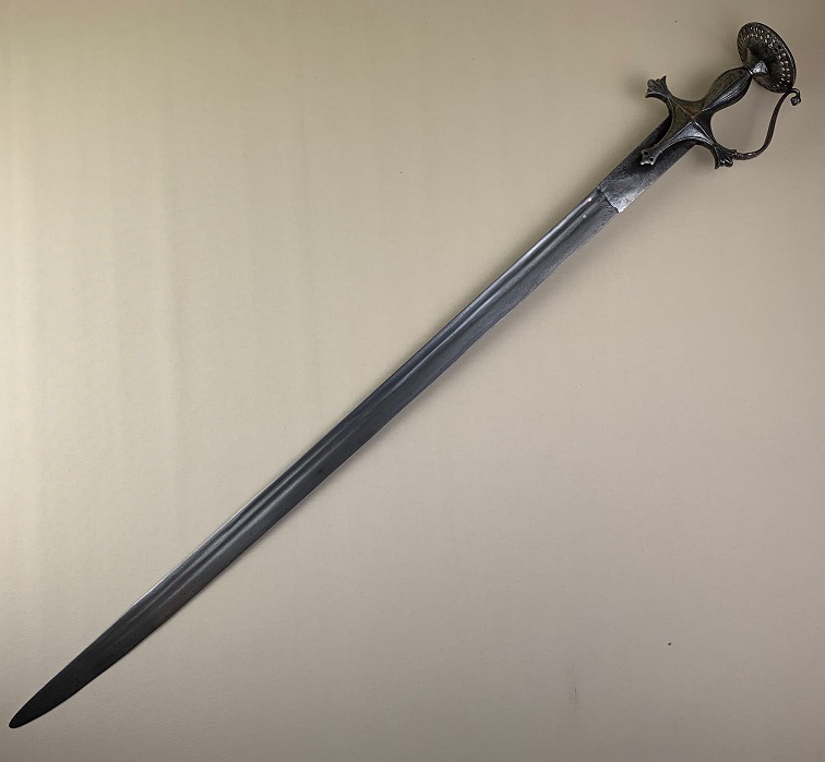

Default Indian Tulwar with Rare Hand Guard
Here I have a Indian Tulwar with a hand guard feature I have not seen often. It has a great balance to it. I was surprised.
Length is 92 cms
Blade to hilt is 79.5 cms
Pommel disk is 6 cms across. Hilt being 17 cms from the tip of the pommel to the tip of the langet.
Good distal taper. Back edge of spine from tip for around 23 cms is as sharp as blade. Tip rounded with age.
Thanks

I like these guards very much.
Elgood in his paper about swords from S. India shows several of those and attributes them to Deccan.
One should always remember however lthat blades and handles very, very often came from different areas.
As to the rounded tip: it may not be from age; Indian swordplay practically did not employ stabbing, a lot of Indian swords had their tips not sharp, but rounded just like yours.

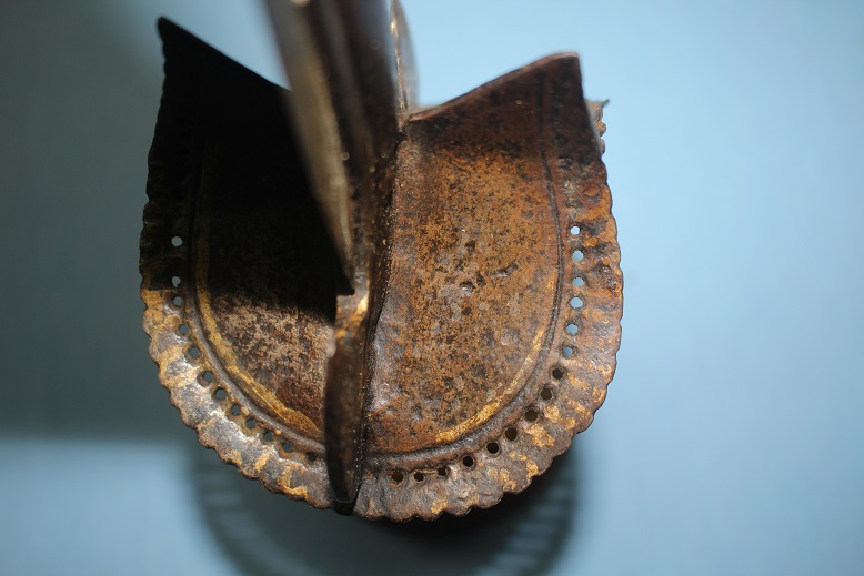

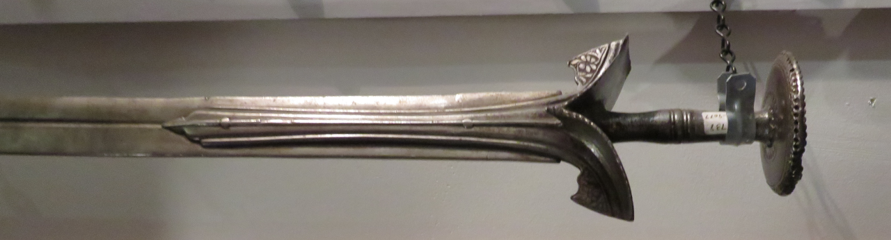

As Kubur has noted, it is seen on 'chilanum' as a 'half guard' as well (illustration added).
I agree with you that the European influence would appear unlikely as this type of guard did not appear until late 18th century, and then in limited instances such as the court swords I mentioned.
In Elgood's article on the Deccan, a khanda of late 16th c. with similar decorative motif as well as a tegha of late 17th, suggest that the style existed there well prior to the European forms I suggested.
It seems the chilanum form, according to the Bijapur manuscript of the 'Nujum al Alam/ (1570) existed at least that early, but of course the frequency of this style decoration or the half guard is unclear.
In the example of chilanum illustrated, the holes along the scalloped edge can be seen also. It appears that as often the case in Indian arms either hilt styles or perhaps actual hilts were often transferred to full size sword blades.
In this case, the 'half guard' element seems amalgamated with a tulwar hilt, primarily a Mughal weapon style.

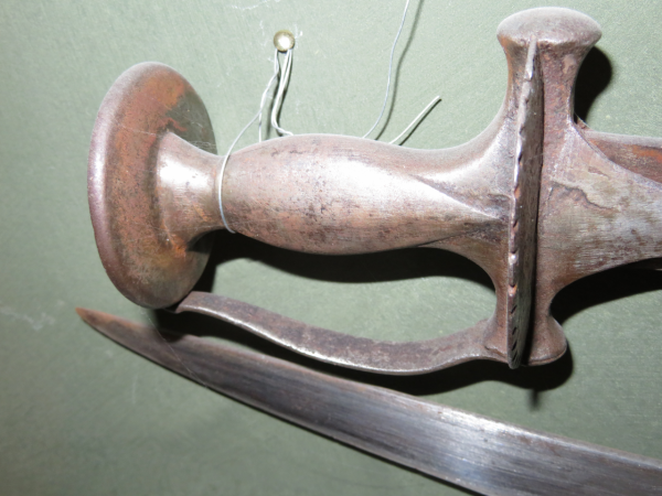

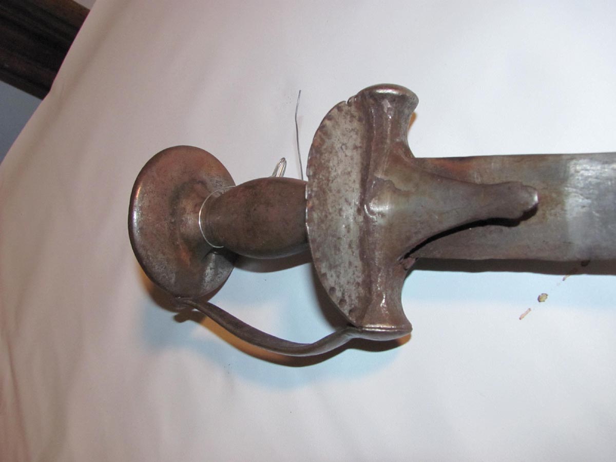

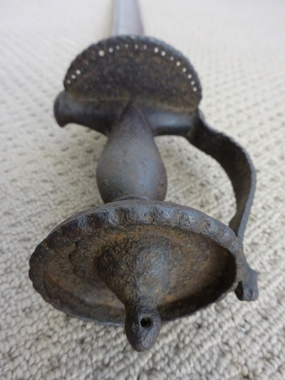

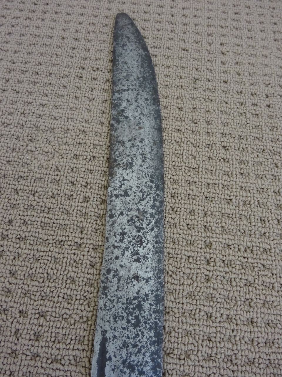

I have uploaded some more images.

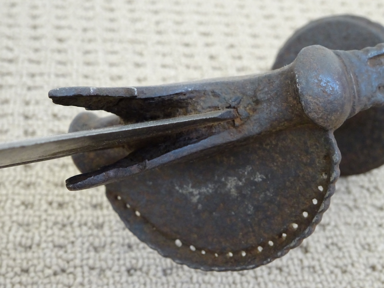

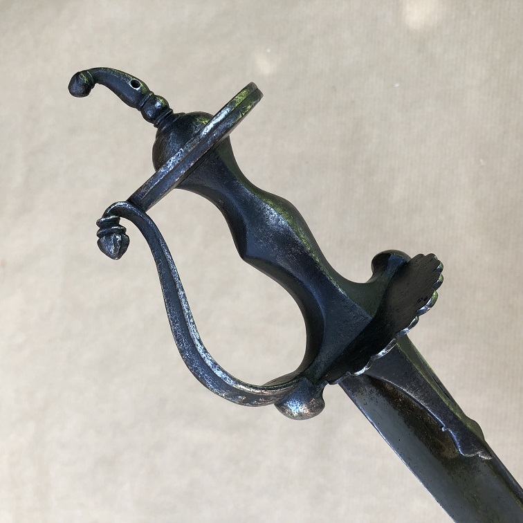

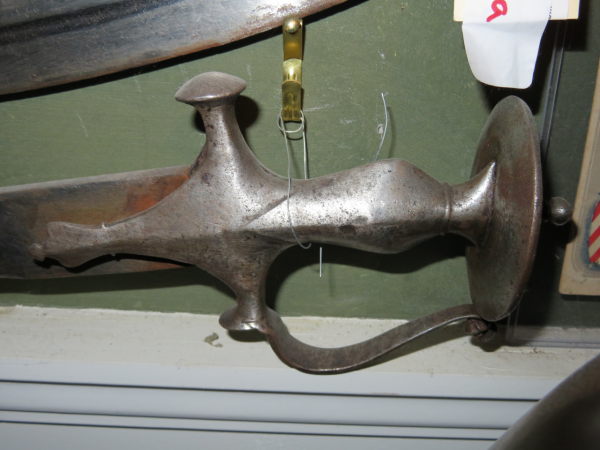

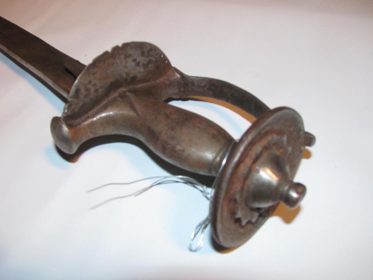

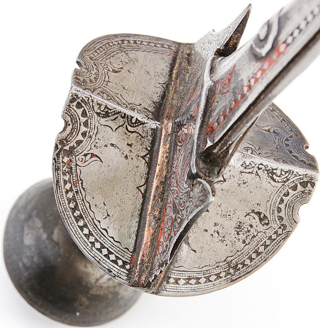

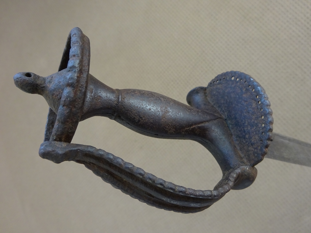

Regarding guard additions and perforations I share two I've had with those features (hopefully I can attach the photos correctly):

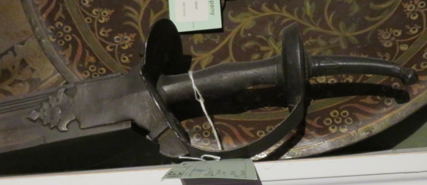

In the photos you have shown Edward, the first two are what are regarded as 'ancient' forms of 'khanda' which correspond to forms seen in iconographic sources, and existed in a spectrum of similar forms over many centuries.
The 'winged' guard as described was a commonly known feature.
In the next photo (left) is the tulwar of discussion, which has the raised half guard and seems plausibly influenced by such features found on some 'chilanum' daggers, a knife typically regarded as Deccani. This broad area of influence covers roughly the entire central band of the Subcontinent. These broad regions are most dynamic through diversity of cultures, religious and tribal, as well as the incursion of foreign trade and colonial factions.
Next (right) is the 'Hindu basket hilt' which is essentially a khanda which derives from the ancient form, but is believed to have the wide guard extended to complete a hand guard up to the pommel. This is generally held to have evolved from European influence post 1600 and with Marathas, filtering into Rajput and Sikh use as well.
Next is another of these. Then another of the 'ancient' indiginous khanda forms.
The next two are tulwars (Indo Persian hilt) the one on the left is Mughal and open hilt, which I personally regard as 'court' type weapons, usually highly decorated and with no extended guarded hilt features. Naturally there is nothing to preclude actual combat use or other........but Rajput and Sikh used usually hand guard forms.
These are seen on the right photo.

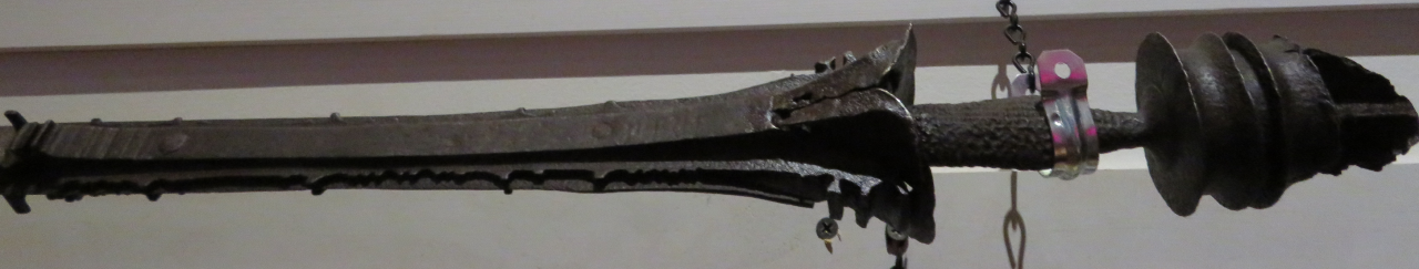

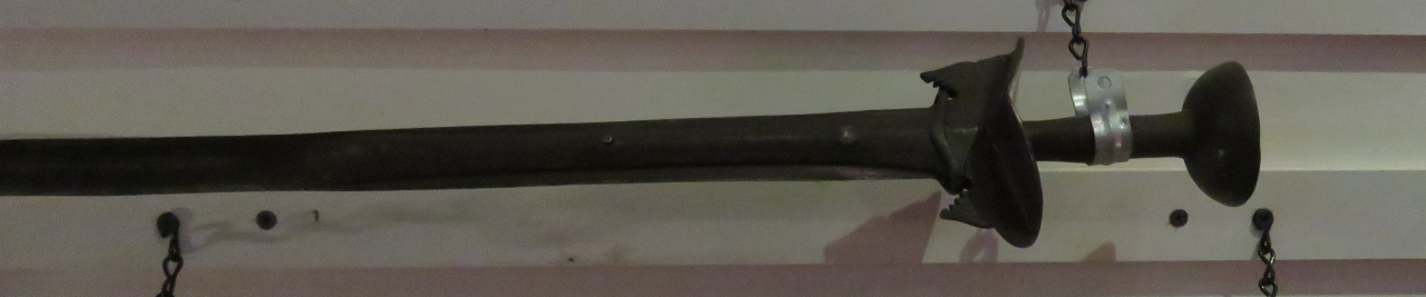

Some similarity/influence in the pierced and beaded guard type on this 17th C Khanda.
Early Hindu Khanda
17th century
Patissa, India
Very rare sword type
Pierced guard
C - Swords and Antique Weapons - Gavin Nugent.

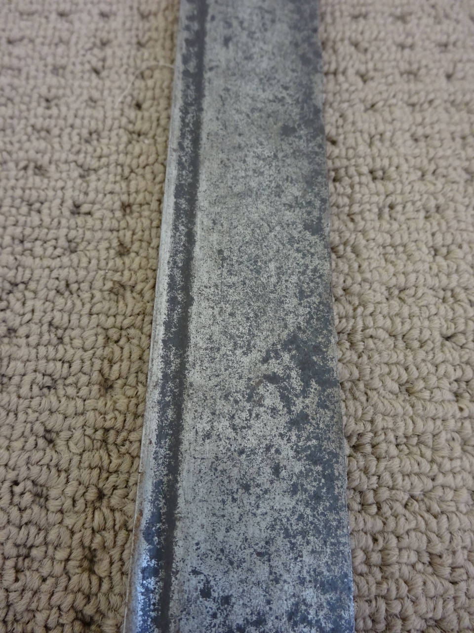

Just a side note, that could very well be a patterned blade, welded or better. Hilts such as these tended to be favoured by the upper classes and tended to have better blades than most. I have a very similar one with a copper dome similar to that of a pulwar that sits atop its semi-basket hilt. Would interest me to know why that is even there, I'll post pictures...eventually. First post, so still getting used to the etiquette

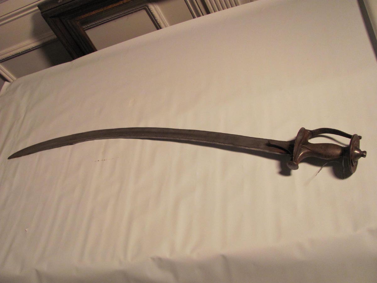

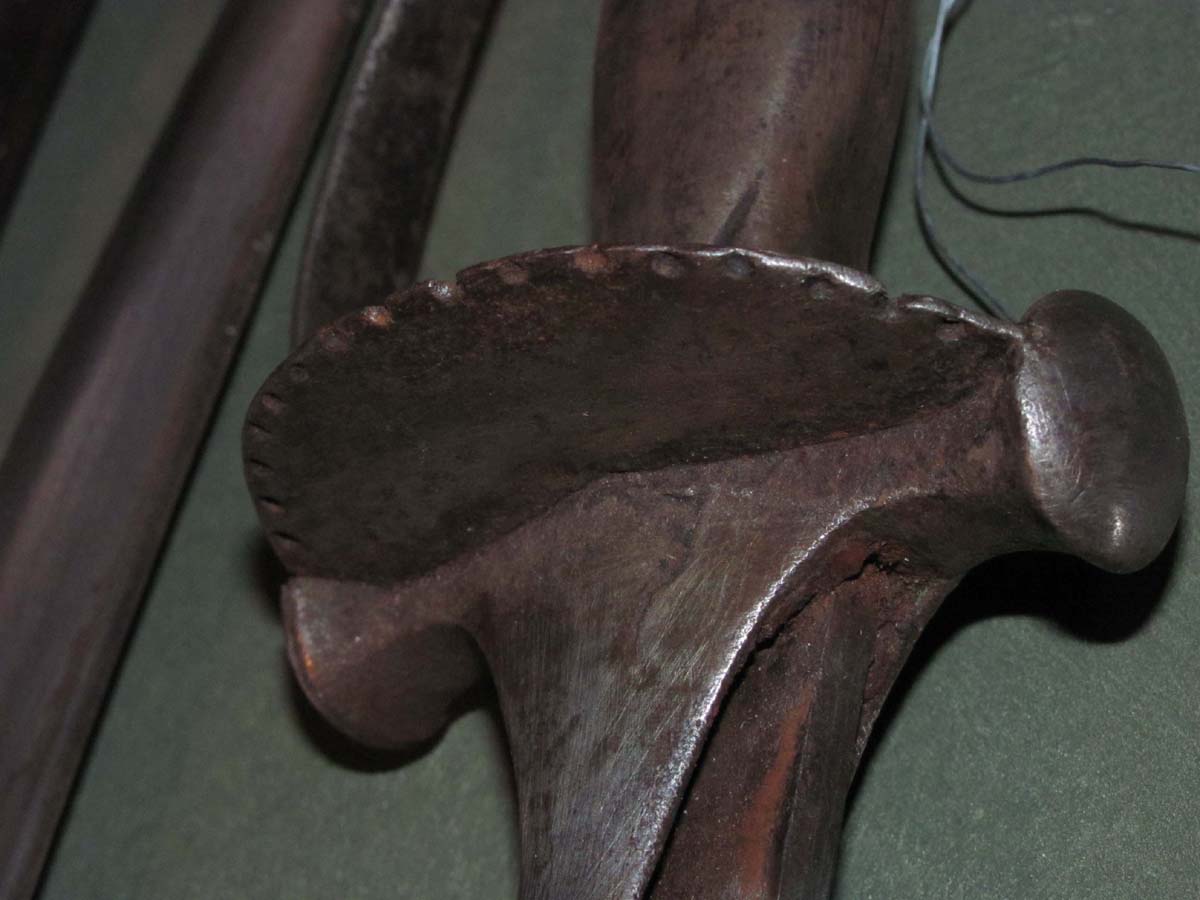

Here is another Patissa. Western India. Probably late 15th century. Total length 100 cm, blade length 89 cm. See cat. pp. 350-353.

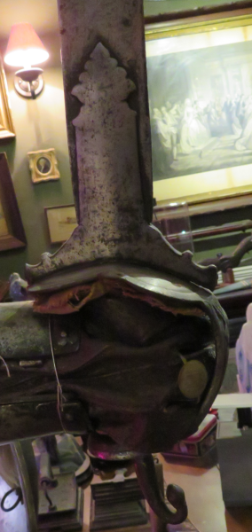

Here is another picture.
