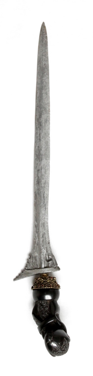

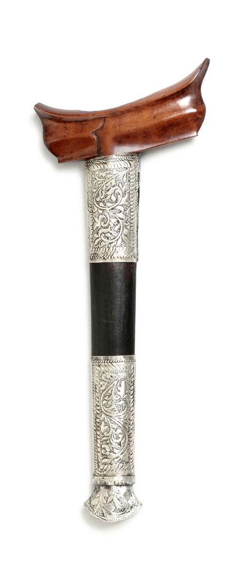

From the box that I had bought: keris nr 3
(keris nr 1: http://www.vikingsword.com/vb/showthread.php?t=24660 )
(keris 2: http://www.vikingsword.com/vb/showthread.php?t=24843 )
A keris Minangkabau with a ganja iras blade 33,5cm/13.18 inch

Nice looking keris. I especially like the blade.

Indeed a lovely blade and nice looking scabbard but the gandar could have been a replacement. Shape and colour is not what I expect to see of a Minang keris.

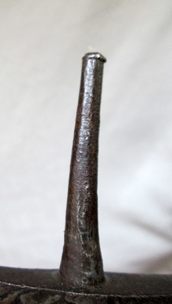

Tip end of the peksi is odd (lloks like a nail).

IMO only the gambar/ atasan (top of the wrongko) is Minang, the hilt & blade (?) look Bugis and the gandar is probably not original as already said by Paul (no buntut at the tip). However this is a nice kris indeed.

The nice blade might be too tall for this type of wronko.
The hilt seems to be too tall for Sulawesi - this style is Sumatran, Straits, or west coast Melayu.
The blade could be from Palembang (unless collected early, the blade surface seems more consistent with Palembang as well as the bold pamor).

Thanks for the comment!
And yes the gandar looks like a replacement, under the copper ring there is a difference in thickness and that is filled up again and concealed by the copper ring.
I also think it's beautiful blade (IMHO): it seems there is an animal visible on one side of the sor-soran?

Yes I agree, the blade is more probably from South Sumatra than Bugis, but not Minang anyway.

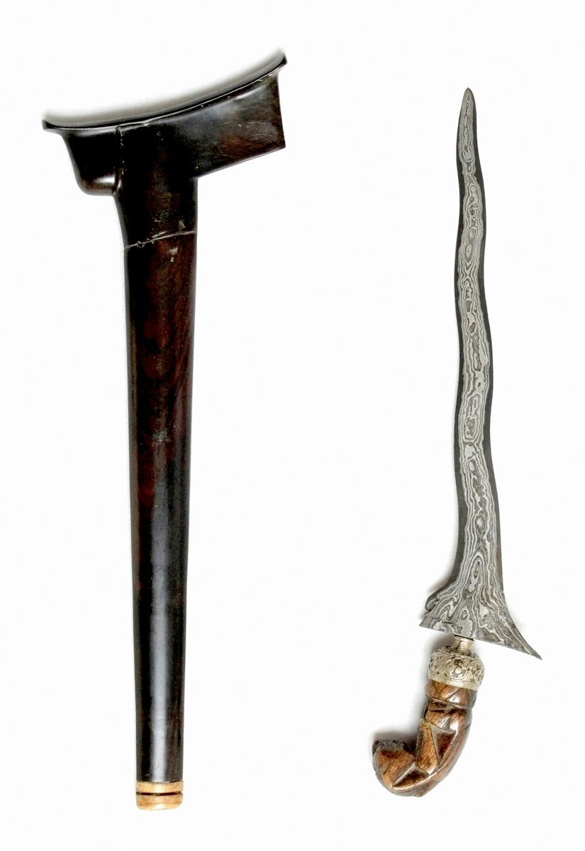

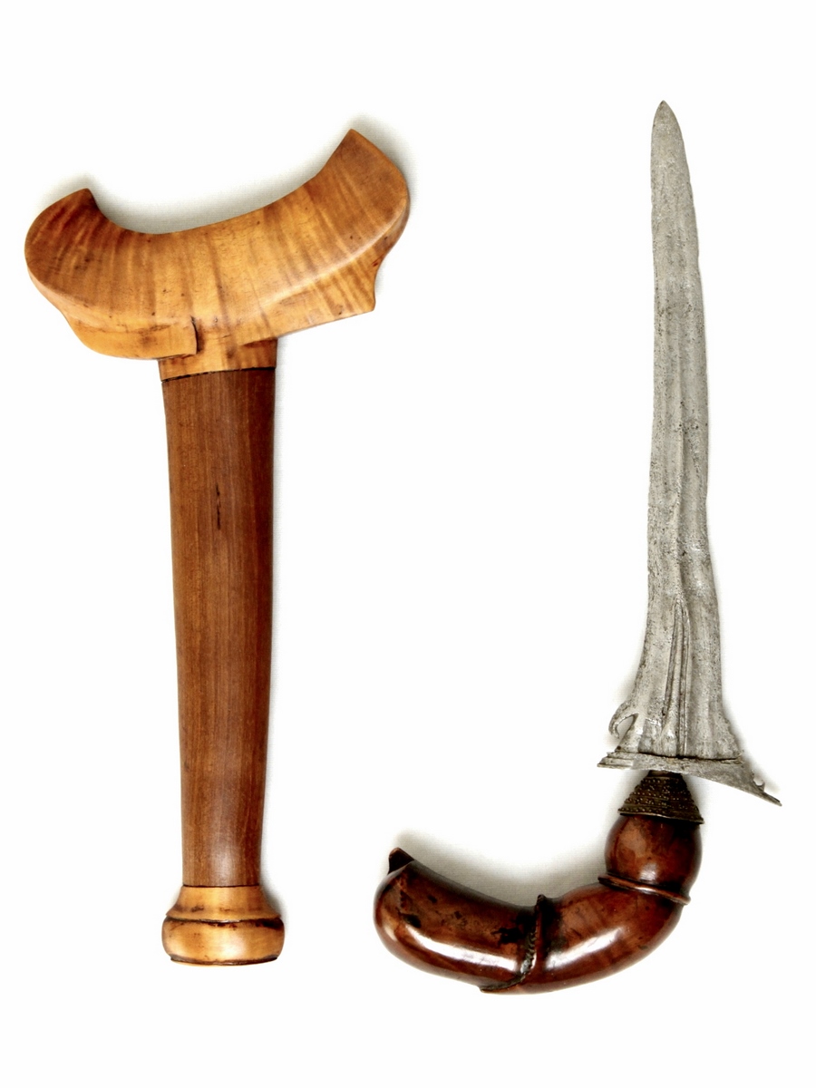

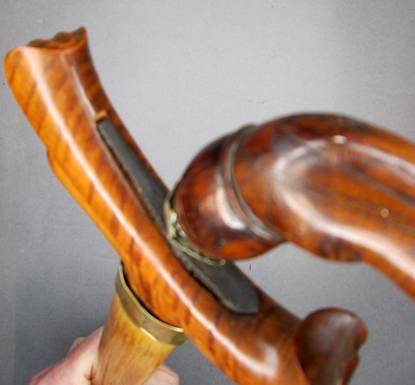

Hi David,
I am not totally dismissing that the blade could be from Minang origin but I find it very unlikely: As you say many Minang krisses are fitted with either a straight bahari blade (the origin of which being generally assigned to the Riau province), or a shorter rustic style with 3 luks. Both types of blades have no clearly visible pamor pattern.
I have attached pics of 2 typical specimens of these blades and I have several similar ones.
The blade from Sirek is totally different as it is longer and has a clear pamor pattern and an elegant dapur with ganja iras which is quite common in South Sumatra.

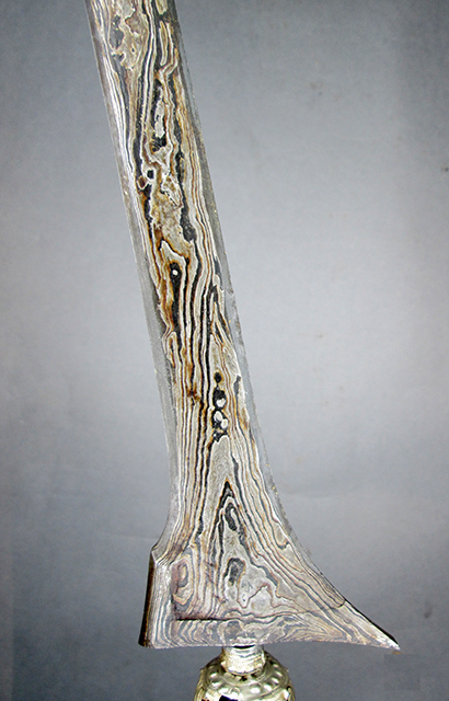

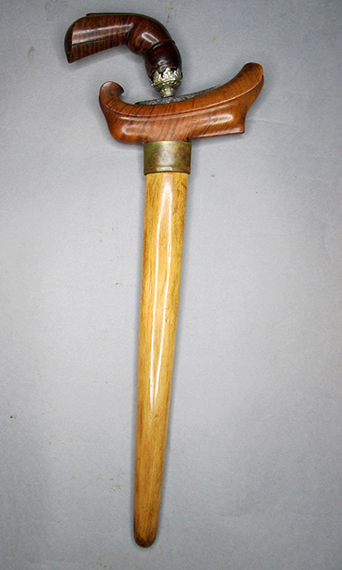

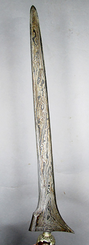

Posts: 1,740

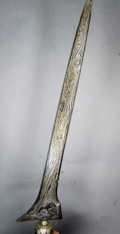

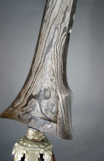

Please see a luk blade attributed to South Sumatra with a fine pamor pattern as the one from Sirek and a ganja iras also.
