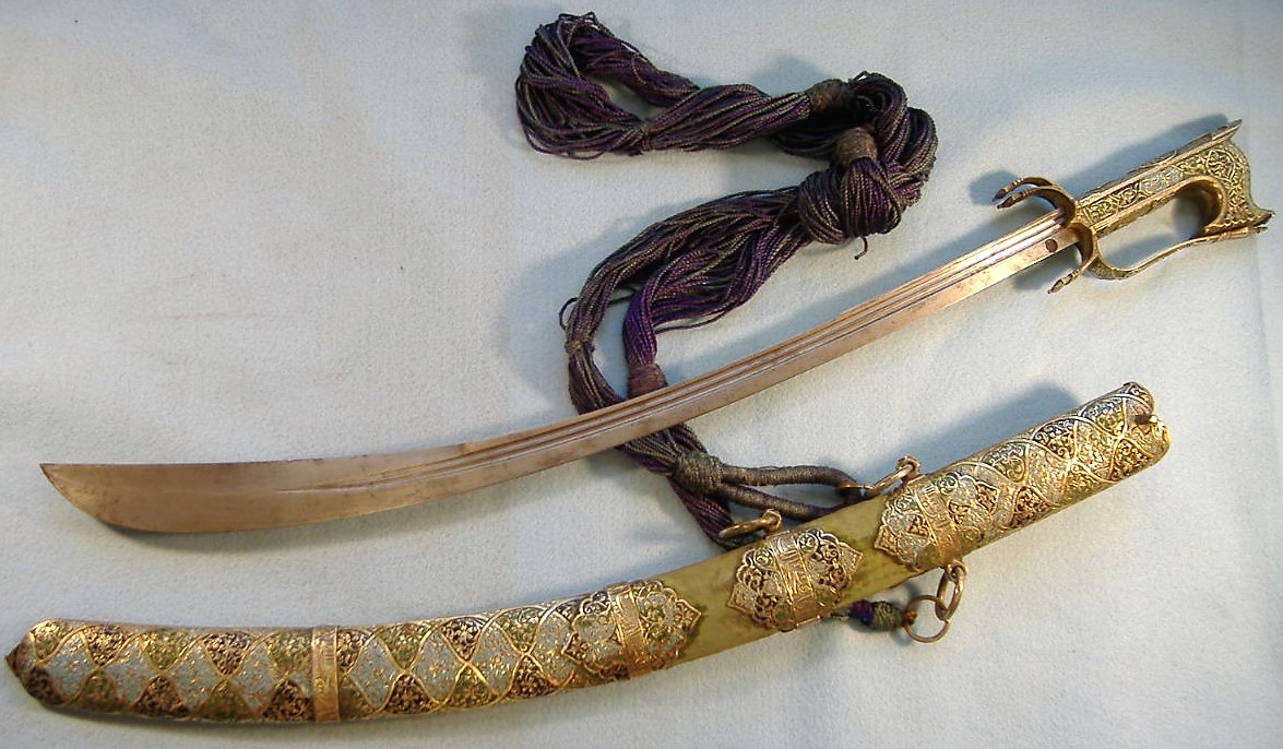

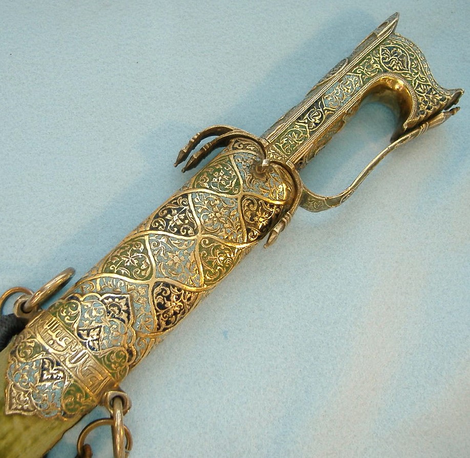

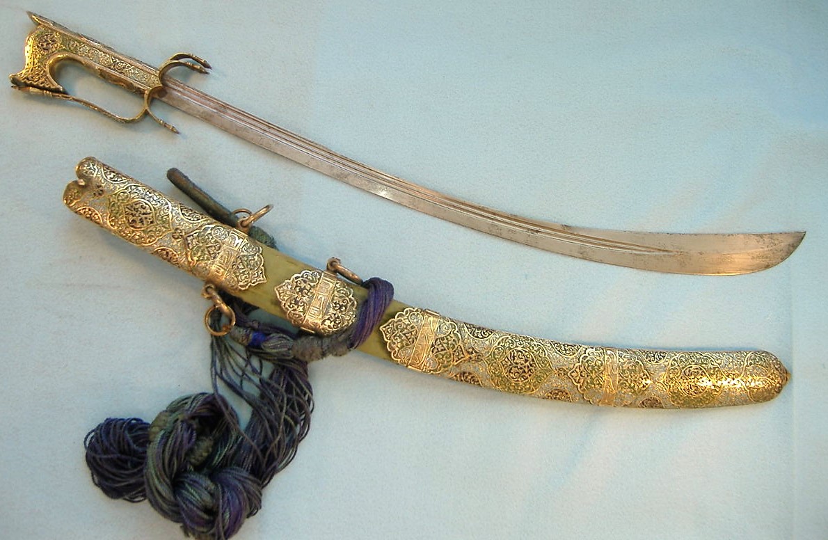

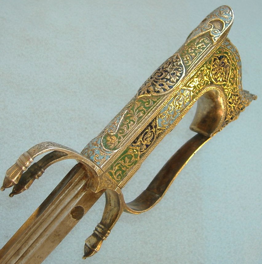

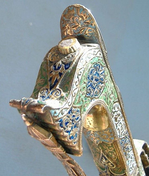

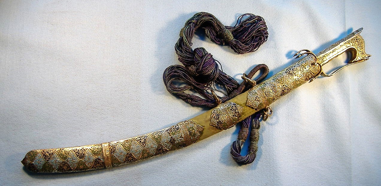

I wanted to share this lovely nimcha with my forum "peeps". It has become one of my very favorite swords even though it far more "blingy" than I usually care for, and generally, I am no fan of enameling. Somehow this one "spoke" to me and I had been looking for this blade type for some time, just didn't expect it to be in so special a "package"
I believe the sword dates to at least the early 19th century, likely even earlier.
The sword features the older style nimcha "cutlass-like" short, curved blade. There is a maker's stamp to the forte. The hilt is heavy silver enameled in dark blue, light blue, and green. You'll note the enameling is considerably cruder than what we might expect to find with Persian and Indian enameled pieces. Every square inch is detailed in some manner. The heavy hilt gives the sword a very nice balance.
The scabbard mounts are en suite with intricate floral motifs highlighted by the enameling. There are four bands of Islamic script along the scabbard fittings.
The baldric is old, but not "born with" the sword, though their colors match perfectly and they look like a natural combination.
Nimchas of this blade type are the most difficult to come by and I dare say, mounted in this manner, even rarer.
Dimensions:
Overall length:32in.
Blade length:25in.
Blade width at the forte: just under one inch
Blade's widest point: 1.75in.

A super piece, Charles ... i'd say. Can you 'macro' that makers stamp ? ... just curious .
Old 23rd April 2019, 04:15 PM   #3
One of the best Algerian nimcha ever!
I guess the guys of the Maritime museum will be jealous too
https://collections.rmg.co.uk/collec...cts/78504.html
I think that you are righ, I would say 18th c. for sure if not 17thc...

Charles, this example is sublime, among the best, if not the best nimcha we have seen on this forum. Thank you for sharing!
As far as dating goes, the earliest reliably dated nimcha is one in the Rijksmuseum which belonged to Michiel de Ruyter, which places it in the mid 1600s:
https://www.rijksmuseum.nl/en/collection/NG-NM-10412
Yours should not be much later than that, so perhaps late 17th or early 18th century, at least as far as the blade is concerned. The enameled mounts and the baldric could be later. There are examples of a 19th century enameled Moroccan saif scabbards in the sold section of Oriental Arms:
http://oriental-arms.com/photos.php?id=4522
http://oriental-arms.com/photos.php?id=3908
I do not know how early the enameling decorating technique made it to Morocco, but my guess is that you have an old 17th or 18th century sword remounted in the 19th century. Whoever did it, preserved the original form of the guard and the hilt. As you can see on the Rijksmueum sword, the original scabbards were made of cloth and leather and these materials tend to deteriorate unless stored in a perfect environment. Obviously it belonged to someone quite prominent, who loved this sword as much as you do. Most of the early nimchas we see are trophies taken during the conflicts between Habsburgs and Ottomans, and it is great tos ee one that appears to have remained in the Maghreb for a little while longer.

Charles, you are outdoing yourself time and time again!
Absolutely gorgeous!
However, I do not think it is North African. IMHO, it is South Arabian, likely Omani. My main point is the configuration of the blade: widening toward the tip. Similar configuration is seen in Elgood’s book on weapons of Arabia ( Fig. 2.1 and by description 2.2). Seems to me it is quite short: thus a genuine “nimcha”:-), a naval cutlass, so popular with seafaring Omanis.
Also, the lavish decoration is very reminiscent of the luxurious Zanzibari nimchas with gold coins on the handle from Buttin’s catalogue ( plate XXX) and Hales’ catalogue ( Figs. 589-90). Similarly “segmented” decor of the scabbard is also seen in the same book ( 2.18 and2.21)
Also, you might recall Elgood’s comment about Bukharans in Oman. They brought enameling there.
I doubt there is an iron-clad provenance, so that’s only my gut feeling.

Its not a weapon I have ever seen in Oman. This does however, satisfy the equation of being Algerian . The https://www.rijksmuseum.nl/en/search...t=Objects&ii=0 I Couldn't shrink it in size to fit EAA parameters... but you can see it on the web..The example has a part tortoiseshell hilt although it may well be of the same family . The provenance is in my opinion Algerian... surely it has to be off the coast as it is every inch a corsairs weapon. However having said that I have not got the Hales or Elgood reference work before me.. ~ Regarding coins on Omani or Zanzibari items I take it on those with Ivory hilts and gold work probably added by goldsmiths on the Zanj or even in Stonetown… These are not coins but circular shapes along with leaf shaped designs from the African comb making fraternity; see below..
I doubt if there is such an animal as a Zanzibari Nimcha and to my eye Butin got as close as any expert in his three plates which I placed at an earlier thread but I believe his detail still accurate and on his 3 plates there is no mention of Zanzibar...therefor
please see http://www.vikingsword.com/vb/showthread.php?t=23387 post 12 and viewing plate XXX 993 994 995 … The project Nimcha is seen as one of those .It may even be on Plate XXX11 991... Shown as an other oriental design.
I must confess I have never seen Bukharen work in Oman...although in the Yemen, yes, for good historical reasons and known links… Further I have no recollection of enameling work here .. Do you mean Yemen also?

It does seem that these hilts are 'Arab' and mostly associated with Algeria from examples are known as early as 17th c. . In "Arts of the Muslim Knight" (B.Mohammed, ed. 2008, p.77) . In this reference it is noted sabres of this type are seen as early as c.1700 with an Ottoman tughra, and another of this typw was captured at Battle of Oran (Algeria) in 1732.
Elgood (1994)does show one with this type blade (flared tip) in 2.1 but with a karabela type hilt, and another with this type hilt (2.2) same type of blade.
On p.15 Elgood describes the (2.1) type often found in sughs in Riyadh with these 'nimsha' blades and a small brass guard, and that they are attributed by Arab traders to Yemen.
It is noted that these are pretty unaesthetic (I have had these and they are munition grade) with these flared blades.
Whether 'Ottoman' or 'Arab' classifications are considered, these hilts with notable peak at pommel seem to occur throughout the Arab sphere, from Malabar, through the Meditteranean, the Magreb and Zanzibar. With North (1975) attribution they seem aligned with 16th century North Italian styles, and indeed many of these blades are Italian it does seem. As Buttin describes many of these type hilts and swords, always as 'Arab' but no specification of Zanzibar, many of these surely ended up there just as throughout these other regions, but were by no means indigenous there.
I have not been able to find any reference to Bukharen enameling in Yemen, but on p. 75 he does note a janbiyya bought during a pilgrimage in Mecca and was subsequently embellished in Bukhara with cabochon and cloisonné turquoises, but notes it is possible the work may have been done in Mecca.
This may suggest Bukharen artisans may have been in Mecca, but whether in Yemen unclear.
It does seem some nice swords were used in Yemen, mostly Hadhramaut, and other well mounted in San'aa, but certainly nothing like this.
Most definitely one of these very old Arab blades of 'cutlass' form and fantastically refurbished and likely it would seem if 19th c very early perhaps even late 18th. Breathtaking piece!!!
