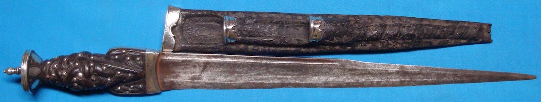

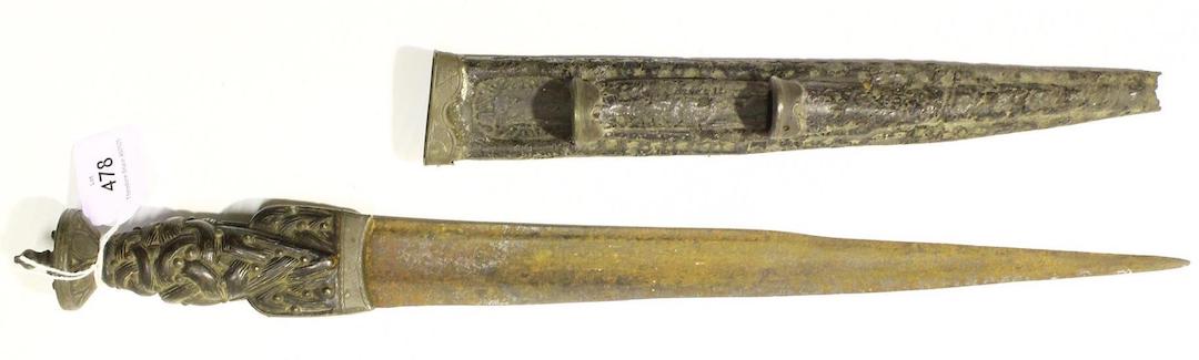

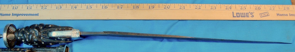

Well once again I'm over here in this section, only sharing my first Scottish dirk. Due to the shape of the baluster hilt, the silver studs, and screw top, I place this example in the late 18c to early 19c, leaning toward the late 18c.
The first picture is how I got it with a bent blade. The second picture is after my cleaning and restoration.

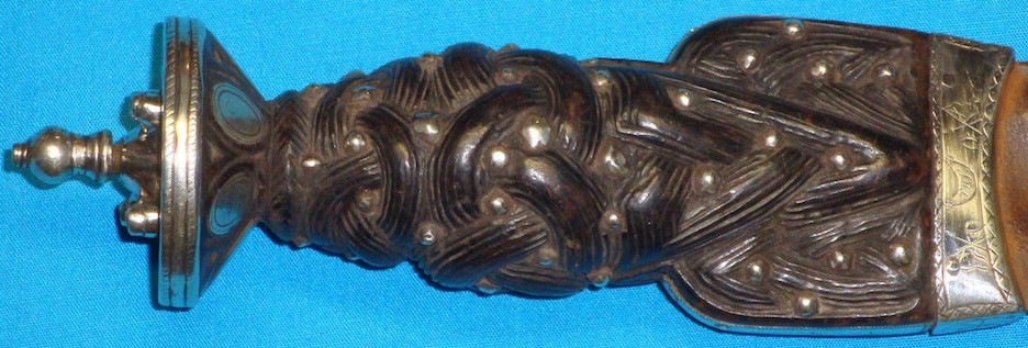

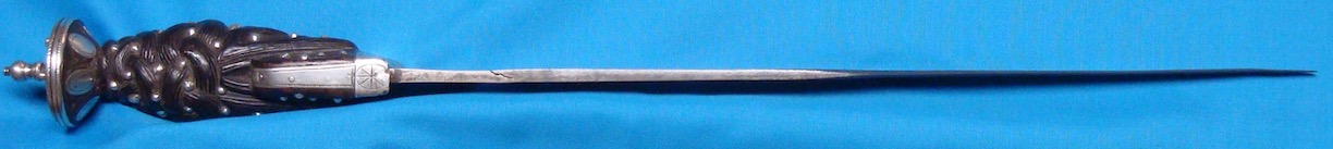

Pictures of the hilt and pommel top.

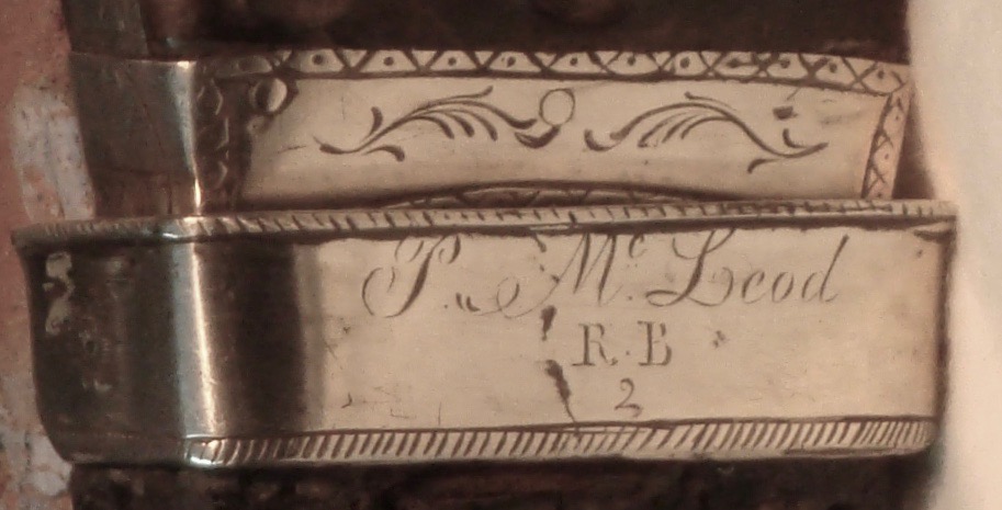

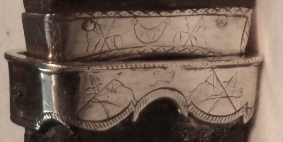

Here are the engravings on the front and back of the silver mounts of the hilt and scabbard. The name: "J McLeod". There is a crown stamp and the pictures of cannons, battle flags, and swords, and spears indicate to me that this person was also an officer in the British military.
My 2 questions:
1. Does the presence of cannons indicate being part of an artillery unit?
2. What does "RB 2" mean?
Other comments welcomed as well.

That also looks like a Gorget engraved on one of the panels.
So, officer?
Oh yeah Jose ; "There can be only one.."
Old 5th December 2018, 03:30 AM   #5
Posts: 7,407
GOOD POINT RICK! I missed that. Many thanks.

Jose!!! This is an absolutely phenomenal dirk!! and my Highland blood is raging with envy
I have been going through resources for hours and I feel confident this example is much as you have suggested, but I think more toward 1770s because of the wider 'haunches' in the beautifully Celtic knot baluster hilt. The metal studs are of this period to 1790s.
Whitelaw (1908 (1977), p.313) notes that after the Disarming Acts of 1746, following the tragedy at Culloden, proscribed Scots from owning weapons. However the dirk, with its utilitarian purposes was typically permitted, and often the now banned Scottish basket hilts were dismantled and blades repurposed into those for dirks.
This blade seems likely to be one of these blades as its profile seems contrary to most specifically for dirks, and the fuller at the forte resemble known Solingen backsword blade types.
Clearly this dirk is for an officer in a Scottish regiment of the third quarter 18th c.+ as suggested by the military motif, the gorget, sword, cannons and the RB 2 is of course likely a regimental unit. This may well be a heirloom blade mounted in military dress as noted. It would be exciting to imagine that the heirloom blade was in use at the time of Culloden.
The cannon do not suggest artillery ...perhaps the RB 2 could mean Rifle Battalion 2 or some such designation but those units seem much later.
The style of pommel and the mounts predate the familiar stone mounted dirk pommels which began around 1800. It is amazing to have the scabbard also! This is truly amazing Jose, congratulations!

A Very interesting dirk, and as Jim says a little earlier in the century I would say.
Towards the end of the century and into the 1800's, blades were much wider towards the tip, and have a different look to the hilt. This one is definately earlier.
I can't make out the letters/ initials on the gorget, but I see a crown below it.
It Has to be an officer's dirk,...and I am always very careful about using the term "Officer"!
Crown, Gorget, and if we knew what the letters are on the gorget, it may help ID it.
What is interesting to me, is that it appears to have been used a great deal.
Lovely piece and congrats!!

This hilt has been niggling at me Jose, so Just looked, and the shoulders on this hilt look nearly identical to those on Government hilts, C 1725 -50.

Well to answer your question, the initials on the gorget are "JML" I think for "J McLeod" on the backside.
With so many McLeods/MacLeods, honing in on the right military service would be helpful to see who it might fit. I emailed the auction house for info on the former owner but no answer.

Did you successfully straighten this blade Jose?

Sure did. The first picture is how it came, the second picture is after I carefully straightened the blade.

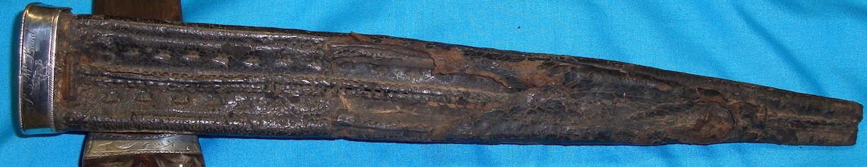

In the meantime, here is the back of the scabbard that I forgot to post.

In your last photos, I can see the side panels on the shoulders. These, with the three pins and the shape, are identical to the Government hilt of 1725-50.

1. should I braze the crack to help stablize the blade?
2. should I attempt to restore the scabbard?

I am unsure about fixing crack
If mine I would leave alone,
if I had to do a repair as in it is likely to break apart if it was picked up roughly I would use silver solder rather than braze as it is easier to work with and will tarnish to look less obtrusive
Lovely item though

I’ll leave it alone for now, but need be in the future, I’ll use very hard silver solder (had forgotten that one).

The unit was formed at Ft. George in July 1793 by Francis MacKenzie , and by 1794 was off to Holland for campaigns seeing action continually and into Napoleonic campaigns. Ft, George was built post 1746 near Inverness.
The MacKenzie clan is prevalent there and Ross Shire.
I am wondering if perhaps this might be our RB 2

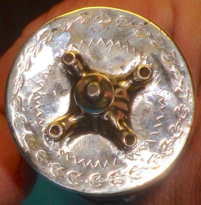

The most unusual element of this dirk is the curious device or fixture on the pommel...the four posts surround with central capstan. The only example of dirk with a similar type of fixture on the pommel in this manner is in Stone (p.209, fig. 259, #1) and of 1700-20, which is far too early in its other features compared to the baluster style in the example posted. I have not found this pommel feature on any other examples in the material I have researched.
The closest thing I can find that resembles this kind of device is the famed Brooch of Lorn which has a stone at center and surrounded by posts with stones at top of each. Here I would note that the regions of Ross Shire extend to the outer Hebrides and Isle of Lewis. This brooch is related to Lords of the Isles from medieval times. While this is a tenuous suggestion it is interesting in the design in comparison.
Possibly this is an earlier dirk which has had the mounts later engraved to this unit and owner? It would be interesting to see if the National Army Museum in London might have rosters of this unit in this period (they were later in the 19th century joined with Seaforth Highanders (1881).

It would be great to discover more on this curious fixture atop the pommel on this dirk, which seems to have been a very early appendage, and how thie dirk has seemingly become possibly involved so much later in a military setting.
