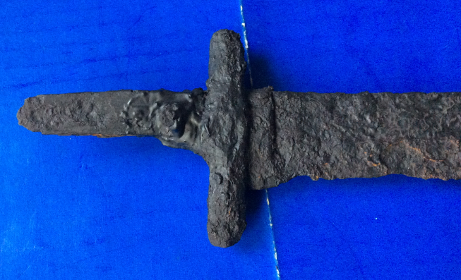

Having read Kirill Rivkin's book about Eastern swords and a chapter by Bashir Mohamed in his Furussia book as well as having written a paper about the penetration of sabers into the Arab/Islamic realm, I got an irresistible urge to have a couple of nomadic sabers.
So, here they are:
First, a classical Khazar saber 8-9 centuries with its crossguard and circular tunkou ( or habaki, as Kirill prefers to call them). Pay attention to the false edge at the very distal part of the blade that had been forged in a diamond-shaped pattern to create a strengthening rib: this saber could not just cut/slice, but stab as well.
It was preserved by tannic acid, that's why it is black.

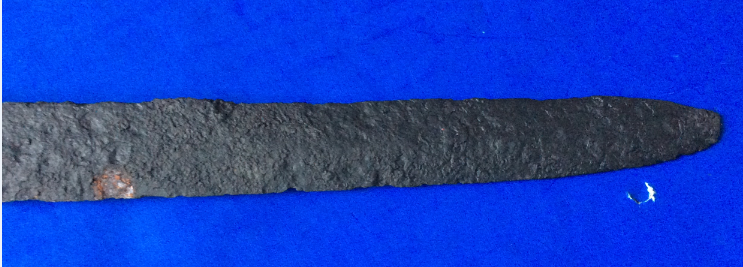

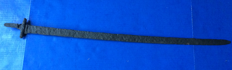

And here is most likely an example from the Qipchaq armamentarium.
This one is in an unbelievably well-preserved condition: the soil must have been highly "hospitable" for a 10-11 century steel.
Here the tunkou is L-shaped with the longer arm going next to the edge. The last pic shows how it was made: a thin plate of iron was wrapped around the ricasso and the two were forged together. This one is diamond -shaped along the entire length and again, the distal part of the blade is double -edged.

Hi Ariel:
I assume you are familiar with the Siberian Sword discussion published on this site in 1998, http://www.vikingsword.com/vforum/for01.html, and with additional information and comments here, http://www.vikingsword.com:80/ethfor...sages/405.html
These blades seem very long. Can you provide dimensions please.

-----------Additional images from owner------------
Old 20th August 2018, 02:03 AM   #5
Ian,
First, thanks for the references and the missing posts.
The lengths of blades:
Khazar 29.5"
Qipchaq 40.5" ( yes, this is no typo:-)
Both very slightly curved.

Teodor,
I cannot see any rivet holes in the tang. Do you think the original owners used some kind of mastique, akin to Indian tulwars, or was the tang damaged badly and the only way to fix it was with some kind of black steel epoxy? My original Khazar's tang was broken ( the seller was negligent) and I had to use a little bit of that epoxy to secure broken ends. It holds well, and the color matches the tannate solution, so I am ( almost) OK with it. I guess that 1300 years from now we will look worse than that. Some plastic surger-ized celebrities look worse even now, when they are still alive.
Unfortunately I cannot tell for certain. It is very possible that there was a hole (or holes) but those were closed by accumulation of rust/dirt when the sword was berried and then sealed when it was restored after it was dug out.
As for Kubur's question of the word Nomadic, I assumed that it is used in the context of this threat to refer to the Pontic-Caspian steppe, as defined in Rivkin's book.
Correct.
