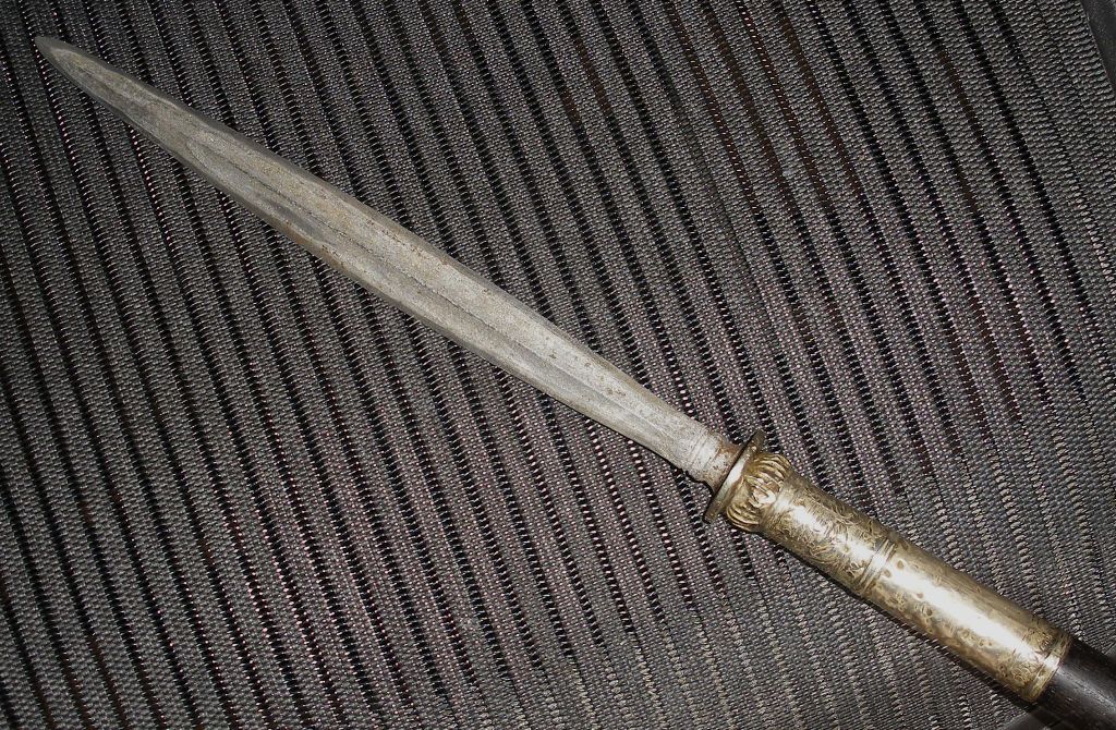

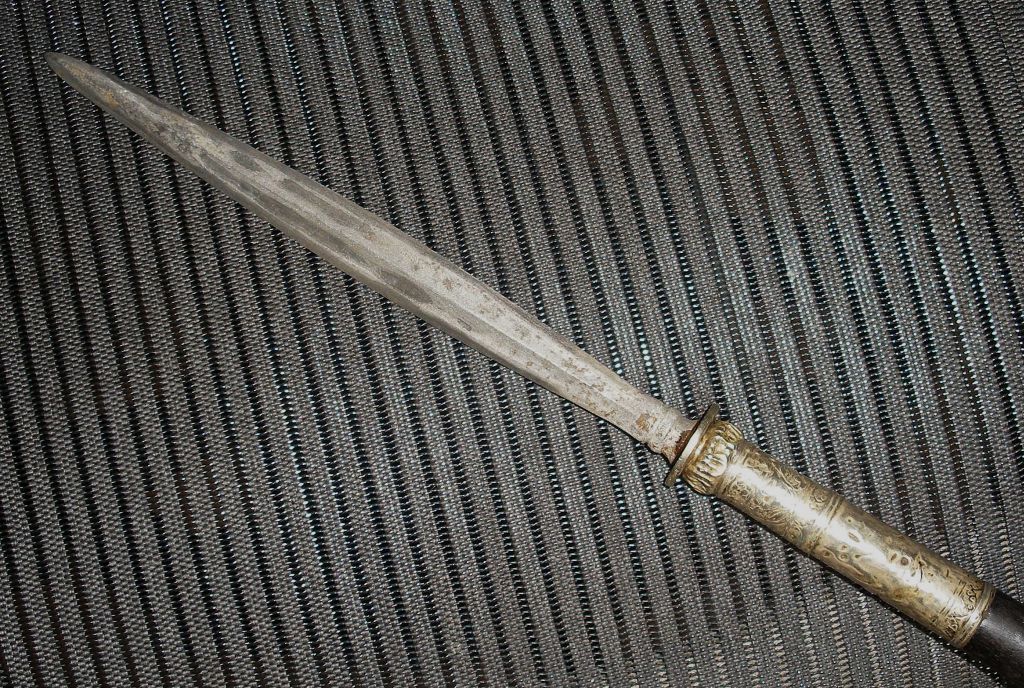

I have a (new to me) tombak that I have used Picreator Metal De-corroder on to remove the rust which was pretty substantial.
The result shows a noticeable difference in color between the core and the pamor.
I intend to try a strong, hot coffee solution (in lieu of warangan) to try to make that contrast even more apparent.
I'm hesitant to post pictures here as it is not a keris.

When I'm finally finished with the rust treatment I'll post the blade before I try an etch with super strong coffee. Right now the blade is in a heavy coating of De-corroder wrapped in plastic wrap to keep it from drying out too quickly.
Something occurred to me about the subject under discussion: there are many variations in quality of steel and pamor material; would this difference not interfere with a consistent result in whatever rust treatment is involved?
/5/20
Well, here are pictures of this blade after treatment with Metal De-corroder (a Renaissance product) a hot rinse and before any etching has been attempted.
It was quite crusty and the color difference was not aparrent; no before pics, sorry.

Old 24th May 2018, 02:01 PM   #21
Posts: 6,420
Yes it would; if I had anything that could produce a warangan type of etch.
I'm reasonably happy just to see a contrast between the metals; the EPA doesn't want me to possess arsenic trioxide.
Old 24th May 2018, 04:23 PM   #22
Posts: 7,289
Though i do believe you said you were going to try a solution of strong coffee, though perhaps "etch" is not the correct word for such a bath. At least i hope not since i am bathing my stomach in some pretty strong coffee right now. LOL!
Old 24th May 2018, 05:31 PM   #23
Posts: 6,420
Default No Big Deal
I bought a small jar of instant and made a paste, applied it to the blade and all that happened was an increase in contrast between the pamor and the core.
Not really worth belaboring the board with another tombak picture..
