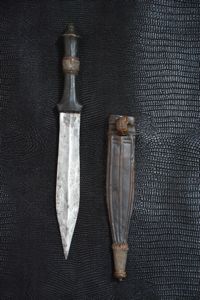

Hello dear members,
I've just purchased this West to North African dagger but I am unsure about the exact origin, the only similar example I've found is listed here: http://www.memoire-africaine.com/armes2.html and described as Touareg dagger but I doubt a little bit that this description is correct. Is someone able to confirm this description or know it better?
Thank you very much in advance, first picture is from the seller and show the dagger in question, the second picture is from the above given site. The dagger in question is 34 cm inside it's scabbard.

A good, uncommon dagger Detlef ... well done. I think I've seen these described somewhere as Baule, but whether that is a correct attribution, I can't say.
However, I am confident its not Taureg.

thank you very much for comment. Yes, the dagger is very nicely worked and I hope that the white spots on the scabbard are nothing serious, have asked the seller for it but never get answer. Will do a little bit search with keyword "Baule". But happy, that I am not alone that it is not Tuareg.

Many of us are interested in African and Oceanic Weapons, however when we lost VANDOO, we lost a real expert in these areas and much more !
That being said, I think it is a great dagger and to me it has a Sudanese Flavor.

I love African weapons particularly those of the Congo and I am pretty sure that there are a lot more members who are also interested. I am no expert by any means, just the opposite, so you will have to excuse me if my suggestion seems improbable. I agree with Colin that it is not Tuareg and is indeed an uncommon dagger which I like very much. I am not sure if it is a dagger of the Ivory Coast Baule people as I have only seen their broad, short, leaf shaped daggers but it may well be. I lean to it being Manding origin but could be wrong.

like you I've looked in direction Baule but can't find something similar. But I've looked for Manding also but sadly no match until now. Can you show pictures?
Until now I don't have it in my hands but here the other seller pictures, maybe someone get an idea by remembering a similar workmanship.

I did a quick internet search and found these two which are described as "Baule" ...

Thank you Colin, I see some similarities, by the first one the handle by the other one the blade profile. So it's maybe indeed Baule!

I saw several attributions to West Afrika (Baule, also if I remember well Sierra Leone ?), nevertheless by collectors only (nothing "in book" I think). Small ("utility") knives are not as known as a big ones. Example could be small straight daggers/knives (blade ca 13 cms) used in Afar region by camel herders

I think as others - West African. (This Afar herders was an example of another not too much known knife)

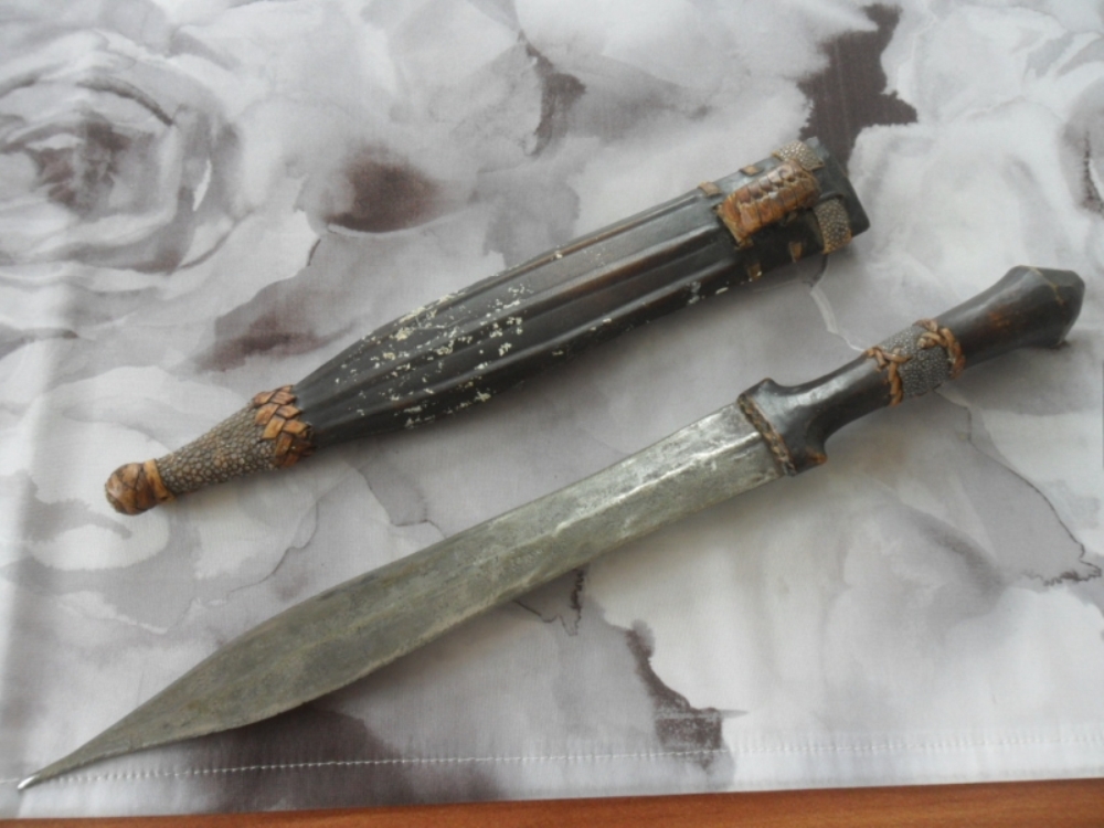

I seem to becoming obsessed with trying to pin point the origin of this knife. Is it possible to provide clearer pics as my eyes aren't to good these days. Could you also confirm the construction of th hilt i.e. Just wood or leather covered wood, material of plaited band around centre of hilt also materials of scabbard and the decorated band.s at the chapel and throat, sorry to be such a pest

like you I would like to know from where this dagger coming. So you can't be a pest! I will post better pictures with many close ups soon as I have it in my hands, the seller was a little bit circular but it's on the way to me and will be next week here. But I think both, scabbard and handle are wood covered with leather and in up and down from scabbard and in the middle from the handle is sewn lizard or snake leather with sinew, that's what I think to see. But I will describe it again when I have examined it.

the small sewn on pieces of leather are neither lizard, nor snake. It is sting-ray skin.

In the meanwhile I've received the dagger and it's worked like supposed, the white spots on the scabbard has been wall paint, I was able to remove it unvisible. Ca. 33 cm inside scabbard, 31,5 cm without, handle 10,5 cm long.
It's a very nice worked small dagger, maybe not extremely old or early collected in a very nice condition after it has received a little bit TLC.
Here the promised pictures. Still hope that the exact origin can get identified.

Yesterday I noticed this ID request from Detlef. Here I can help. Your dagger is from Benin, former Dahomey and belong to the tribe "Bariba". They are located in the northeastern part of Benin and today around 1 million people. Some also to find in Nigeria.
Here you can find my examples, one short sword and two daggers.

Last not least here some of this daggers in the Überseemuseum in Bremen/Germany and a map.

thank you very much! I've searched on your site but seem to have overlooked your examples. Thank you again for your great help!

Thank you very much for this info, Wodimi, I have spent hours searching without success, You have saved me many more and I very much doubt if I would have discovered the origin of this knife, brilliant.🙂
