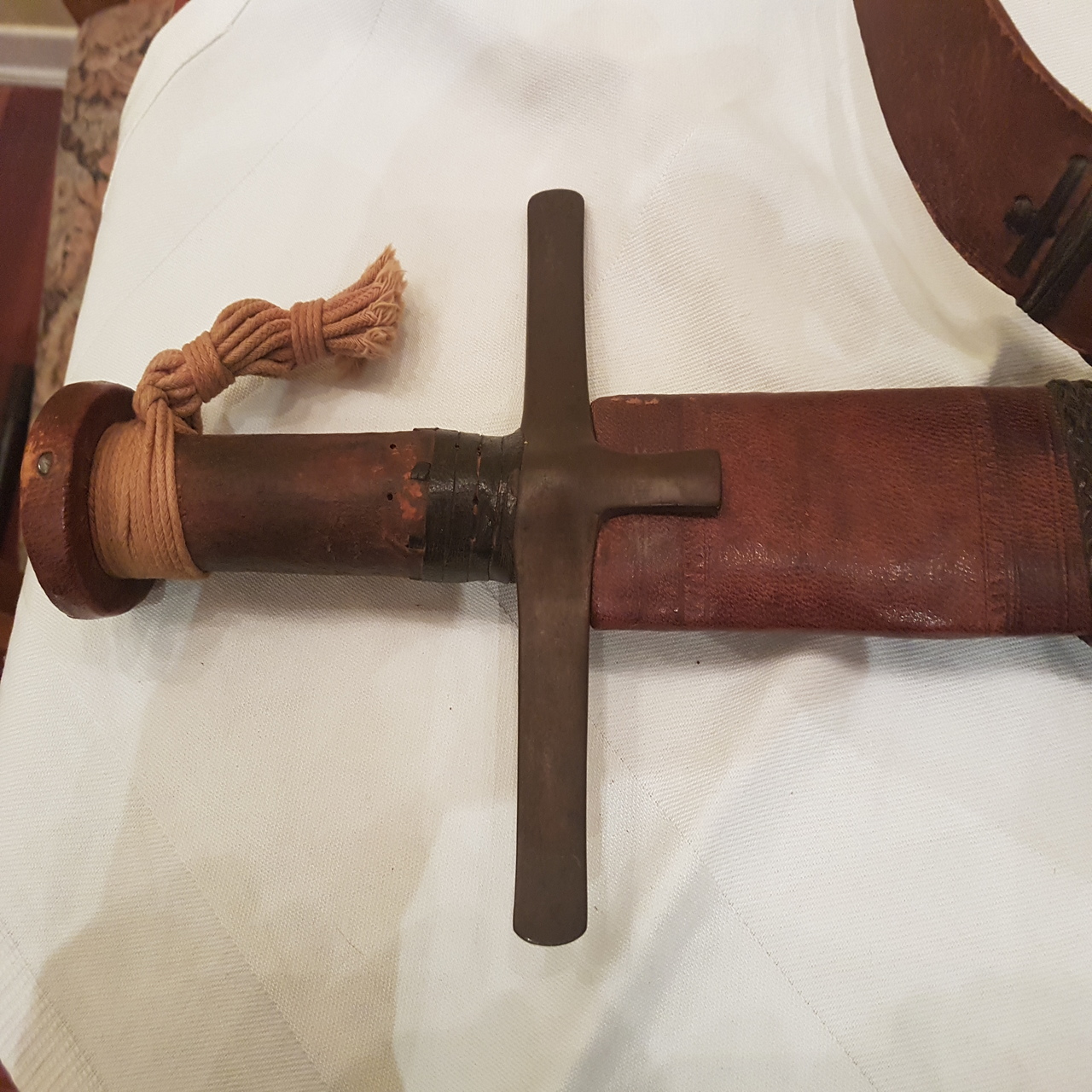

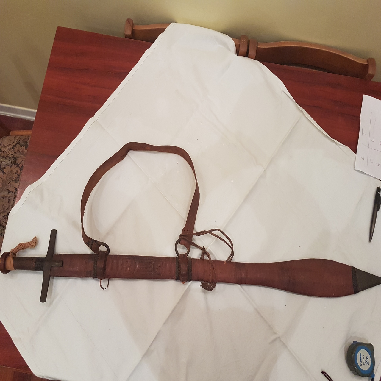

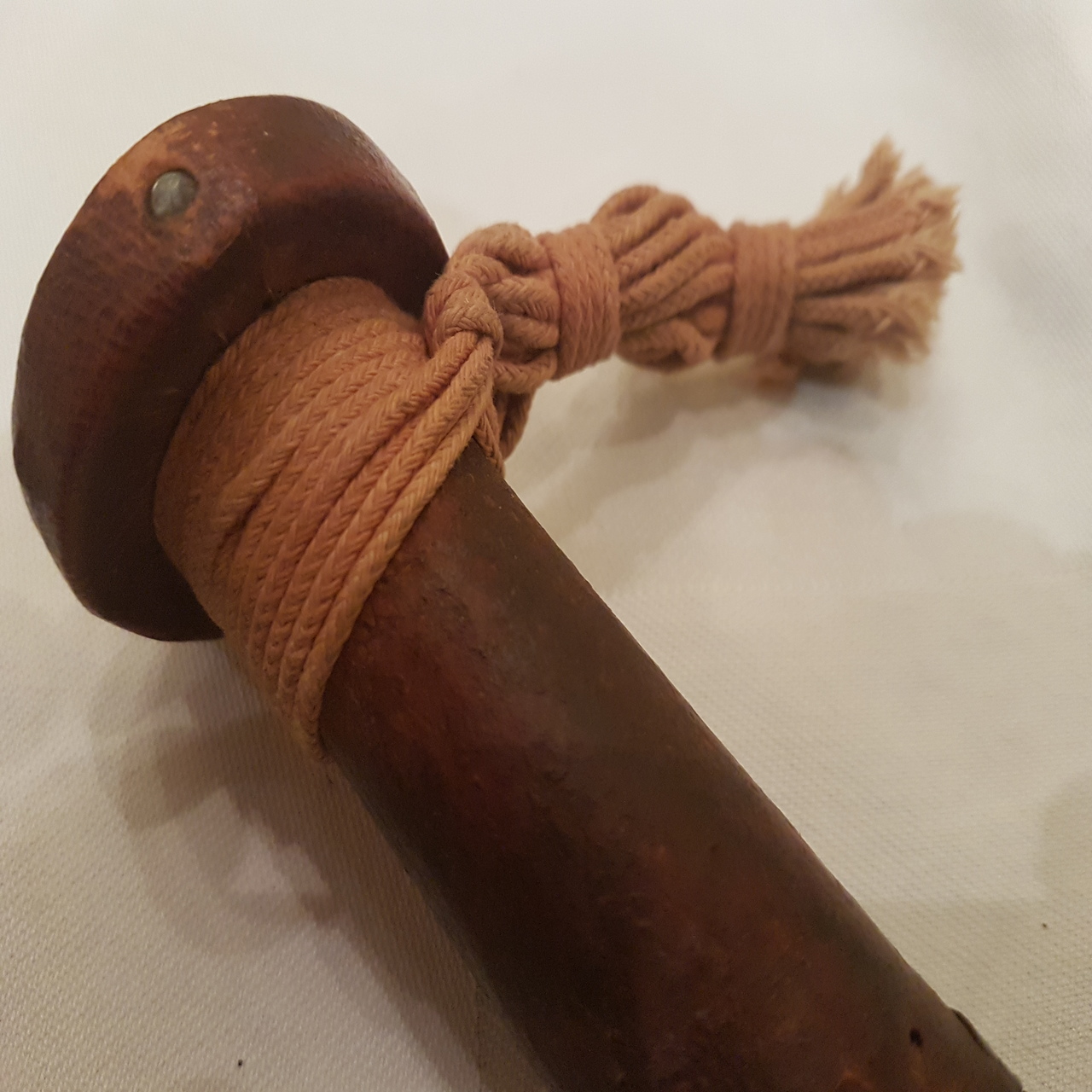

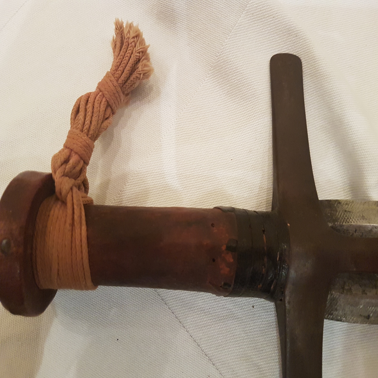

Hello, I'm new to this forum and would like to ask for advice. I recently purchased a kaskara and seller didn't have much info on it apart from it being brought from Egypt in 1970's. It is in fairly decent shape except for the loose hilt. Considering I don't know much about these swords I would like to ask for the help to see if it is an antique or a tourist souvenir. In case it is just a souvenir, without historic value, I'd go ahead with fixing the hilt and making it usable because it is such a nice, light and lively blade itwould be a shame not to let it cut some light targets
Here are the photos, excuse the quality but my mobile phone camera is all I have at disposal.
Thank you in advance!
Sinisa

1970s sounds about right. I'd class it as a tourist object, these shorter examples were to a degree made to be easier to take back for tourists I think.
That's not to say its a bad little sword, its made in the same manner as the full size ones.

Thank you for your feedback. Actually blade is 89 cm which I think I read it's about right length.
Do you maybe know how the hilt is constructed in these?

Iain, How much shorter are these tourist blades? I thought most Kaskara were about a yard 35-37 inches (89-104 cm ) in the blade. I agree Selohr's blade looks like tourist or wedding quality but I don't see it as being particularly short for ease of transport.(88.5 cm )

Thank you all for your feedback. Blade is sharp and looks like it was bought sharp. Were tourist or wedding pieces usually made sharp? Also, how would one go about fixing a loose hilt? Is it fixed with just resin or can I expect a rivett under the wrap too?

They are usually a fairly short tang, with a punched hole towards the end. They are fixed by a metal pin, or a nail through the grip and the tang.

The blade would have been sharp when it left the "factory" as the maker would not know the ultimate type of customer. In the 1960s-70s sword use was still an active means of self defence and/or of "being armed". BTW the cross guard is of good quality and rather old; in the Sennar location style.

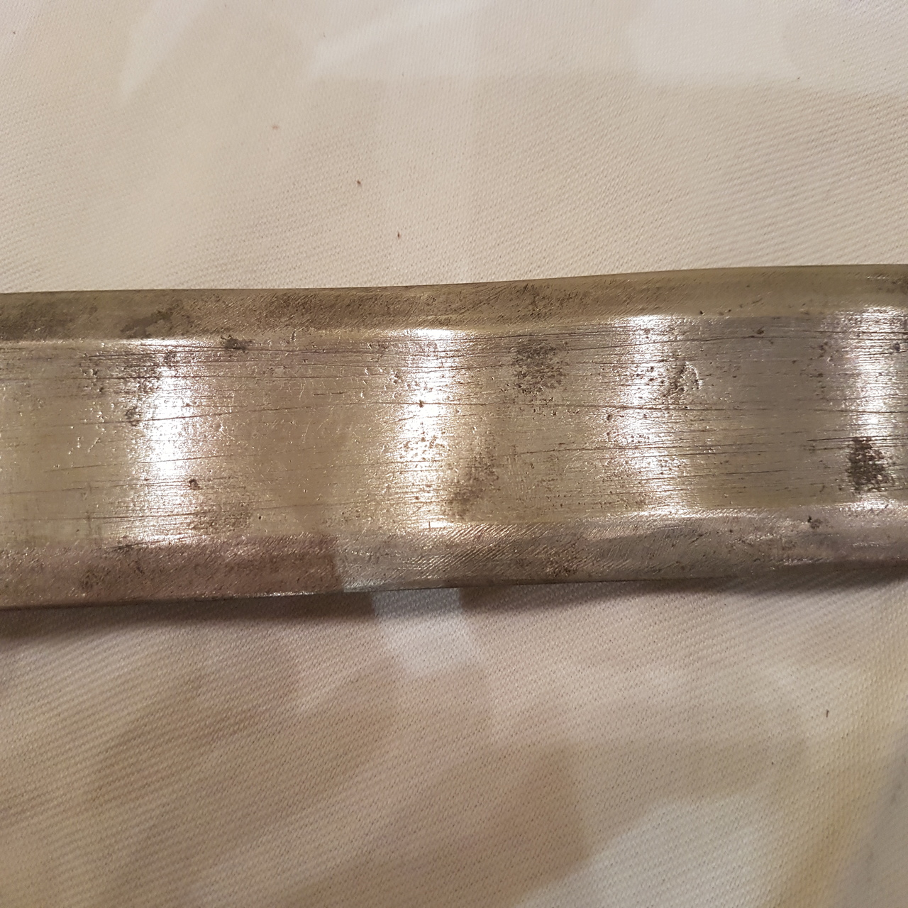

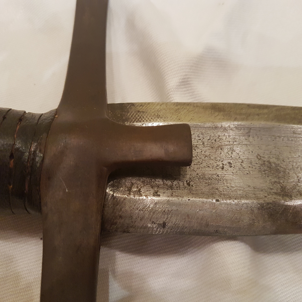

That does look like the blade was fullered rather than a more touristy flat stock. the wormholes in the grip could be filled in with superglue to help stabilise the wood if you do try cutting with it. If there is no staple/bent nail/cotter pin hidden under the wrap, holding the grip scales and blade, I'd be leery of cutting anything with it, especially with anyone in the immediate vicinity that might be hit by a flying blade while you are left holding the remains of the grip. The long ones were often used from camelback & would be an impediment if dismounted, or trying to defend a building, these, like naval hangers (and roman gladii) are more suited for close work. A lot of indigenous people STILL guard their homes with cold steel.

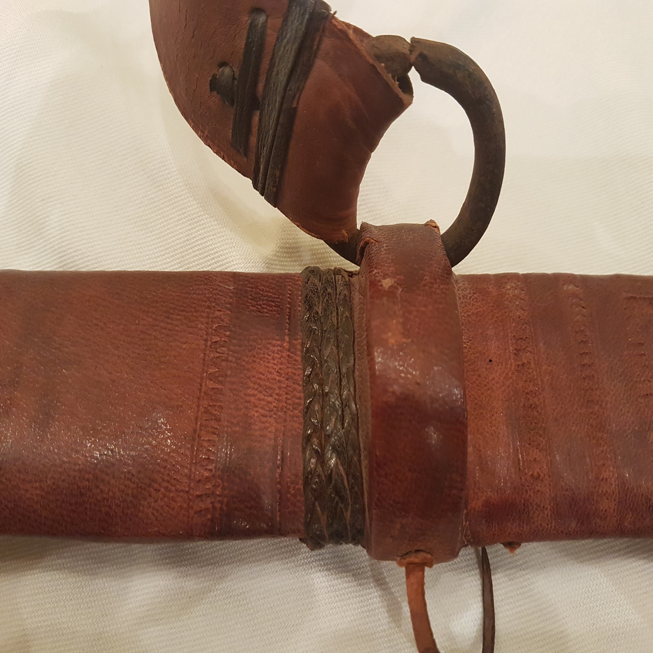

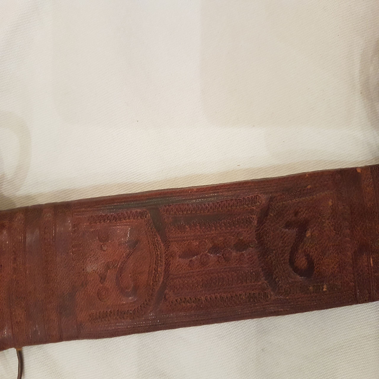

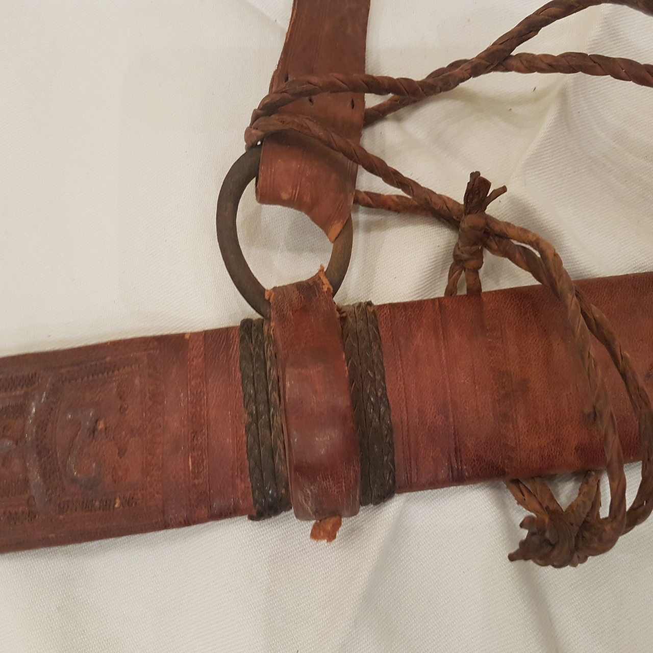

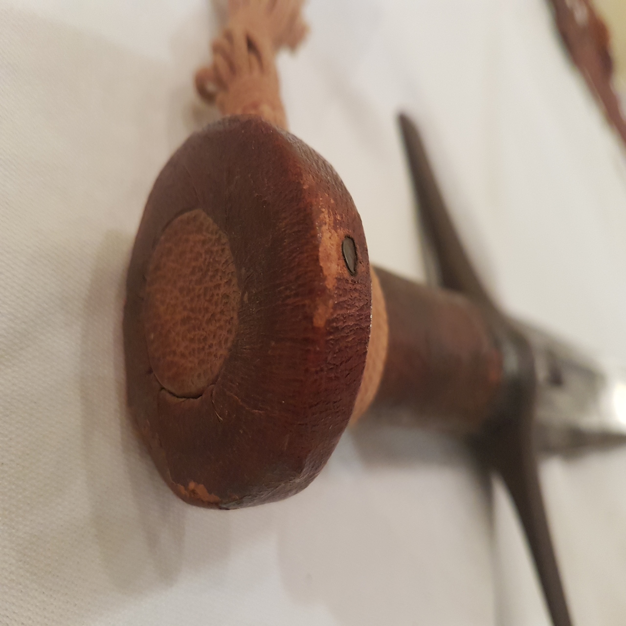

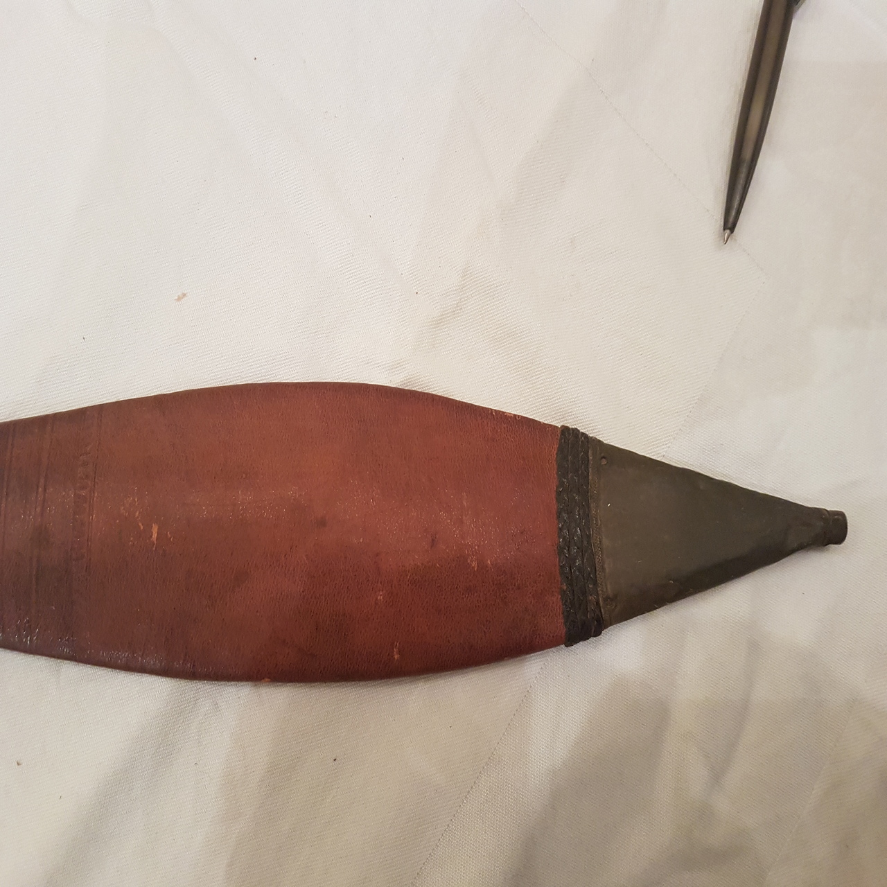

Had some time to examine it and the movement within a hilt is because the wood of the grip has rotted towards the guard, it does seem to be held by a rivet beneath that leather strip wrap, in any case I won't attempt any swinging until i find a way to fix it. I suppose it will require taking the grip off and making a new one. Anybody got any tips on restoring the leather of the scabbard, it is very dry and starting to crack?

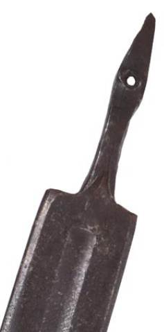

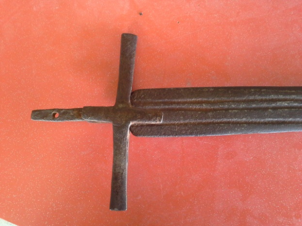

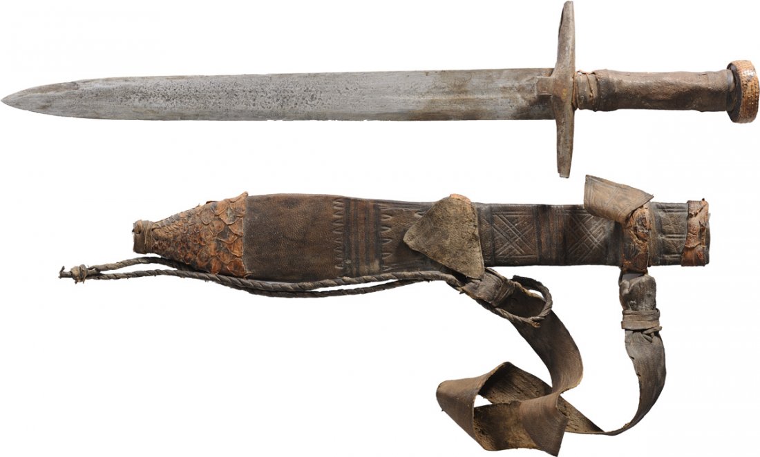

Just found a photo of a takouba's tang, might be of interest...
It might have been in takouba mounts but that was at some point mounted as a kaskara.
Takouba don't use a pin, but a full tang through the pommel.

It is always interesting to see discussions on kaskara, especially when these aspects of more modern examples are observed. I very much agree with the date consensus on this one, and as noted, these were not necessarily made 'just' for tourists. While many traditional ethnographic weapons do end up in souks and sale venues, they are likely most honestly intended for traditional uses, with weddings of course as well as other celebratory events.
I also agree that the shorter examples are intended for the wear over the shoulder, which is often seen in period photographs. It seems I recall one of Zubier Pasha, a notorious slaver, mounted wearing one in this manner, while a longer (full size) one was attached to the saddle under his leg. This was very much in the European manner of a 'tuck' (large straight sword) under the riders leg while he wears a sabre.
The steel used in this blade was probably in the same manner as the old lorry springs used in the early days of British occupation in Sudan and it would seem that the very process of grinding the blade down would render a reasonably sharp edge. These methods of kaskara production have been handed down for generations, which is why I have always considered even newer examples like this very much good 'ethnographic examples'.
