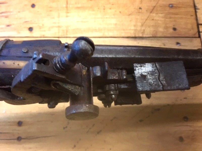

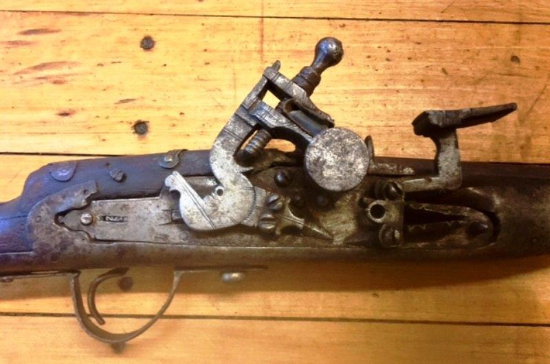

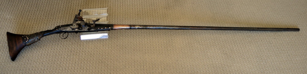

SNAPHAUNCE – I just picked up this Moroccan Snaphaunce, where I was the only bidder and was able to pick it up locally to me. Thus by the time it was bought and paid for, I only paid a few $100 (US) for it, maybe 4-times or more less than the low bid in the range expected. It is my 1st snaphaunce lock mechanism.
The auction ad said 62-caliber, but I can’t even get a 58-caliber jag down the bore. Mechanically it is complete and in excellent shape overall – as all the wood is sound and the metal is sound, less the steel (frizzen) which I’ll get to. The barrel is cleaning up nice, but right now I’m using brushes to get out the years of accumulated crud. I’d really like to pull the barrel and check the condition of the breech plug and if shootable, then if needed I may consider lining. It would be awesome to get it shootable!
Taking it apart has proven to be a challenge as it appears that there were some ‘solder’ repairs to some of the ornamental metal bands holding the barrel in place, but it turns out to be a gray epoxy-like product, like a construction adhesive. I have not yet used a heat gun to help soften the epoxy, but I’d like to remove the bands to get a full assessment of the barrel and barrel channel, as well as to completely remove the barrel.
My biggest obstacle will be the steel. See the crack across the face? Any suggestions here? I do thank you for your input in advance and I hope that I can be a welcome contributor to you all here. My next build or purchase will be a wheellock!

Welcome to the Forum !! So, your first Moroccan snaphaunce long gun. Congratulations. Your gun appears to be a Mukahla long gun from the Tetuan Region of Morocco. And typical of the style. The locally made snaphaunce lock on yours favors the Dutch pattern style, with the hammer (dog) reflecting a combination of Dutch/English style. Probably made sometime during the first half of the 19th Century. (Yes, believe it or not they were used all the way till probably 1900).
I thought I was the only one left worldwide that wanted to restore these guns into shooting condition. LOL I hope I haven't infected you with anything ? LOL
Anyway, feel free to PM me for some tips/suggestions on getting these in shooting order.
We do have a few Ethno gun enthuseists on this Forum, and hope they chim in and say hello.
Again, welcome.

Hi Dale and welcome to the Forum.
I agree with Rick as to origin of this gun.... Moroccan Tetuan North Coastal Region.

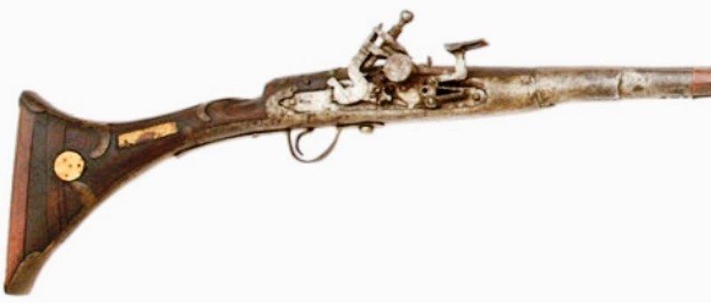

Re your comments about pulling the barrel. I think you are giving yourself quite a challenge as the upper part of the barrel is bound to the stock and does not use bands to attach it. Unless you have devised some way of removing it without damage to the original metal work I would suggest leaving it as is. The cracked frizzen is probably not too much of a problem as I suspect that Rick has something in his parts box to replace it.

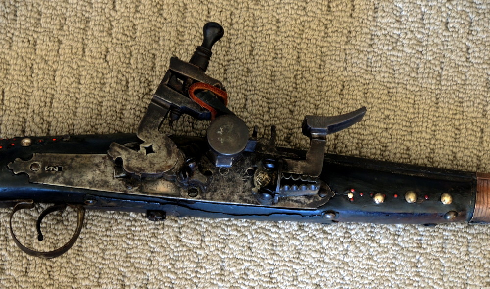

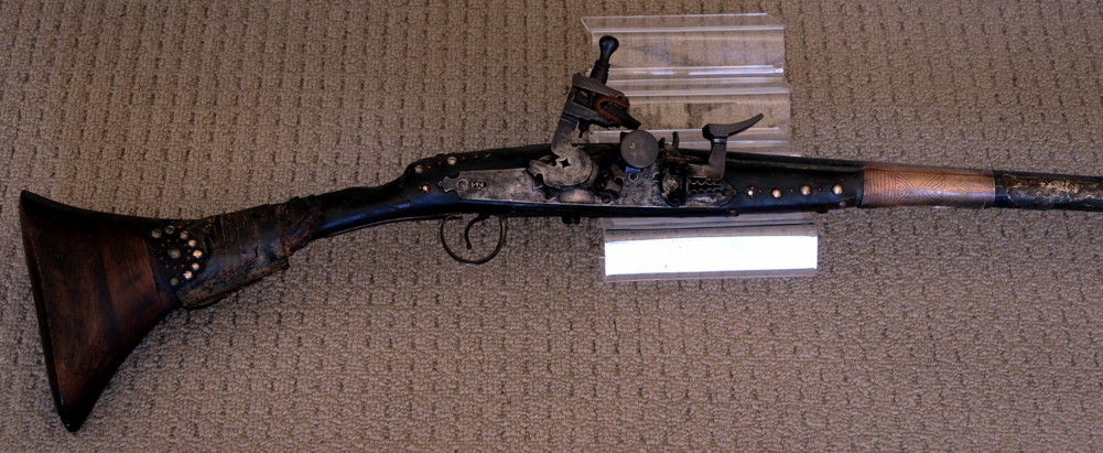

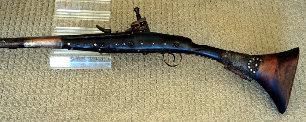

Here is a similar gun which I have in my collection.
Stu
