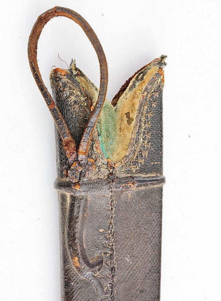

The Indian scabbards were covered with leather, but also with brocade, velvet, and other textiles.
Something which I have only seen on scabbards covered in leather is the 'loop', or rather the rest of it, looking mostly like a 'fish tail'.
I only have one scabbard with the 'loop' intact, and would like to know if other members have scabbards with a 'loop'.

Indeed, I have had several and currently have one with an original loop.
It was used to loop over a handle quillon to prevent the sword from slipping out.

These scabbards with the 'loop' are not very old, but on the old scabbards you can see that these 'loops' was used for a long time, although they have broken off.
It is interesting to notice that the 'loops' were only used on scabbards covered with leather, the other scabbards must have had a string which could be attached to the quillon.

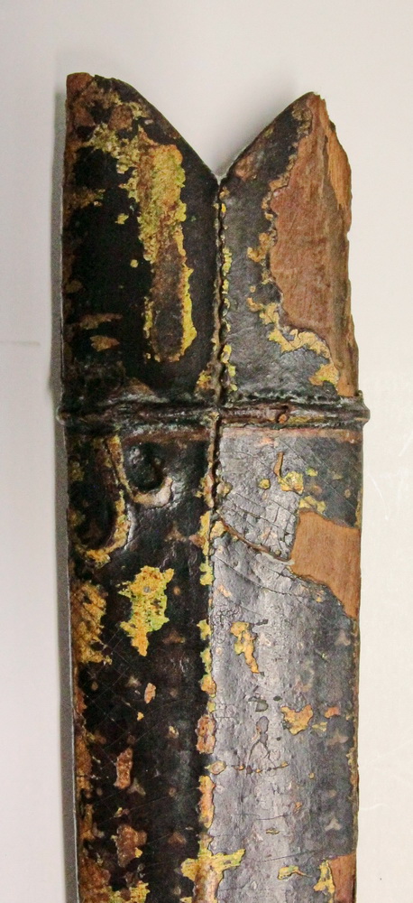

Here is another example.
The originale scabbard is 18th century. The loop is missing, but the 'fish tail' can be seen on the left side of the scabbard.

Ariel is, no doubt, right about leather scabbards often in use, but as he also writes, 'except for something stored in a royal palace and attended to on a regular basis.'
I believe this is one of these cases, where the sword was seldom used, and taken very good care of when is was not used. This is why I believe the sword and the scabbard are of the same age.

Very possible.
The leather is in a bad shape, but may be original 18th century.

Jens,
Is there any accounting for the 'fish tail' and the loop being always found together? It is interesting that loops do not appear to have been used on scabbards with no fish tail. I wonder why? Do you know if the loops on these leather covered scabbards were produced only in one locality? If this was so, it makes more sense maybe.

Posts: 2,718
Hi Richard,
Nice to hear from you:-).
I have seen no accounts to that they belong together. However, why make a 'fish tail' alone? The way I see it, they must have belong togher.
No, I dont know if these loops only were made locally, but I find it very unlikely, this was made all over India.
In old texts you can read what will hapen if the sword rattels in the scabbard. I seem to remember that someone in your family will die, so imagine if a sword falls out of its scabbard - you would likely be the one to die - it does say in the texts, but it is a very long time ago since I have read them.
A sword is quite a long thing, and the blade quite heavy, so I have difficulties to imagine how that would happen, but if you are superstitious enough, almost all can happen.
I think scabbards, other than the one dressed in leather, had a cord to tide the sword to the scabbard with. This would be fine, and could be changed when needed, but on a leather scabbard, when the loop was broken - that was it.
What makes me wonder is, that the makers of the leather scabbards did not make it easy to change the loop - when it broke, as we can see on many scabbards that it did.

Good morning Jens, and Happy Easter!
The loop on the leather-covered scabbard may have lasted as long as the average scabbard.
By this I mean that if (In an organised day and age) scabbards became worn, and were re-covered every five years for example, then the loop would last this long without problems or breaking down.
If it Was viewed in this manner, then maybe no problems making the loop integral with the mouth.
If this line of thinking is correct, and there is nothing to suggest it is!....then the frailty with which we judge the loop now, would not be a problem at the time.
Of course, this in no way explains why loops are only found on leather covered scabbards.

I think whenever the leather was in a bad shape, due to much rain, heat or whatever, it would be replaces and a new loop added.
I find the 'fish tail' interesting. Why a 'fish tail'? Did it attach better to the scabbard when it was glued - or was there another reason? Fish did have a spacial meaning to many Indians.
To be quite honest. I believe the loop would go before the scabbard was worn. A sudden atack and you have to pull the sword fast - the loop is a gonner.
The sword belonging to the second scabbard I show, has a long straight double edged blade, and there is no way it would fall out of the scabbard, but maybe if it rattled in the scabbard it would be a bad omen.
