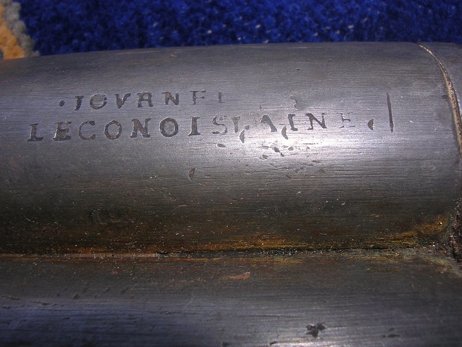

Good morning gentlemen,

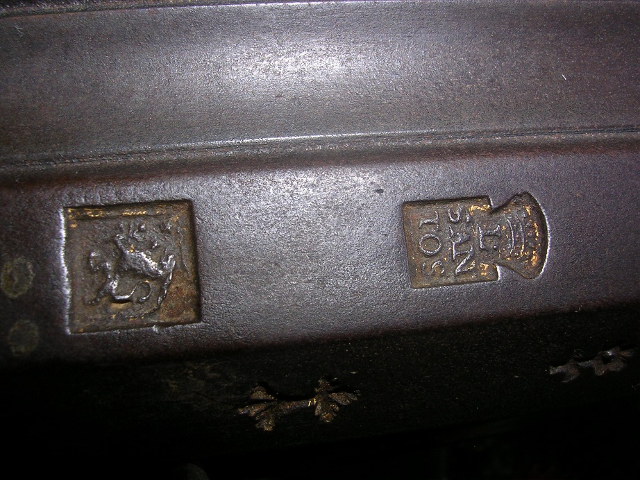

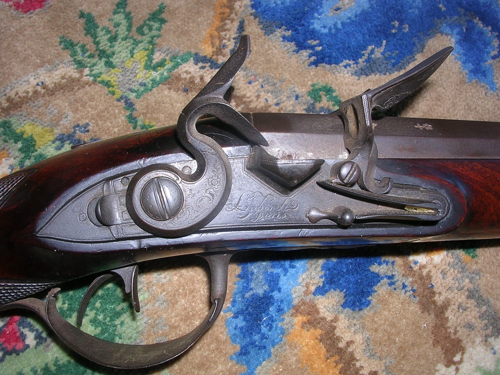

I have a mystery on my hands; It is an early double -barreled flintlock sporting gun, barrels marked Luis Santos, Locks by Labarde, Paris, and apparently re-stocked in England in the early 19th century!
Under the breech it has these stampings , attached.
I can not figure out what this says or means. Maybe the "staine" is "spaine"?
But what the first part is I do not know. Looks a bit like "Lesson " in French! any help most appreciated!!
Richard.

Hi Richard,
Labarde ? certainly Laborde, instead .
Those letterings under the barrel may (should) not be words; the upper set has too many consonants in a row... and not necessarily original to the barrel making.
You surely have a riddle there .

On the other hand, the word "Leconois" exists in French; apparently an old surname !

If we determine that ‘leconois’ is lesson, could this be an apprentice’s final build for acceptance into the guild? That may be why those other marks are there, perhaps denoting it was built/proofed under the oversight of the Master?
However, those “,” marks might indeed be commas and recall that Europsnuses them as commas between numbers - so perhaps those final marks are the bore sizes?

Dear Fernando,
Of course you are right. Laborde it is. Getting things wrong is the only way I get them at the moment!
Thank you for the old French Surname. This is a good start.
Much to puzzle over on this piece, but thank you for your help my friend.
Richard.

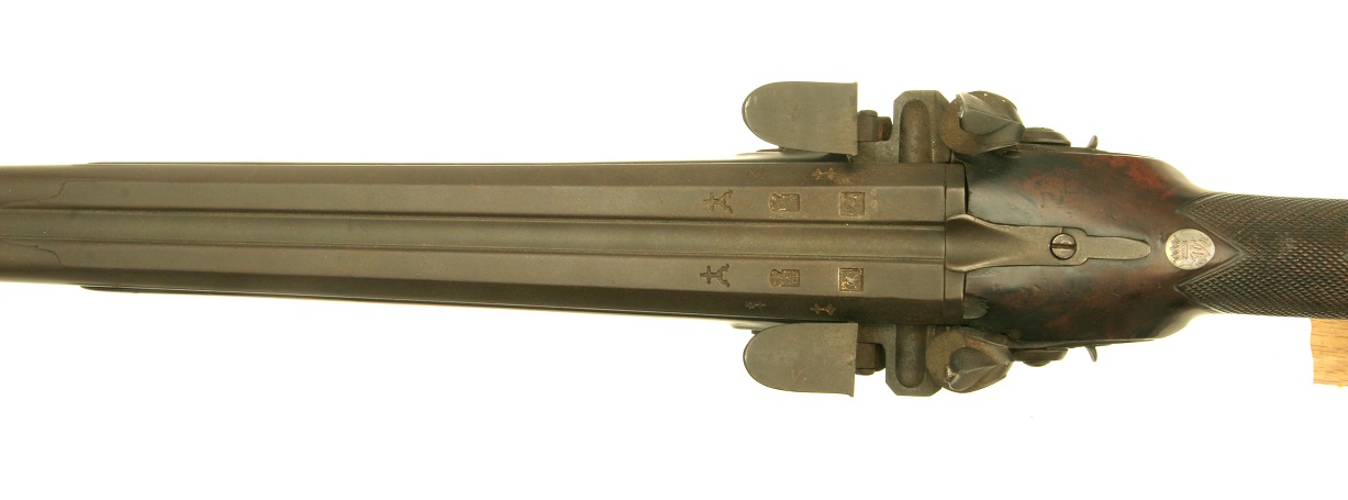

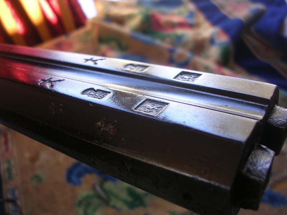

The marks on the barrel are those of Luis Santos, and whether they are correct or a bit later forgeries I do not know. Many Were forged with famous Spanish barrel -maker marks applied, and these were difficult to tell apart from the real ones even in the 18th century.
I did have a short thread about the Santos stamps some time ago, and they Do appear correct..
The problem with this is that Luis died in 1721, so if his work, they are Extremely early for a set of double barrels. I Think Keith Neal had seen some from 1723 or so, but these would have to be 1721.
The locks are by Laborde, (Thank you Fernando!) and Stockel has him working in Paris from 1745 to 17 60.

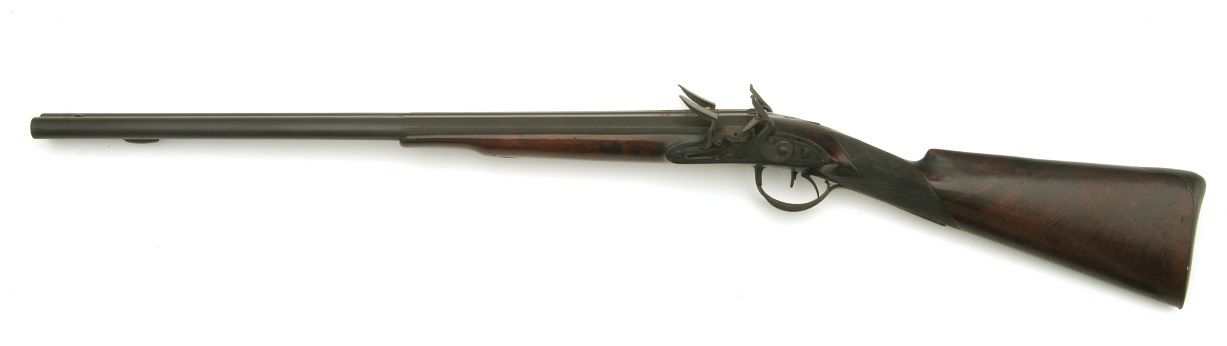

Then, we have later stocking up apparently in the UK, in the early 19th century, and have an Earl's coronet on the wrist.
So what do we have?
I will attach more photos tomorrow.

I am not a French speaker but, i would not get it how 'leconois', assuming this is the exact word engraved, would give a derivation to 'lesson' (in french leçon) or that it would be relative to apprentice (in french aprentis).
On the other hand, assuming these inscriptions are indeed French, their relation with the maker of this double barrel would not be coherent if such barrel is indeed Spanish, but that is something that remains to be established, as admitted by Richard.

... The marks on the barrel are those of Luis Santos, and whether they are correct or a bit later forgeries I do not know. Many Were forged with famous Spanish barrel -maker marks applied, and these were difficult to tell apart from the real ones even in the 18th century.
I did have a short thread about the Santos stamps some time ago, and they Do appear correct....

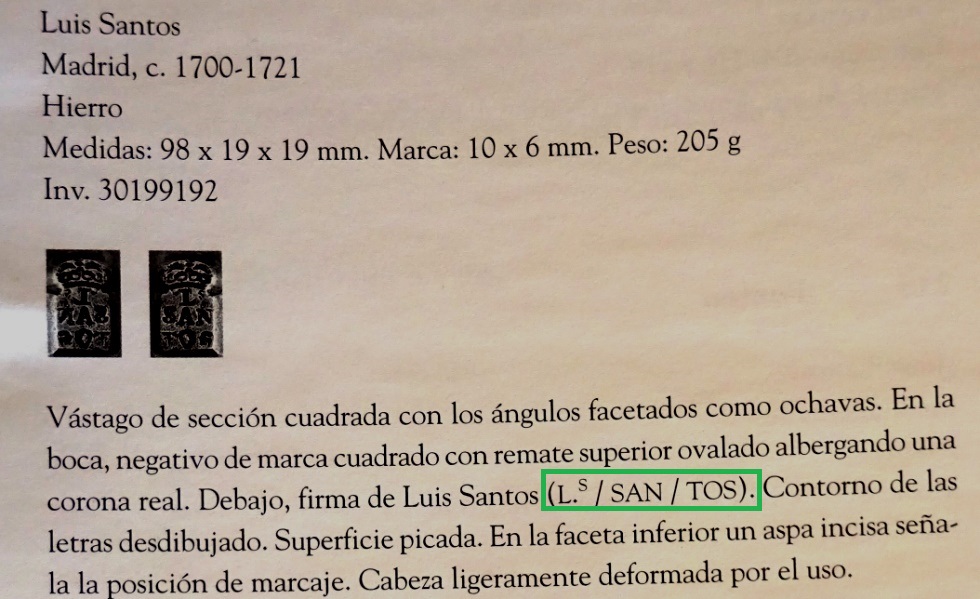

Loking at various examples shown and described in the Catalogue of the Real Armeria, we see consistency in a little detail; the L. for Luis is followed by a minuscle s. Can you check whether the digit after the L in your barrels mark is a dot (as i see it) or a s ? Maybe this could help verify the mark authenticity.
Originally Posted by Pukka Bundook
... The problem with this is that Luis died in 1721, so if his work, they are Extremely early for a set of double barrels. I Think Keith Neal had seen some from 1723 or so, but these would have to be 1721...
Good reasoning, Richard. Resulting in that your gun, having a French lock, would be consistent with having late XVIII century barrels of French origin, the famous Spanish master marks being a "marketing" operation.

...Then, we have later stocking up apparently in the UK, in the early 19th century, and have an Earl's coronet on the wrist...
And why do think of this as a fact, Richard; the coronet style, or the stock shape ?

On these stampings, the L for Luis is followed by a miniscule Dot, so apparently Not the real deal. This has been driving me a little nuts, so I am very pleased you have shared this with me. :-)

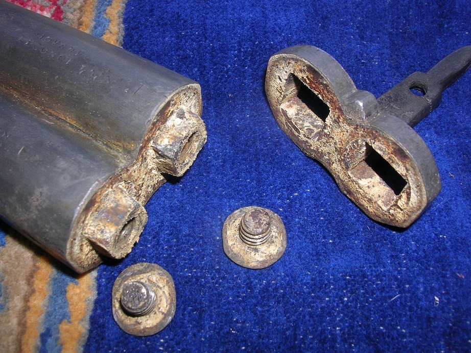

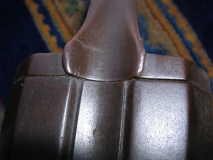

The barrels are still early but may well have been assembled into a gun by Laborde. They are apparently brazed together, with a top rib, and are beautiful work. (Even if not Santos!)
Your quote from "The Field" would validate the time-span as well.

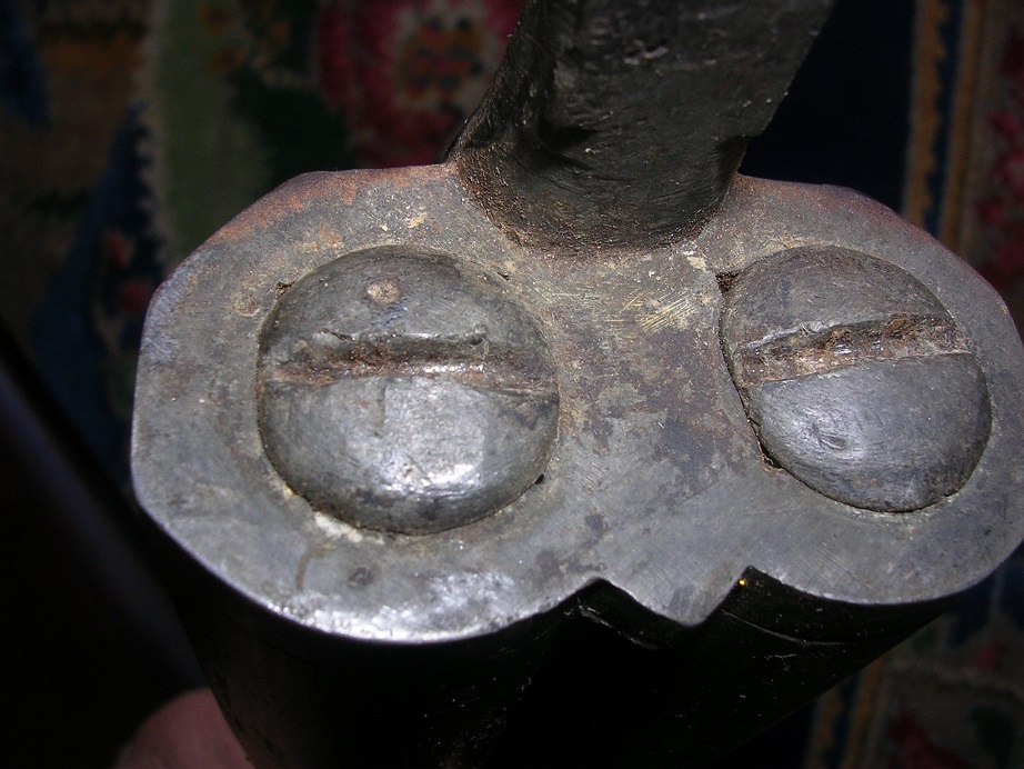

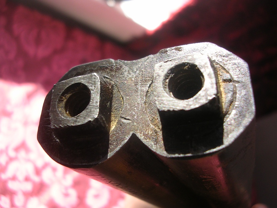

If Laborde work, I think it is fairly early work of this maker, as the manner of attaching the barrels to the breech is not a standard procedure. Please see pictures.
This is not the usual hooked breech we normally see, the barrels and false breech must be lifted from the stock as a unit.
My pictures of the stock are too large, so will reduce them and post later.
The stock is newer, and has an "English" look about it. V high quality walnut. It seems the original Laborde furniture was fitted to this stock.
I value your thoughts on this !

Definitely the barrels are French. The lettering after Leconois is a word: L'aîné, meaning "the oldest son". It is known that Laborde (1745-1760) was often named as Le Jeune (the Young), which suggests a Laborde father (Bordeaux 1730 ?). However in the case of your barrels i would not discard the possibility that the epithet goes for the "oldest son" of such Leconois, the name of a less kown (so far) barrel smith; you know, Laborde being a whole pistol maker but using contracted barrel smiths for shotguns ?. Besides, one finds it hard to see Laborde forgering his guns with Spanish marks ... or has a Laborde lock been implanted in the dicussed shotgun ? .

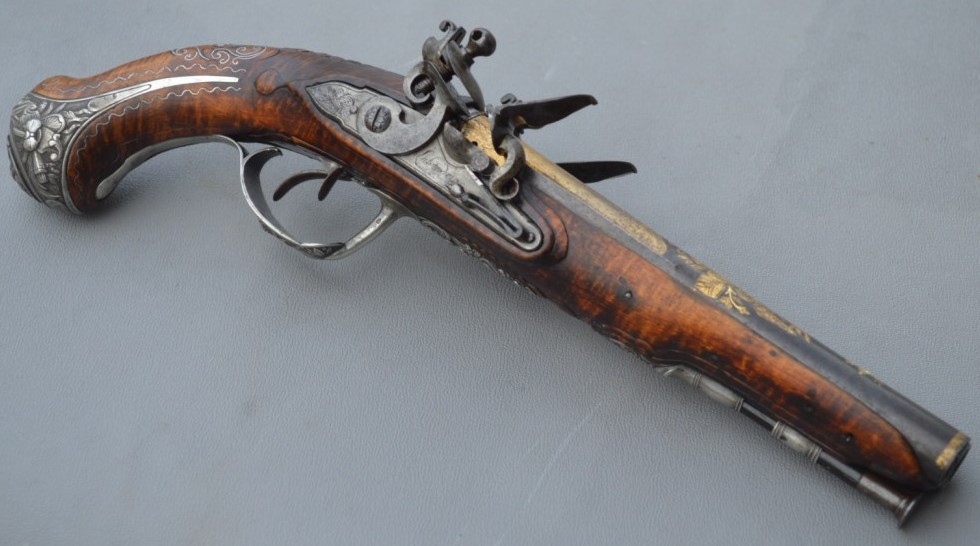

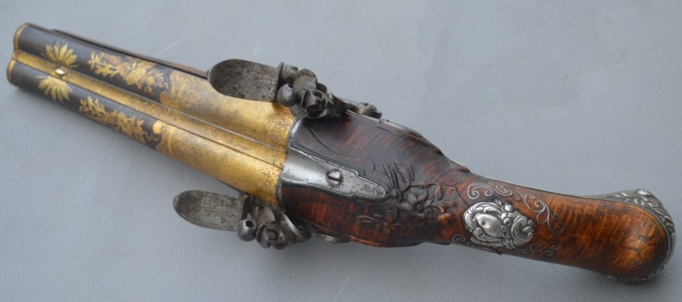

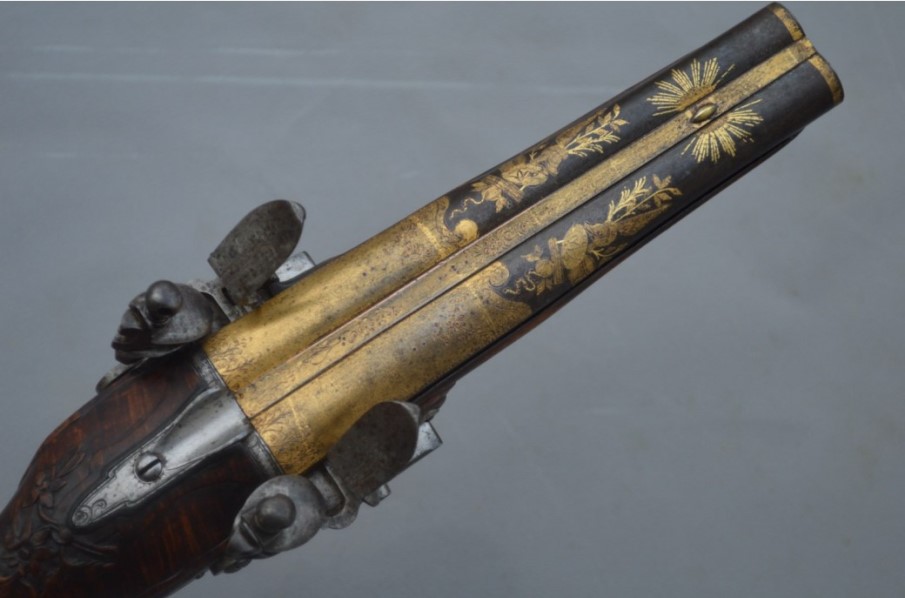

Just for the fun, look at this hunting pistol by Laborde a Paris.
(Courtesy Galeriedemars)
Old 27th March 2018, 08:01 PM   #13
Pukka Bundook
Join Date: Jan 2007
Posts: 803
Again, a Very helpful reply Fernando!
I believe you are right; That Laborde did not make the barrels. Most gunsmiths bought in their barrels and I see this as most likely in this case.
If Spanish barrels were selling at a premium, as indeed they were, I do not suppose he had any great worries regarding supplying what was in demand. :-)
That is a very beautiful pistol you show!
Very nice work. The cocks are very interesting, as we think of them as later than Laborde was working. The trigger-guard is the same 'pillar ' type as on the gun in the opening post. Not exact, but same style.

You showed L Santos marks in Lavin, (with miniscule S) and also L Santos in Isidro Soler's work, where we see the dot and no little 's'.
So where does this leave us my friend?
Yes, you said in that post that makers did not always use the same punzon,
so is there any way to say if the marks on these barrels are fake or genuine?
Kind regards,
Richard.

I am sorry Richard, that my words made you realize that it was a decisive diagnosis, whereas my approach was more on the 'food for thought' basis.
Still in the mentioned previous thread i submitted that marks depicted by Soler and Lavin are drawings of punzones whereas all those three in the Armeria Catalogue are images of the actual thing.
On the other hand, being the discussed barrels of Spanish origin, why the heck should some Frenchy's 'oldest son' punched that inscription underneath ?
Again something (only) to think about, nothing ultimate.

In "An Essay On Shooting" (1797) we read that fake marks were common and very hard to tell from the real thing, so it appears that the faked marks were nearly perfect. This takes me back to the conclusion that the marks on these barrels are fakes.
The big trouble with this conclusion, is I must then wonder why make a perfect forged mark, ....then give the game away with French writing!?!
Sometimes things just do not make sense.

Thank you my good friend, for all your help on this.

Just think of it as being genuine Spanish barrels for exports, receiving a French inspection countermark at arrival .

"Just think of it as being genuine Spanish barrels for exports, receiving a French inspection countermark at arrival ".
This may be Very close to the truth!
