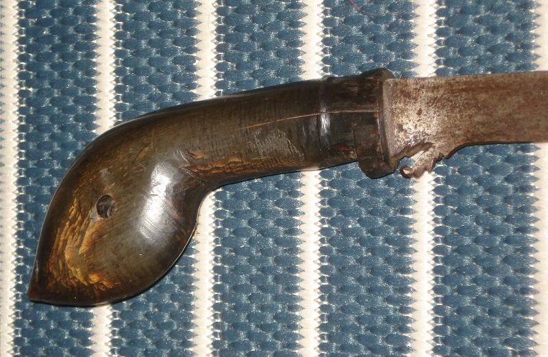

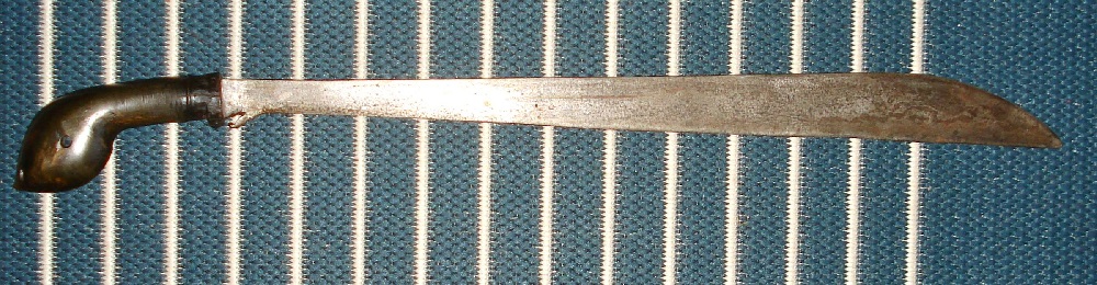

Here is my birthday present received a few days ago.
It has some points in common (at the handle) with a pedang of palembang hinterlands posted a few days ago, but the shape of the blade is very different.
The blade is very wide at its base (1,5cm) but especially it has a Kembang Kacang and a very nice pamor that looks like pamor "Udan mas" of keris.
There is some remaining red paint at the base of the floral part of the handle.
The sheath seems a little more recent than the rest of the sword.

Hello Séverin,
Congrats, that's a neat catch! And my best birthday wishes!
I'm fairly sure this it not Rawas since the pommel shape is not matching. Highly carved Rawas hilts look different, too (cp. the attached pic from the other thread ).
This pedang variant has usually been associated with southern Sumatra, possibly Palembang.
In a recent thread, I believed at least a subset might originate from northern Malaya (Kelantan/Pattani); there seem to be some other leads, too. I'm still researching this topic. BTW, mine example has complex surface-manipulated pamor, too!
I reckon the darker grip part wasn't painted (braided wire work partly missing)? Do you have any examples of the typical Palembang lacquer work? How does this painted pommel compare with the former?

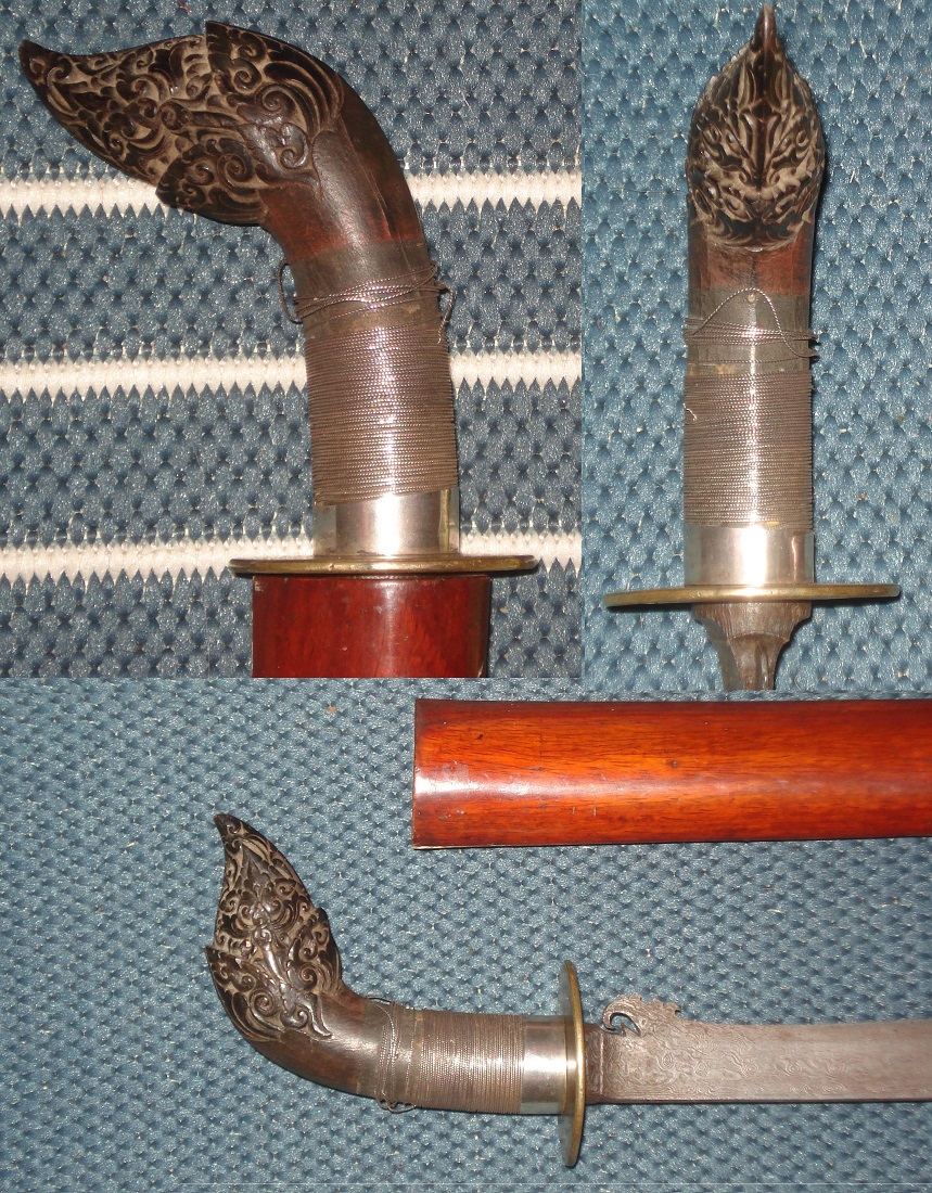

..sadly I am not able to post pictures from this sword since it's not mine but the owner is a member of this forum, I will give the member a hint, maybe he will post pictures from his sword.

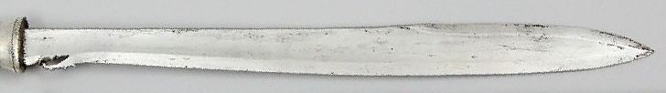

After contacting my friend I am allowed to show pictures from the blade, the pictures are from the auction. It's for sure a Sunda sword.

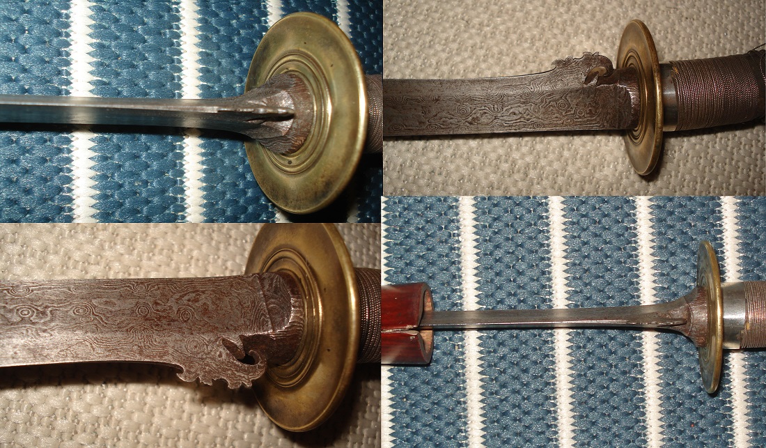

I did the photos but I left in Italy (Rome) in a few hours I did not have time to transfer them to the computer, cut out, and resize to post them.
I will post them Tuesday night.

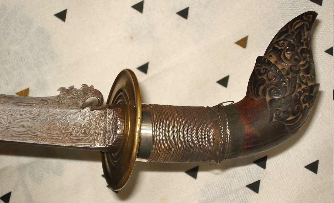

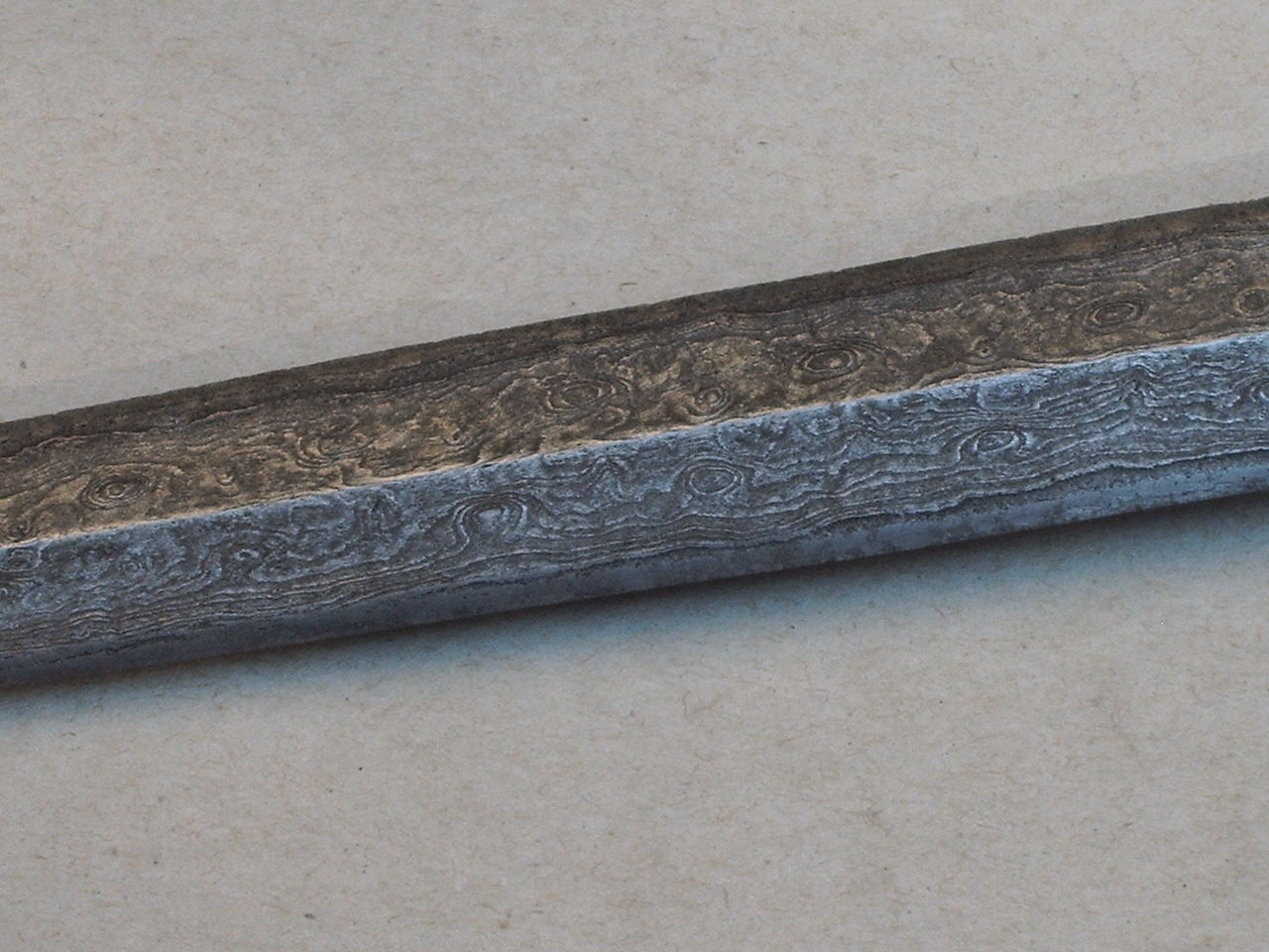

With one week late, the pictures :
Old 13th March 2018, 08:59 PM   #23
Posts: 9,202
Hello Séverin,
what a beauty! Can you post pictures in this quality from the whole sword?

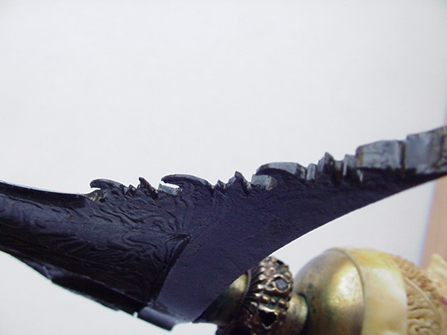

Séverin,
thank you for the pictures.

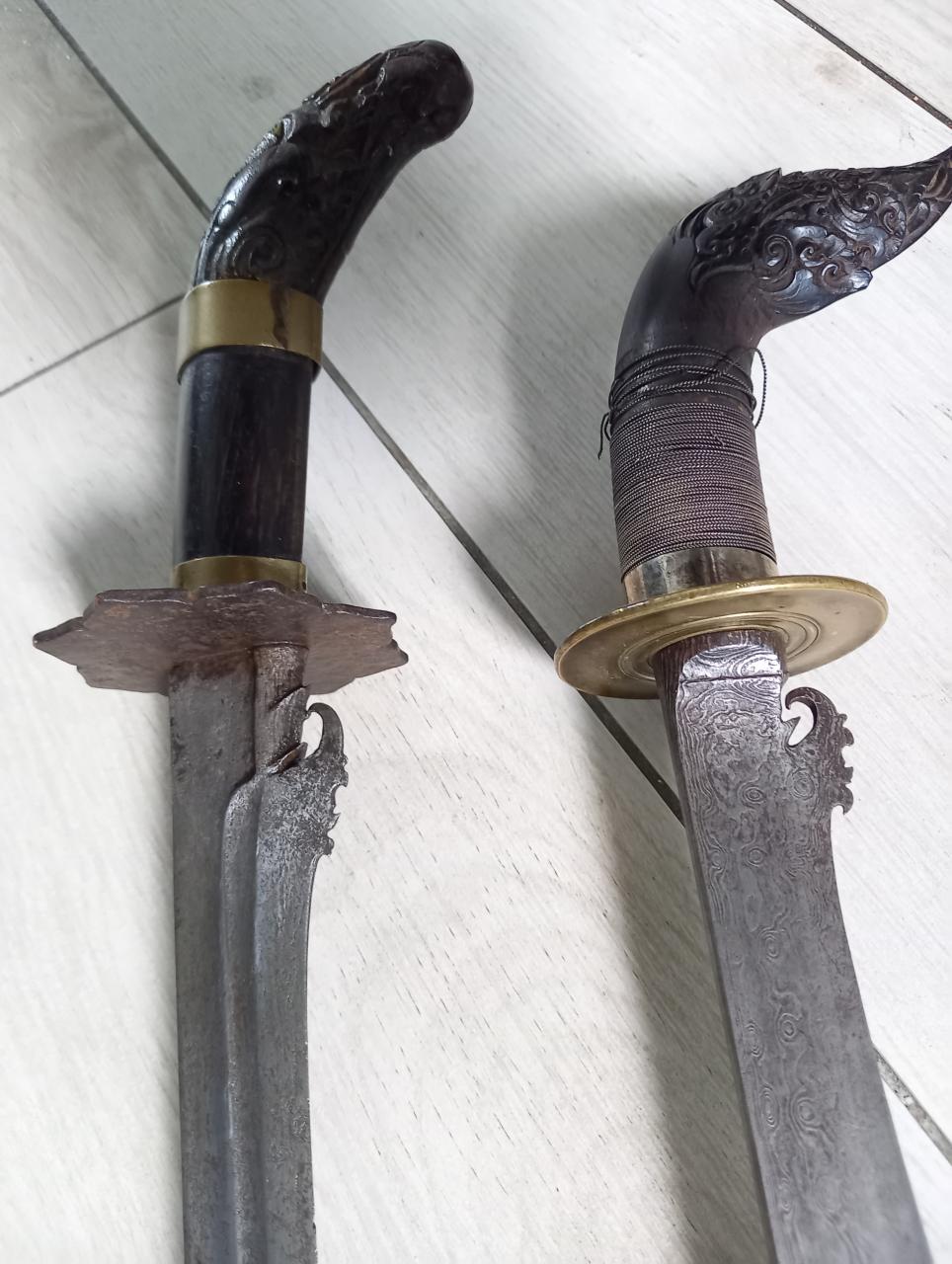

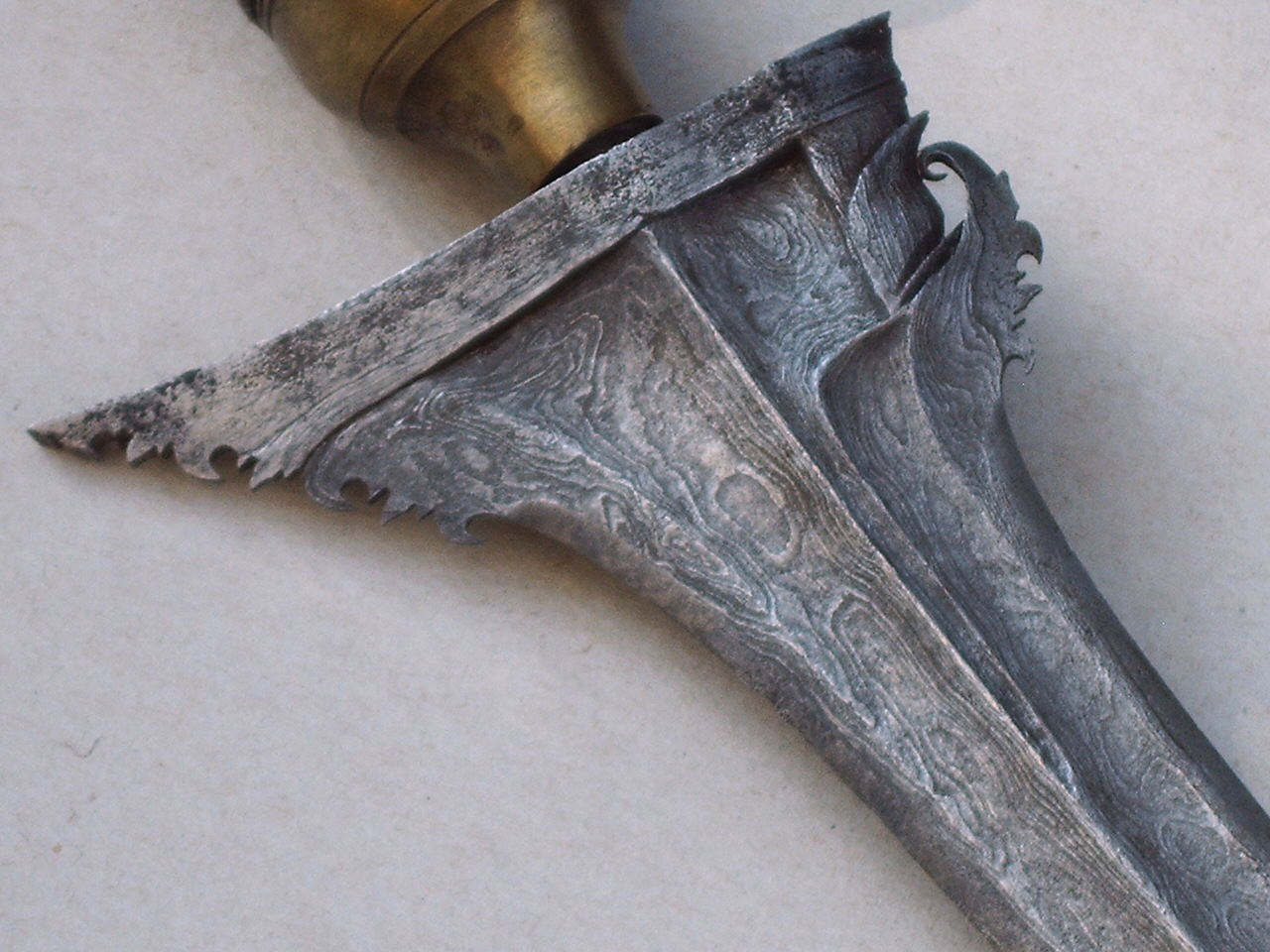

I attach two pictures of a Palembang Keris. They show the typical "thick" Greneng and Jenggot, the edge loosing its sharpness just before Ri Pandan (that's why we more often see a complete Greneng surviving on Palembang Keris) and the Udan Mas-like Pamor treatment.
The Jenggot on you Pedang also is "thick" - till now I haven't see a Sundanese or Cirebon or Javanese Keris with this feature, and my main interest is Keris.
Maybe we could encounter this feature on a Pedang from Sunda - I don't know.
Old 14th March 2018, 12:33 PM   #25

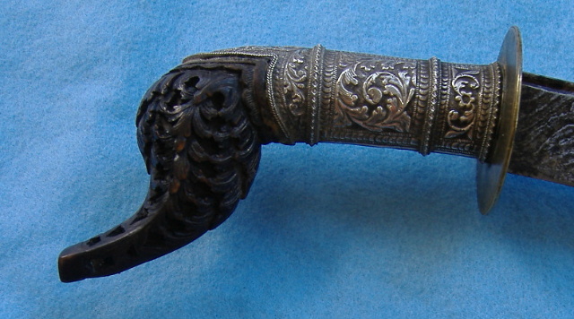

And a picture from the now defunct UBB Forum, which even better shows what I mean:

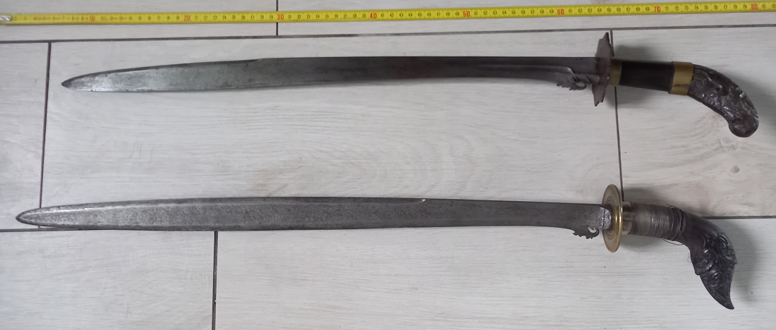

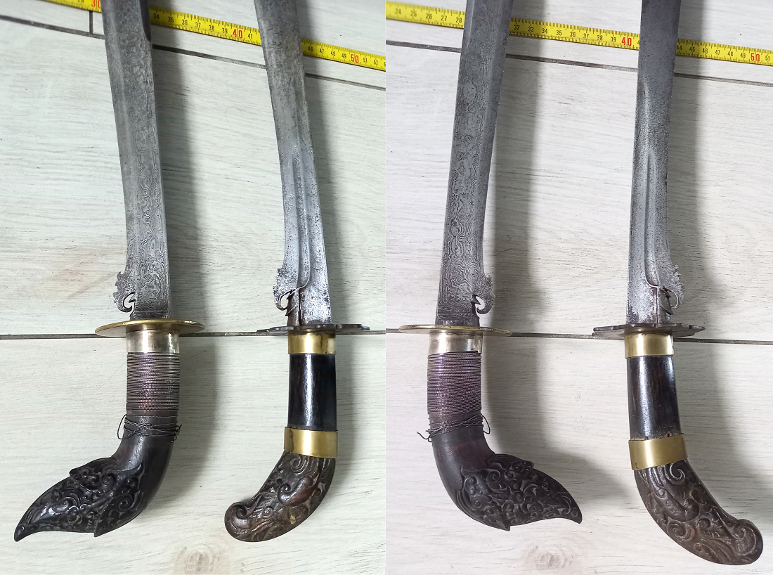

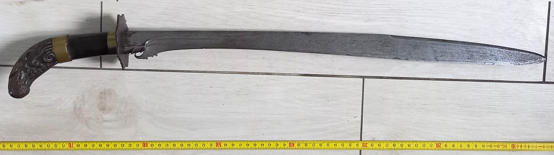

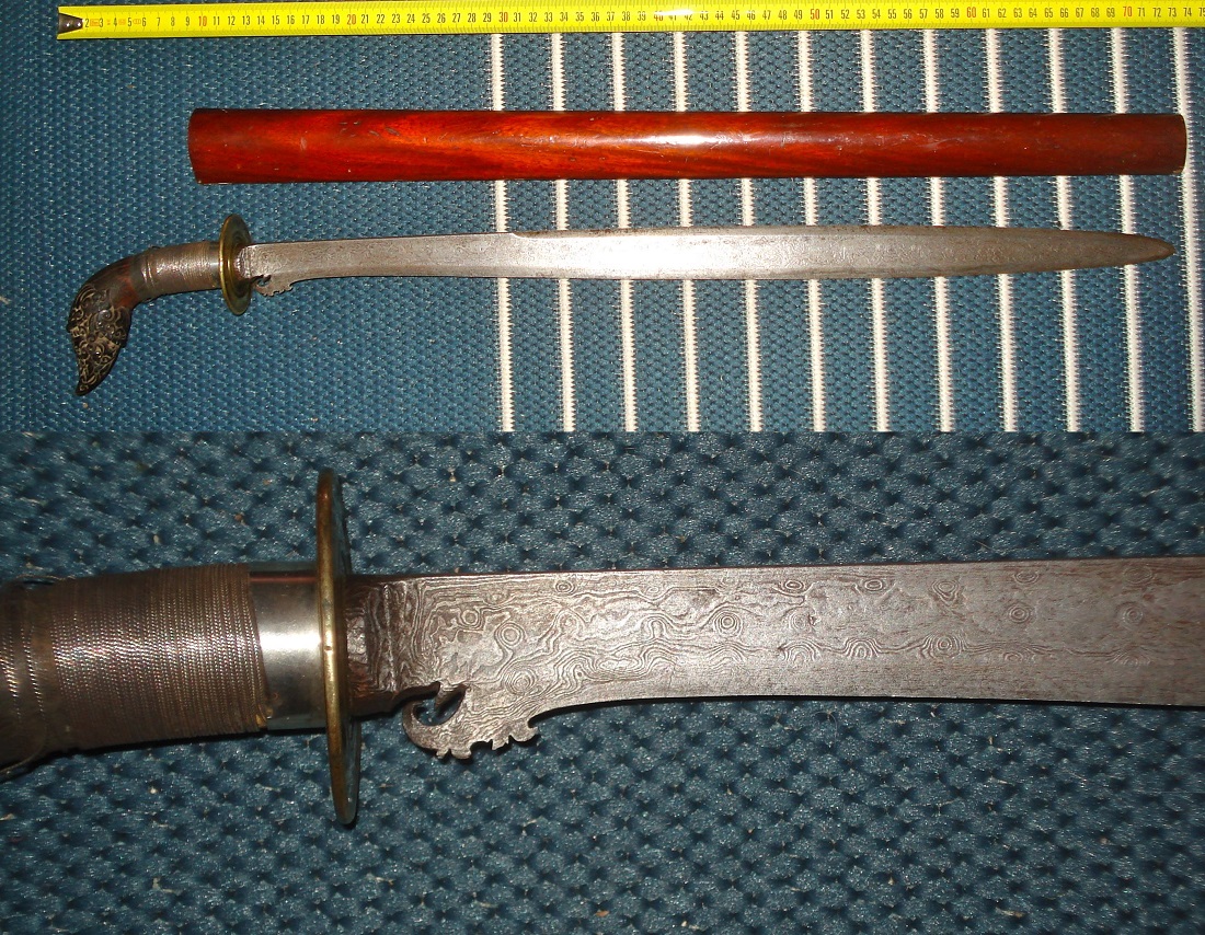

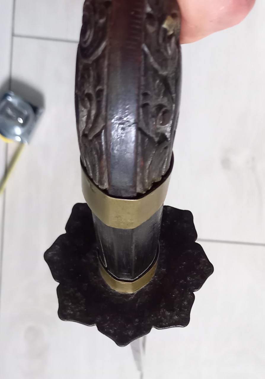

I recently received a new pedang from Sumatra that looks very similar to the one at the beginning of this topic.
The handle is a little different, the iron guard forms a flower with 8 petals.
The blade is imilar but more detailed and better made in the "ricikan" area.
