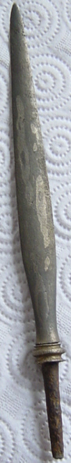

I recently acquired this nice Tombak from one of our esteemed fellow formites. I'm trying to learn as much about it as possible. I can really use your help.
I understand it is hard to give an evaluation using photographs.
First of all I realize it is "out of stain" and it exhibits characteristics that make it difficult to identify as a Javanese Tombak. (Thank you to Alan Maisey for that information). If anyone might have an opinion I would love to hear it.
Another question I need an answer to is; where can one find laboratory grade white arsenic (arsenic tri-oxide) ? Does anyone know the difference between a Tahitian lime and a regular lime. Both these are needed for proper staining according to Alan's detailed instructions.

On the ferrule, it looks like a postmark plane for airmail. Could the brass have come from some postal box?

The Tombak looks pretty good as it is anyway IMO.
If it were mine I'd let sleeping dogs lie .
Does anyone feel like offering an opinion on the specific origin of this style Tombak ?

Yes, its a tombak, but it is out of stain, and there are some characteristics that make it difficult for me to identify as a Javanese tombak. It may be Javanese, or it may not be. It appears to be in overall good condition, ----
There`s just not a lot I can tell you about this *****. Commentary on Javanese wesi aji starts with an attempt at classification, and because this is out of stain and has some non-typical ( for Javanese) characteristics, there is no way I could make a sensible classification. Sorry.---"
I do not know what is , and if I do not know, I`m not prepared to guess.
If I had it in my hand the story could be different, but giving positive ID`s on the basis of a photo is something that I am often just not good enough to do.

David, I didn`t say that there were non-typical characteristics, I said there were characteristics that made it difficult for me to identify as Javanese.
The overall look and proportion don`t click into a tangguh slot, the ada-ada is very thickly ridged, the material looks a bit porous but this might just be excessive use of acid in cleaning, the metuk---this will be found to be mechanically attached, not forged as one with the blade--- the metuk could possibly fit a couple of classifications, but it seems to combine characteristics from at least two different classifications, possibly three. It might be Javanese, but without it in my hand, I`m not prepared to say. Look, this is not a top level, court quality tombak:- its a nice old fairly middle of the road example. Tangguh was never intended to apply to every piece of wesi aji under heaven, and the further away you get from court standards, the more difficult it gets to fit any wesi aji into a tangguh slot. Tombak are much, much more difficult to classify than keris at any time, and when you get a few pics of something that might or might not be Javanese, its just too hard to be positive about anything. In the hand it may be possible to look at different angles, or examine the texture under a loupe, or gauge the weight, or feel the texture, but from photos I`m afraid its beyond me. Now, if I were to take a punt and say---yeah, OK , probably Javanese---the next question is---oh, its Javanese is it? How old? What tangguh?--- my answer---I don`t know---well how can you say its Javanese?
Actually, my gut feeling is that this tombak could be Balinese.
But don`t hold me to it---that is just a gut feeling, based on a photograph.

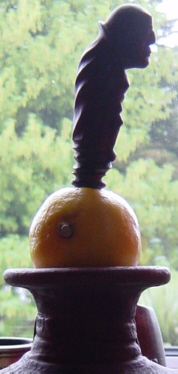

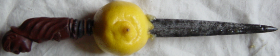

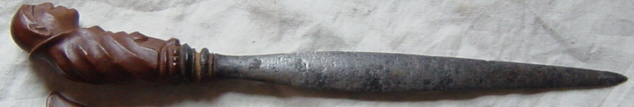

As far as staining goes, why not start with this tombak?
I personally think it would be a good thing to start with.

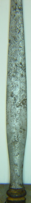

At least its got good clear pamor that you can be fairly confident will show up OK after staining. A lot of old blades, especially old junky ones just show grey and grey with low definition, and a beginner doesn`t know if he`s on the right track or not.
Give it a good scrub up with hot water and dishwash detergent, a light bath in pineapple juice,rinse off,dry, and go right to it, as long as you can get the arsenic, and that might be the hardest part.
One thing is certain:- you cannot do it any harm. If it turns out too dark, you just clean it off with bonami or some other powder sink cleaner--ajax maybe---and try again. In Jawa we use abu gosok---an ash used to polish pans--- and coconut husk, but ajax and steel wool works just as well. I`ve been playing around with cleaning and staining for about 45 years now, I`ve been taught several different methods and have developed a couple of my own. There is no magical secret attached to blade staining, its just patience and experience, and if you get it wrong, clean it off and try again.You definitely cannot do any damage to the blade if you tackle the job correctly.

My main focus is the size of the bottom of the ferule for a first indication. It’s (again in my humble opinion) mostly seen in heavier and larger spears, which makes sense if you imagine the force used with these things (Some were over 2.5 meters long). These spears are called landeyan (I believe) and indeed used in Java and Madura.
(Always wondered if the name could come from the dutch, langejan=Long John; no prove though but the period seems to match).
The dapur is in my opinion common for java. The higher section in the center has the function of removing the spear more quickly after contact with its target and it will create more damage. (The broader base helps to increase the “stopping” power). There is a kind of dapur originally containing holes, but I forget the name ) Holes look a bit like made in later stage. If they were not then Java comes to mind again. As mentioned the are probably for decoration purposes, since these spears were used in (keratin) parades as well. (they still do have those parades)
Pamor doesn’t have the "madura" feel, the small lines on the side of the blade are more seen in java pieces ...it doesn’t really match from what I see from Madura.
Dating is a rough quess, but I placed it somewhere between the arrival of the Dutch and from the looks of the spear not younger then 200 yrs. Markings of numerous cleanings would have had its marks not only in the ada-ada area but on the side as well. I have no specific comment on quality, since its obvious not created for royal ceremonies. However from what I see it looks like it has been actually used (which is not really that surprising). 2 smaller cuts on the side and traces of scars in the center, so I would argue that its not well made. From the “wear” around the border, the well shaped “ferule” I would call it good quality.

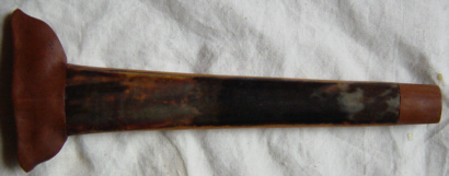

This does have a scabbard with a thin slice of turtle on the outside. I have shown it in the past.
I have the tombak set up like this, in the opening of a pot. It has been like this for about 4 hours, I think something is happening I can smell it. Every now and again I move the blade in and out of the lemon to keep the juice wet. How long should I keep this up, days?
Old 14th May 2006, 09:52 PM   #29
doecon
Posts: 63
Mhwaauhaha, great experimental setup. I think you should leave it a couple of days I bet you will see some nice shinny "white" blade...
