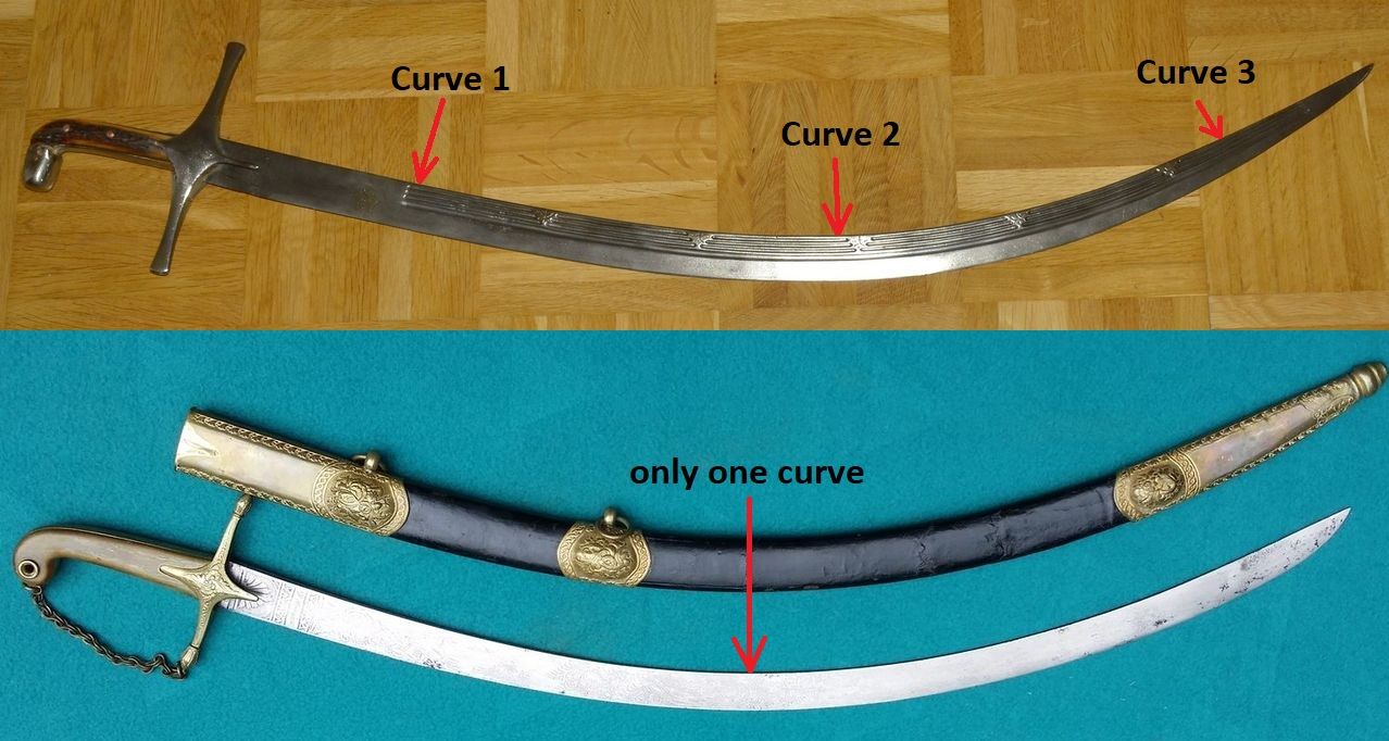

The great secret of the Persian Shamshir is that the blade got at least two curves instead of one on European blades!
Please look at the first picture with the curves now. My Shamshir got three different curces, the smallest radius is shortly behind the middle of the blade.
The German copy of the Shamshir got only one curve.

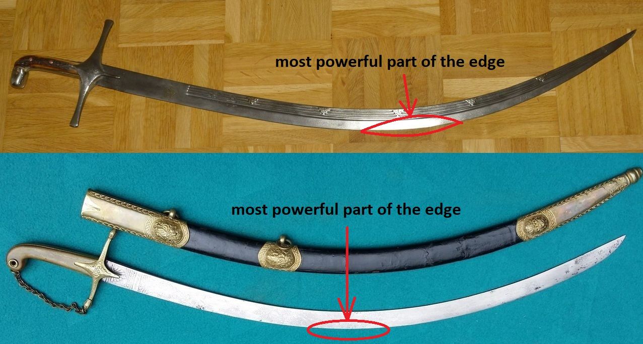

This leads us to the next picture, the most powerful part of the edge. The most powerful part on a curved sword is the "deepest" point.
I highlighted the areas in the second picture.
It is clear to see, that the most powerful part of the Shamshir is closer to the point.
Closer to the point results in more velocity, which results in more kinetic energy and more impact power.
Another very important effect of the two radius design is that the blade hits its target in the right moment, when it reaches its highest speed.
This is ideal, slightly curved back plus a small radius for maximum impact power.

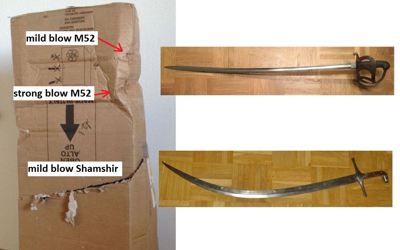

As an evidence for my opinion I added a picture of the cartonage in which the Shamshir was delivered.
It was a mild forehand-blow with the untouched Shamshir, which was not really sharp. But to my greatest surprise, the massive cartonage was almost cut in half.
I tried the same with a mid 19th ct. German M52 saber (850 gramms, blade 85 cm long), which was brutally used on battlefield.
The M 52 also was much sharper and thinner than the Shamshir but nothing after the first blow with the same speed. I made a second attempt with the double speed, resulting in a little bit of damage.
I know, the comparison is not 100% meaningful, but we see total destruction after a mild blow vs. nothing (german blade was much sharper).
I am sure, if I do the same thing with my French M1822, which is much bigger and heavier than the Shamshir, the difference would still be breathtaking.

"how do you define separate curves? "
Sorry, this is obviously to see and I also highlighted it.

Nah, that's only the tang: E. g. your real shamshir starts out with a (slightly) curved edge already. However, I don't believe this has any importance since this part of the blade won't do much cutting...
That won't cut it as I tried to explain: If you prefer to dissect a continuum, you should define working criteria (when striving for reproducible results).

Originally Posted by Timo Nieminen
I can't tell for sure from the description whether he gives the centre of percussion (i.e., the centre of percussion as defined by all non-sword people) or the closest-to-the-tip node of vibration (which is often called the COP by sword people).
The key to what is actually measured is that last word, "vibration". I think the measurement is a measurement of the node of vibration, but I'm not certain.
Sweet spot and center of percussion are terms from Baseball. I have serious doubts, that we can use such terms for describing swords. Because the specification is quite different.
At least a Baseball bat is no static device.
Also the point of balance means not much or nothing. For example the POB of the shamshir (1kg) is ~18 cm away from the guard. On my European rapier (1kg) the POB is ~5cm away from the guard. But the Shamshir is clearly mor agile and more flexible to use than the rapier. So what does the POB says?
Theory (!): In a two dimensional coordinate system we have two axes, the x and y-axis.
If we describe the POB we use the lengthwise axis, which is normally the x-axis. But the POB on the y -axis is also important! The POB should be as close to the cutting edge as possible! This leads to a more stable blow. Maybe this is one reason for the 38 fullers, next to a lower weight.
I found out for myself, that all modern technical terms are pretty useless to describe a sword. So I tried to avoid modern technical terms in my text.
Tons of technical descriptions are nothing compared to a real test blow.
I tried out the usability of many different sword types (normally without cutting tests), so I'm pretty experienced in this field. Nowadays I can hold a sword, make some blows in the air and I can say, what it is designed for (for example once I tried out a long Afghan Kyber knife/sword and it was clear within seconds that this is a cutting weapon, despite its sharp and long point. Later I found out, that this is absolutely true).
My concluison: Modern technical terms are between not ideal and useless to describe an ancient edged weapon.
Roland
