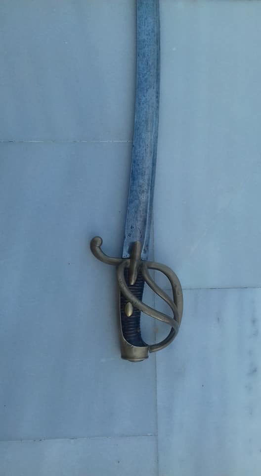

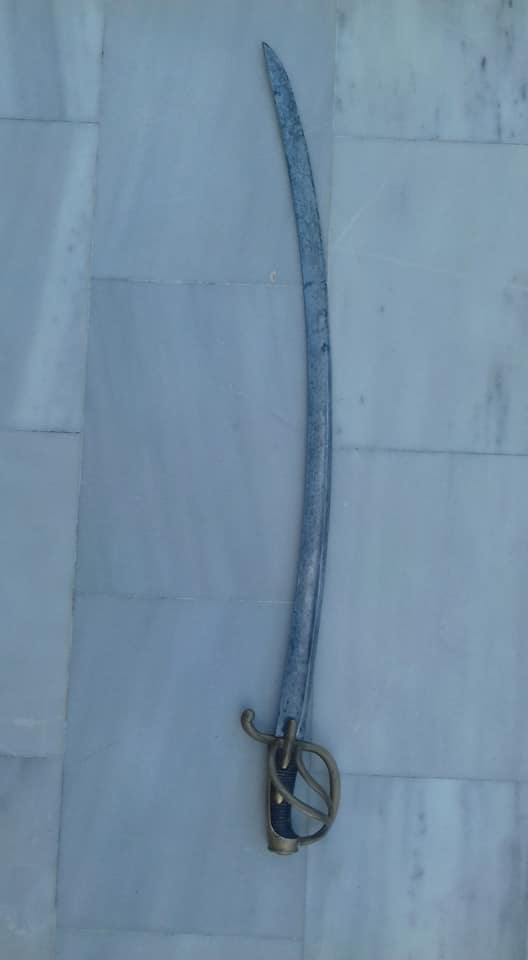

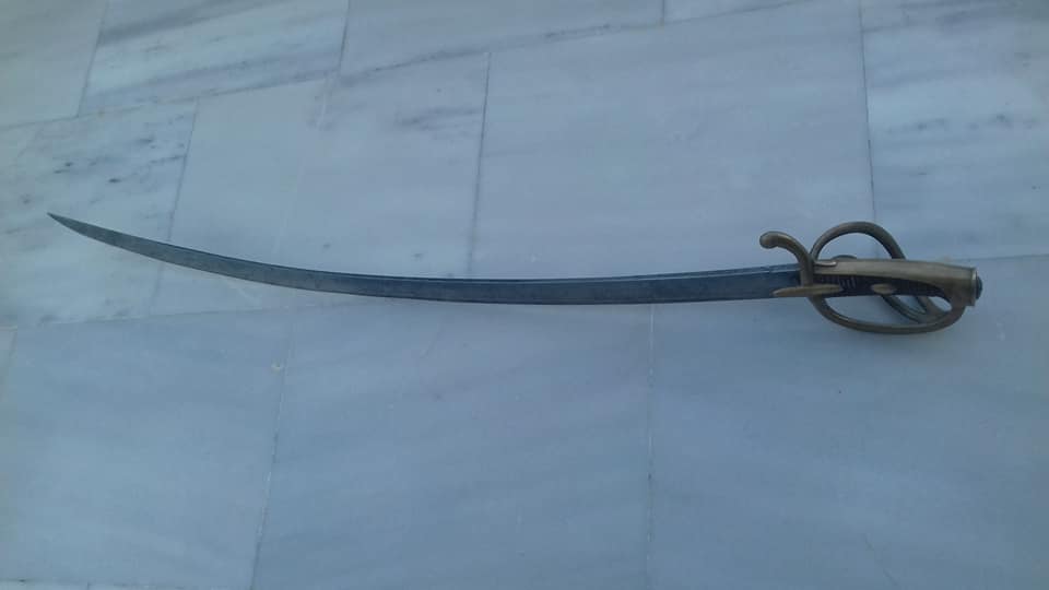

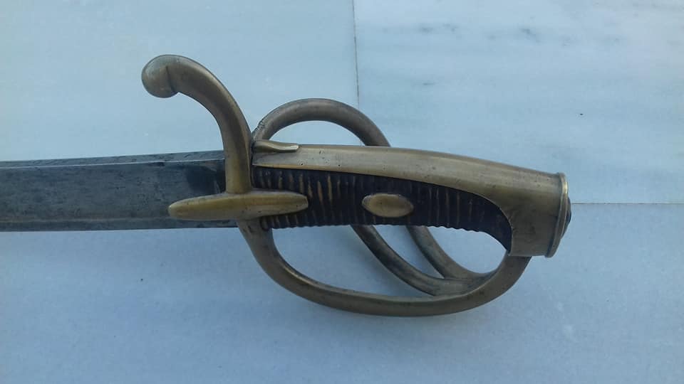

Hi all! This is my first Napoleonic sword. Very nice light and long blade. Does anyone know more about these sabres?

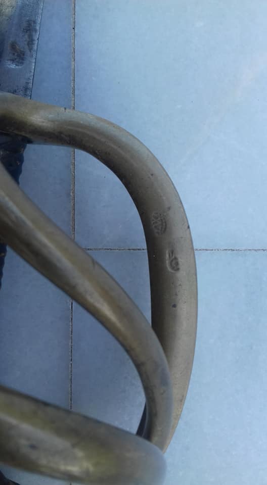

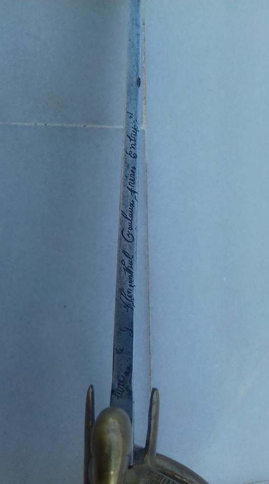

Default manufacture markings

Sabre Mle.: An IX ( about 1802 - 1803 )
Manufacturer on the back of the blade : "Mfture. nale. du Klingenthal Coulaux Frères ent."
Hallmarks:
On the blade: "M under gear" = J.J. Mouton (July 1798 - February 1809), 1st class controller and "LW framed by a string of pearls in the oval" = B.P.C Levasseur (March 1798 - September 1803).
A rare saber.
Best regards
Canos
