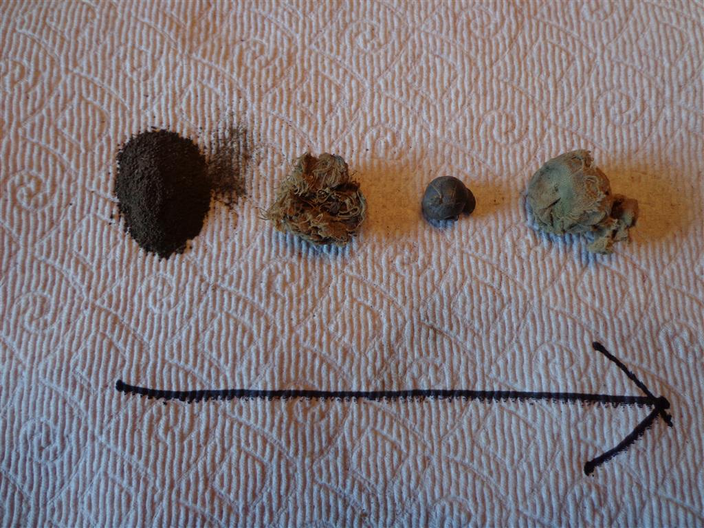

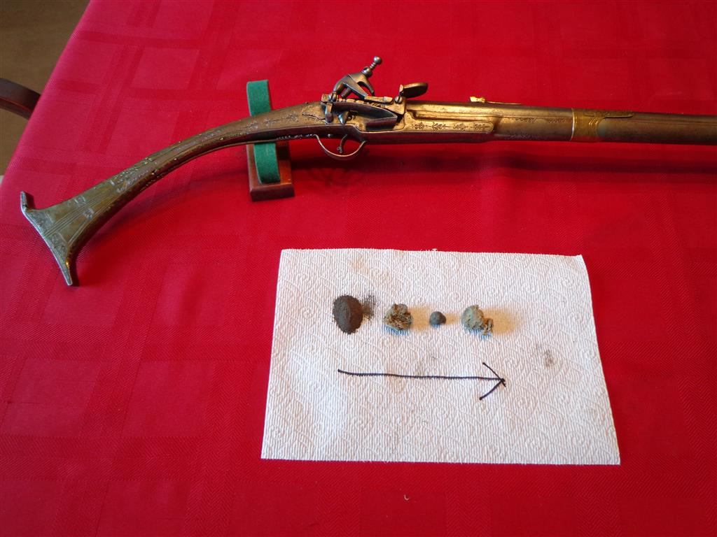

Which, makes it very curious, as Richard mentions, that many of the Indian Torador barrels had the larger than bore size powder chamber at the breech with the constriction to keep the projectile a small distance away from the powder, allowing more oxygen in the chamber, - and were still building barrels this way in the 19th Century. Although the breech wall thickness on these barrels are very thick and heavy on these barrels. Possibly able to handle the more powerful corn powder (?) The locals also thought this barrel design was more accurate.
A few years ago I read of a test that was performed. The shooter used an original 1880's U.S. Springfield Trapdoor Rifle, and a mint condition, unopened box of original U.S.Government 45/70 black powder loaded ammo.
Also, another box of hand loaded 45/70 ammo using the same volume, bullet weight, etc. (70 grs. FFG I believe) using today's sporting black powder. The result was about a 15 percent increase in velocity and accuracy. Of course, this did not surprise most observers. Even taking into consideration the age of the powder in the original ammo, it's interesting to note that today's sporting black powder is more powerful than the same powder made as late as the 1880's.
As long as we are on the subject of powder, I thought I would post this photo below. A short while back I bought an Albanian Tanchika long gun that still had a load in the barrel. Fortunately, in this case I was able to extract the load from the barrel without disturbing the contents. The powder is of the corn variety, but the grains seem a bit inconsistant. Even though I traded the gun, I still have the contents. Interesting to see how they loaded the gun. The ball was considerably undersized which allowed me to keep the contents in such good condition after the extraction.

1. As regards the relative strengths of the powder in the cartridges used in the comparison test, I would still make an allowance for some deterioration in performance as a result of over a century's storage, even in a "sealed" cartridge case. Black powder has always consisted of only 3 ingredients, and the "optimum" formulation has been hit upon in both Eastern and Western cultures centuries ago. The standard formula used in Western Europe, Britain, and the US has remained constant for over 150 years, and variation in performance can most likely be attributed to quality of ingredients, and storage conditions over time. Even in a "corned" configuration, black powder has inherent instabilty. It doesn't settle or separate into its constituents like "meal" powder, but the ingredients, especially the charcoal, are a magnet for atmospheric moisture to a degree that nitrocellulose (smokeless) powders are not. Remember the old saying "Keep your powder dry!"? Brass cartridge cases (as in the case of .45/70 ammo you mentioned) protect the contents a lot more effectively than powder flasks, or the wooden barrels formerly used for bulk storage. Yet I've pulled enough heads from cartridges that have exhibited greenish gunk and other shmutz on the outside, and have found it on the inside surfaces as well. As I recall, in older American cartridges like the .45/70, the case lip was crimped against the sides of the lead slug, and the slightest microscopic gap in between is enough to let in enough ambient atmospheric moisture to degrade the powder to a certain degree over more than a century. Not enough to render it entirely impotent -- a 15% decrease is not enough to make the thing totally "safe" and as you know, excavated ordnance from the Civil War and Franco-Prussian War have gone off with a healthy bang when detonated. I think that certain European cartridges, like the 11 mm Gras, Mauser, and Mannlicher rounds which have a wax-impregnated paper "jacket" which surrounds the slug as the brass is crimped over it, might provide a better anti-moisture barrier.
2. Not surprising that the powder recovered from the chamber of that Balkan gun had uneven grain size. It's likely that a lot of the powder made locally was handmade in mom-and-pop village operations, which didn't have the machinery that commercial or military powder mills were equipped with at the time. However, the stuff no doubt worked well enough for the purpose. It seems that these cultures had their own methods for grading the quality of local powder (there is mention of a grading scheme in Delhomme's report on Moroccan gun manufacture that I cited in a prior post), so they must have had a way to optimize the use of the product available to them.
