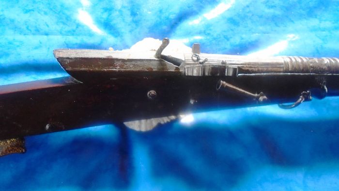

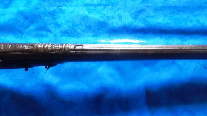

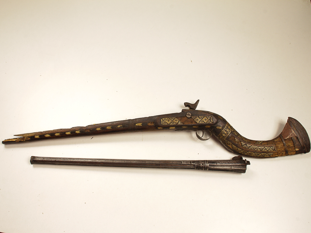

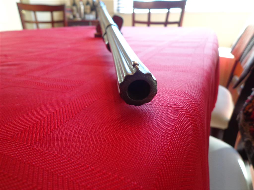

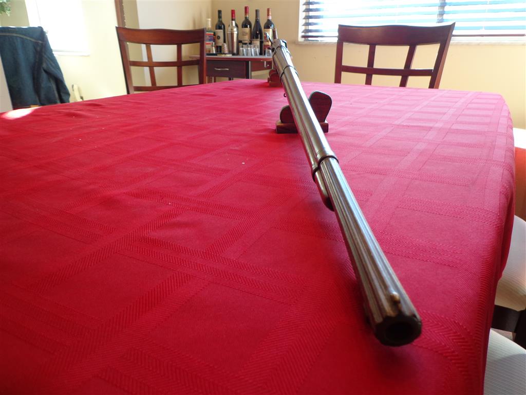

Hello all.
I don't have one of these Omani guns in my collection. But I have always wanted one of the barrels. Well, I now have one. I just could have never thought I would obtain one in this manner. LOL
Judging by the stock, someone in the latter 20th Century built this gun from scratch, but utilizing an original Abu Fathilah barrel !!! I have no idea if it was built for shooting or just for display. Seems like a lot of work just for display. I'll check the bore to see if there is any evidence of recent black powder usage.
The trigger and serpintine are fully functional. Anyway, everything is wrong with this gun except the original barrel. It has a jazail type stock that looks like it's from a Sindh gun, and a serpentine from a chinese gun. LOL Obviously, the builder had no idea what an Omani matchlock is supposed to look like. Too bad. Alot of work when into making this.
I bought the gun VERY cheap, so it really doesn't matter. It was worth the price just to get the barrel from it, which is all I really wanted.

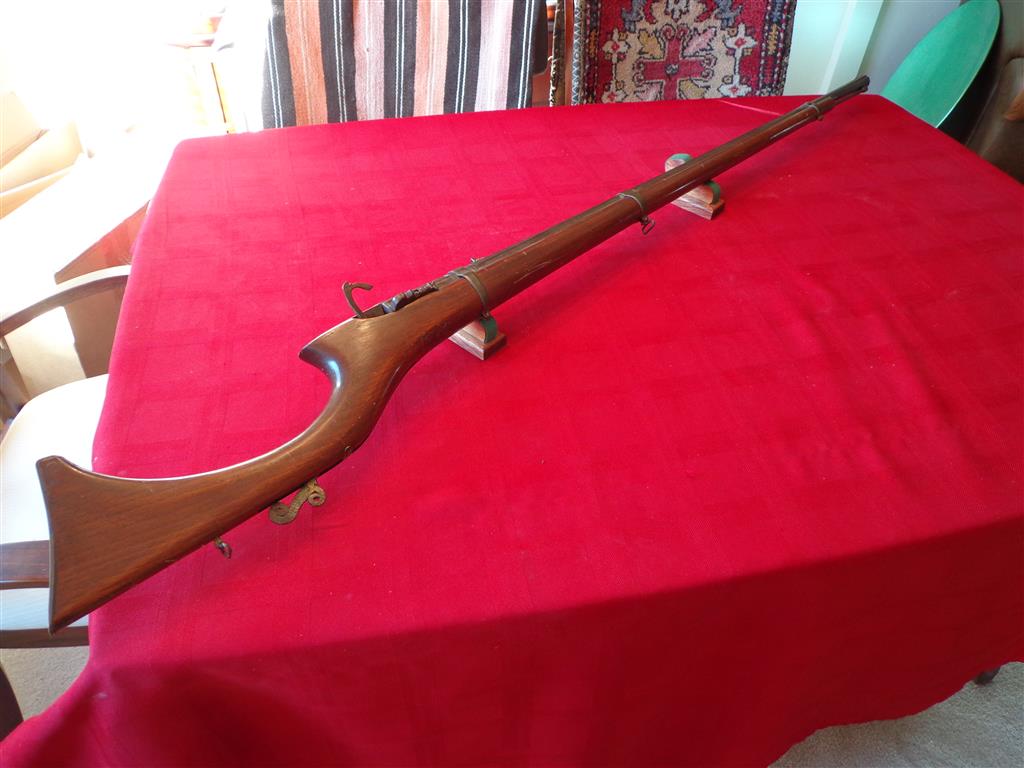

Since this Forum is for original items, I will post just one photo of the gun as I received it, and the other photos of the barrel only, unless other members want to see additional photos - and the Moderator will allow it. I can always PM other members.
I re-read some of the Threads/Posts on these guns and barrels which are very interesting. I can't imagine how long it must have taken to make these barrels.
Anyway, this barrel appears similar to others posted here in the past. It seems in good condition with a heavy patina, but smooth all over. There appears to be two deep makers marks at the breech. The barrel is 46" long and .55 caliber. While some of the decoration at the breech is worn, the barrel appears to be in good condition. There is probably no way to accurately date these barrels since they were made/used over such a long period of time.
So, I now have a Abu Fathilah barrel to add to my collection. Don't know what to do with the rest of the gun LOL

Very nice barrel!
According to Elgood, these Fluted barrels aren17th C.
The 18th C and later ones he shows are not fluted, but still very nice barrels.
I am still "all of a squirm" wanting to know Exactly where these barrels came from, and what they looked like in their original stocking up.
It was very interesting to me, when I saw that Tipu Sultan had two of these barrels in his collection, stocked up in more modern European style, And that the poincons of silver were also missing as we see in most cases now.
This must mean that they have been in many cases missing for a very long time indeed!
I do not see them inthis case, but you are well aware of them I am sure.
Pity the clown drilled the tang but I am sure you can correct it.
Please keep us posted about the re-stocking.

Thanks for the coments. Yes, it's really a strange creation. You would have thought that the builder would have at least done even a rudimentary research as to what the gun looked like before doing all this work. But, no loss here. The price was easily doable just to obtain the barrel.
NO, I don't own an original, complete gun. And honestly, have never tried to seriously obtain one. But I've always thought the barrels were so interesting and full of mystery. So I couldn't pass this one up when the opportunity arose.
Yes, the barrel appears in nice shape. No corrosion that I can detect so far. Just a nice smooth even patina. I'll take the barrel off the stock this weekend and see if there is anything of interest. I'll give it a light oil cleaning while I'm at it.

Thanks for your coments. As you mention, Elgood dates these fluted barrels to the 17th Century. But there does not seem to be any conclusive evidence as to their original origins. Persian, German, ?? But the speculation is very interesting.
I am not planning at present to re-stock the barrel in a more correct, representative manner. But it's a "maybe" down the road. LOL Too many other gun projects at present. But I am sure happy to get this barrel. Especially in such nice condition.
FLASH !!! I just realized there is an obstruction in the bore, at the breech end, about 3" long. And, when you run a wood rod through the bore, and bounce it a couple times, it has that familiar sound of wood against lead.
Will have to investigate this weekend and report back. Could be an old load !! Stay tuned.......

Well, I was partially mistaken. After further investigation here is what I've found so far: Running a wire in the vent hole, there is evidence of powder in the breech. From the muzzle end, there is some type of semi-soft cloth or other fabric about 3" from the breech. Twisting, my patch puller will get a hold on it, but it doesn't want to budge. Hmmmm. If there is a ball/projectile it would half to be behind this cloth/wad/material. I'll try a bit more with the patch puller. Next, I think I will try some boiling hot water or penetrating oil to see if it will soften the material.
So far, I have not noticed a conctriction like on some Torador barrels. But you may be right. Just need to get that piece of material out.

The bore is now clear. Used boiling water. Whatever was down there seems to have melted LOL I also used a smaller diameter rod than I was originally using, and discovered it would go all the way to the breech end. What came out of the bore with a dry patch was the usual black/rust - but also some ugly looking grey colored substance. LOL The bore at the muzzle is about .55 caliber. I've been cleaning using a .50 caliber bronze bore brush. However, a too loose .45 caliber brush is a perfect snug fit the last 4 inches at the breech end. So you are correct. The boree has a constriction, and tapers smaller the last 4" or so from the breech end. That was adding to my confusion. LOL
Anyway, thanks for the tip. Just needs a bunch more cleaning now.

I would have said this barrel is set up in a modern version of the traditional Scinde stock. I have seen a number of these Scinde 'jezails' with this type of barrel. My suspicion is that these barrels, as you say, closely associated with Omani matchlocks, actually originate in Scinde.

Thanks for your reply. Yes, the stock shape of this gun more reflects the stocks made for the Sindh guns. See below. My guess is that this was the stock style used as a pattern by the late builder.

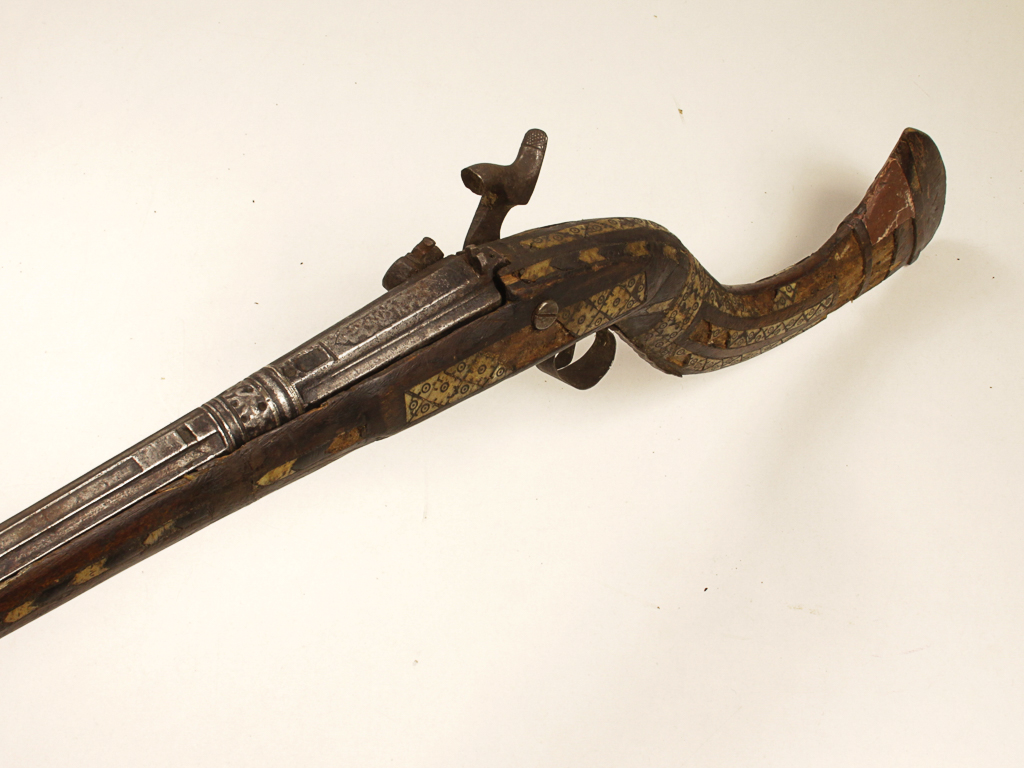

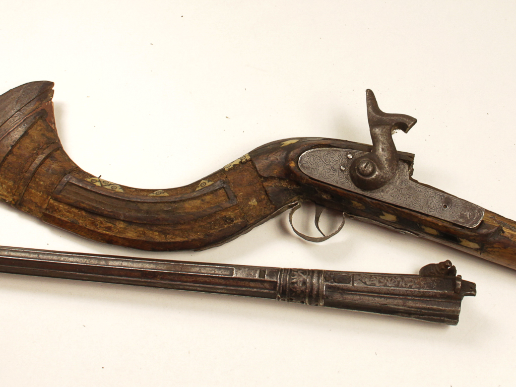

Isn't this one quite similar fluted barrel stocked in poor jezail style?

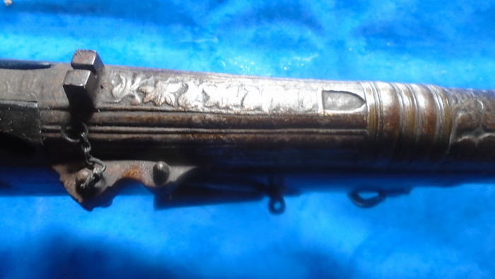

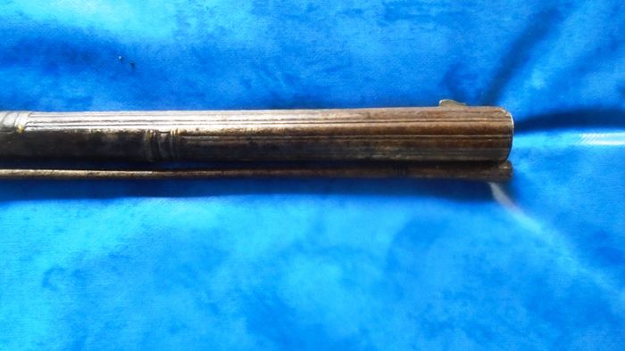

Old 30th December 2017, 04:12 AM   #21
Philip
Philip's Avatar
Location: California
Posts: 1,036
Default great-looking barrel
That sure is a nice one! Is the bore rifled? Any sign of twist forging? The flat-bottomed channels with square ends take a lot of skilled labor to cut, with chisels and then finishing with scrapers and shaped whetstones. The style of those grooves is also seen on the fullering of some saber blades from Eastern countries.
Old 30th December 2017, 04:21 AM   #22
Pukka Bundook
Join Date: Jan 2007
Posts: 803
Grendolino,
Yes indeed, the barrel you show is of the type in question.
A very nice barrel too, with all the hallmarks belonging to this type.
I do not know whether it has been shortened, as it Is shorter than we normally see, and the tang appears shortened or broken off.
Thank you for showing it! It adds even more questions to this equation!!

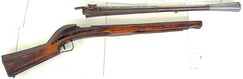

I note that the rear sight has been removed, and a later one fitted right at the breech. All V interesting!
Rick,

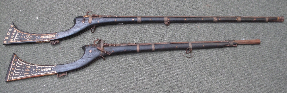

here are the other two I have seen photos of, One tarador and one Scinde fashion;
Please forgive the poor photos, they are all I could get.
Both guns doi show the 'same' barrel style although the torador has a sight at the breech whereas most have the rear sight further forward.
Hi Grendolino.
Thank you so much for posting this Jazail. Yes, the same family of barrels. And this one converted to percussion no less. While the use and re-use of barrels was common, this barrel may have been near 200 years old by the time it was mounted in this Jazail stock. Amazing. As Richard mentions, the barrel may have been shortened at some point. Maybe at the time it was converted.
The original rear sight removed and a simple notch rear sight mounted at the breech, which seemed to be favored on Jazail and Torador barrels.
The prolonged use of these barrels is amazing. Very interesting. And adds further to the mystery of these barrels.

Richard: Thanks so much for posting these photos. Sure enough, a Sindh and Torador mounted with these barrels. First I've ever seen outside the Omani matchlocks. These barrels were more traveled in the Region than I thought.
very interesting. Thanks again.

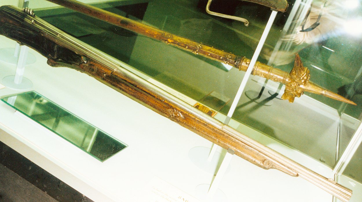

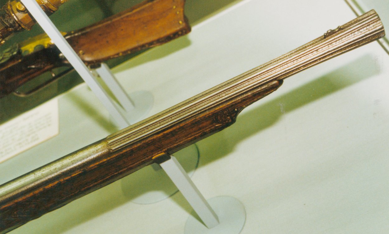

Here's an image of two barrels in the Museo di Artiglieria in Turin, both made for guns originally fitted with matchlocks, 16th cent. similar 3-stage format with fluted ends, faceted or round centers, and with flaring muzzles. They are of short carbine length (a pistone), the one with short tang is 17 mm and the other is 24 mm bore diameter. Published in A. Gaibi, Armi da Fuoco Italiane (Milan , 1968), pl 6 d,e.
Old 12th January 2018, 02:54 PM   #28
Pukka Bundook
Join Date: Jan 2007
Posts: 803
Philip,
The barrels you show are very similar to Michael Tromner's barrell (Matchlock)
His was Tusco Emilian C 1525 if I recall correctly.
Also two rifles (I believe both are rifled) once the property of Henry V111 had the same fluting, and interestingly came from the same workshop but 1540's.
I will come back with a link and photo.
BTW,
I have yet to tackle a fluted barrel! If you have details on this work, please let me know. :
Link to Michael's thread;
http://www.vikingsword.com/vb/showth...ight=Matchlock
As can be seen barrels were getting longer between the 1520's and 40's.

Philip: You may be on to something here. So, could it be possible that the origins of the Omani fluted barrels were from Italy in the 16th Century ?
That fluted barrel on the top in the photo is strickingly similar.
It's always been assumed that the Omani fluted barrels had some type of European origin. But it seems to have been about a century earlier than previously thought. Great information. Thanks for posting this.
Richard: Yes, that's the gun from Matchlock's collection that I remembered. The swamped muzzle with the flutes. And also Italian.
