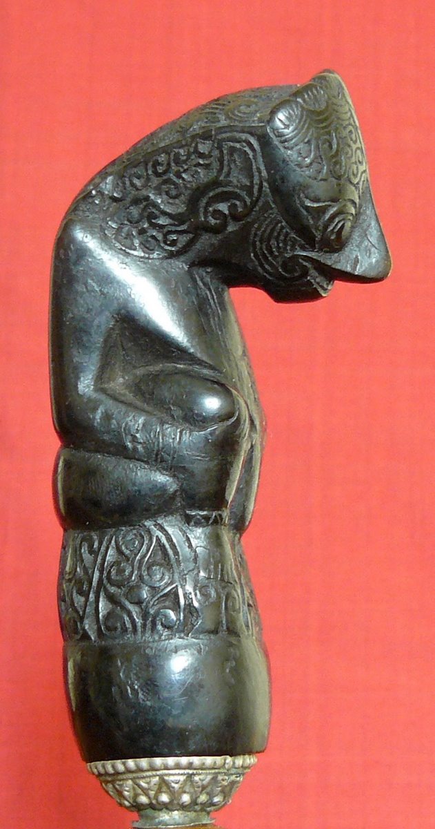

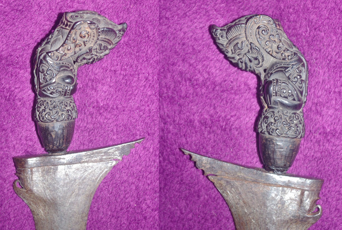

Here is the grip of my new Kriss.
The sheath is very much worn (it is broken and half of the wrangka is missing) but it looks like Cirebon's style.
I think the handle comes from the north of Java but I'm not sure because I've never seen a similar one.
What do you think?

Yes, it looks a rare and old specimen of raksasa hilt from Northern Java, congratulations!

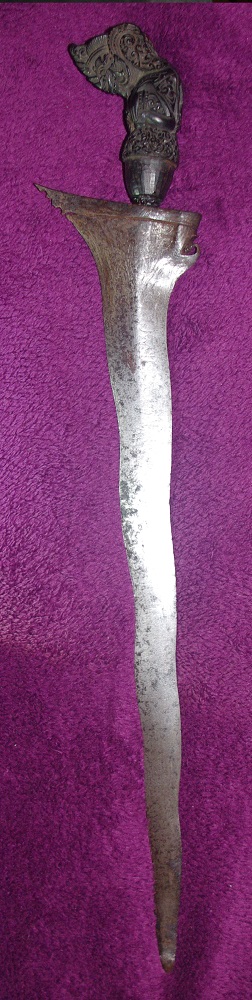

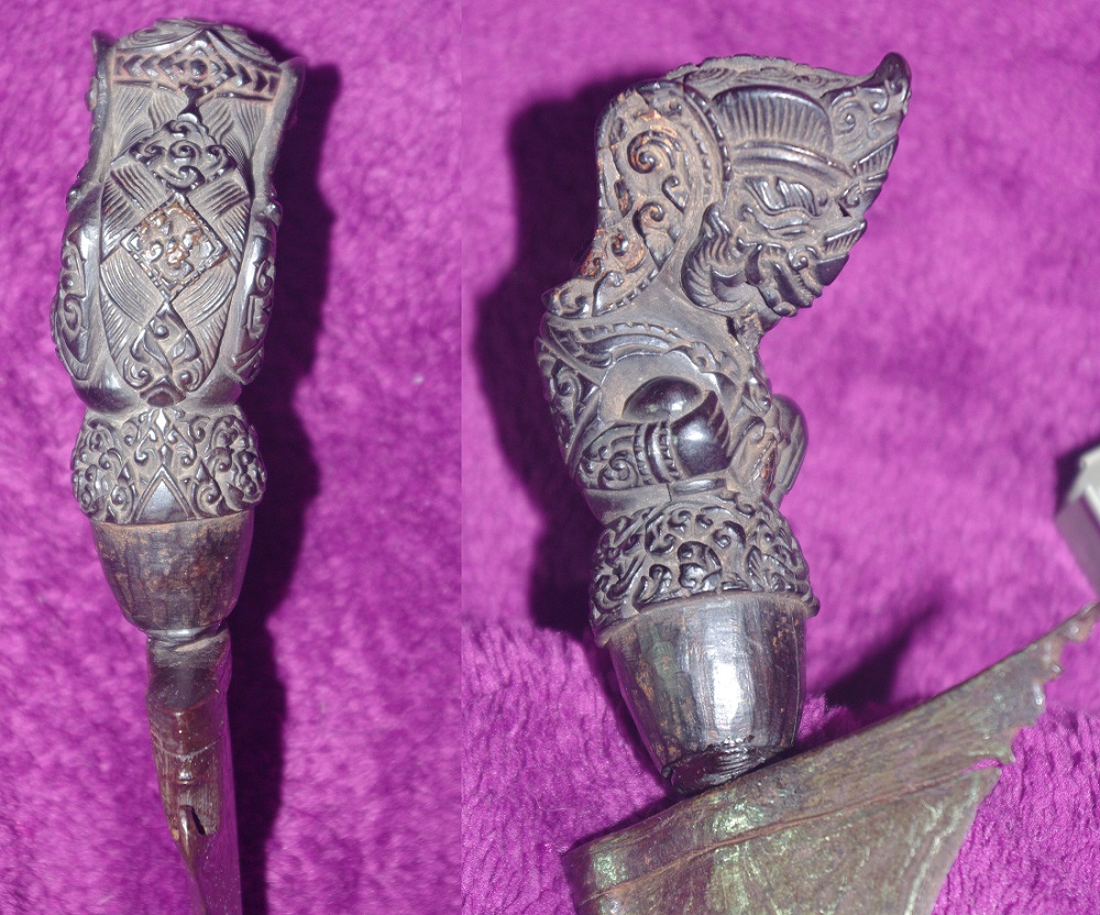

Here is an overview of the kriss. The blade presents 2 different pamors :
- the one in "triangle" which is very visible at the base,
- and another almost invisible on the blade and which seems to be of the type Uler Lulut ?? or Segara Wedi ??
Old 26th November 2017, 04:06 AM   #4

Hi Jean. I'm wondering what about this hilt makes you specifically identify it as a raksasa?
Definitely a lovely, old and unusual hilt. I would agree that it looks Northern Jawa. And i just love the face on this guy!
Hi David,
I used the generic term raksasa to mean a forest demon covered with vegetation, this hilt is similar to the buta bajang style (squatting ancestor with bulged eyes) but with a different face, hairdress, and decoration which makes it peculiar. It is also different from the raksasa style hilts with crossed arms (see pic).

The blade is original and old, and typical of the Northern/ West Java area with its 9 very shallow waves but the pamor pattern looks too indistinct on the pic (too much light reflection) for being able to confirm your identification.

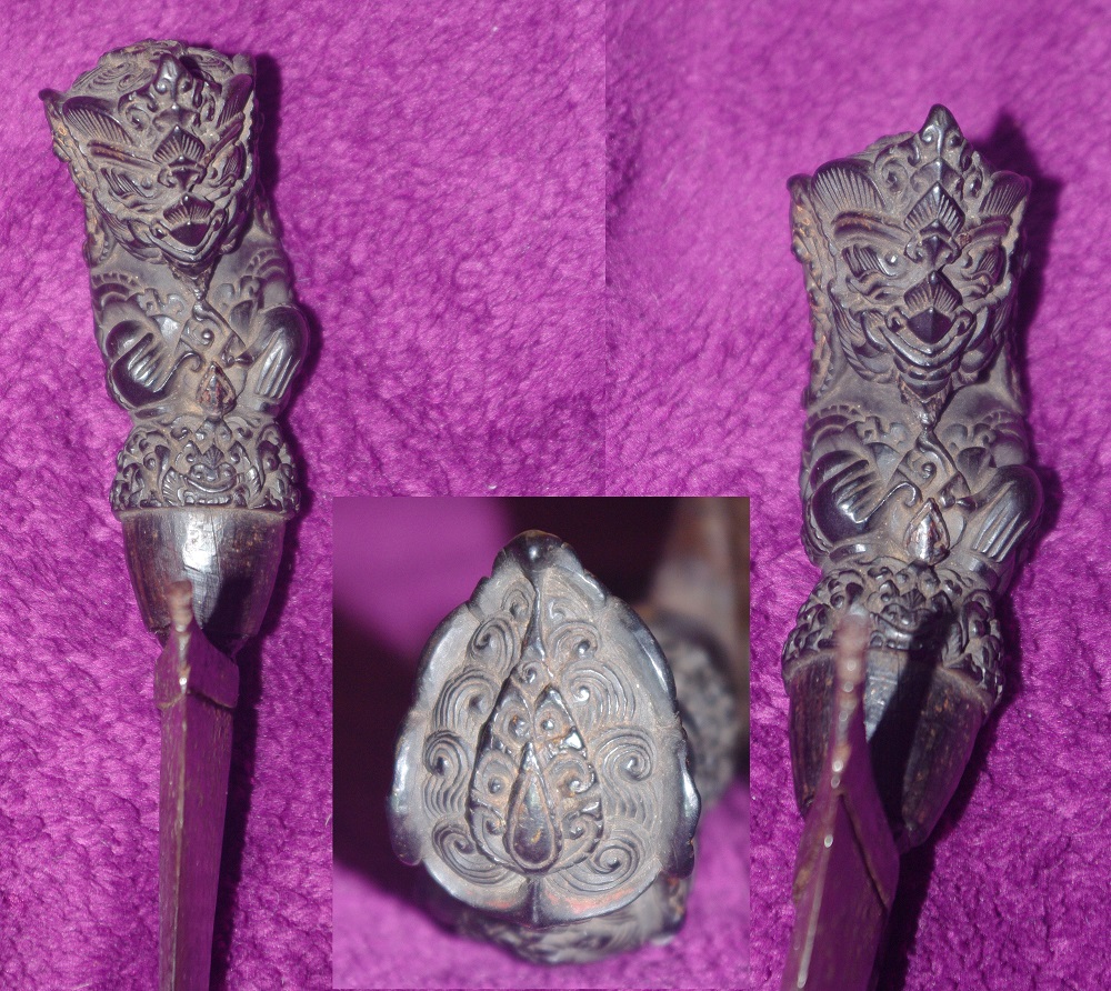

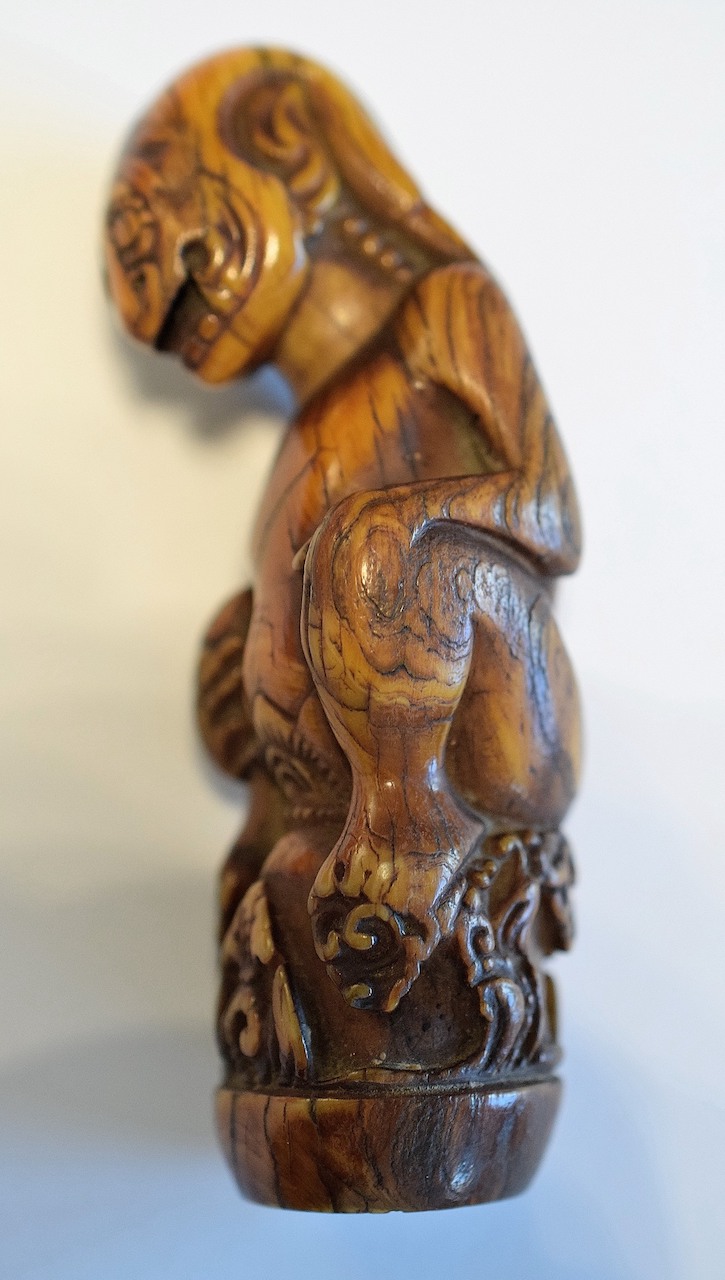

another Cirebon hilt

In Javanese/Balinese art motifs, a figure with fangs is identifiable as demon.
Raksasa is a male ogre, raksasi is a female ogre, an ogre is actually a monster that eats human flesh.
Thus when we call these types of hilts "raksasa" we're being pretty general, its pretty loose terminology.Maybe a bit more "Collectorese".
If we look at origins and turn to Hindu beliefs, what we find is that rakshasas & rakshasis are shape shifters, and not all of them are necessarily bad guys.
If we were going to get really pedantic we probably should only use the term "raksasa" for demons that haunt cemeteries and eat human flesh.
Anyway, Athanase's hilt has got fangs, thus it is a demon. Raksasa is probably OK. If we don't call him a raksasa, what do we call him?
Squatting ancestor with fangs Jean? Interesting idea.
Ancestors eventually become one with their deities, and often are depicted in pit burial mode. But with fangs?
So why are these demons used as hilt figures? Are they all demons? Maybe they're guardians? Or maybe they really are demons and their purpose is keep the really bad guys away from the sacred Meru.Lots of room there for discussion.
I think we've visited this previously.

another Cirebon

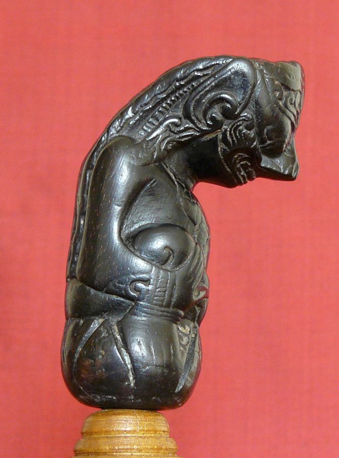

Thank you Alan, and demon is indeed a better generic term than raksasa or ancestor. Do you know what "buta bajang" (the local name for these squatting demon hilts) mean?

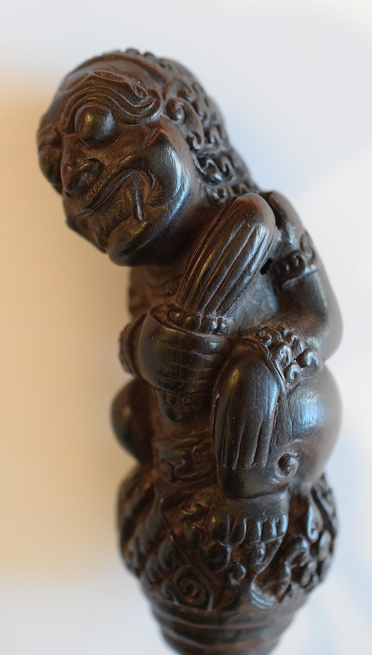

I attach the pic of an old raksasa hilt (holding a human arm in his left hand).

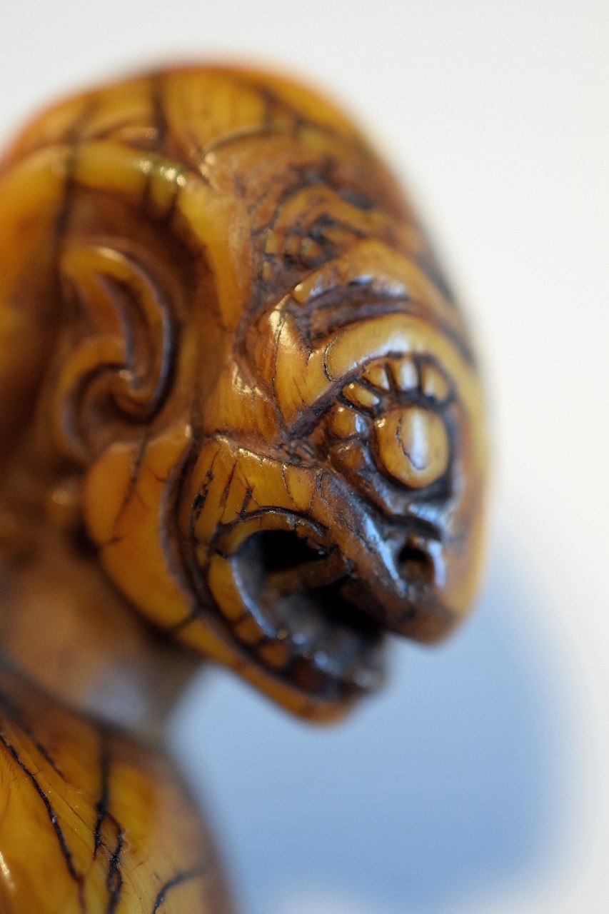

Hello Marco,
Very nice hilt, especially the piece from #7! This one appears to be considerably older than the other examples in this thread - maybe you could add close-ups from the other sides here or in a separate thread, please?
What makes you narrow down their origin to Cirebon? (Vs. Banten or any other other cultural centers in the sphere of Sunda influence? Or other busy trading ports along the coast of northern Java, that is?)
And, yes, I'm still hoping on Christmas for finally reading your book...

Originally Posted by kai
Hello Marco,
Hello Kai.The hilt was on the pesi of an an old blade with a Cirebon sheath and the Yogya seller had only very old keris all from Cirebon area.

Well Alan, you bring up exactly why i asked the question of Jean to begin with. When figures begin to attract i suppose there is always room for interpretation. Fangs? I'm not convinced i am seeing fangs on Athanase's figure. Yes there are what appear to be a couple of curved shapes near the corners of the mouth, but i'm really just not sure. Are they intended to be fangs? Maybe, maybe not. If i saw better photos or had it in hand perhaps i would see it differently.
And then there is the head dress. I just don't think i have ever seen a raksasa (or what we collectors generally consider raksasa) with such an elaborate head dress or crown. It's usually just long hair.

A couple of observations about the original hilt:
The little finger of the right hand seems disproportionately long with a wicked looking hooked nail.
What could be the semi spherical object be that is cradled in the right arm; the head of a child?
Old 26th November 2017, 04:21 PM   #16
For me it's his knee.
Hi Rick,
It seems to be his knee but it is not very clear as the foot is not shown

That's definitely his knee: The traditional position of the right hand is the shin close to the knee (sometimes it pretty much covers the knee, too); the lower leg is visible (with only the feet hidden among the foliage). [The left hands usually rests on top of the left knee though.]
The pinky of the right hand always shows an extension which should be the long finger nail (these tend to curl towards the tip when growing longer; in this carving it's more pronounced than usual). [On the left hand, the thumb usually shows what seems to be an extended finger nail...]
Those are definitely fangs if you compare them with less stylized examples; even in this more stylized representation the animal-like, flared lips are clearly visible around the fangs (indicated by the traditional "striped" area).

Jean, in Javanese, "bajang" means "stunted", you mostly hear it in reference to a child:- "bocah bajang", a child who is either small for his age, or who has not yet had his hair cut.
So, if we say "buta bajang" we are actually saying "stunted ogre", ie , a little ogre, which of course this style of hilt is, since it is only of handle size.
David, in Javanese art, and I guess in the art of all the Archipelago, there are certain formal representations of many things that need to be learned, in order to understand what is being represented. I do not know all the formal stylizations for all places within the Archipelago, but I'm not too bad on Javanese and Balinese ones. This hilt under discussion here has fangs.
Yes, I agree, there is some room for interpretation when it comes to understanding iconography, symbolism, and motif, but these things are really a part of the language of an art form, or belief system, or society, or culture, and that language needs to be understood first, before we can interpret. It is just like our normal spoken language:- in English a word can mean one thing, in another language the same word might mean something entirely different.
As to our little ogre's hair, well, it seems to be streaming down from under some sort of head covering, I don't know what. Maybe the carver had a particular personality in mind? Or maybe he just thought a hat would be useful on cold days.
In respect of specific point of origin of these little ogre hilts, I find it very difficult, if not impossible to nail the overall form down to one particular location. Personally, I'm pretty content to have them just about anywhere along the North Coast, into Madura, and up into the highlands of East Jawa.
I find it odd that you can assign such import to what you perceive as fangs yet completely dismiss any relevance to such an elaborate head dress. Can't say i have ever seen such a head dress on a Javanese raksasa. I find to hard to believe that it has no significance for this figure. But i suppose sometimes a hat is just a hat.

David, the way that we are able to understand anything at all depends upon the things that we have already learnt. Sometimes the things we have learnt provide a direct point of reference that permits us to understand something with a high degree of certainty, at other times the things we have learnt permit us to apply a rational or logical approach to understand by way of reason.
Now, in respect of this hilt figure I have only limited information with which to work, this is because I have never seen a similar figural representation. I do not know who, or what the figure represents, and I do not have sufficient points of reference to permit a rational guess, that is to say a guess that I can defend with logic.
I can see a few things that I do not have any problem with, for instance, I think it is reasonable to assume that we are looking at a Javanese carving; that Javanese carving is figural, and stylistically it conforms with similar Javanese hilt figures that stretch over several hundred years. But I cannot place it within any particular period, nor can I place it at any particular geographic point of origin.
I can see a detail at the corners of the mouth of this figure, that based upon Javanese artistic convention may be interpreted as fangs, or perhaps tusks. The more probable interpretation is fangs, but still, perhaps we are looking at tusks. If tusks, then we need to consider Varaha, but here we have a problem that we cannot really address in a rational way unless we can place a time and place of origin on this little figure. So, on the weight of available evidence, it is probably safer to identify those corner-of-the-mouth details as fangs. If they are fangs, we have a demon, or ogre, or raksasa, or rashasa, or buta, or some other probably rather nasty little piece of work.
Now, the thing that we can see on the figure's head. Exactly what is this thing? Frankly, I do not know. Often in Javanese figural carvings the head-gear of a figure will assist in identification of the figure, and that in turn will assist in dating. This is one of the ways in which we can place approximate dates on the figures that form the hilts of keris sajen. Similarly, in the identification of Balinese hilt figures, the crown or head covering of a figure can assist in identification. But the catch 22 is that we need to ID the head covering, and maybe to ID the head covering we need to ID the figure first.
So, this little figure's head covering:- what is it?
Well, it looks to me as if we can see the hair on top of his head, so perhaps this head thing is not a covering, but rather something like a European crown. Not a Javanese crown, but a European one. Javanese crowns? Well, there was the story of the Golden Crown of Majapahit. Did the carver of this hilt know what a Javanese crown looked like?
Varaha, manifestation of Wisnu. What do we know about Varaha? Well, he saved Bhumi Dewi, the Earth Goddess when the evil Hiranyaksha stole her and hid her. Bhumi Dewi is a consort of Vishnu in his Varaha manifestation. Bhumi Dewi is associated with Lakshmi, Dewi Sri is also associated with Lakshmi, but Dewi Sri pre-dates Hindu influence in Jawa. Lakshmi is associated with wealth and prosperity, Dewi Sri is associated with fertility and the product of the soil, she is the Goddess of the rice, rice grows from the Earth, Mother Earth, Bhumi Dewi, no Mother Earth, no Dewi Sri, no Lakshmi, no prosperity, no wealth, no rice.
So now we can see that Varaha is really a pretty important character, because he saved Bhumi Dewi and restored her to her place, by lifting her on his tusks.

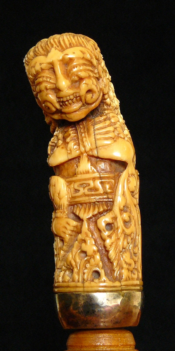

Just for reference I attach the pics of 3 old Javanese figural hilts with a less elaborate headdress and a standard curly hair style.
Old 28th November 2017, 09:41 AM   #27
Posts: 7,256
I think the people I know would probably give that style as minat jenggul Jean.
A. G. Maisey is online now   Reply With Quote
Old 28th November 2017, 01:15 PM   #28
Jean
Join Date: Jun 2009
Posts: 1,740
Thank you Alan, I never heard this name, what does it mean?
