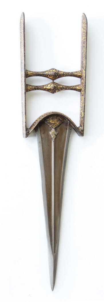

Most of the katars we see to day have relatively thin side guards, which would disqualify them as fighting weapons. To this come, as Robert writes in his last book, that some of them had older blades attached, which did not qualify them either.

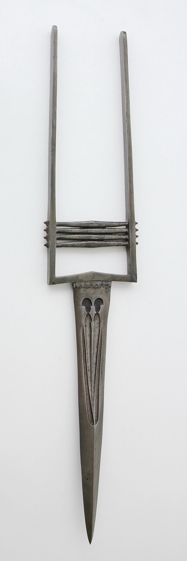

But have a look at this one, it is Rajput 18th century, and 52 cm long. It is made in one piece of dark crystalline wootz,and sounds like a tuning fork when hit on wood.
Salaams Jens, To mirror the words of Jim I have to say what an excellent way you have of offering posts and the fact that you are the leader in your field...and I know you probably don't like people telling you that ... but its true.
One thing about the Katar you show which intrigues me is the strange addition of the VVVVVVV zig zag line at the Forte that I have seen before on Omani Battle Swords and wondered if it was significant.

To prove this to you. Yes, the 'VVV's', I dont know what they represent, but I too have seen them before. What about the hilt base? The hilt bases can be very different, but they are mostly represented in both the north and the south, and there are a lot of other questions I have, but I can only research few things at the time - I am sorry to say.

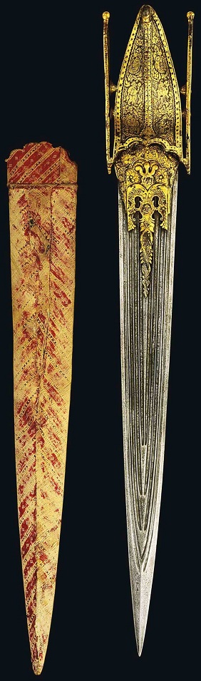

Returning to the thread and the question which is what were the better quality Katars? I presume the daggers worn at court fall into the same category.. Pinterest has a lot of very ornate examples at:
https://www.pinterest.com/wmilitaria...rs/?lp=truebut

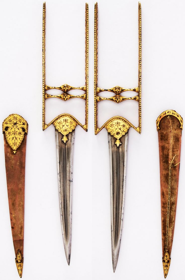

I picked out a couple to place here...The older example with a full handguard form being 17thC and the other showing both sides 18thC. It would seem reasonable to inspect Mughal Court paintings of the period for examples of artwork displaying Katar being worn however these are miniatures and fine detail is not easy to see...
As already stated surely koftgari and finely made scabbards and those examples with semi precious stones incorporated into the design would be likely suspects as court swords or as better quality Katar?

The Met Museum has many excellent examples.

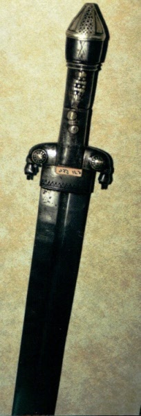

Compare this katar to the one shown in post 7. The side guards are slimmer than the one shown above.

One can experiment easily with different Katars and I am pretty sure the conclusion would be that a Katar with longer and stronger arms like the one in Jen's posting no. 7 is much more stable in the hand than one with shorter side arms like the one in Jen's posting no. 20.
Longer arms would ensure better alignment of the blade with the forearm (notice how the longer arms slightly converge opposite to the blade in order to give a firmer prop against the bearer's arm - the same reason why some Katars have the side arms slightly bent inwards, not as a result of a blow, but to ensure better contact with the arm) and through their weight will also serve as a counterbalance to the blade improving the handling of the Katar. The wide four transverse bars will also contribute to the stability of the grip and prevent the rotation in the hand.
The same thing cannot be said for the second Katar that would be rather difficult to use as the very short and rather widely spread side arms would offer no alignment and balance to the blade. At the same time the two transverse bars would ensure a rather narrow grip prone to rotate in the hand.
So, the first Katar would definitely be a functional weapon, while the second one would be more like a dress Katar. And here I contradict my own statement above (second part of it) when I said that "there are some Katars more suitable for combat than others, however, this doesn't mean they were deliberately designed for combat."
