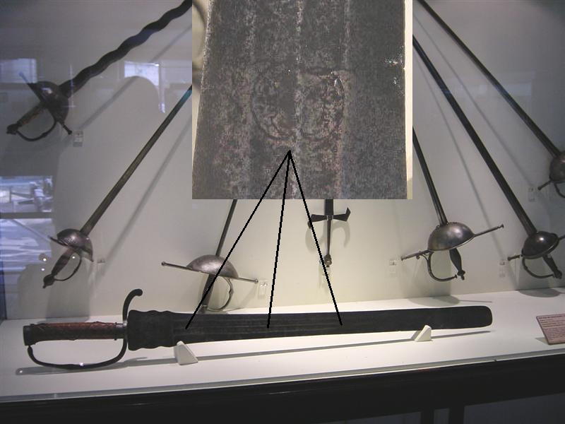

It is well known that often one of the key elements in studying ethnographic edged weapons is that of the trade blades often found mounted in them. I have tried using our search feature to research certain established markings often found on a number of these, but feel that it might be a more effective resource if we began a thread with discussion focused on known markings.

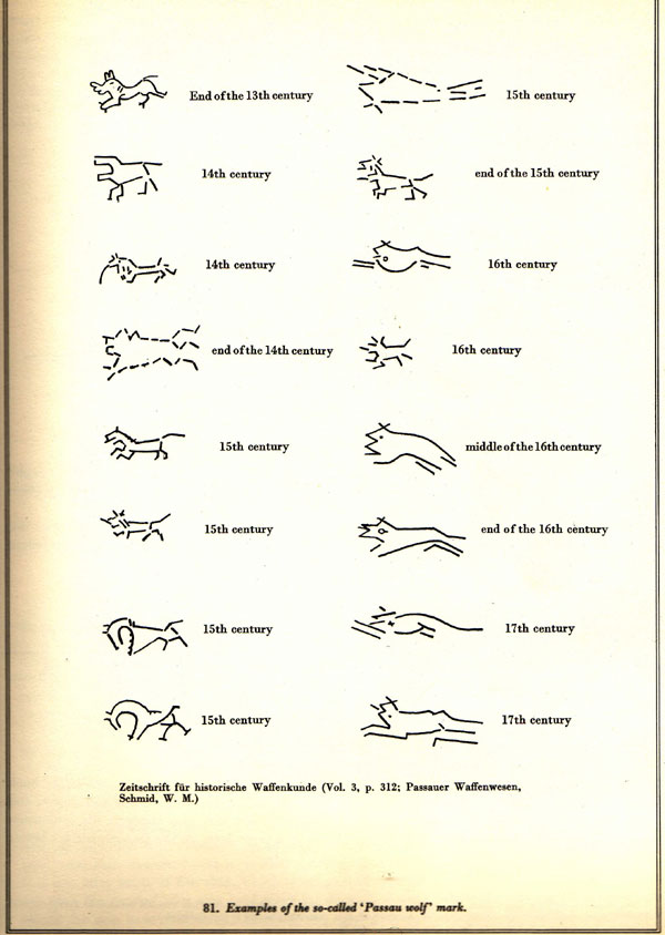

I am hoping we can focus for example on the 'running wolf' of Passau, which evolved into forms stamped in the blades of Styria, Solingen and eventually in the Hounslow blades and Shotley Bridge blades of German makers in England.
There is an especially interesting chart on the chronological development of this mark in Wagner ("Cut and Thrust Weapons") ...could anyone with this book please post? Also there is I believe a note on the marking in Oakeshott ("Archaeology of Weapons"). ...also please post anyone?
Also, I believe the running wolf in Chechen blades is termed 'Ters Maymal' (check Askhabov, "Chechen Weapons").
Other key examples would be the 'sickle', 'eyelash' markings associated with Genoan blades. These evolved also via Genoan colonies into Styria, Solingen and Chechnya (where they are termed 'gurda', see Askhabov again). These occur almost consistantly on examples of Afghan paluoars, and on trade blades in many regions.

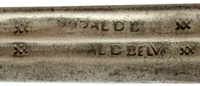

The familiar 'Andrea Ferara' seen in the fullers of various straight blades of 17th-18th century seen on Scottish basket hilts, English mortuary swords, khanda 'ferangi' in India and others. Any examples of this appearing on trade blades would be essential. While often held by early writers to have been the purloined name of an early Italian swordsmith that became used over centuries as with the Islamic Assad Adullah marking, it has been suggested that rather than a name it is actually a term. Ferara (=iron) Andrea (=true, ?)
Much as in the term Eisenhauer on many German blades (Eisen = iron) (hauer=cutter).
Sahugun, on early Spanish blades..name of maker? or place?
The talismanic blades of the 18th century....the man in the moon, the human faced sun and the star ....what is the application of these astral figures? These are widely copied on native blades, especially in the Sudan and the Sahara. We need examples of the European blades as well as the native mounted ones.
'The Spanish Motto', do not draw me without reason, nor sheath me without honor. This occurs in about mid 18th century, and while associated with Spanish blades of the period, it turns out these blades, typically Spanish dragoon blades c. 1769 were actually produced in Solingen.
These are what seem to comprise the most commonly encountered markings on blades associated with trade and ethnographic weapons. I hope that anyone so inclined will quote and address any of these examples so that we might all benefit from discussion focused on them and the topic in general.
The comprehensive research resources and outstanding examples in the collections of the members and readers here is well established, and I would very much like to see these employed in a useful resource for us all.
Thank you in advance everyone!

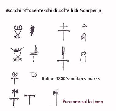

Here are some early Italian makers marks.
Rich S

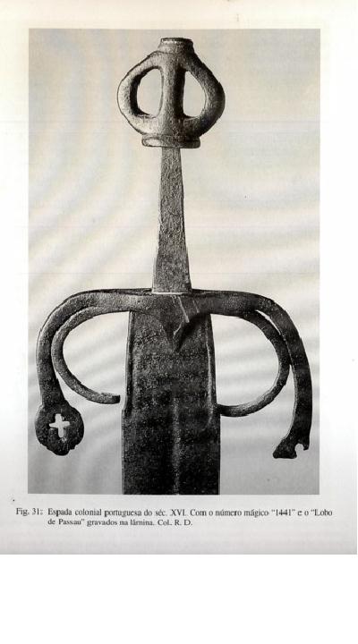

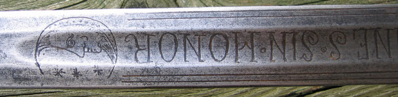

'The Spanish Motto', do not draw me without reason, nor sheath me without honor. This occurs in about mid 18th century, and while associated with Spanish blades of the period, it turns out these blades, typically Spanish dragoon blades c. 1769 were actually produced in Solingen.[/QUOTE]
Hi Jim
This Motto is much older than that.
In the collection of the Portuguese Viscount of Pindela, published in 1946, swords #35 and #39 bear this Motto. These sords are dated XVI century.
This is a very serious (rare) publication (which i luckily have), sponsored by the State. The collection was kept in the family's Mannor house, where it was catalogued, and was later sold to the State, due to the family's financial situation. It is now in exhibition in one of the National Palaces.
Hpe this is usefull.
Fernando

Thanks so much Rich and Fernando for getting things rolling!!!
The Italian marks are great Rich.....I had a copy of the huge volume "Armi Bianchi Italiene" which I wish I had access to....these Italian marks are very important as the Italians were quite prominant traders that diffused immense numbers of blades.
Thank you for the input on that motto Fernando....I knew it was older than the popularly applied examples on those dragoon blades but did not know where or how early. The transliterated versions appeared also on French and Italian blades as well during the 18th century, and in the case of the Italian examples probably much earlier due to contact with the Portuguese I would imagine.
Hi again,
The running wolf ( Lobo de Passau ) is quoted to be engraved, together with the number 1441 ( one of the various combinations of magic number 7 ) in a XVI century Portuguese Colonial ( crab ) sword, depicted in page 64 of "Homens Espadas e Tomates, a book you also have. It appears that these trade blades were supplied at the time to Portugal and ( if i remember reading ) also Spain.
If needed, some evolution on the magic number seven can be posted.
Fernando

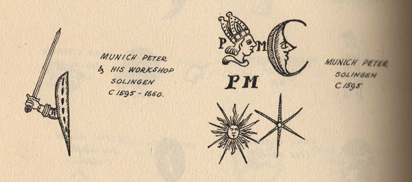

Hi Jim,
Here is Pg. 109 of Wagner's Cut and Thrust Weapons .

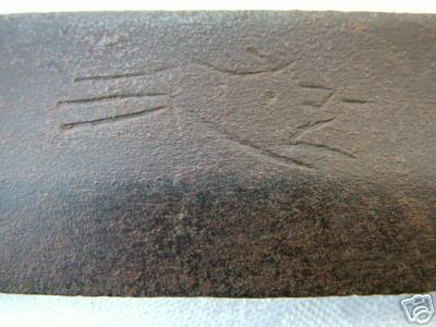

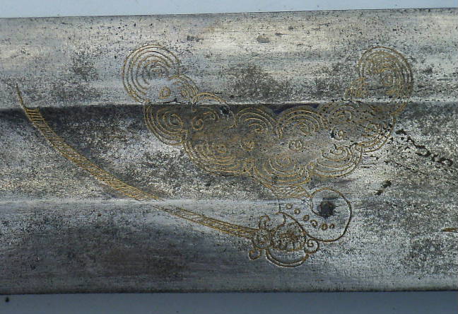

Here is a cloud with a sword. One is from an English cavalry sword, the other, a Yemeni sword and the coat of arms is for the town of Valka, Latvia. A very small town in Latvia from where my wife's family fled during WWII. This part of Lativa was a German principality for most of the the middle ages.

Beautiful examples Michael! and most intriguing history with the coat of arms shown. It seems I have seen similar arms in Polish heraldry, and that the arm coming from the cloud device was most likely adopted by Solingen makers in the 17th to 18th centuries as can be seen in the talismanic context.
I have seen this marking in books on this topic such as 1000 Makers Marks (Lenciewicz ?) and another whose title escapes me (Jeff I think you have these). I apologize for not having better recollection on these, I do not have access to books presently so must rely on what there is of my memory!!
It is interesting to see the religious allegory associated with these talismanic devices in motif, in this case the arm holding a sabre represents the arm of God and the sword extending from Heaven. We did have some discussion on the appearance of the Virgin Mary on Polish swords along with astral symbols not too long ago, and it seems that the arm in the cloud is shown illustrated in a Russian reference on this topic indicating the use from 17th to 18th century.
The English cavalry blade looks like an early 19th century sabre blade, and the Yemeni blade appears to be a broadsword as seen on kattara in Oman..both with Solingen blades,can you show the full examples?

Hi Jim,
The images in Zygmunt Lenkiewicz and Dudley Gyngell's books are the same and as you know attributed to Peter Munich (I will post the images in Gyngell below). Not quite the cloud and sword as on Michael's beautiful blade. I think these images are often mistakenly attributed to Peter Munich but infact date to Solingern from the mid 18th to mid 19th century. The Munich images are much more detailed. The exact images seen on Michael's blade are seen often on British 1788 blades from the Runkel factory. They are less often but not atypically seen on British 1796's, and trade blades to Eastern Europe, Caucasus and Africa (oddly I haven't found any exported to America?). Similar images are copied in these areas, but appear more crude.
The arm with sword protruding from a cloud is thought to represent the sword of God or God's justice. It is seen in herarldry from Poland, Scandinavia, and Ireland to name a few. It has been mentioned that there at least was a Protestant connection. It is interesting to note that often in heraldry and in the blade image the sword is a "scimitar" not the more typically European saber as in Michaels coat of arms?

Thank you for posting the reference on the Peter Munich blade markings, and I think you are right in these appearing in kind, much later into the 18th and 19th century and the astral figures do appear often on British officers sabres as you have noted. I have always thought that these figures on these blades in these later times not only had to do with quality symbolism, but likely even more to do with Masonic lore. In those times officers were of course also well established gentry and often nobility, and were of course also often quite active in Freemasonry, where much of this symbolism remained well in place.
Very good point about the trade blades from Solingen, or for that matter Runkle who was situated in England, and their wide distribution. I think that in America these blades did get there in some degree of course via British presence. Best source for examples here would probably be Neumann, "Swords and Blades of the American Revolution".
Interesting note that you bring up on the sword held by the arm in the cloud being a 'scimitar' as described in heraldry. It seems that these sabres and for that matter the 'Oriental' fashion deeply influenced many European forces in warfare in Eastern Europe against Turkish forces, and in many cases the 'exotic' imagery was adopted in degree. One interesting case is with a few of the Scottish mercenaries who adopted the curved sabre blades in their basket hilts, terming these hybrids 'turcael', if I recall.

Regarding the scimitar in the cloud image. I always wondered if it represented that the Eastern powers were seen as God's punishment, you know, not enough faith and all that...
More things to ponder.

interesting, i had noted this one on a sword for sale on ebay (now ended). looks like a hunting sword.
it did not want to come live with me tho........
it did not want to come live with me tho........ Quote.
Hi Kronckew You beat me to it .....I was surprised at the final price....have to agree that its a hunting hanger ...but think it was re-hilted ...the blade shape seems a little unusual for a hunting sword though, and I suspect that the blade has been shortened and the tip re-profiled.
Regards David

Hi Jim,
I feel deeply frustrated
I have deliberatily gone back to the Oporto Military Museum, in order to improve the pictures of this situation, but i couldn't manage better than the last time i was there. It is rather dificult to picture determined positions through the glass windows.
This is labelled as an end XVI century German beheading sword, of unusual quality, where the double human half moons face each other, etched three times along the visible side of the blade ... probably also on the other side.
I had sort of convinced the Directing Colonel to open the window for better pictures ( he owed me one ) but he went on a meeting and didn't show up untill i gave up.
I hope this is usefull the way it is.
Fernando

While I can see the moons, were there other marks on the blade? Quote.
No Jim, the only marks are the crescent (and decrescent ) moons. Three pairs of them, at least on the showing side.
Just a little note. This sword is labelled as German by the Museum, but this is not necessarily a fact. I once showed a full set of pictures to Philip Tom and he sugested it could be Hungarian, quicker than German. This just in case someone finds its quoted origin passive of doubt.
