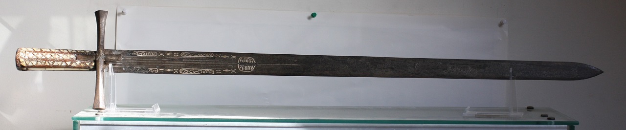

Hello everyone,
I've recently acquired some addition to my collection and the first piece I'll present is a nice kaskara sword from Sudan.
It would date from the mahdist war or maybe a little bit before.
I hope you will like this little new addition just for waiting the rest of the presentation
Friendly,
Clement

The blade appears to have 5 fullers, which is an interesting and uncommon feature. I also like the thick silver inlay. Per previous discussion in this forum, the crossguard is of a style attributed to Darfur. I wonder however about the hilt and whether it is a more modern replacement.

It is difficult to judge from the photos, butvthis appears to be a locally made blade.

Better photos would help, but the blade could be European with the later addition of the half moon marks in Sudan (notice how the one mark overlaps the fuller). However, it could also be local. Always hard to tell without better photos or the blade in hand.
The crossguard is of high quality and the blade decoration is an interesting departure for the more commonly observed thuluth acid etching, again better photos would help in this case.
Unfortunately I also suspect the hilt is a more modern addition.
An interesting piece, but I have some doubts the entire piece is homogeneous to the Mahdist period.

thank's for your comm !
I will promptly post new pictures of this kaskara, don't have the time and good conditions to take nice pictures....
For the hilt, it look like really homogeneous with the rest of the blade so it could be a later addition but I think really old ?
Clement

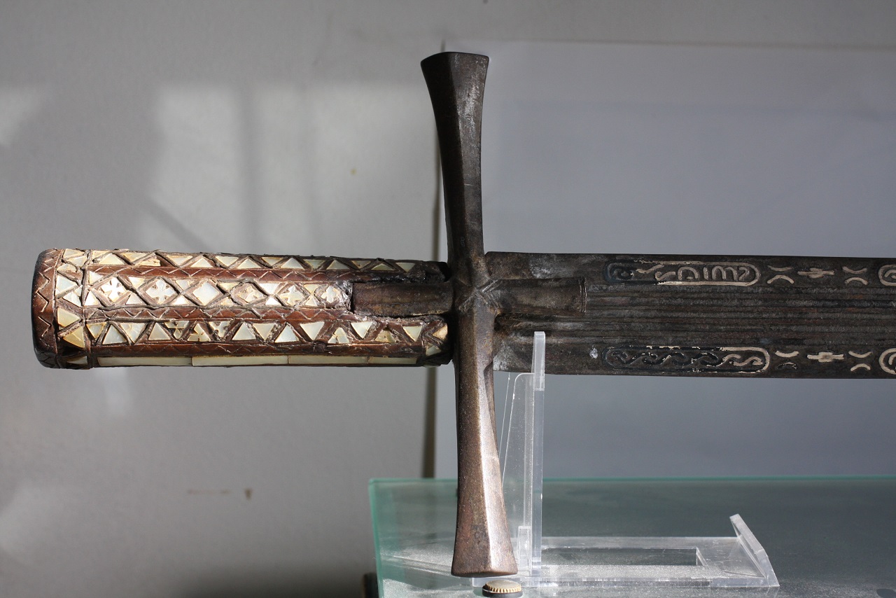

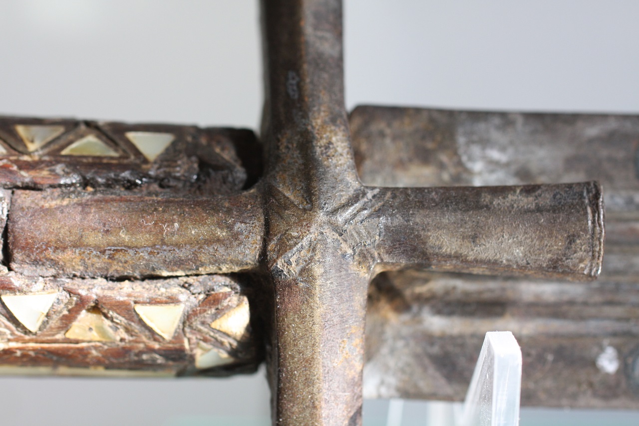

Thank's again for your comm ! I just change picts which, I hope, are better
Thank's Kubur, I don't knew this area and this is a nice discover.
The little bit on the hilt are "shell's nacre", something unsurprisingly for a hilt which would be done in the red sea's coast area.
After all the blade and the cross guard can pre date the hilt, if the blade and cross guard were recycled of an older European sword and after trade in Africa isn't it? I've seen/read that was a common practice ?
Clement
CNK1 is offline   Reply With Quote

Thanks, on another look at the pictures I think I see a ricasso at the base of the blade as well...

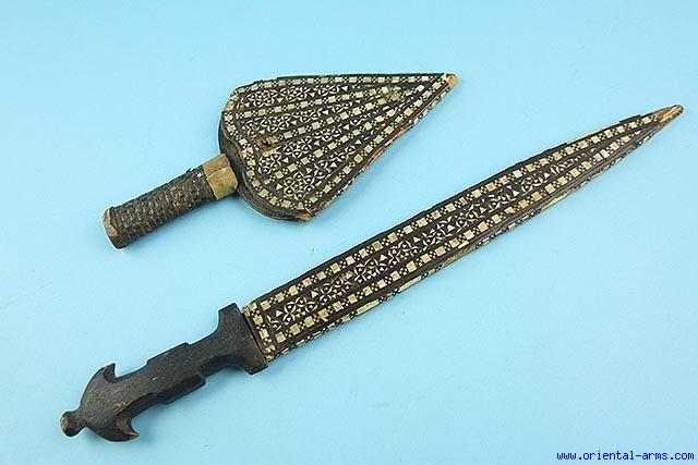

Here is something similar from the internet...
Perfect, I knew I'd seen that style of work before but wasn't coming up with anything in my notes.
I'd be curious if there are any firmly dated examples or bring backs exhibiting this type of work that can be used to establish a baseline.
A check on the British Museum and Pitts River Museum collections didn't turn up anything.

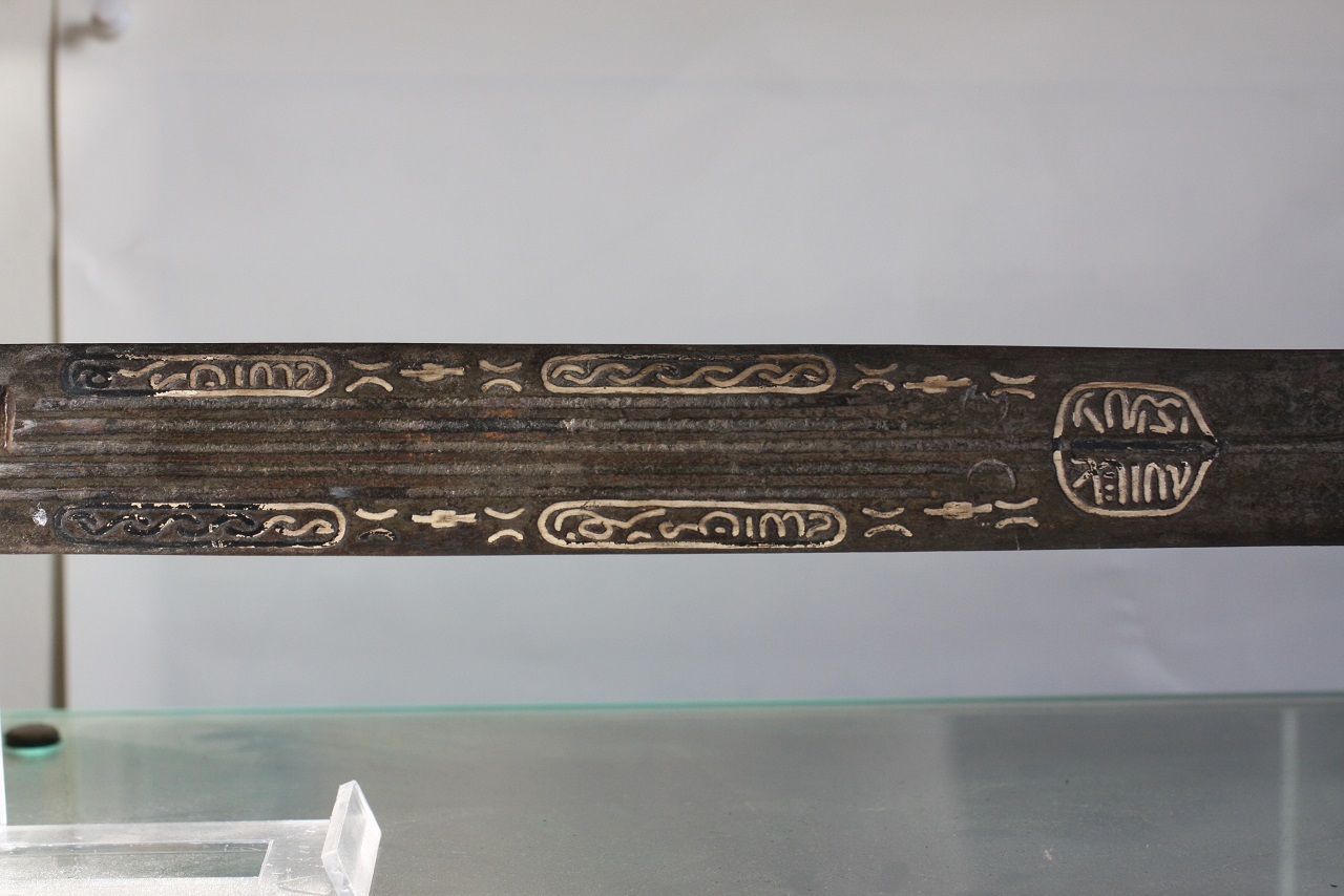

Can anyone translate the Arabic script on the inlays? I can make out a couple of letters, but am not literate.

Friend of mine had a look and said it was a typical Koranic verse, "Victory from God"

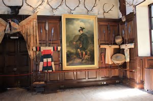

I suppose the Blair Castle, Perthshire collection would be a good indicator, as the material was brought back at the time by Lord Tullibardine who fought in the Battle of Omdurman. Photography was not permitted when I visited some years ago, but I now see a few images have appeared on the internet...

Blair Castle has a great collection, but it is all quite workmanlike and there are no croc or fancy weapons on display.
Most of the Thuluth and croc pieces I've seen in museum collections like Pitts river have ascension dates from the 1920s or later. Although some thuluth peices are of course certainly Mahdist period and reached museum collections at the end of the 19th and very early 20th century like the piece linked below.

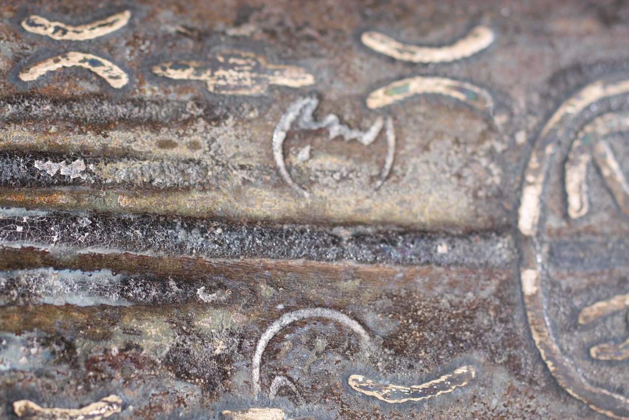

It seems that the blade with five channels, and the familiar 'dukari' moons was a relatively unusually present example of the common three channel, dukari marked type blades. If not mistaken, I believe Ed Hunley in his work on Sudanese makers (archived here) noted these 5 channel blades termed 'Suleiman', and I gathered they seemed preferred by figures of status. These were native produced and termed collectively as 'masri' (I believe Rodd, 1928).

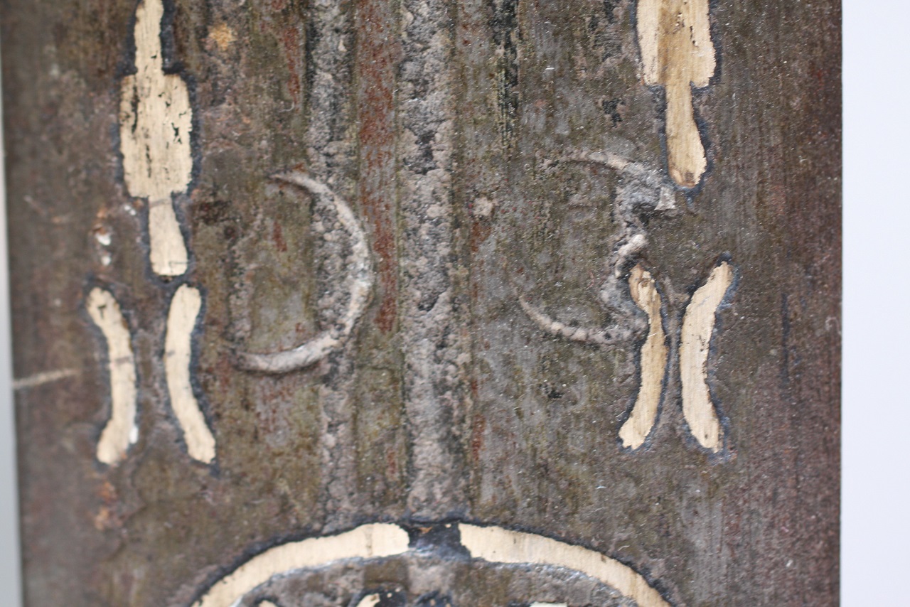

Are there any inscriptions on the reverse?
What is shown in the photo is inscribed as Iain noted above:
Nasr min Allah! (Victory from God.) This appears twice, however the remainder of the phrase,
wu fath qarib! (and conquest nigh) is lacking.
The large central cartouche is more interesting.
It reads at the top: Mash'Allah! (God's blessing)
And at the bottom: La ullah (No god-- the beginning of the Muslim profession of faith, There is no god but Allah, no prophet but Muhammad)
Finally, there are three digits, 121 or 131 which convey the date 1210 (1795/96) or 1310 (1892/93.) Given the competent but clumsy character of the calligraphy and inlay work, I suspect the latter is correct.

Thank's to everyone for your help, I gratefully appreciate the time you take to search, share your knowledge
So to my personal culture, this sword date from the end of 1800's and was "manufactured" for a high ranking person (tribal chief ).
I'm really happy to see that so many people are interested by this sword

I have no doubt the blade seen here is of some quality, five fuller blades are unusual and I find it an attractive piece.
Regarding the crossguard plenty of of this type with the central 'X' are in clearly dated bring back collections like Blair Castle, they don't belong exclusively to the 20th century Ali Dinar groupings.

It seems reasonable that the 'X' on the cross center on hilts probably were produced during the Mahddiyya, but seem certainly more unusual in examples I have seen. It is in Reed (1985) where these predominate on the swords he describes from Darfur, and as the forms which apparently became popularized during Ali Dinar's time in early years pre WWI. These had these X guards and often embossed harlequin/lozenge decorated silver hilts.

Regarding thuluth, I'm not implying they are all post 19th century junk, but there are certain standardized patterns of quite short kaskara without fullers, sheet metal blades and thuluth combined with low quality brass guards that I am certain were made for the tourist market.
Obviously there are plenty of examples that are indeed from the Mahdist period, but my point was simply that a lot of the examples that come up frequently for sale are in my opinion not of the age often prescribed to them.
About the hilts with the Xs. Yes these do seem to be something of a Darfur specialty, but offhand several in Blair castle have them. So I think its really not specific to the post 19th century period and much of the arms used in the Mahdist period, particularly good quality swords were doubtless produced before. Also we know the cross guards were also imported from Germany (see "Le Soudan: Ses rapport avec le commerce Europeen" from 1871 and written by a French civil servant).

Reading Major Powell-Cotton's excellent book "In Unknown Africa" 1904, I attach an extract which is pertinent to this discussion, as it illustrates the keen awareness the Sudanese had for selling souvenirs to Europeans... The Major's visit to Khartoum and Omdurman was in 1903 on his way back to Britain, I believe.
