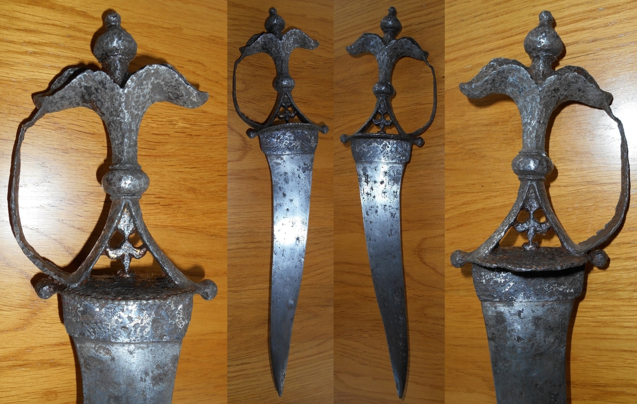

Just a short note:
I was very surprised to see in all the litterature, including recent books from the best experts that the chillanum are always dated from the 17 th c.
To me it smells like rubbish... Authors and experts are just repeting an "established" fact without any serious evidence than quoting each others...
Why not 16 th c.? And due tothe large number of these daggers 18th and 19th c. too... Do we have chillanum during the 18th and 19th c.?

Plenty of them on E-Bay. All straight from India. All from 21-st century:-)

Well researched Ariel:-).
Kubur, I have one from the 17th century and two from the 16th century. See A Passion for Indian Arms.
Old 27th August 2017, 10:18 AM   #4
Thank you
Well if I can see a 16th c. one with some descent explanations,I will buy it tomorrow!

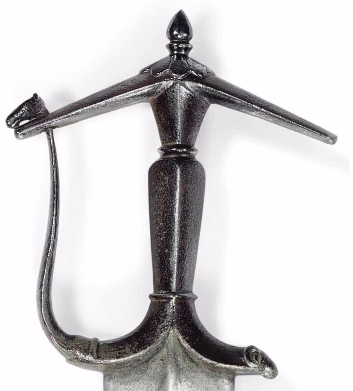

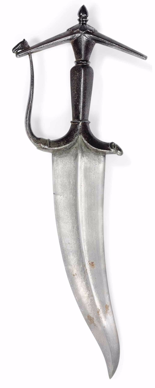

A nice example but 6875 GBH!!! It is described as 18th century and "earlier"? Put together, perhaps an older hilt and a newer blade?
A CURVED STEEL DAGGER (CHILANUM)
NORTH INDIA, 18TH CENTURY AND EARLIER
With a curved watered-steel double-edged blade with medial ridge and reinforced point, the 'T'-shaped hilt with a rectangular grip with rounded knop finial, curved knuckle-guard issuing from a stylised elephant mouth and terminating in a horse's head, the rainguard with a ram's head finial, blade and hilt contemporaneous but associated
13½in. (34cm.) long

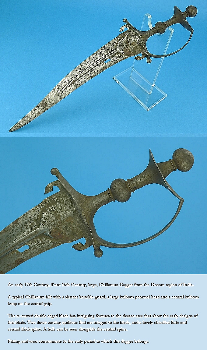

Here is one from Runjeet, described as early 17th century or even 16th century.
