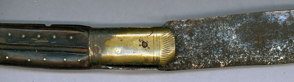

Default ratcheting mechanism on Spanish Navajas
I have for a long while wondered what is the function of the ratcheting mechanism on the locks of traditional Spanish navajas. It makes it impossible to open them silently. The only advantage I can see is that it could not be accidentally closed on the hand while opening the knife; perhaps if someone kicked it in mid-open? I have read that it acts much as the rattle on a rattlesnake; announcing imminent danger. If any of you experts have an idea, I would love to know.
Thank you.
Richard.

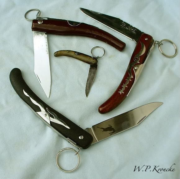

couple for illustration, the stag one is quite large (and noisy).
...and some ring pulls, they are mostly in the same family
there is a saying that the sound of the navaja was the last thing many people heard.
