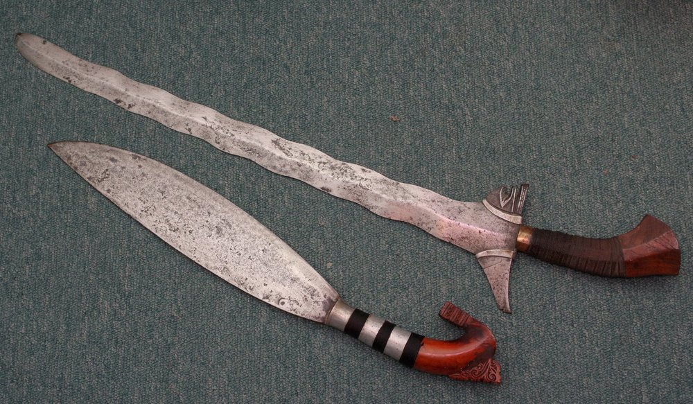

Default barung, kris, gunong: my first post

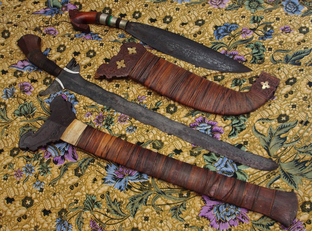

good day, i have been reading some threads here for a few weeks now, and am really fascinated about the opinions and information you guys share here.
i have a few pieces in my small collection that i would like to have your opinions on as to estimated age and origin.
thank you in advance

Mabuhay and welcome to our little forum!

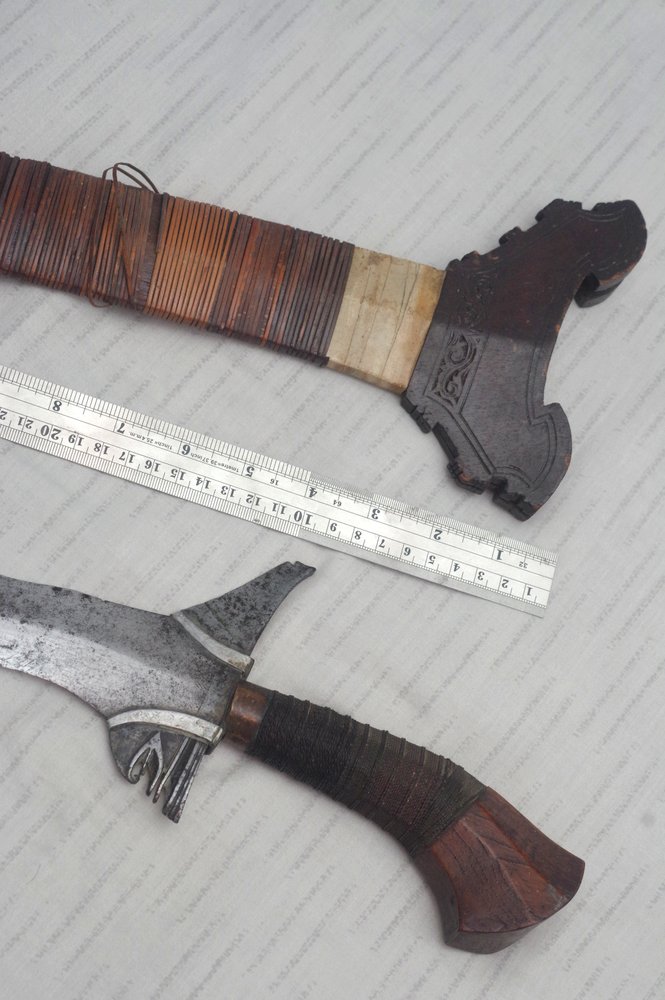

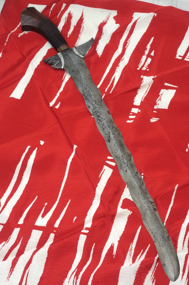

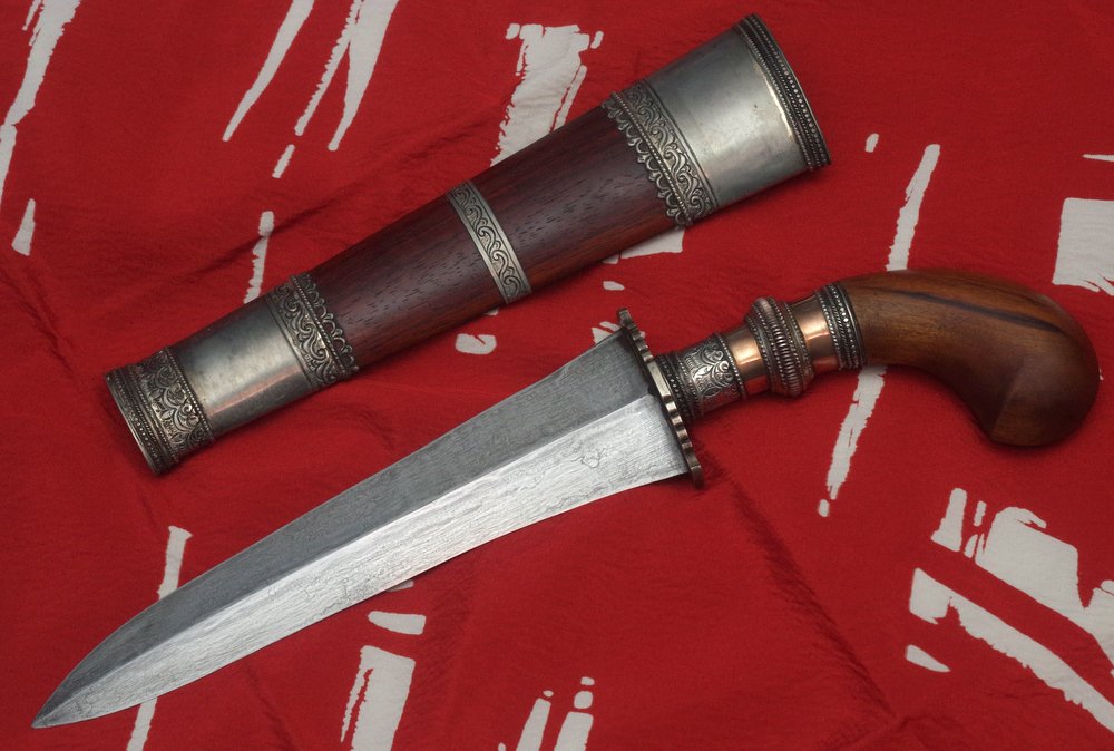

Your barong and gunning (the dagger) are of more recent manufacture. The barong from the Sulu region and the gunong looks to be perhaps from the Maranao (Mindanao for sure).

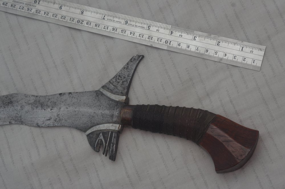

The kris looks also recent, although perhaps the blade might be WWII at the earliest. As far as the hilt is concerned it is later than the blade, but the blade might be Maguindanao, though I am a little inclined toward Sulu (close ups would be more helpful).
Nice work one the barong and gunong.

Hello and Welcome to the Forum.
Three nice examples of 20th C. Moro work. I agree with Battara about the likely age of these pieces, and that the kris might be Sulu in origin.
Look forward to seeing any more pieces you may have.

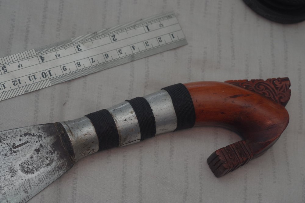

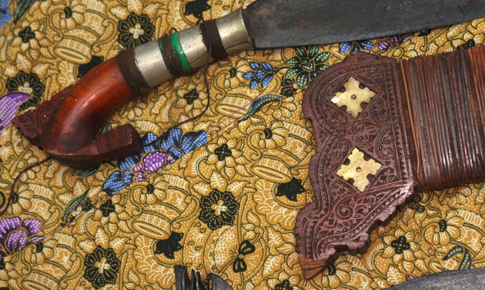

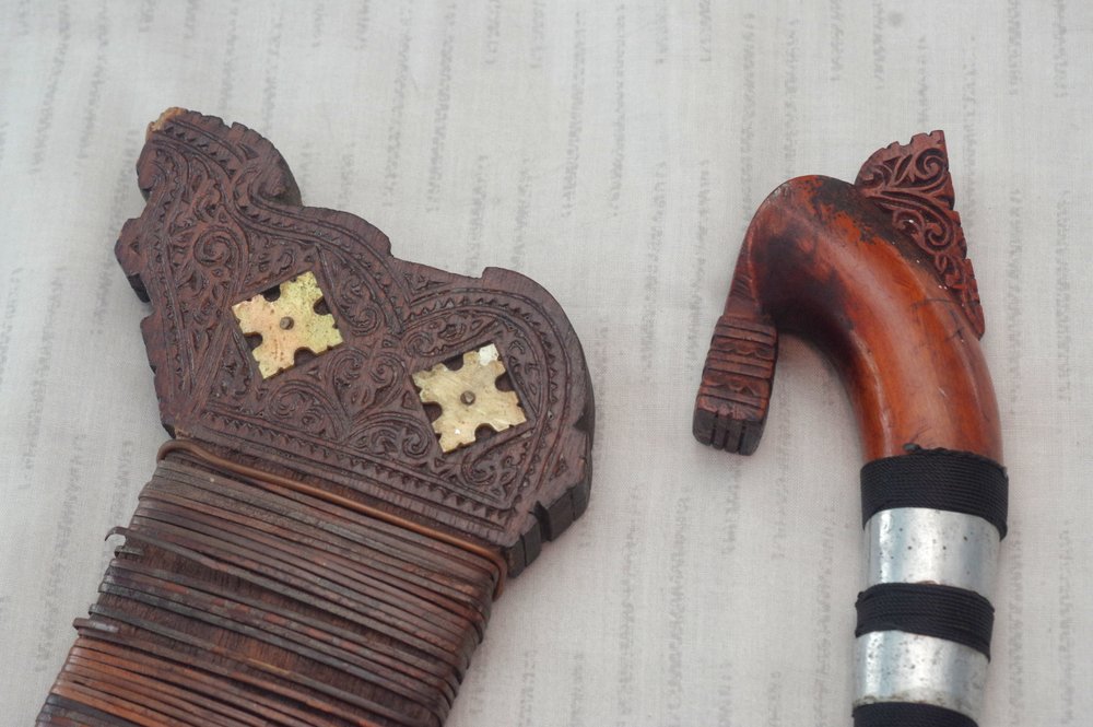

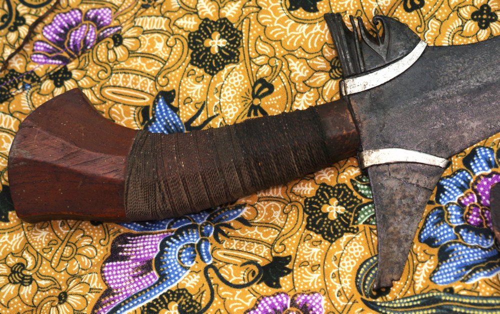

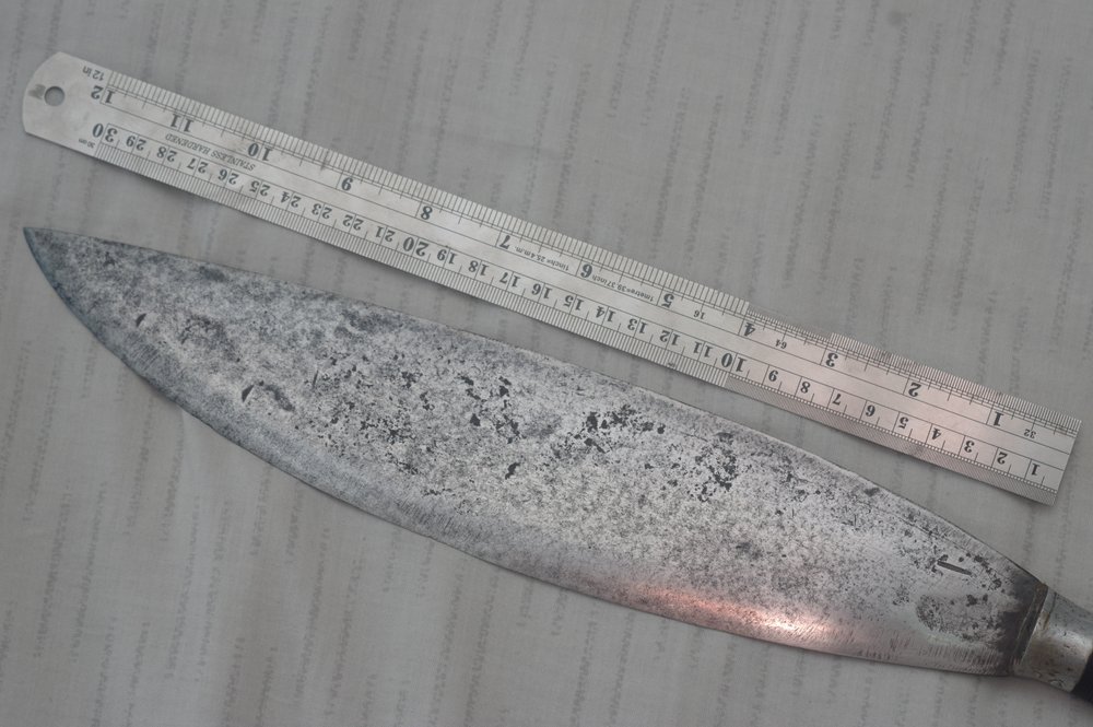

here are some more closeup pics of the barong

and here are some more pics of the kris

Hello Jose and Ian,
agree with you both to have here three 20th century pieces but it's maybe a little disappointing for our new member to read "recent" for the age of his pieces. Would agree with recent for the gunong but it's a very nice worked piece. The barong is maybe from WWII area, so I would call it "vintage" .
But very nice carved pommel! The kris seems to my eyes the oldest piece of this small collection and when my eyes don't play a bad game with me I think to see that the gangya is separat, so maybe is this piece from the 1920/30ties?
Old 24th May 2017, 02:23 PM   #8
Pinoy Blade Hunter
Join Date: May 2017
Posts: 62
here are the kris and barong as i have received them the first time. the former owner coated it with "rust converter" thats why it was all black.
i had sanded it down a bit to remove most of the black, and put on metal polish.
the barongs thread wrapping was disintegrating, i re-wrapped it with cotton thread.
the gunong i got in that condition, i didnt do anything to it but wipe it with cloth damp with a little oil.
Pinoy Blade Hunter is offline   Reply With Quote

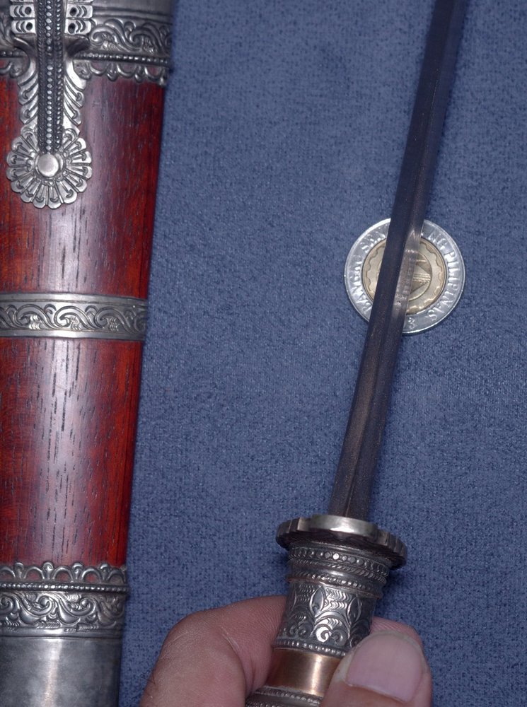

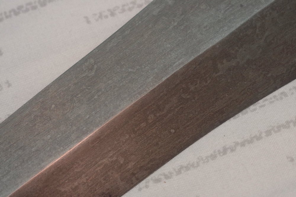

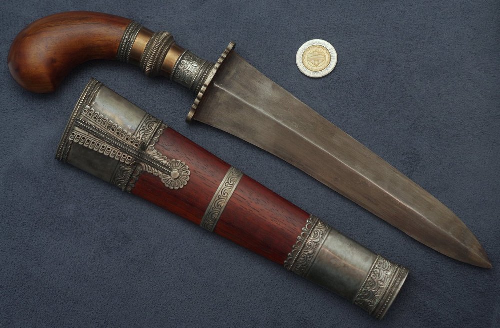

Default tried some etching

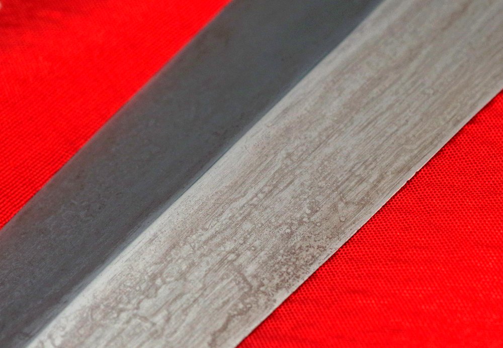

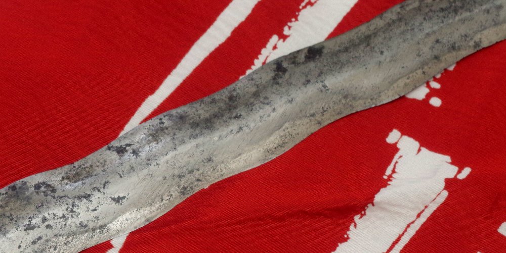

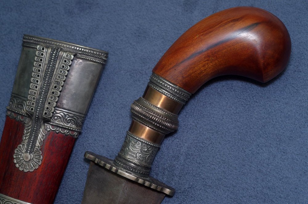

i tried acid etching with vinegar on the gunong and the kris,
the gunong when seen upclose shows very nice layers but doesnt show much in the pictures.
the kris seemed to be made from monosteel but with hardened edges. the temper line is not even (sloppy work on my part maybe? or the smith?)
anyway, i will polish the kris again to bring it back to silver metal color because i liked it better that way. i thought i was gonna find out that this kris has layers.

That's a nice gunong, PBH!

Really nice gunong and kris.Would love to see the kris after polishing.
