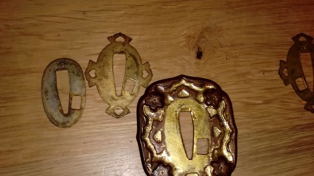

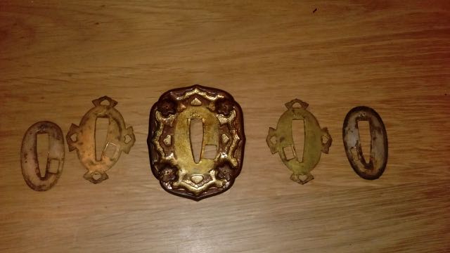

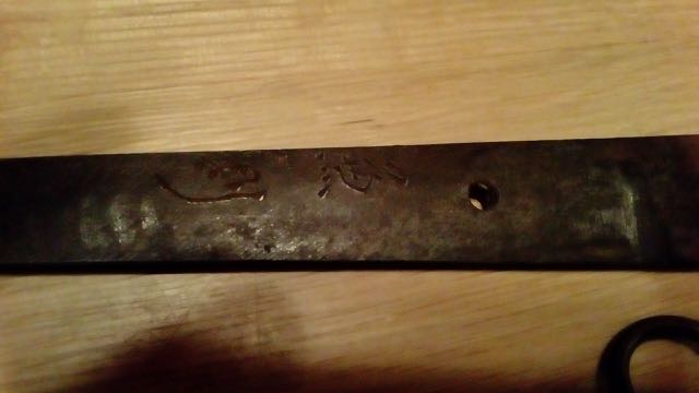

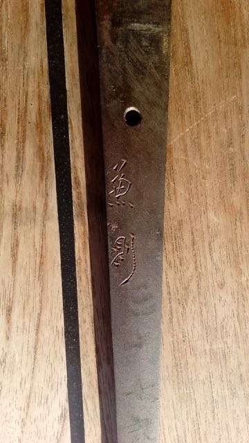

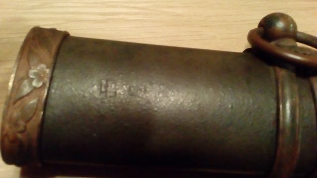

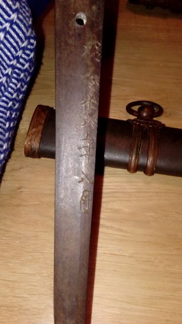

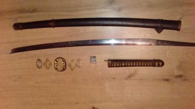

Hello everybody,
I post some pictures of a japanese gunto,
it seems a real one but not sure because there is a lot of ''good'' replicas...
The seller sold it for not much money:
1. he was not sure 100% if real ( hum...)
2. The blade is not sharp, unforged and with little rust.
All pieces ( tsuba...) have the same stamps: 20 ,
the habaki is not marked ( good ! )
the blade is not sharped and seems classic industrial WWII japanese blade
for officer.
Maybe anybody can read and translate the kanjis on the tang.

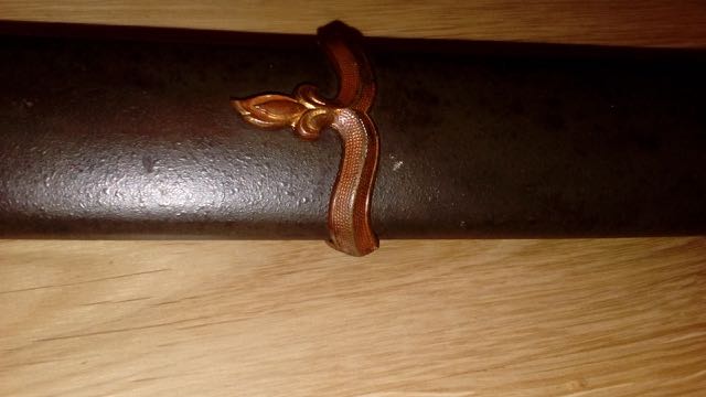

there is another 2 signs on the scabbard ( cf pictures ).
( inside the scabbard ''classic'' wooden structure ).
Thank you,
I tried to do my best with the pictures but !...
Old 10th March 2017, 08:20 PM   #2
francantolin
Posts: 969
pictures...

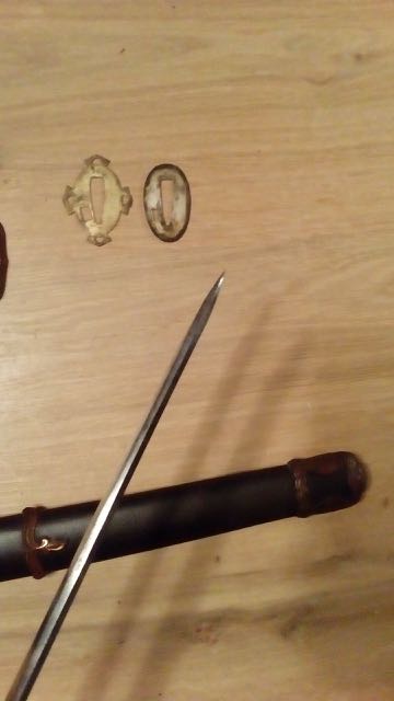

Old 10th March 2017, 09:53 PM   #3
francantolin
Posts: 969
another glyphe:

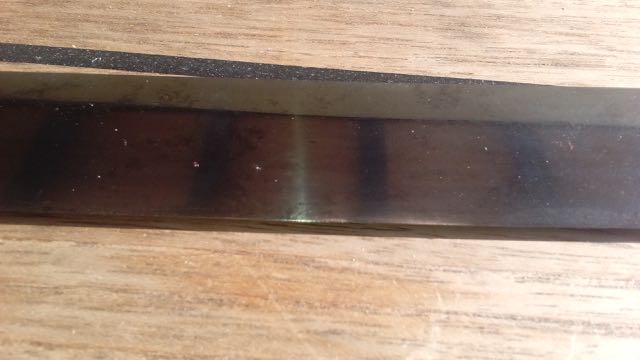

mariusgmioc
mariusgmioc's Avatar
Location: Austria
Posts: 1,918
An unsharpened blade points almost certainly to a fake/repro.
The kanji also look very strange and un-Japanese.

Rich
Rich's Avatar
Posts: 432
I respectfully disagree. Looks totally correct for a Showa era (so dated) shingunto. I think is reads Kanenori as the maker.

Posts: 969
Hello, thank you, I ll try to do pictures of better quality for the kanjis/signature on the tang. I read that officier gunto sword where sometimes unsharpened , more representation sword rather than made for war...

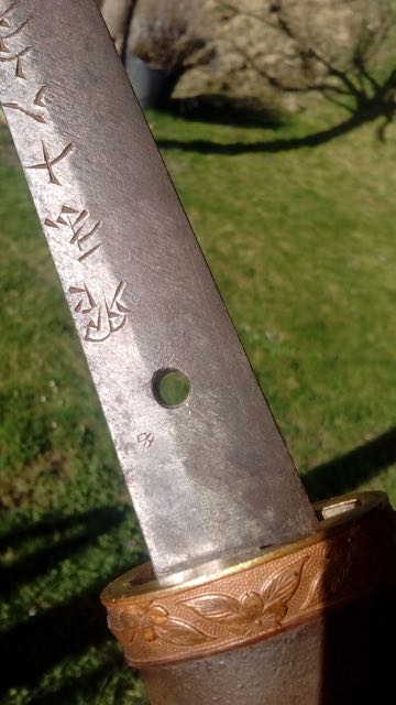

I wonder if I also see a fuzzy seki stamp on the upper right of the tang. If so, this would certainly not be a fake but a true gunto.
Can't tell by the pictures but it would be great if this were gendai, although the seki stamp makes this unlikely.

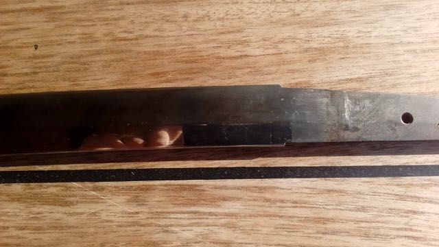

Old 11th March 2017, 08:41 AM   #9
francantolin
Posts: 969

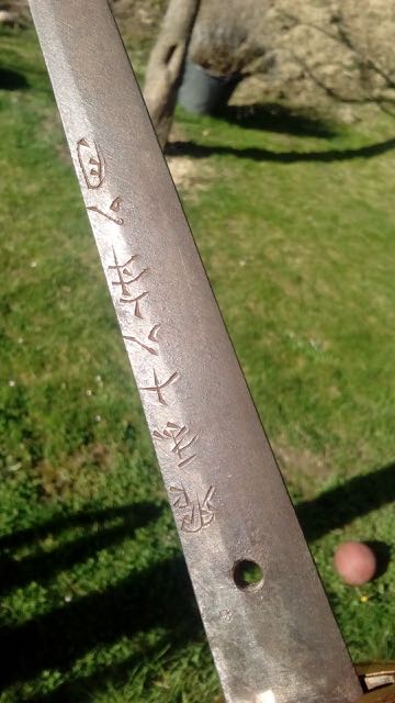

Better pictures !
Holy daylight !!

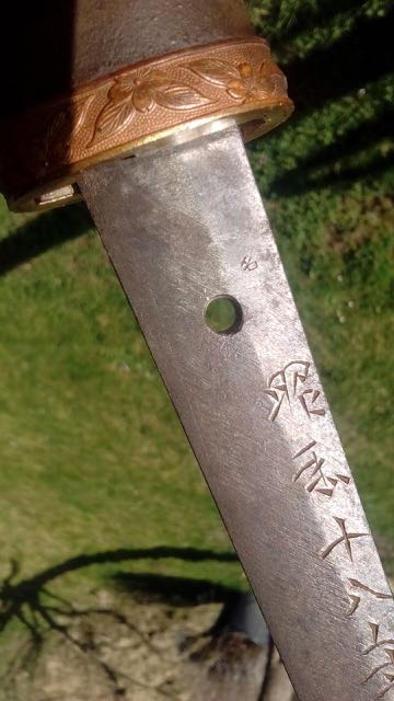

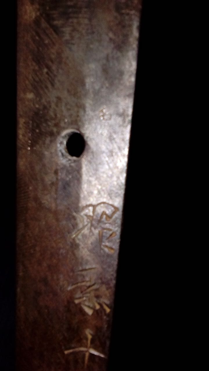

Old 12th March 2017, 09:02 AM   #10
francantolin
Posts: 969
No japanese specialist or WWII fanatic ?
I put the mei on right side !

koto
Join Date: Feb 2011
Posts: 27

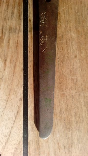

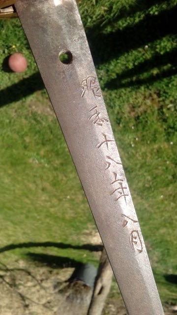

Rich is right about your shin gunto.
It is authentic.
The sowrd smith signature is Kanenori 兼則
Date inscription is Showa 18 years August (1943), with a Nagoya arsenal stamp.
Cheers

Rich
Rich's Avatar
Posts: 432
That is the date side. Showa ....... The makers mei is the two Kanji side. Also the stamp is a Nagoya Arsenal acceptance stamp, not a Seki or Showa stamp.
Kanenori is a known smith. Here is an example of his signature (Mei) and notice it also has the Nagoya arsenal mark.
http://www.japaneseswordindex.com/oshigata/kanenori.jpg
Hope this helps.

Old 12th March 2017, 01:43 PM   #13
Posts: 7,297
I believe that is exactly what you are getting with Rich's comments.

Old 12th March 2017, 07:20 PM   #15
GIO
GIO's Avatar
Join Date: Dec 2009
Posts: 335
A further superfluous information from "Military swords of Japan (1868-1945)" by Fuller and Gregory.
The explanation about figure vi reads: "Na or mei stamp. Very small and easily overlooked, this is probably a general inspection or acceptance stamp - as well as a Nagoya Arsenal firearms control stamp. Fairly common"
GIO is offline   Reply With Quote
Old 12th March 2017, 07:25 PM   #16
Rich
Rich's Avatar
Posts: 432
Not sure what you mean by "industrial or semi-industrial". With the exception of the "top end" gendai smiths, most other Showa era blades (whether hand forged or not) were made in factory settings using production line methods (smith forges blade, someone else polishes it, yet others mount it, etc.).
IMHO, Kanenori falls into the latter catagory - probably hand forged, but not of tamehagane, and then passed on for polishing,mounting.
Here's a page that may be of help.
http://www.japaneseswordindex.com/showato.htm

Old 12th March 2017, 10:54 PM   #18
pbleed
Join Date: Jun 2005
Location: Little Rock, Arkansas
Posts: 89

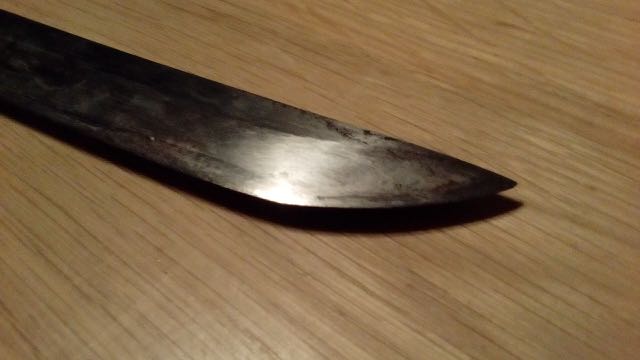

Dr. Stein is correct. this is a Japanese gunto made in August 1943 by a cutlerer named Kanenori. He was a an established producer of military swords. This sword is a wirthy example of wartime swords. The point may have been abused, but overall the the condition is not bad. Post thsi sword on the Niponto Message board anf you will get a fuller account.
Peter
