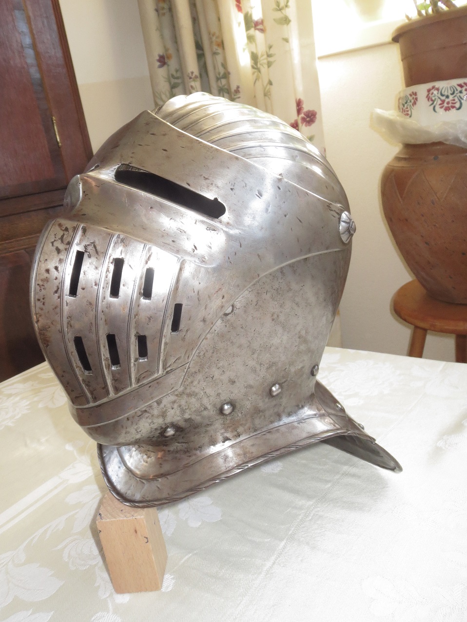

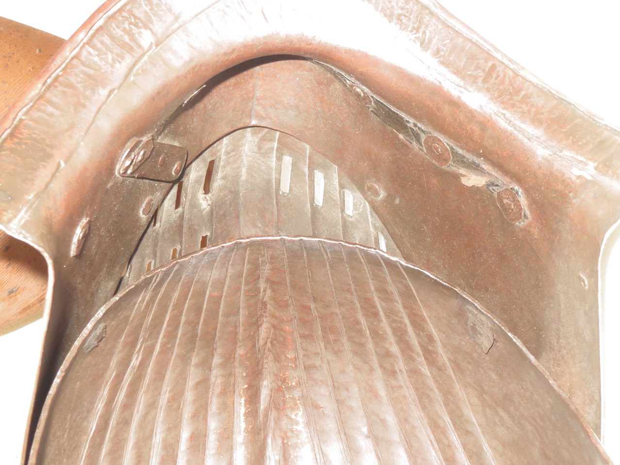

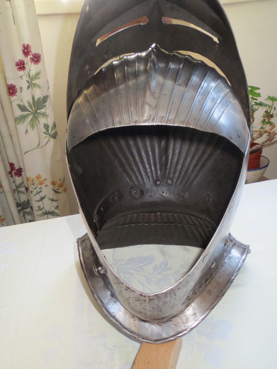

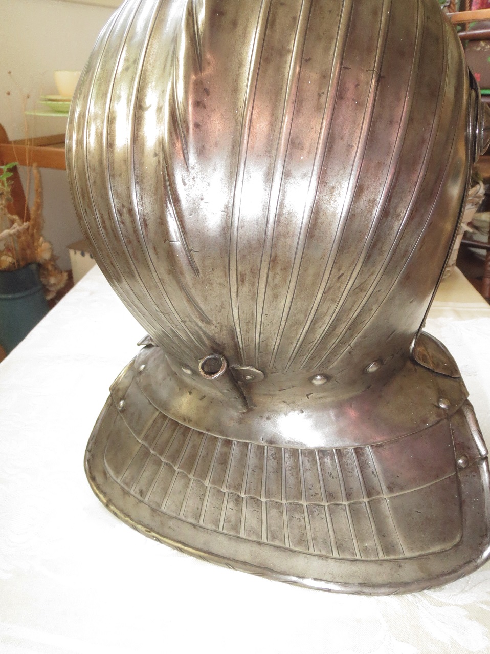

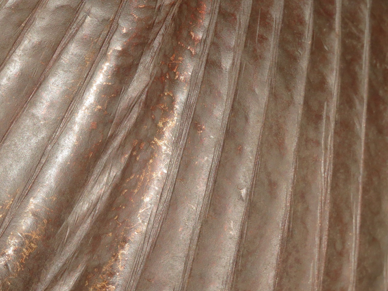

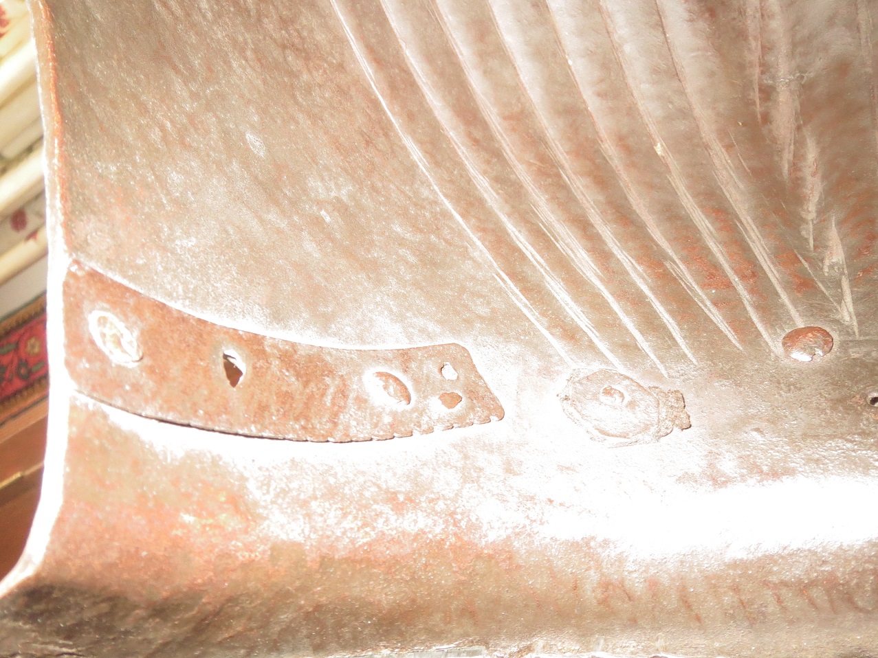

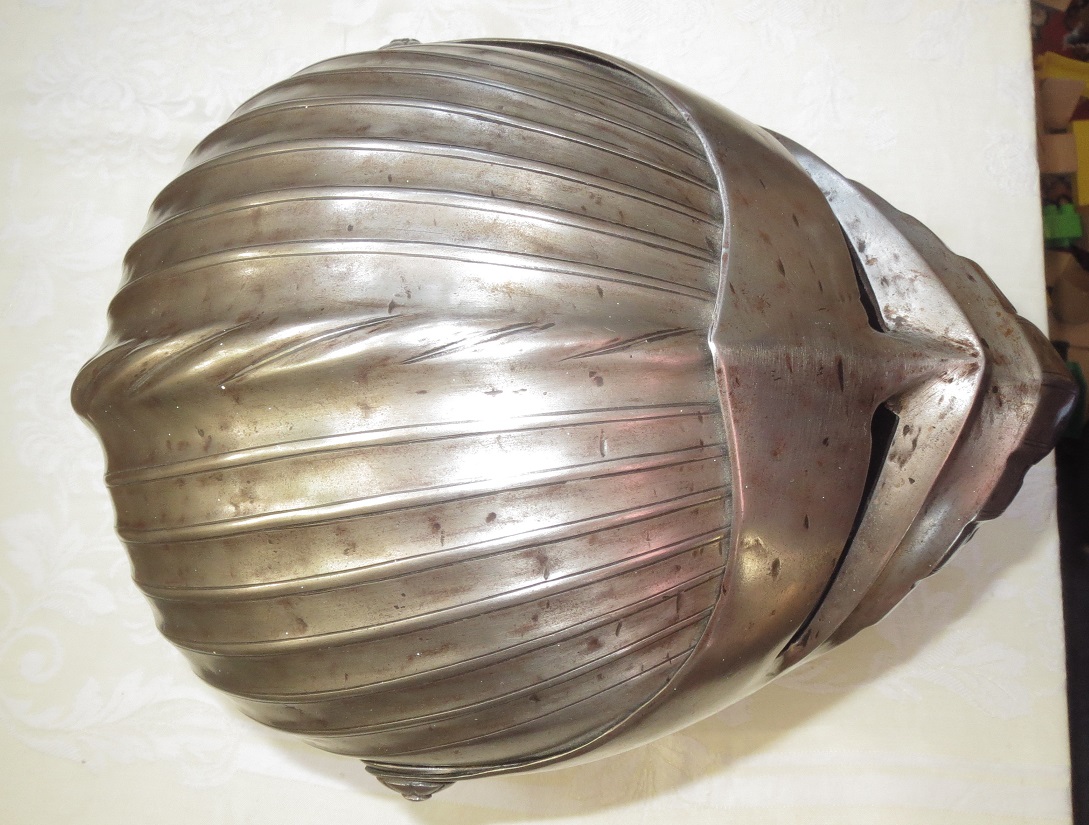

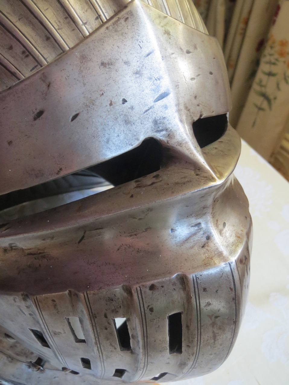

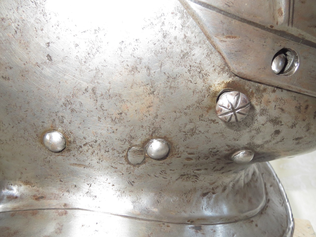

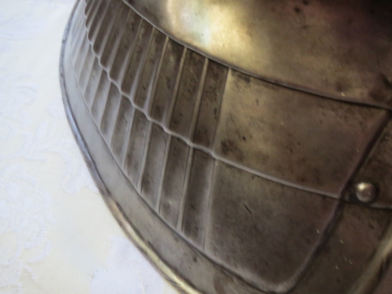

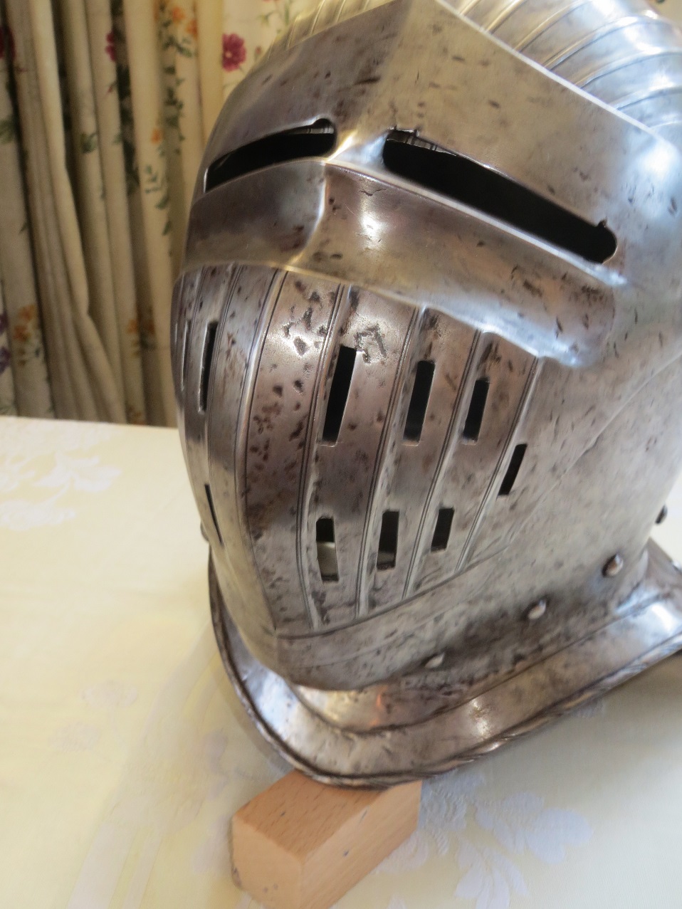

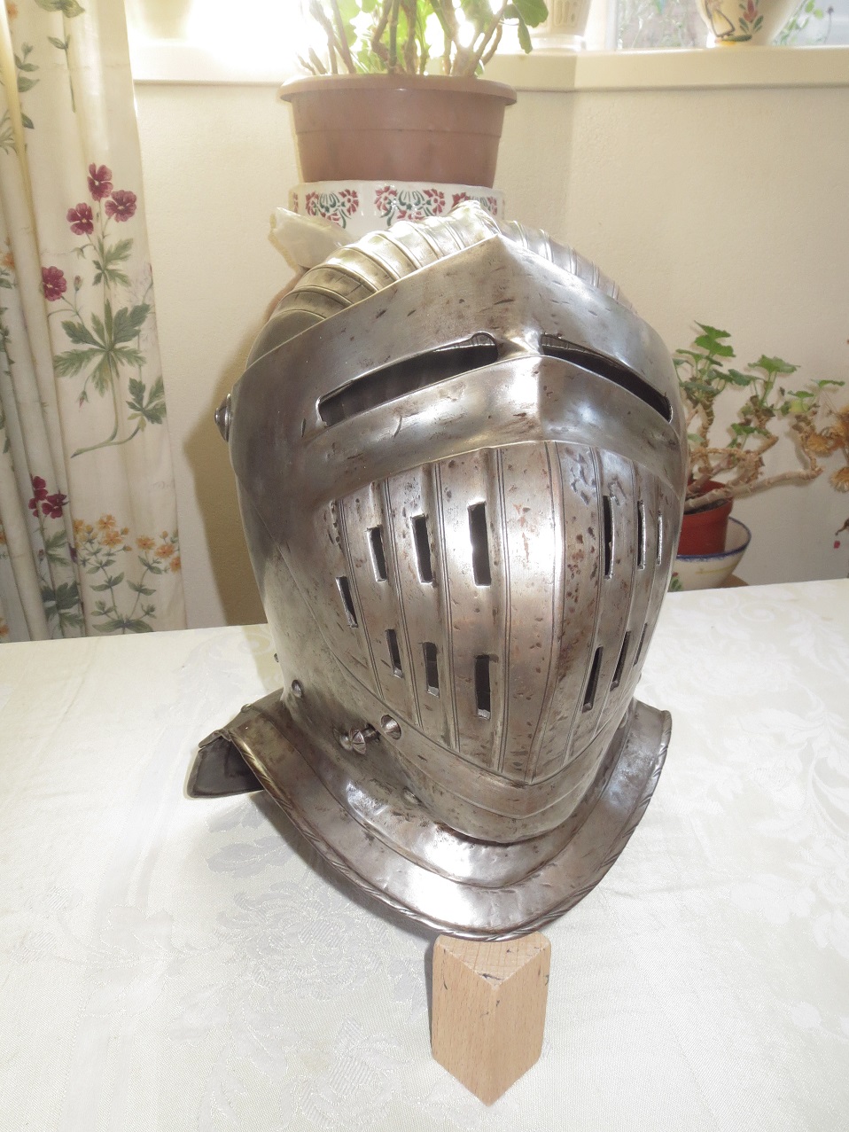

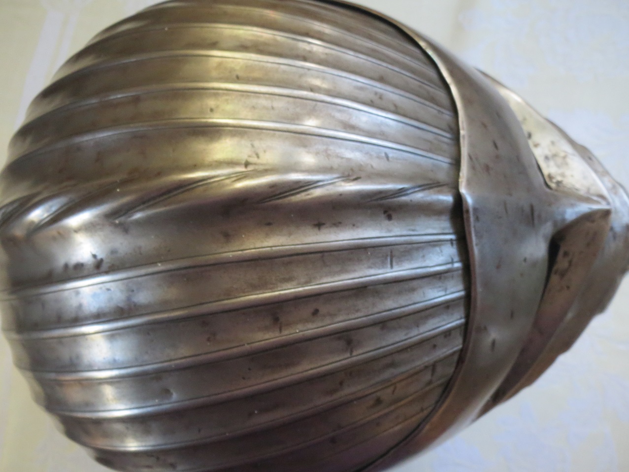

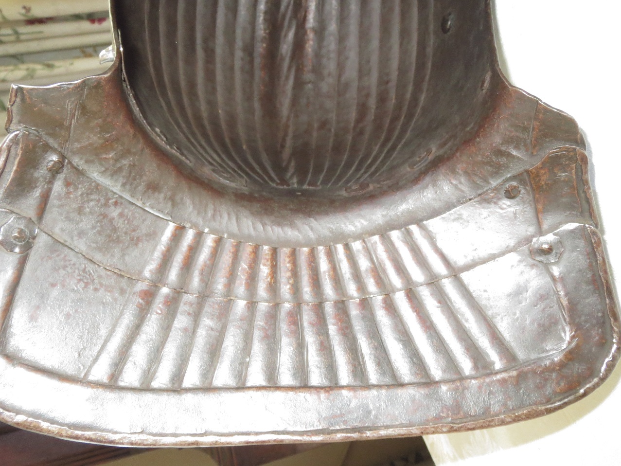

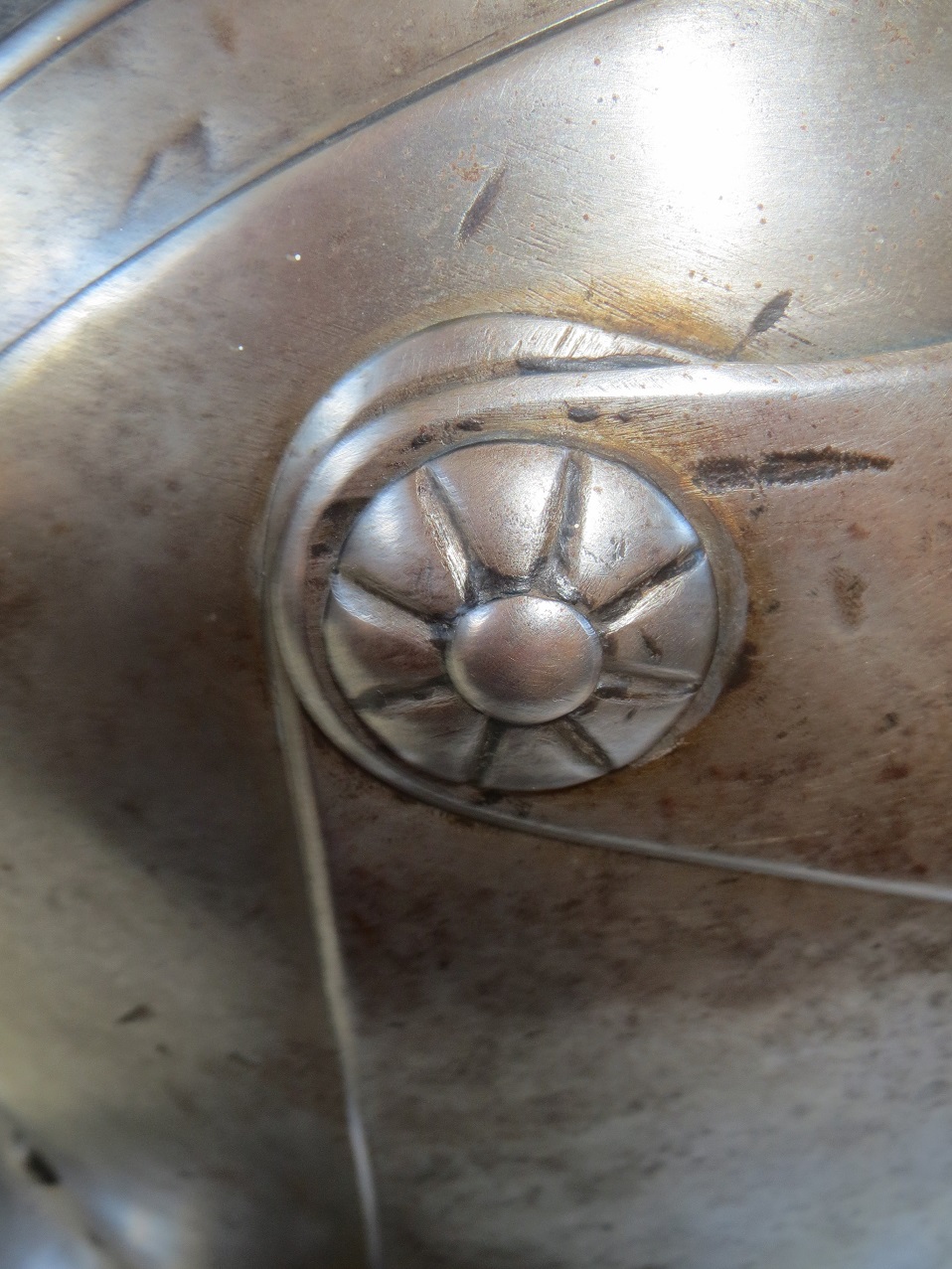

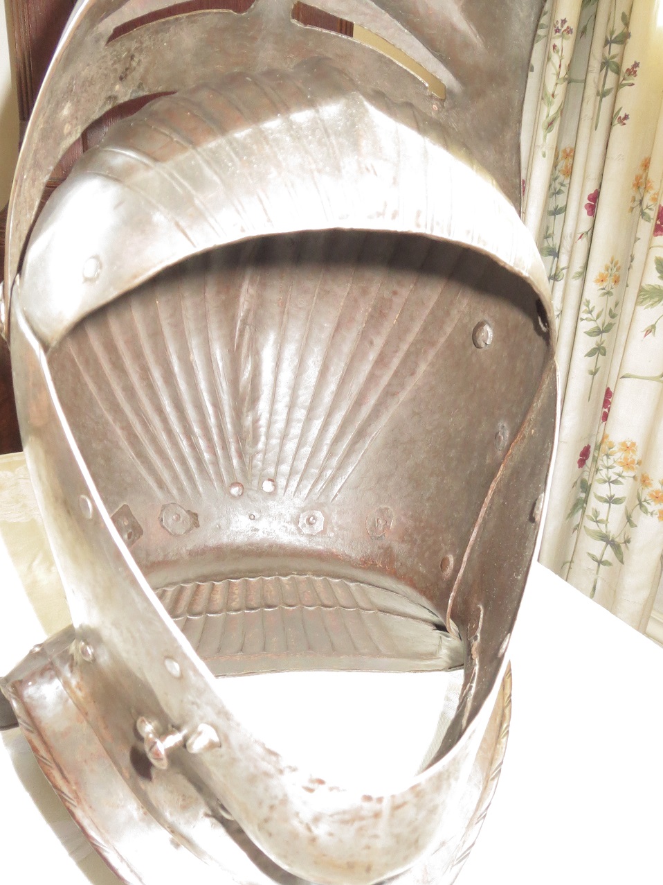

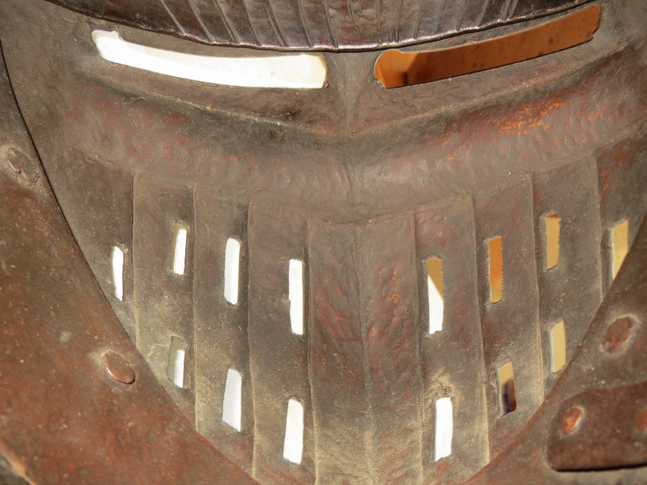

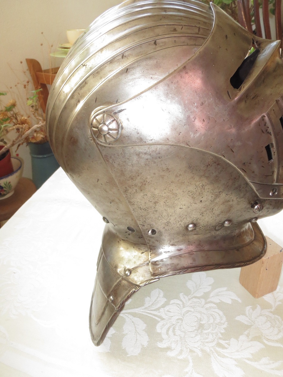

Recently this close helmet of fluted maximilian type has entered my collection.
It is 32cm high (with lames), 20cm wide at the skull, 26cm from back to visor.
The neck opening is 15 by 16,5cm.

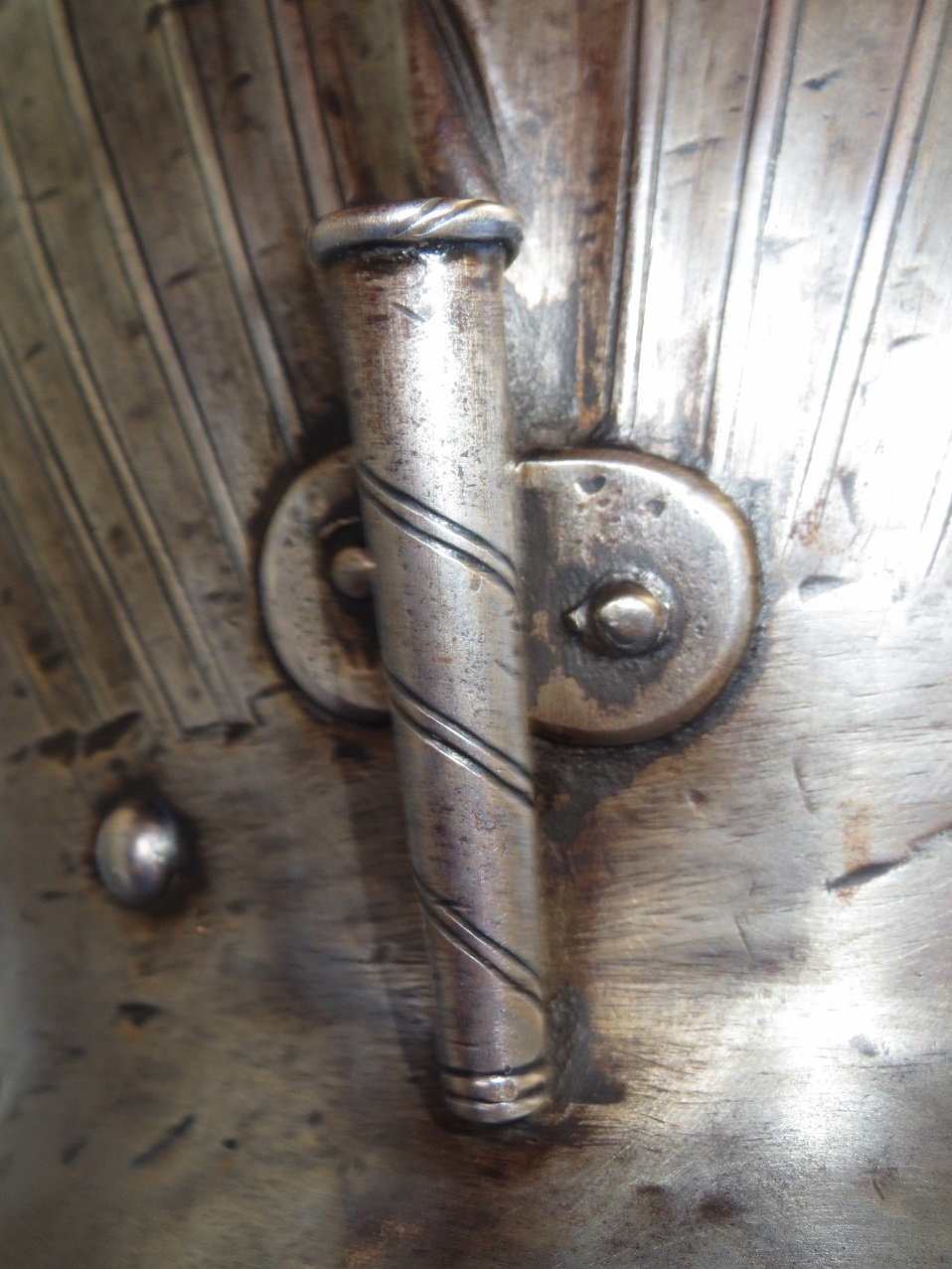

It can be opened by means of a push button (missing) just as the visor (see pictures.)
Can anyone tell me the age and any other relevant information this is my first helmet

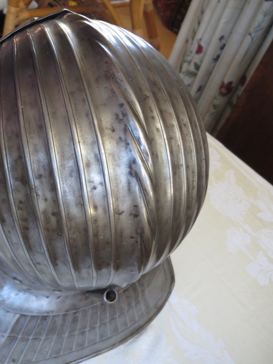

More pictures

and more

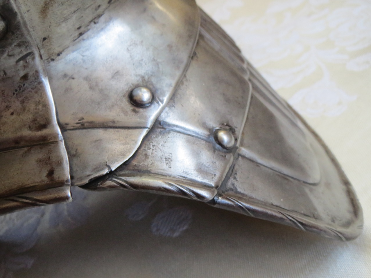

And more, if need be i have more pictures. Problem is i won't be back until next year after tomorrow.

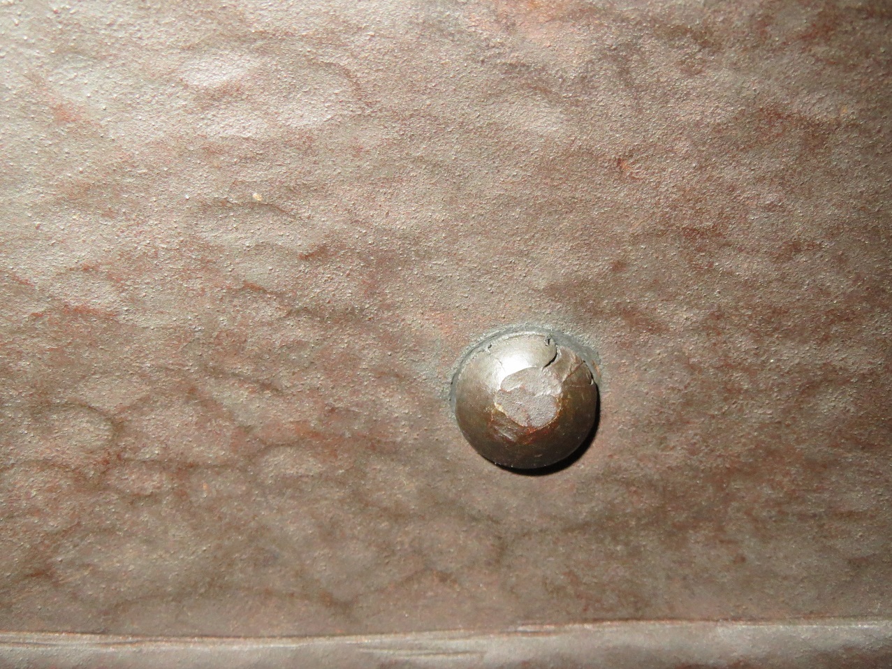

nice one- piece skullconstruction ,good hammerwork visible from the inside, i suspect you have just entered the most difficult section of collecting arms and armor! best regards iskender

Marcus,
I think that the visor is wrong .
If you look at the slots for the eyes you will see that they are too high so would not allow a good vision.

Thank you Nando, Iskender and Cerjak
The pictures are all taken slightly from above, had to do it on the table with the most light which was also the table with a lot of toys from my nephews around them the helmet itself is supported by a wooden building block in the pictures hahah.
It lines up perfecty though when it is in its correct angle (neckplates are now too verticaly placed on the pictures, making the chin face upwards as is the visor).

hello marcus , 10 minutes beforehand i would have posted the message that the helmet of yours would look normal without standing on the woodblock. greetings iskender ( now in cronstadt visiting the old fortifications there)

Constructionally, based on photos of course, I see lots of things I like, the proper hammer marks inside the bowl indicative of being raised from a single piece of steel as well as the marks inside of the flutes from being worked over stakes, cut washers, beveled exposed plate edges, nice old patina. Is there any chance of getting a weight on it? I'm inclined to think, again based only on pics and not having had it in the hand, that you have an excellent original example of a helmet for this classic Maximillian style from the 1530's.

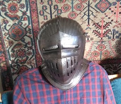

What kind of suspension would have been used in such helmets? Surely, there must have been something to keep the head from bouncing inside the helmet.
Have you tried it on?

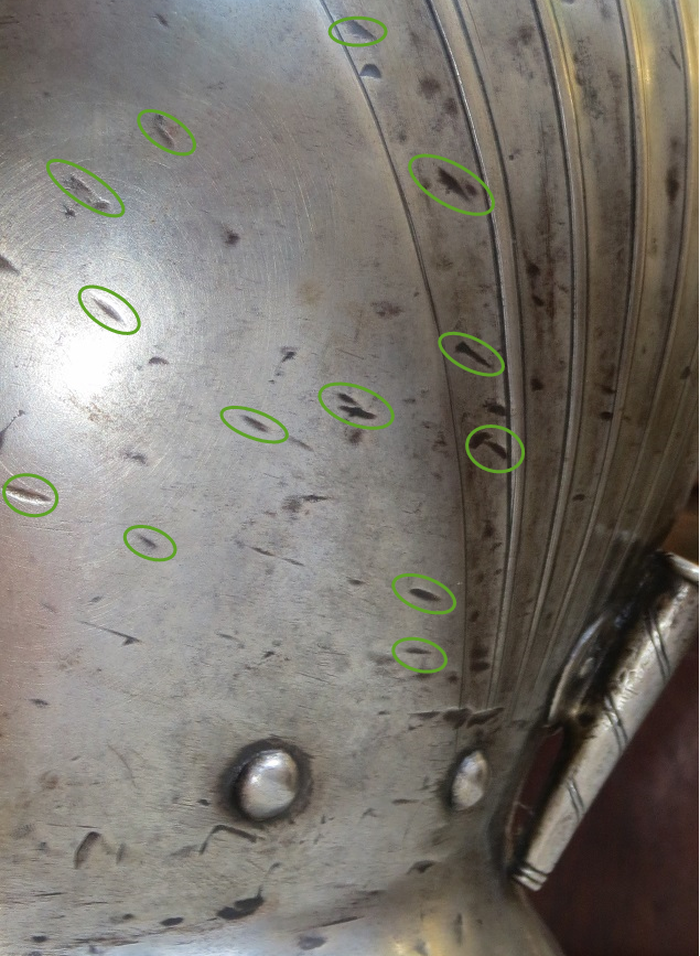

My knowledge of armor is limited but I am intrigued by the pattern of marks all over this helmet. Was this normal for this style? What would be their purpose or origin?
Old 3rd January 2017, 05:41 PM   #14
I am certain that Marcus has made a safe deal and this is not a well built late reproduction, given the price such genuine helmets may cost. Say Marcus, hasn't the seller given you evidence of its authencity ?

Could it be an earlier reproduction? Maybe 19th C? I don't really know, I just found the pattern of the marks interesting.

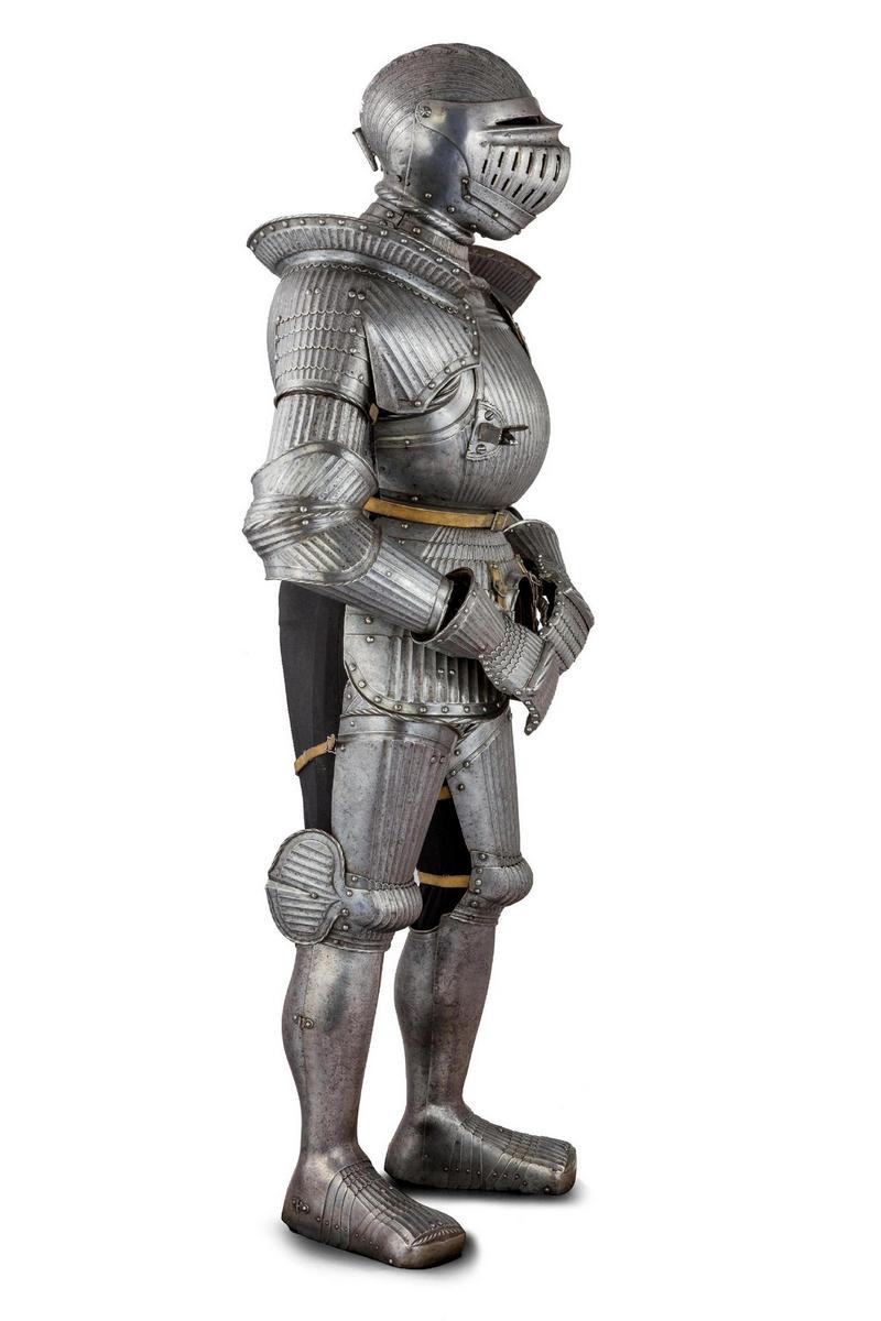

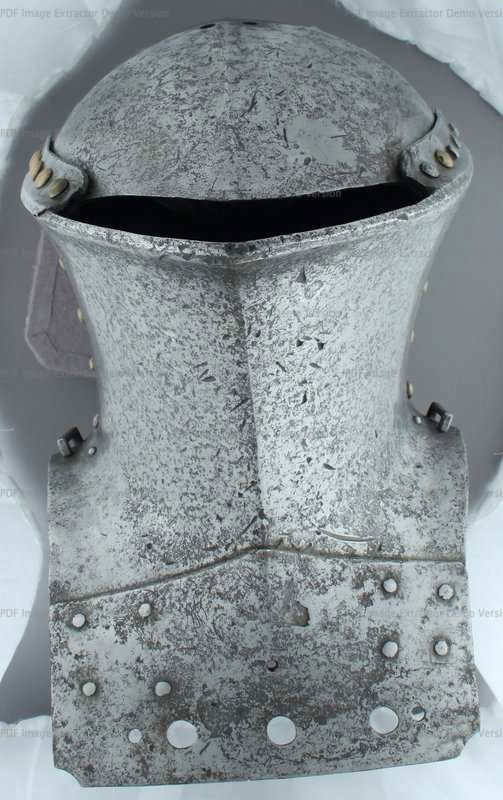

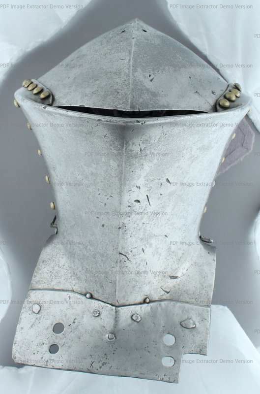

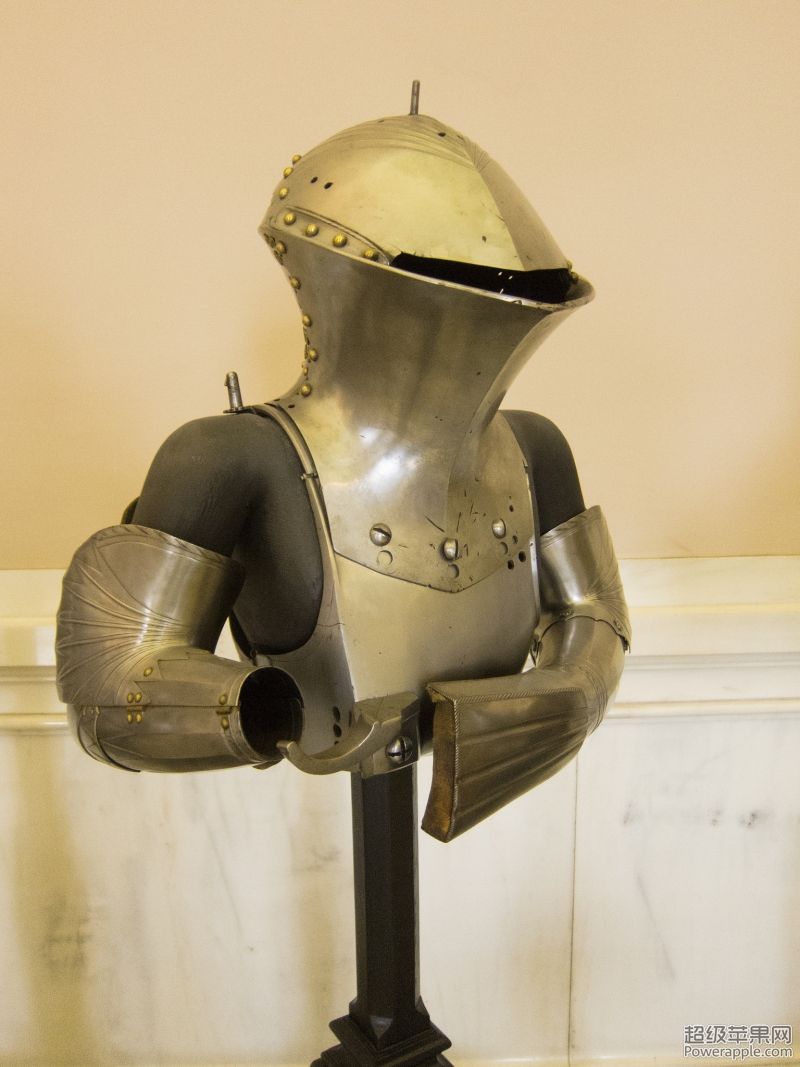

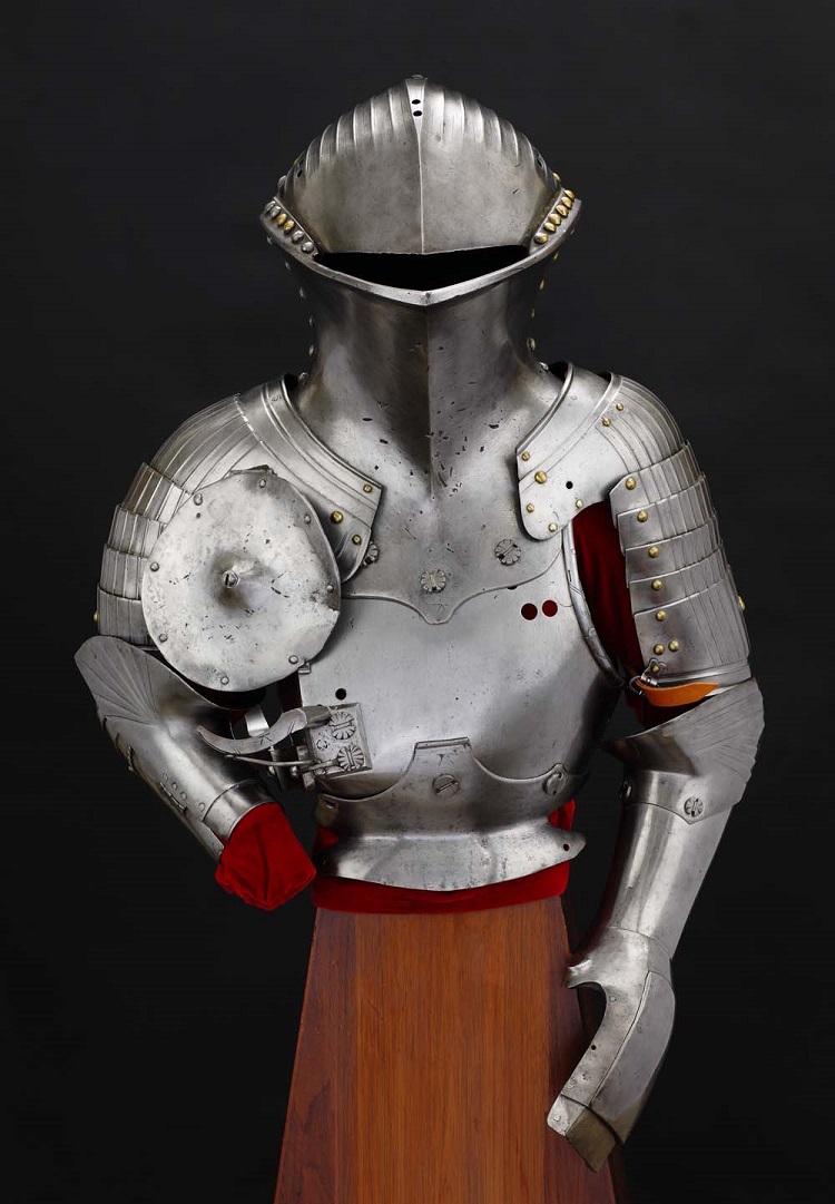

It has come to my attention that some people question my original post about the age. As to its provenance, i do not know i bought it at auction without further information other than there assumption it is 19th century.
Some other members told me they know for sure it can't be original, others claim it is.
All i wanted was to verify my own interpretation which differs from auctions most of the time... and i hope that most of you can agree here that auctions don't know everything if anything at all especially about such items as this close helmet.
Please make this a real discussion and not something behind the curtains, because if that is the way things need to go, i am out!

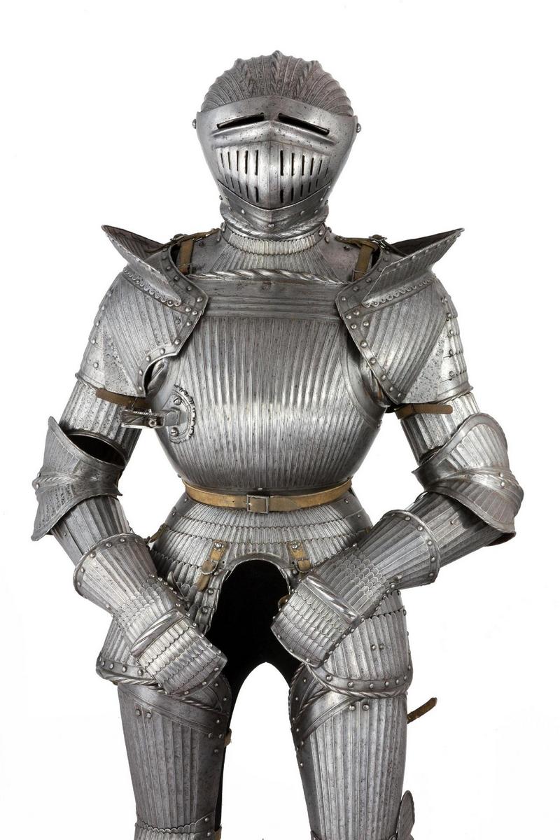

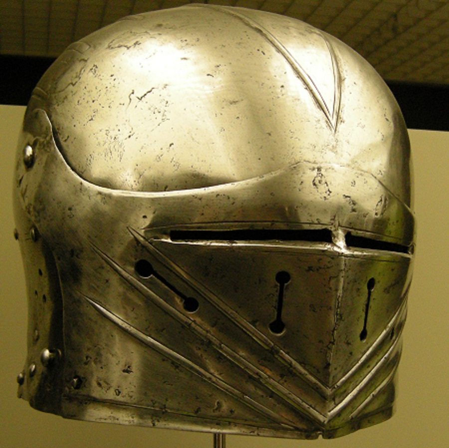

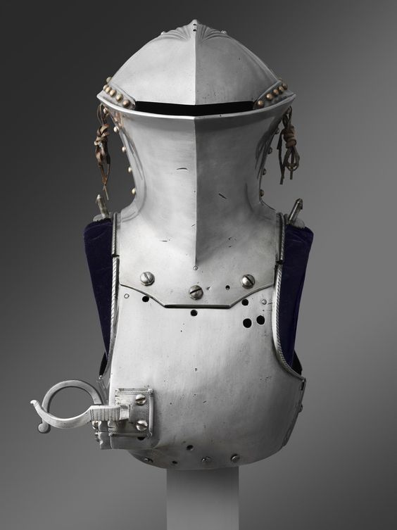

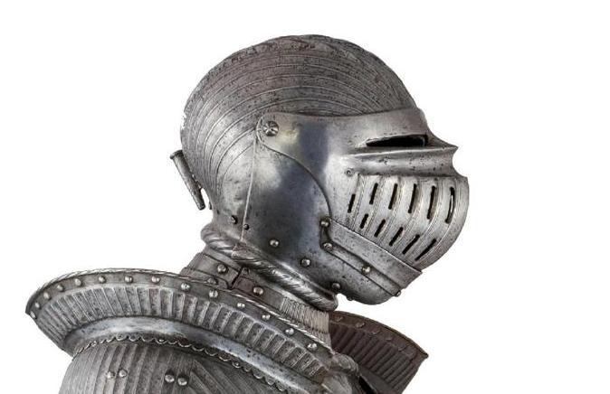

No than, here are some original pieces of armour (as far as i know) with similar markings.

ps Batjka, Yes i tried it on, but my head is to big.. sadly
The liner would have been something like this is suppose.

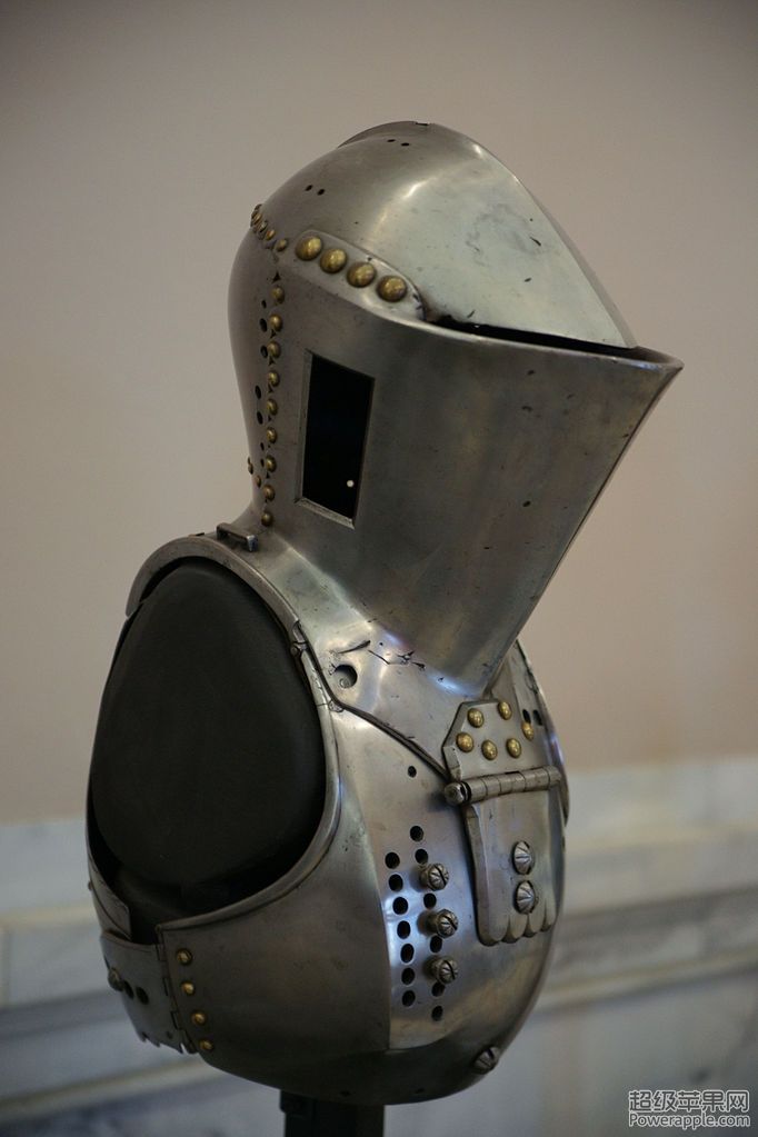

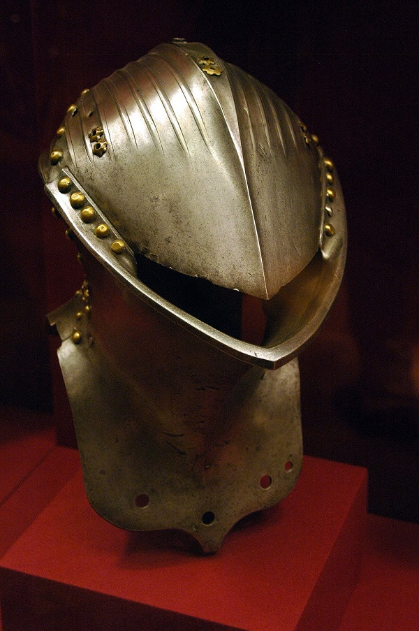

I specifically looked at tournament armour (stegzeuge) because of the probability of damages.
If anyone has other period armour with damages, please post these. This would be very enlightening.

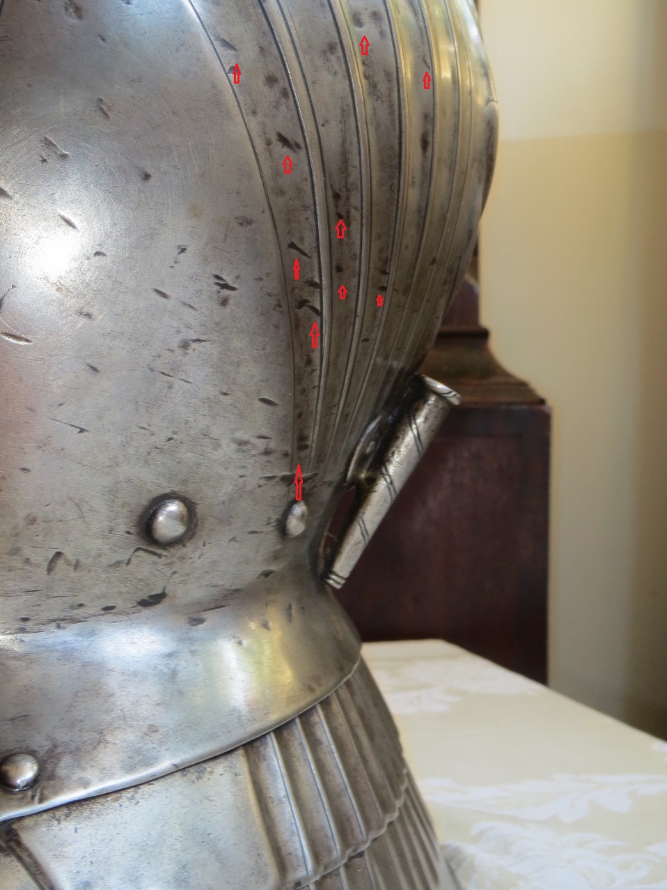

Hi Marcus,
thank you for showing us helmets of the same period to compare with.
It does happen and has happened before that auction houses mistakenly label good authentic pieces as 19th C.
That being said, the bigger or more experienced the auction house has, the less this happens.
Looking closely at the helmets presented it seems there are some differences in the impact / pattern strikes .
Most of them have a around dozen of these impact and are different in shape, none have all the same looking impact marks.
The place were these marks visible on the helmets as presented here are in the neck area or the place were a sword blow would have been deflected to in case of a frontal blow.
On the Maximilian Helmet I easily count around 50 impact marks, they all seem to come from the same object the only difference is that some are deeper than others. What concerns me more is that they are structural divided over the whole helmet and appear in places were this helmet would in most cases deflect a hit or blow.
I think we can rule out sword blows completely as many of these strike marks are in the deeper part of the gully or groove.
These impact marks look like they are made by a hammer.
They don't seem to come from a war hammer but rather from the back of a modern hammer.
They have a repetitive similarity,when they were inflected concerning : force , angle, shape of the object and distance , all these circumstances together would be impossible in battle.
In my opinion , the battle blows you see on the other helmets was exactly what they were trying to mimic, but they over did it.
I hate to visualize the situation, a nutcase with other intentions hammering from a distance of 50 CM an otherwise beautiful handmade helmet.
Of course I would like to hear other thoughts as well.

I like the look of this helmet. Somebody has put a lot of effort in making it. But it gets let down by poorly applied ageing. The exterior marks are as others have said -- Not correct. I would also question the inside patina, from the pictures it looks like it has been rusted artificially. The photographs appear to show bright steel in places under the rust. Next, the visor. Hard to tell from the pictures but the steel looks a little thin, I would also question the burrs left on the inside of the chisel cut openings, not something you would expect from a true artisan. Last bit, the visor construction seems to be overlaid steel plates but the exterior has a shaped but smooth finish. So has this been welded and filed down? Of course fire welding has been around for a long while but this requires heat and hammering but I can see no sign of this on the plates. OK, that's me done--- Age, I don't think it has any. Just my feeling and I am not a expert and have never played with a helmet of this supposed era.

I think the first thing to look for is flaws and inclusions in the plate . Most genuine armour will show some stress cracks , flaws and other imperfections that are part of the material itself and this is something that is difficult to fake. Secondly armour that is either modern or Victorian will invariably have started life as a uniform flat steel plate, as opposed to a lump of material that is beaten out by hand and progressively eased into shape . This tends to produce variations in thickness which exist irrespective of the hammer blows used to shape the piece and can usually be felt by running the plate between your fingers.
As a footnote you might expect an armour of C1530 to have outwardly turned roped edges but this is by no means a definitive guide to date.

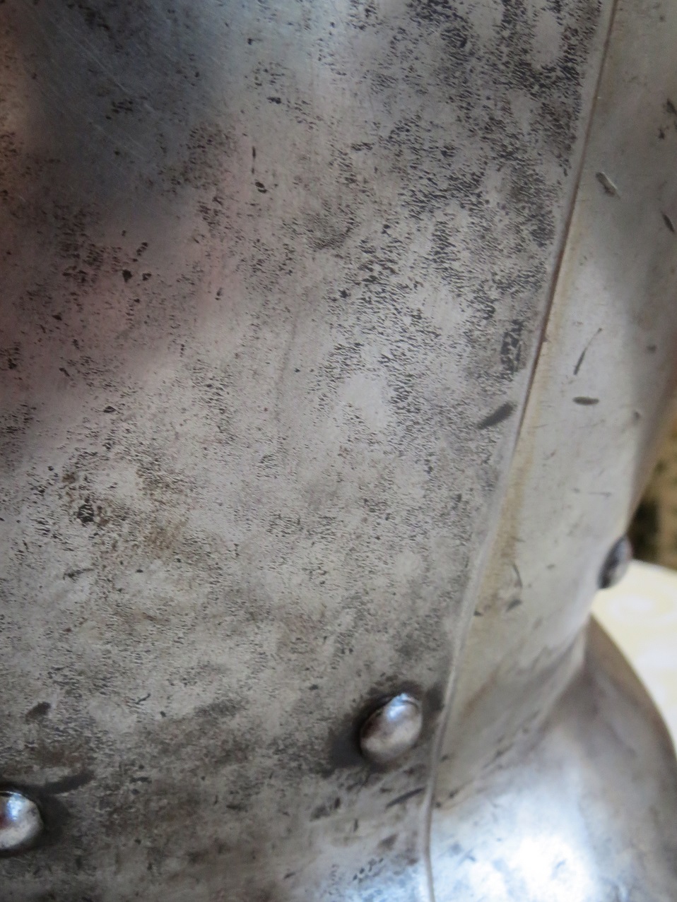

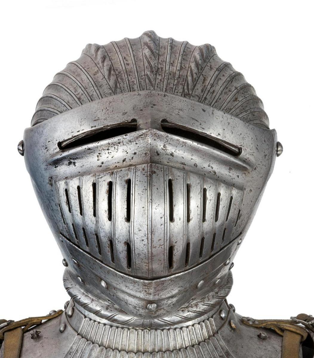

16th century metal just has a different look than 19th or 20th C metal, in this picture you can see the difference on the surface of the helmet.
The black spots are not from damage but older metal has more impurities that over time translates in the more visible cracks , black spots and as here delamination.
None of these traces look homogeneous or uniform on 16th or 17th C metal, there is nothing repetitive about them.
In Attempt to mimic these signs of age they use various methods, for instance damages, or chemicals to create rust, the results exits in as many forms, but none have the exact look of the originals.
Once you master to recognize this difference you can start identifying the reproductions.
I suggest you read scams and fakes a lot is explained there
http://www.vikingsword.com/vb/showth...ighlight=scams
IM afraid its not exaggerated, and as Michael pointed out the current scientific dating method is accurate by a 500 years margin.

Jasper, I look forward to your notes as well, and would suggest that we mention the name of the auctioneer here privately only. I look forward to your assistance as well in noting what to look for in authentic examples of these helmets.
the workmanship is quite poor for an original Maximilian armet, especially the ventail-visor, these helmets were manufactured by top master blacksmiths.
furthermore the damage and dents seem to be artificially applied.
it is IMHO a helmet from the second half of the 19th century or early 20th century.
see attachment for comparison of a suit from the second half of the 19thC. ( style of 1520-1530)
