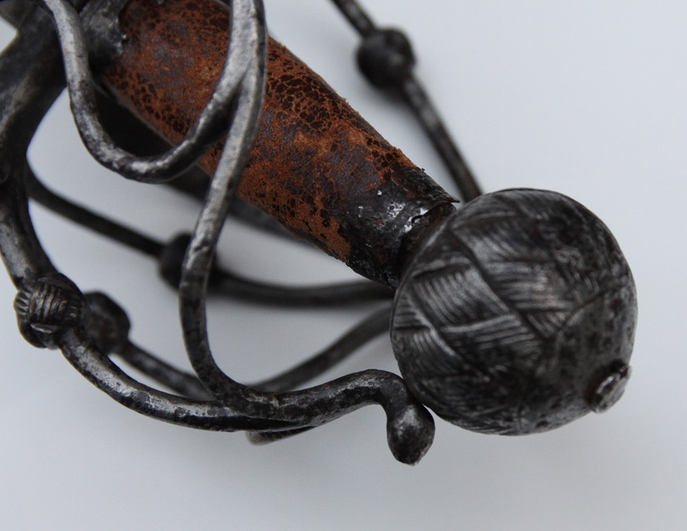

Default A late 16th century Dussack for comment

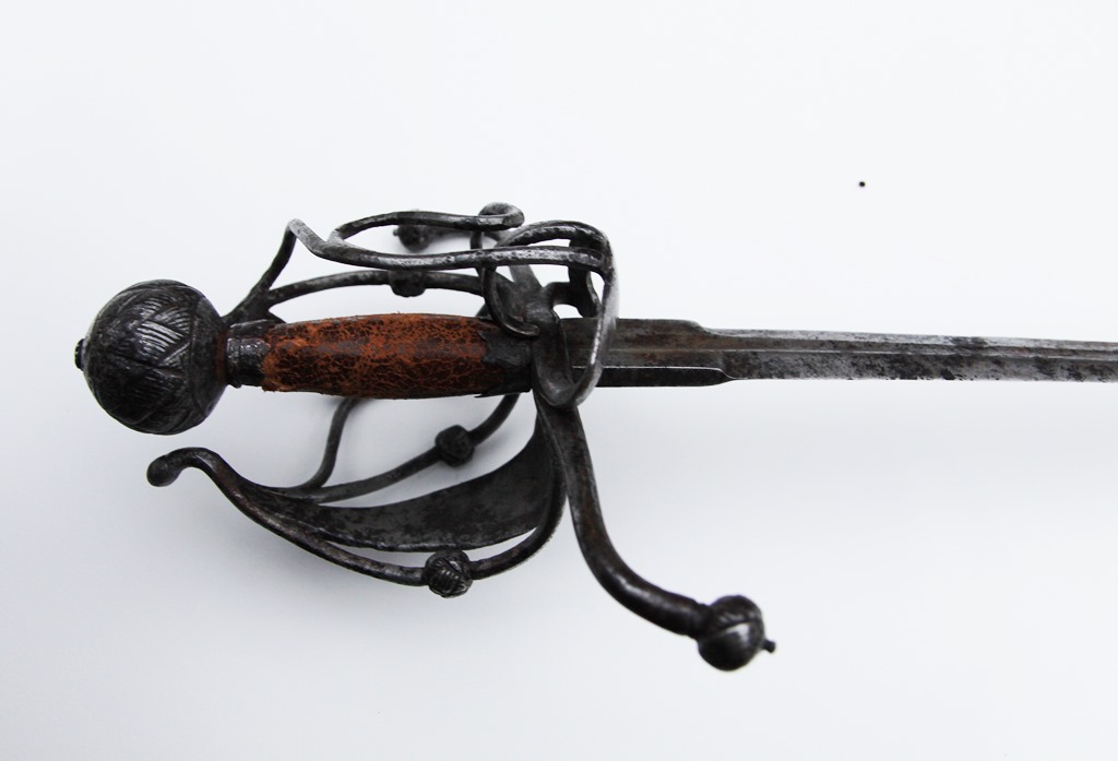

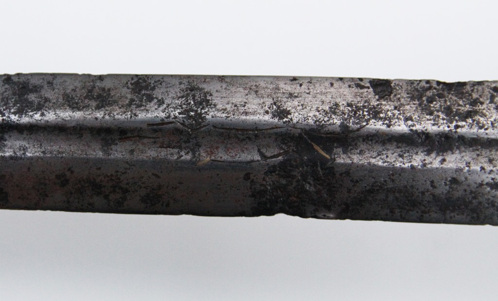

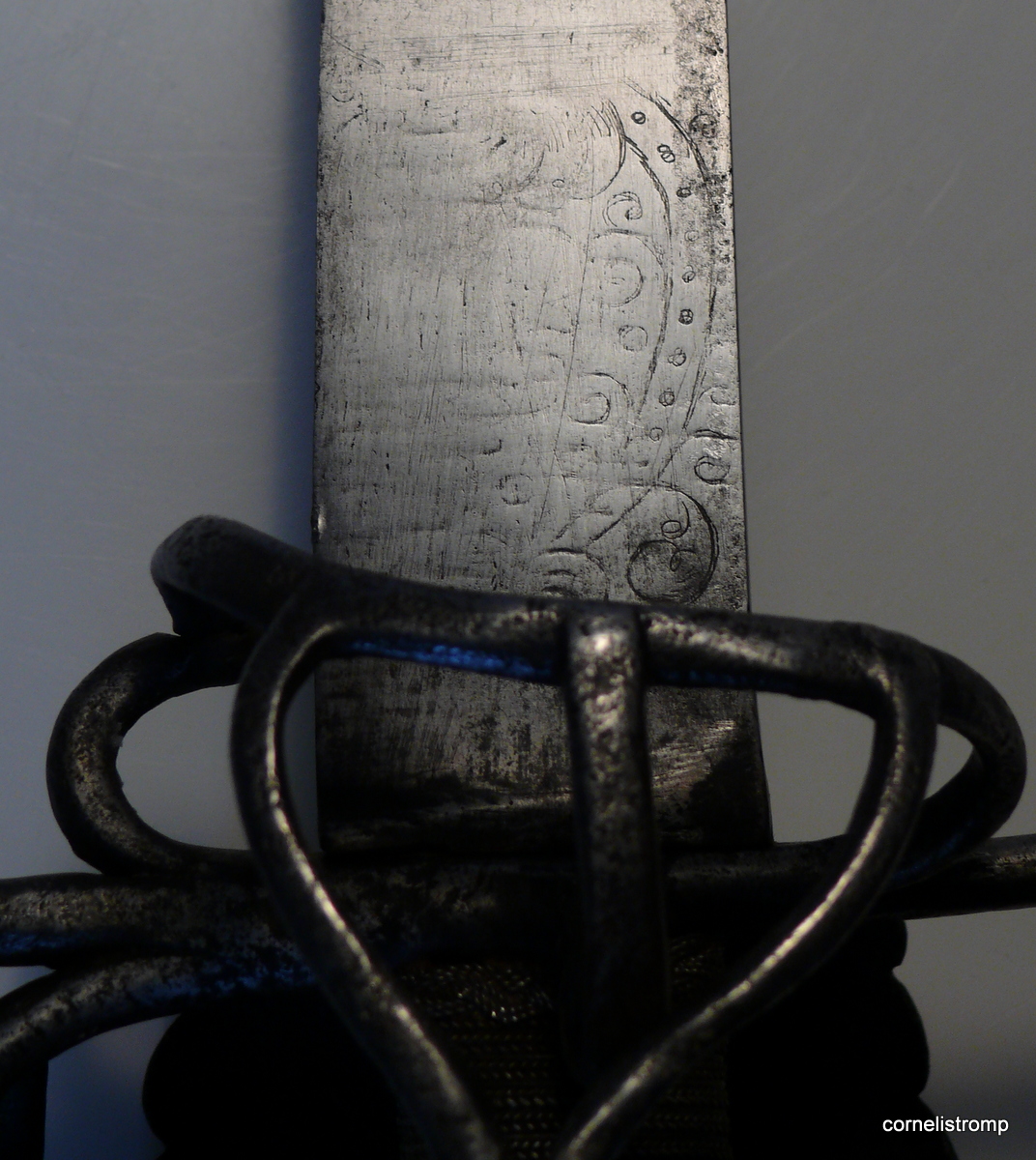

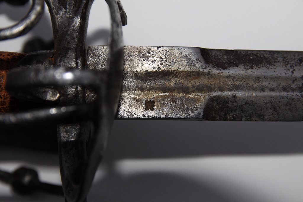

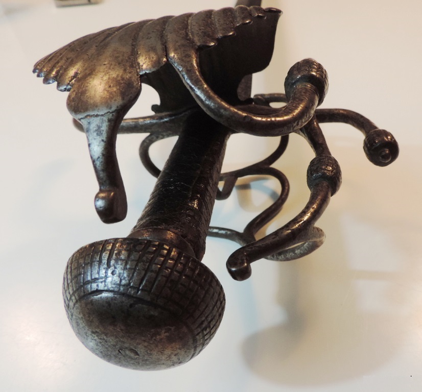

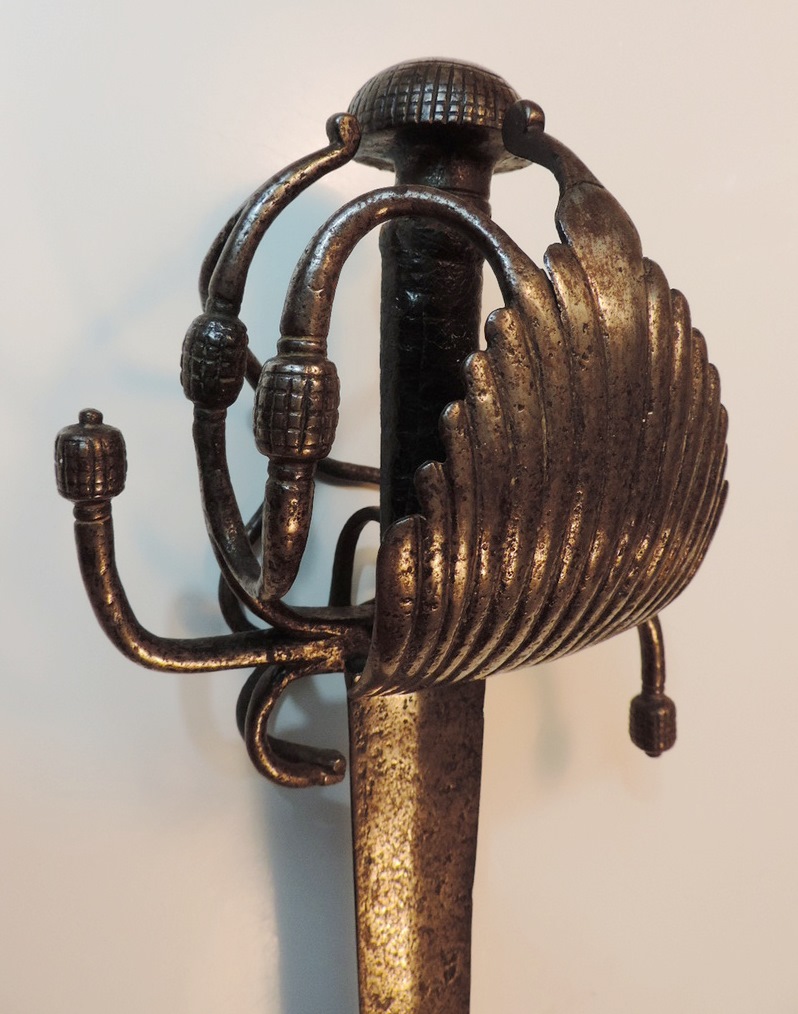

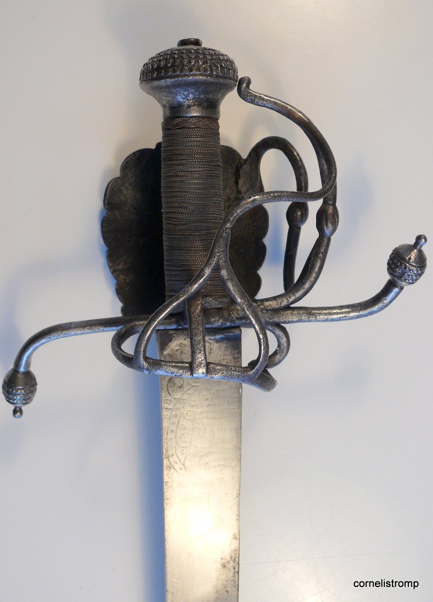

O.L. 93 cm ; blade L. 79 cm; blade width at hilt 2.9 cm

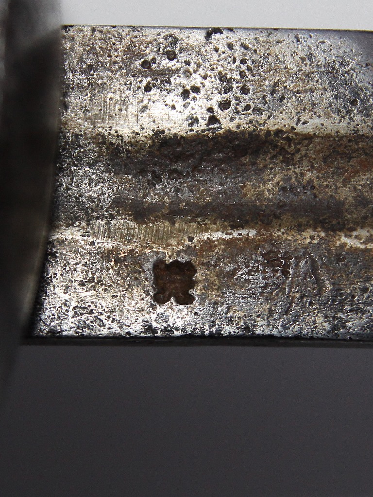

Marks Passau wolf in one side and one stamp on the ricasso in the two sides
Any comment on it would be welcome.

Posts: 1,071

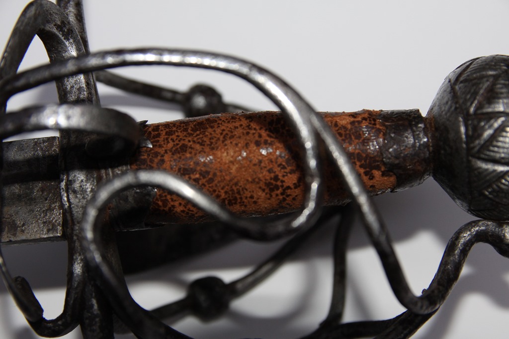

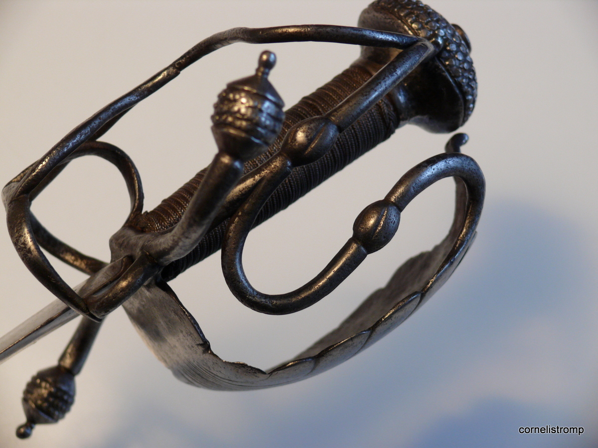

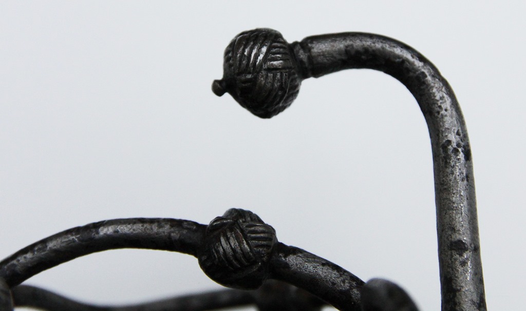

the sword is a very early one so around 1560-1570.
a hybrid model between the baskethilted sword and rapier.

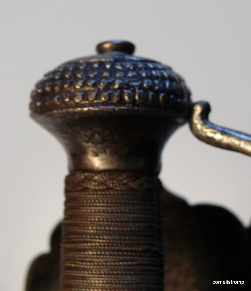

beautiful sperical pommel with a design of plaiting, as also occurred in different guard finals in the middle of the 16th century.
probably the original grip.
one side note:
perhaps the blade is not the original one, because there is some space between the finger guard and the ricasso. but it is an early blade which originates from the third quarter of the 16th century.
very beautiful weapon, congratulations!

Posts: 10,867
As Jasper notes, blade may not be original, though still of period. Most of these 'dusagge' in variations were indeed apparently the inspiration or compelling force in the development of the Scottish basket hilt.
Interestingly these often gained the term 'Sinclair sabre' as they were typically with heavy sabre blades, the term a misnomer from an unfortunate event in Norway where a Scottish unit was decimated
The chiseled 'running wolf' is regarded as the distinctive mark of blades from Passau, and the single stamped mark opposite is the 'mill rind' or 'twig' mark often heavily employed in North Italian blade centers. These regions are fairly close in proximity so traffic of blades between them does not seem unlikely.
Very nice example,now to look more toward the interesting motif in pommel and guard plate.

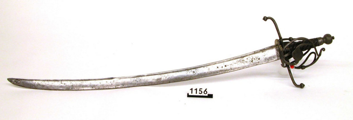

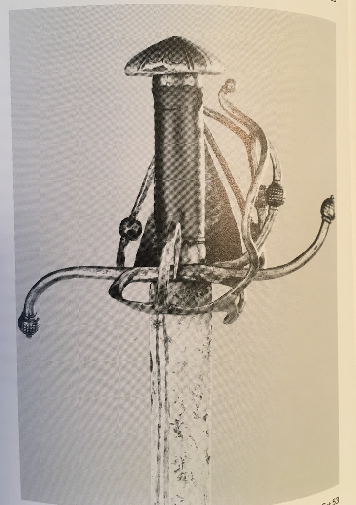

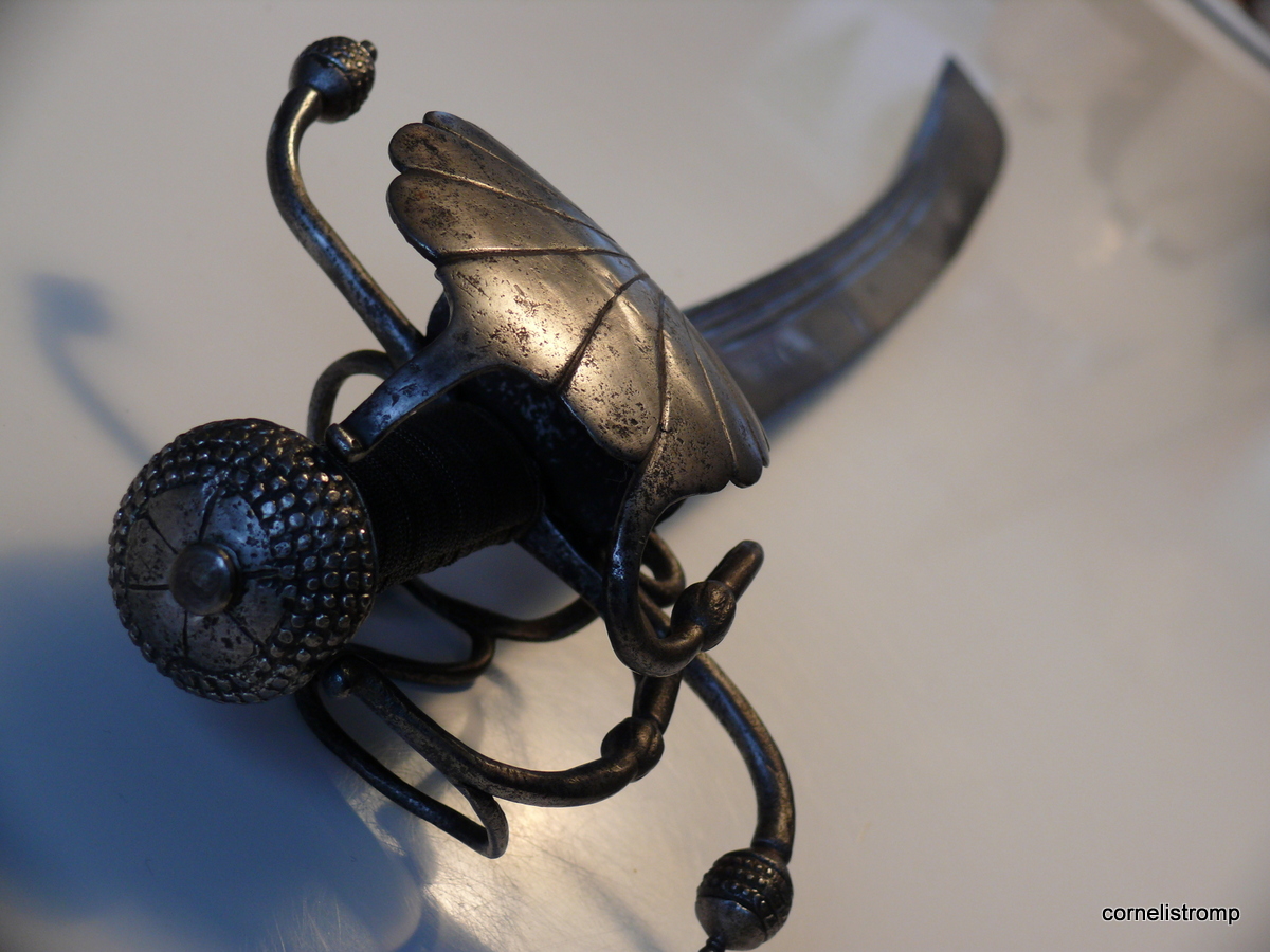

similar hilt type in Dutch army Museum.
Attachement JP PUYPE van maurits naar munster.

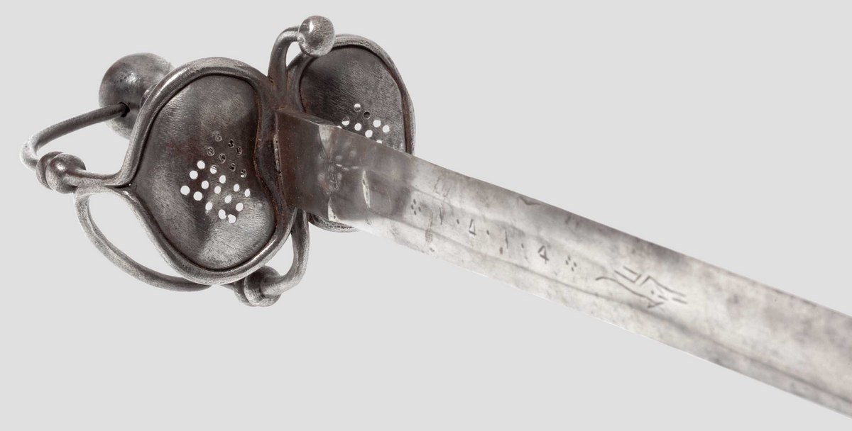

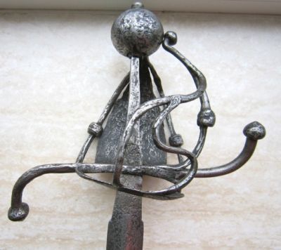

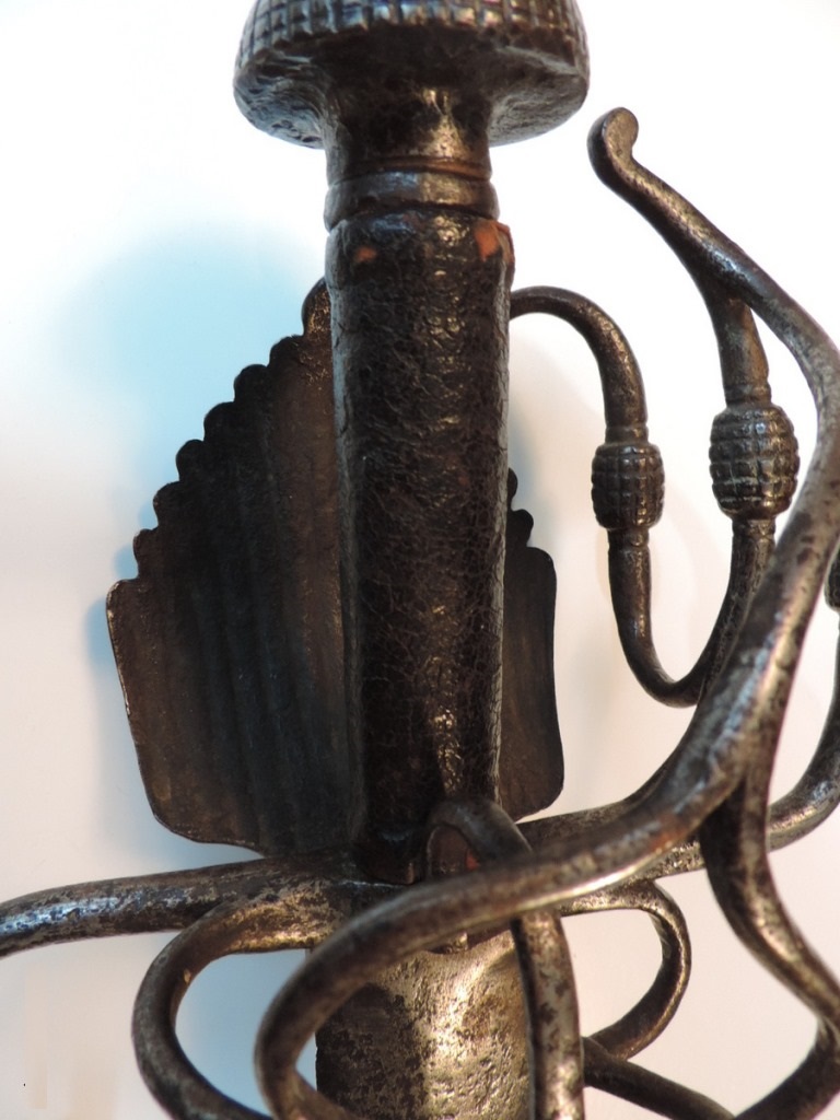

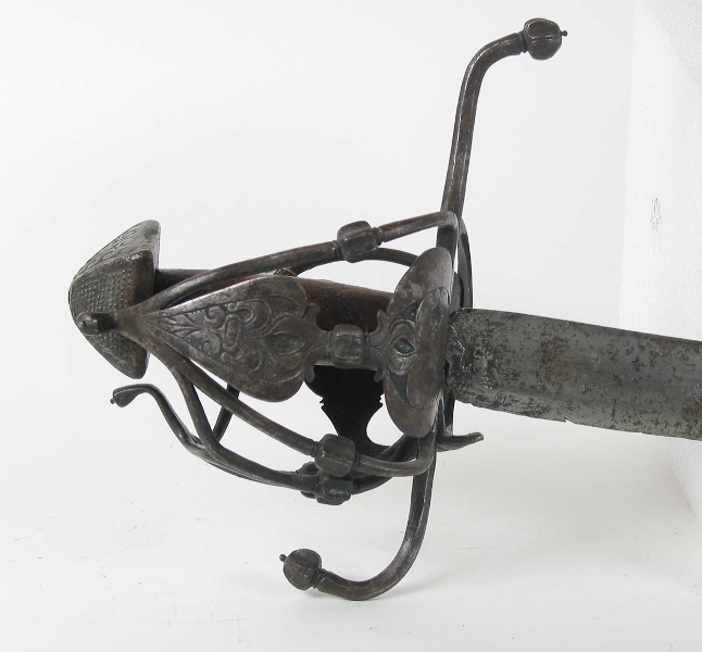

Default a similar hilt
a similar hilt

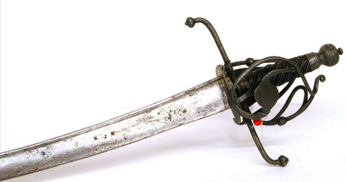

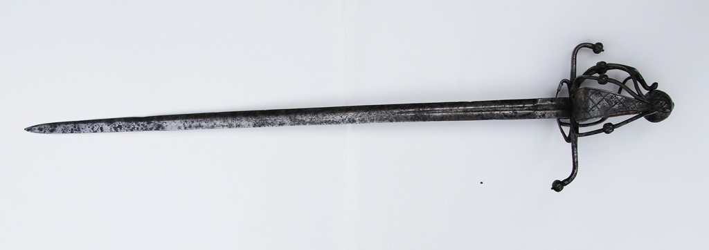

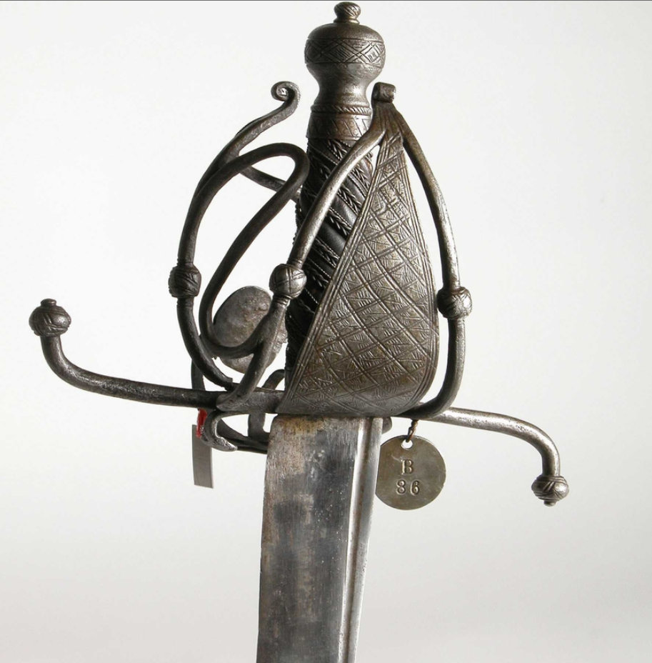

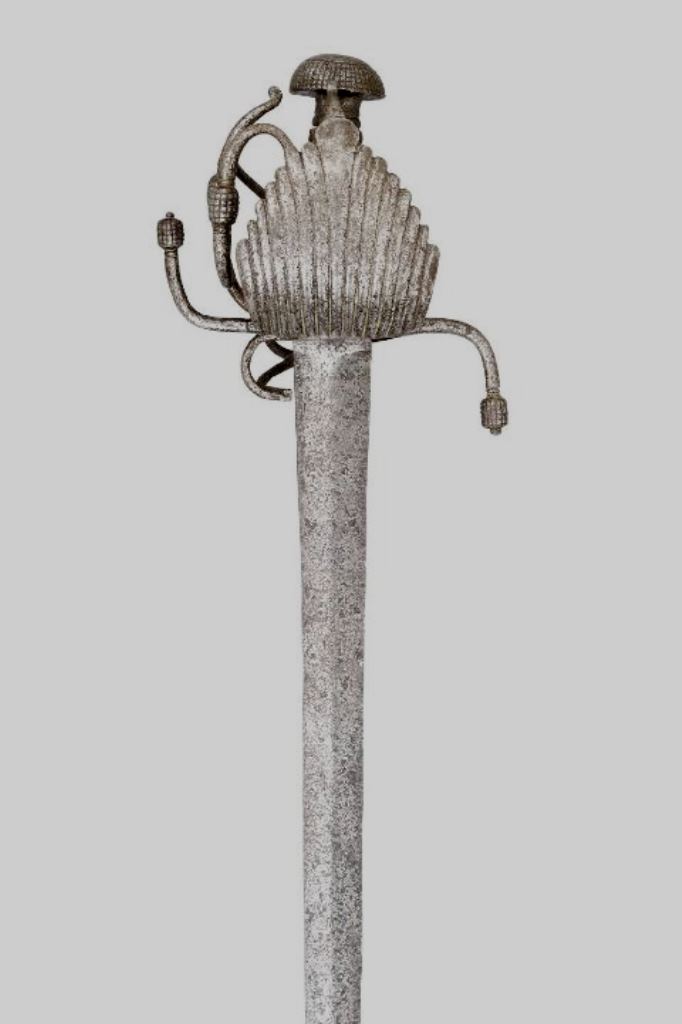

Two similar hilts below.
The story that created the name "Sinclair Sabre":
At the Battle at Kringen, Norway 16 August 1612 it is likely that both the 400 - 600 Scottish soldiers where armed with the same type of swords that the Norwegian Peasant militia where armed with. The so called "Sinclair sabre" = Dussack.
King Christian IV(1577 - 1648, same king that lost the battle at Lutter 1626) had sent the first shipment of Dussack's to Norway in 1598 among other arms to build up the Norwegian Pesant milita's capability in preparation for war against Sweden. The battle at Kringen was part of this war that came, the Kalmar war 1611 - 1613. Denmark won.
The Peasant Militia was most likely well armed with snaphaunce muskets, hunting spears, pikes, Norwegian battle axes and Tessaks / Dussack's that is the Norwegian name for Dussack.
The Scottish corps under the command of Alexander Ramsay accompanied by George Sinclair was lightly armed and had been given the promise of being properly armed when joining the Swedish army in Southern Sweden. In addition to being well armed, the Norwegian Peasant militia had the advantage of an ambush from the high ground forcing the Scott's to fight in a chokepoint with little space for maneuver and escape. The ambush was sprung with an avalanche of rocks, followed with wooleys of musket fire before a full on attack with Dussack's, axes and pikes. supported by musket fire. Thus almost all Scott's died in the battle. 12 was captured and brought to Akershus castle while a unknown number of prisoners where tortured and executed the evening after the battle. Alexander Ramsay was killed early in the battle and George Sinclair was shoot dead with his pregnant wife during the battle. Brutal times!

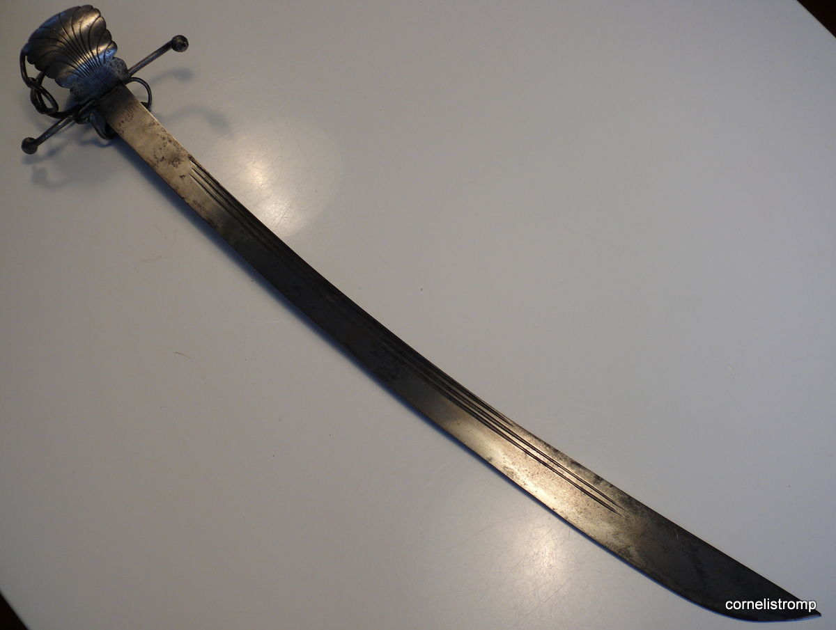

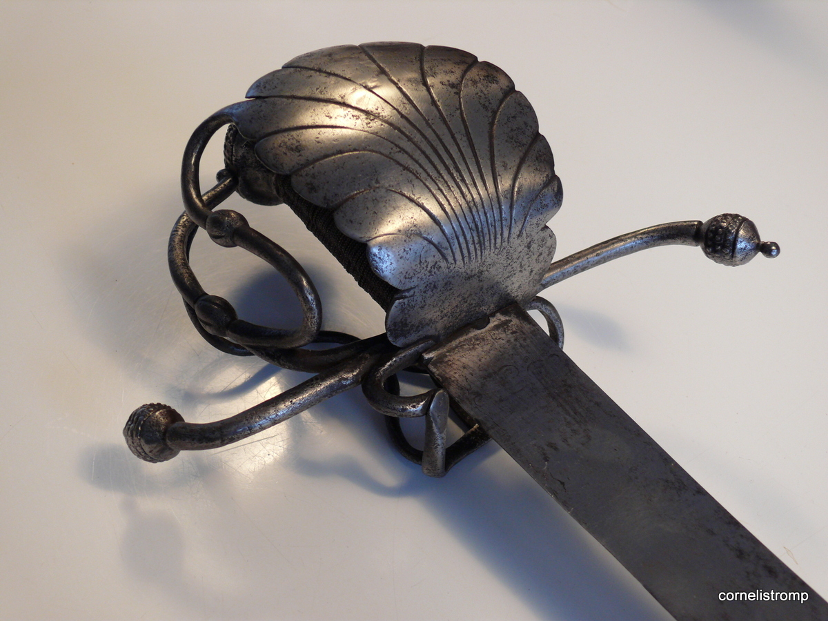

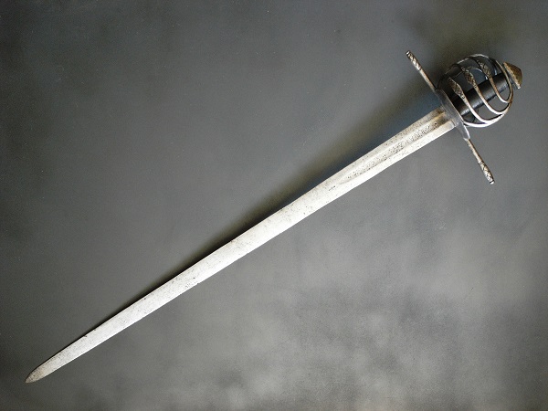

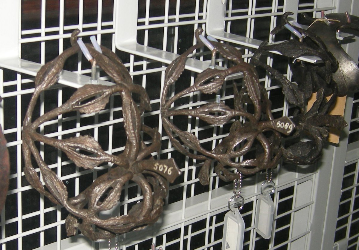

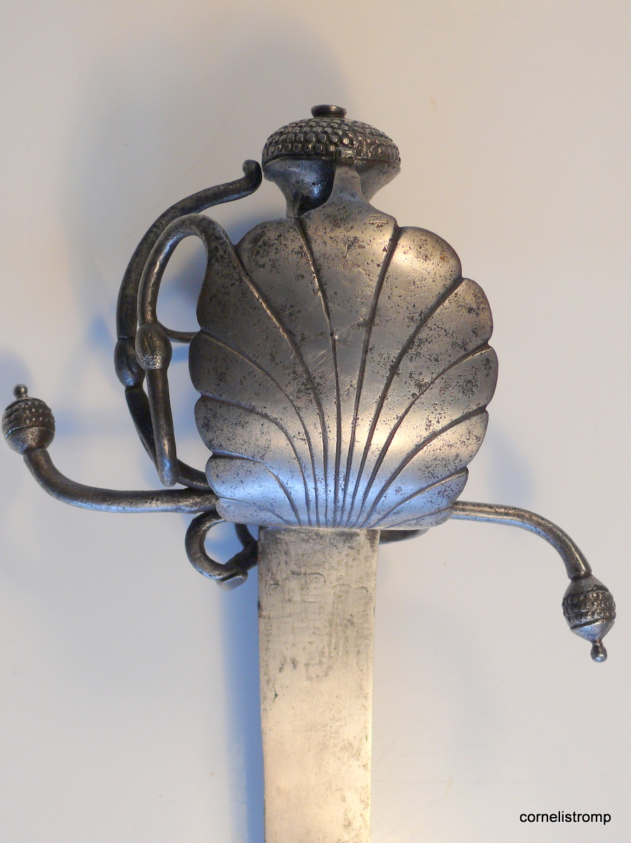

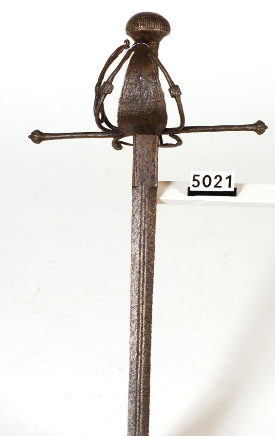

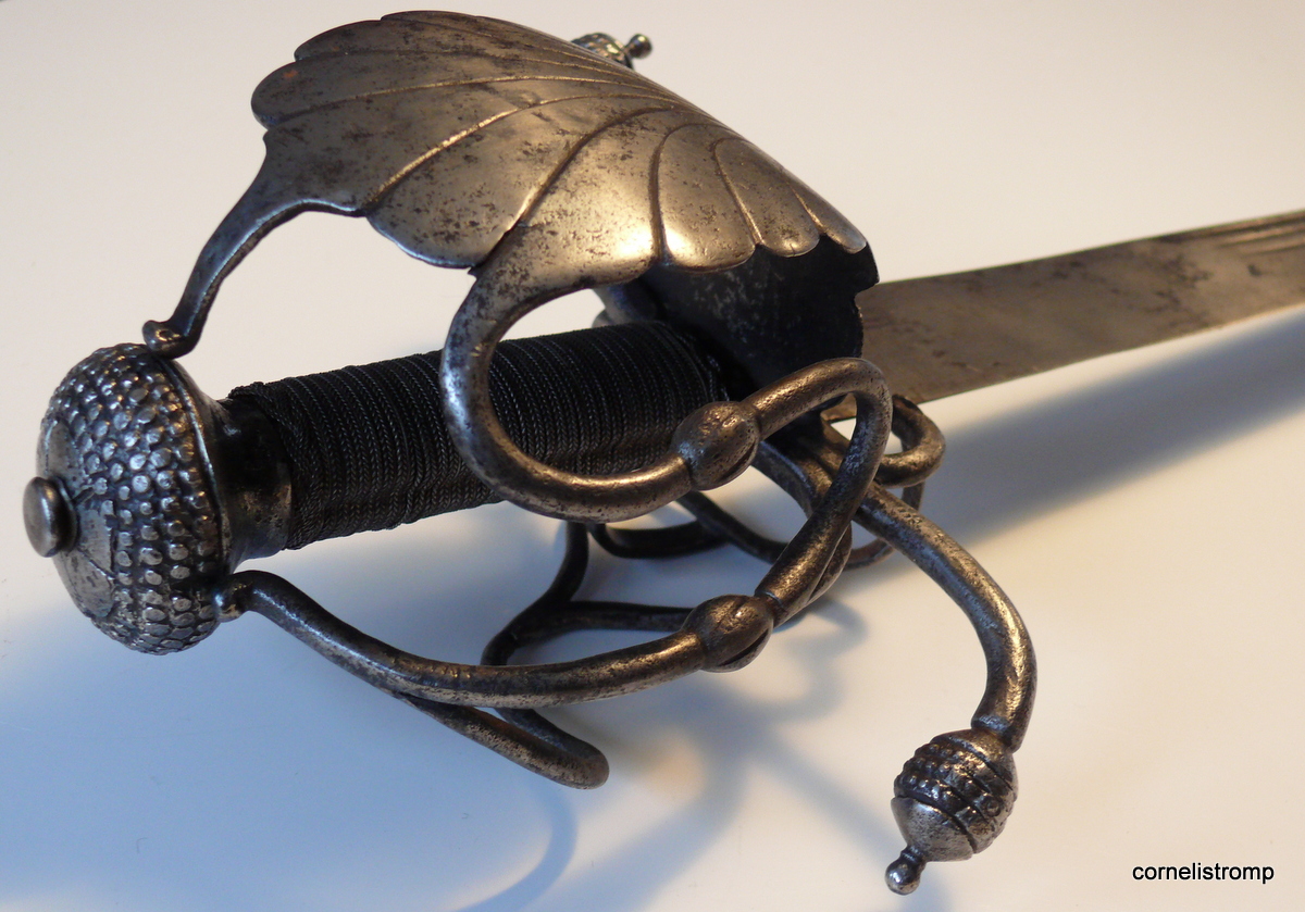

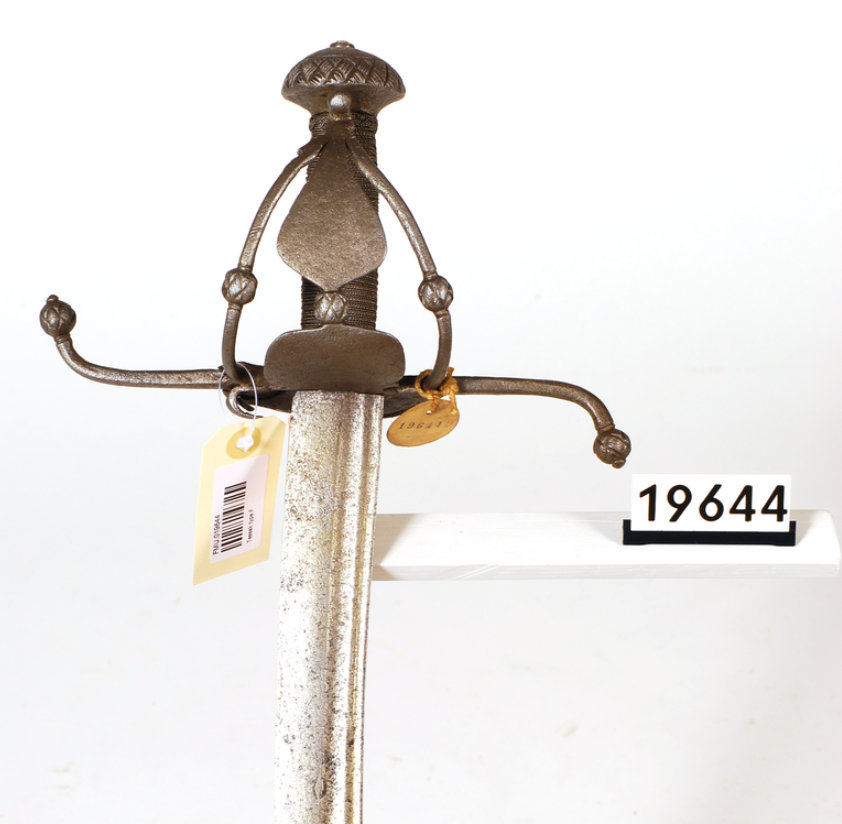

Hi Jean Luc,
globular pommels are fairly simple in form but are rarely found on swords and rapiers in the 16thC.
In the Low Countries (Netherlands) unless other countries globular pommels were common between 1575-1600. frequently depicted in Dutch art. on rapiers and around 1650 on smallswords
therefore your transition dussage-rapier fits much better in a Dutch collection than in a French one , Don't you agree

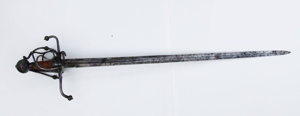

above dussage typeF is a nice example, herewith some more pics.
forsvaret museum Aalborg Denmark nr. FMU.001156/5021/19644

Originally Posted by cornelistromp
Hi Jean Luc,

Just a small correction Jasper. FMU stands for Forsvars Museet that is located at Akershus Fortress in Oslo. This are Norwegian Tessak's imported from Amsterdam and Hamburg between 1598 - approx 1611
Aalborg is in Denmark and I don't think they have a arms and Armour museum. Just so that we stay true to history. It always helps in keeping us honest in understanding this beautiful Pisces
Why do you think this swords has anything to do with Aalborg ? In fact this is the area of the former Denmark Norway where we have not found any Dussack's. Are you simply making things up ?
We can all visit the Norwegian National museum website and search for Tessak and a number of Dussack's will show up:
https://digitaltmuseum.no/search/?aq...3A%22tessak%22
Where you get Aalborg involved in this I simply do not know. When that is said I do have some very good collector friends in Aalborg.
Do you understand the typology you are referring too ? And what literature reference the web site from the Norwegian national museum is using?
This typology is limited to the commonly Tessak's found in Norway and does not cover all Types found in Europe. Also found here:
http://norskevaapen.no/wp-content/up...saktgrep21.jpg
The typology was made in a study by Per Terje Norheim and this is the main types found in Norway, imported from Hamburg and likely Amsterdam. Delivered in Bergen and Christiania(Now Oslo). Just like Petersen's typology from 1919 is based on Viking swords found in Norway only and later expended by Oakeshott typology that includes Viking swords and later swords from the whole of Europe, I am sure someone will switch on to Per Terje Norheims work and make a lot of money from expanding his typology. History has a tendency to repeat itself. This might be the type of work that would be right up your ally? = Someones else intellectual property translated and expanded in the English language.

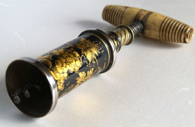

There is some details who need to be to be fixed…
1 )we must stay in the same year 1947 So the quality will be already checked so I will not be worried about the condition of the second bottle.
2) so first Bottle for the discussion ,the second for the swap, and the third I will need it in order to forget my beautiful sword!
3) Tell me which model of corkscrew I should bring to you for open the bottle (the folding model is Dutch)

About the dussage and variations of basket hilts Seitz mentioned the following in Blankwaffen p 325;
Towards the end of the 1600th c you find the same principle ( of basket hilt) in different forms and so also in a larger number of militarily types in the weapons bought by Christian IV in Germany for the arming of the country population of Norway. See attachement
Basket hilts bought by Christian IV in 1589 1604 and 1617 (schiavona).
on the origins of the war booty of Sinclairsabel Seitz mentioned following:
Sinclair sabel is a perhaps romanticized conception of the war booty which was taken from a Scottish troop under the command of captain George Sinclair.
(Jacobsen 1937/1939)
………… From a theoretical point of view the matter could be more complex with regard to the way the southern Germans weapon took to Norway.
That both the Scottish and the Norwegian peasants could be equipped with such weapons. There is nothing known about it.

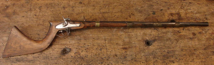

Awaiting your comment on it.
PS the afghan riffle we could put it in the fireplace.
best
Jean-Luc
1. is not possible , I have t0 check the market or can I change the year to 1989 or 1990 ?
2. you still have another nice one from a famous collection.
3a. the Dutch one..... of course.
3b. already done last weekend when it was cold here.
best,
jasper

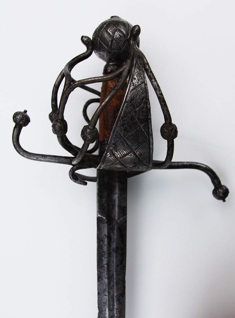

Here is one of my Tessak's with a Solingen blade that I bought from a Scottish dealer. We call this "A" type(Per Terje Norheims Typology) This hilt type is the most commonly found in Norway. We see this type with both straight and curved blades:

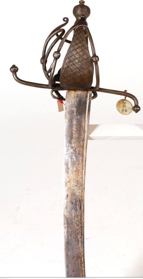

on nomenclatur weapons often kept their original name after being exported.
early basket hilts 1550-1580 in german language pferdemaulkorb-gefaess swedish Mulekorgs-fæste.
later dussage and variations thereof, probably derived from the( tjech?) word dusaken, an early form of steel alone.
schwedendegen the term refers to me to a later Type Felddegen around 1640, a kind of early Walloon type. see attcachement
the weapon count (Våpenting) you mentioned went over a long period of time over 150 years.
Are there early records known just after 1604 where these swords are described and was the term schwedendegen known before 1640 ?
I will later post some examples of basket hilts which I believe originated in the Netherlands
best,
Jasper
Old 28th November 2016, 10:49 AM   #28
cornelistromp
cornelistromp's Avatar
Join Date: Mar 2009
Posts: 1,071
for early possible Dutch basket hilt form see
http://www.vikingsword.com/vb/showth...ht=basket+hilt post #135
P. Norheim Type C.
there was a type C sword with a Dutch name in the blade in the Visser collection and several baskets only of this type have been found in the Netherlands, probably spare parts or perhaps this type was assembled in the Netherlands.
best,
Jasper

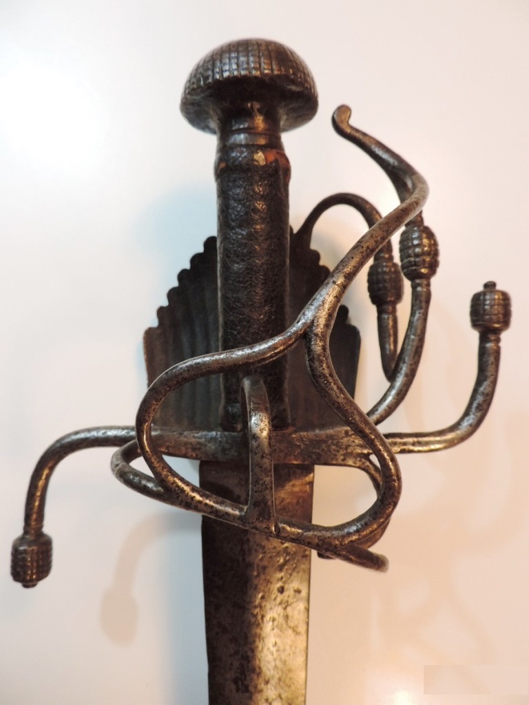

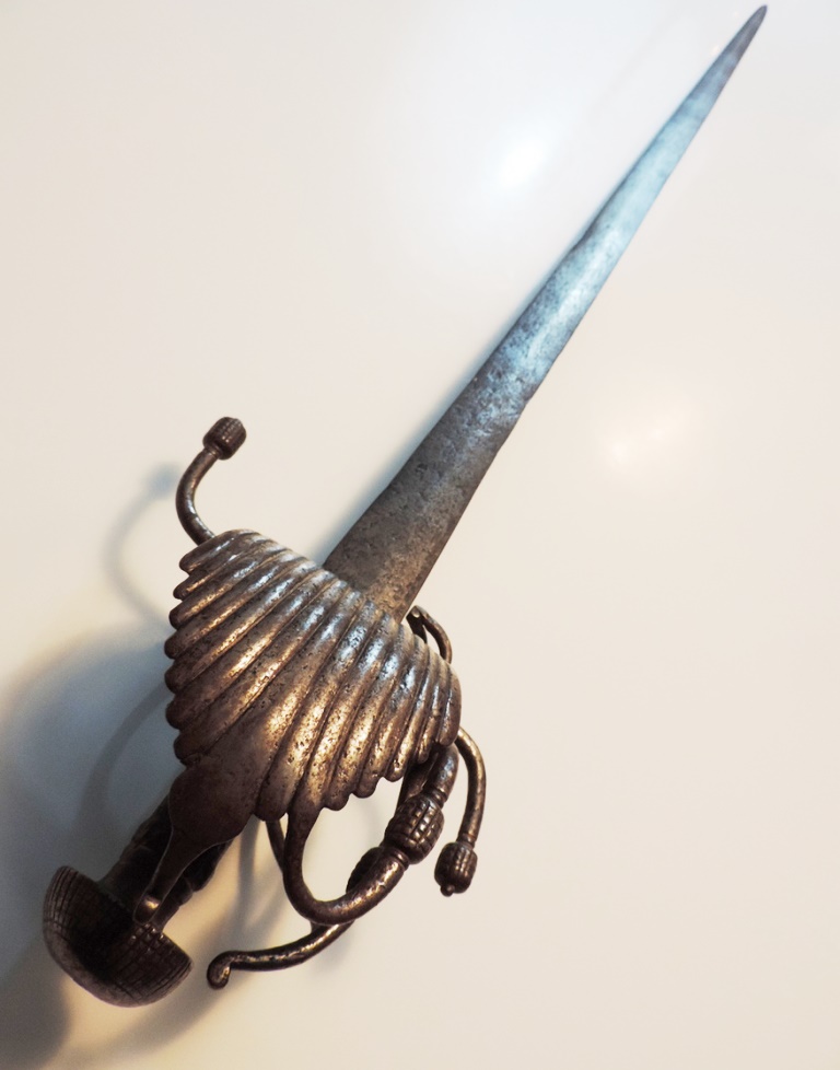

Old 29th November 2016, 08:38 AM   #29
cornelistromp
Join Date: Mar 2009
Posts: 1,071
the dussage of post 1 and below dussage 1570/80 are both of type F ( Norheim -Army museum's Yearbook 1971 ?), nevertheless there are significant differences in the hilt design.
the dussage of #1 has an open structure hilt design, such as the earliest examples, and small protective plate with two additional bars at each side of the plate.
later developed, these 2 bars and plate were probably replaced by a bigger shell plate, as below example. therefor the dussage of post #1 can be dated a little earlier.
a classification of its own for the type dussage of #1 instead of placing it as a subtype under F could be justified.
best,
