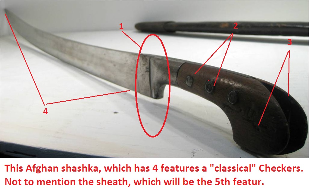

First we need to recall the definition of the word «shashka». E.G. Astvatsaturian offers this description: «A shashka is a kind of sabre…» it has a shorter blade and there is no guard. «A grip is the most original part of a shashka and makes it different from a sabre. A solid grip covers a tang; if the grip consists of two halves, these halves cover the tang from two sides and get sealed by rivets. A grip usually has an oval cross-section… A pommel is large, slightly elongated and rounded up. There is a wedge-shaped cutout on top of the pommel - forked head. The base of the grip is extended to the width of the blade… The grip has no cross guard for protection… The grip is crafted so as to be almost entirely enclosed by a scabbard» Stone believes that a shashka – «It is the national sword of the Circassians…», and further quotes Rockstuhl: «The shashka ordinarily has a straight blade, or one very slightly curved towards the point, and the hilts without any guard whatsoever… When the arms is sheathed the hilt enters the wooden scabbard covered with leather, if desired, as far as the pommel. The latter is divided into two straight wings like a Trapizond yatagan. ...to many of the swords have fine old blades from Persia...» K. Rivkin gives the following description of a shashka: «A shashka is a light, relatively short (60-90 cm) slashing weapon of a very simple structure. … There’s no guard on a shashka, … A grip is made of a horn, expensive grips are made of walrus tusks … there are splitting forked head on the end… A shashka was usually worn on a shoulder or waist baldrick with an edge up. Such way of wearing a weapon was known a long time before shashkas appeared… in the Ottoman Empire. … A grip of the Caucasian shashka is almost fully enclosed by a scabbard».
All these authors say about the Caucasian shashka, as other shashkas they were not familiar ((K. Rivkin wrote in the book is about the Caucasian weapon).
Under the above-mentioned definition of checkers match:
1) Caucasian shashka
2) Afghan shashka
3) Bukhara shashka (and I think more correct to say - Central Asian shashka)
4) Russian shashka (Cossack)

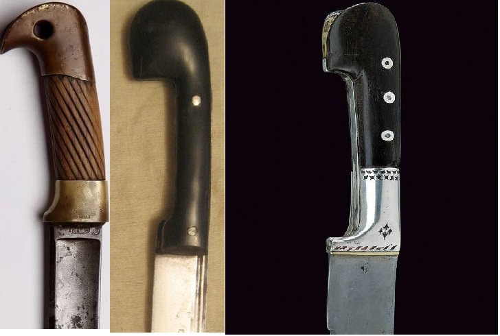

I think no one doubts that the "Bukhara" shashka developed independently, regardless of the Caucasus.
Russian (Cossack) shashka is derived from the Caucasian shashkas (or vice versa). There are serious studies (they have not yet completed) and we do not know who came before. But it is not important. It is important that they have their own identity (in the decor, for example)
Afghan shashka is not a copy of the Russian shashkas. If someone borrows something - then items will be very similar. For example, the installation of the handle of the Caucasian and Russian shashkas - the same. Afghan shashka - individual. So we can not say that it copies a Russian shashka.

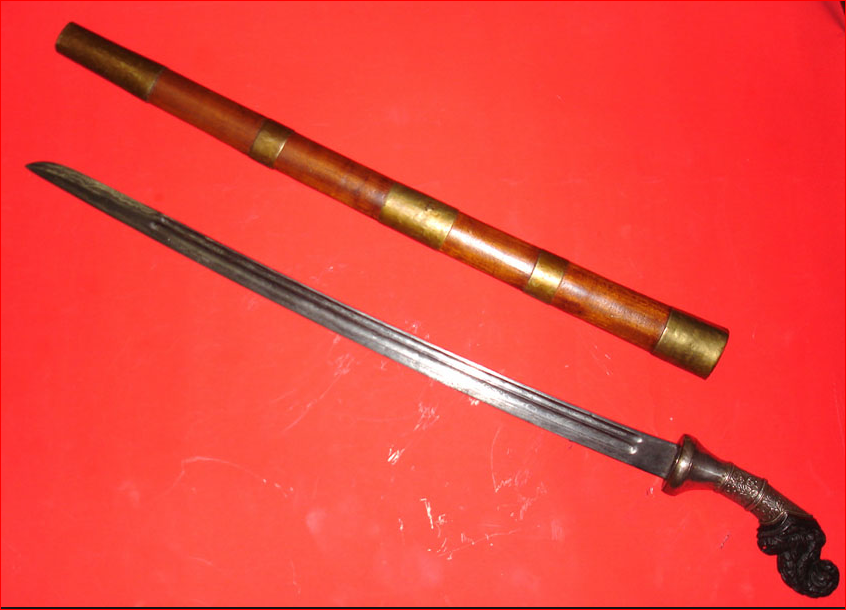

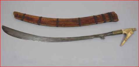

Gentlemen,
Enjoy shashkas from the Indonesian archipelago:

If those are Shashkas, then my Japanese Katana is also a shashka!
mariusgmioc is offline

That is what happens when a definition is taken out of context: the cardinal word missing in the above comment is "Caucasian". All the rest of guardless sabers from all over the world are not Shashkas by definition.
Just like there is only one true Katana: the Japanese one. We all know Indonesian and Filippine WW2 imitations, but would not dare call them true katanas: pseudo-katanas at the most.
Rivkin, Astvatsaturyan and Stone were very well familiar with other guardless sabers. They just thought about the topic bit more carefully:-)

Visual comparison:

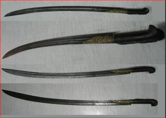

Well, here is a "Turkish shashka", down to a forked pommel and up-curving blade.
ariel is offline

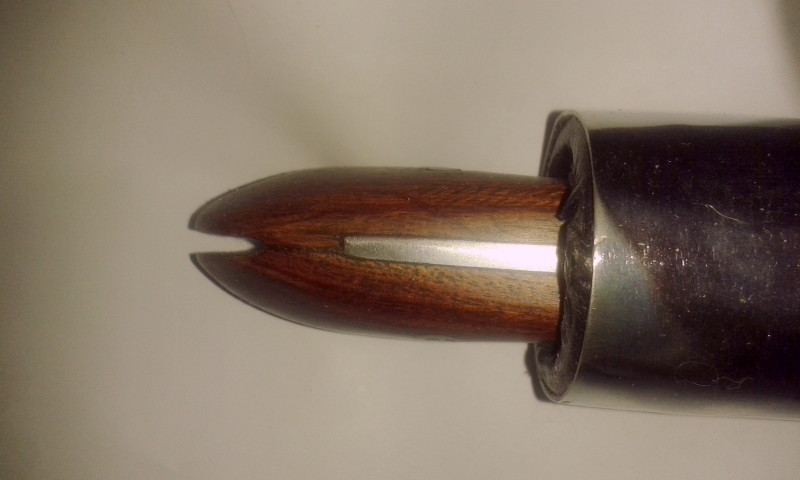

ariel, your submissions do NOT have the "wedge-shaped cutout on top of the pommel - forked head"*. turkish ones propbably count as turkey once ruled over parts of the caucasian areas.
*-as in my pommel:
Perfectly. If you show online now 10 such "Turkish shashkas" - it will be possible to discuss it. And so - this is an isolated object, which is called - "chimera".
Just get the catalogue of Zagreb collection by Dora Boskovic: multiple examples with straight and up-curved blades.
Anything that does not agree with the thesis of shashka being an " international weapon" is now an exception and a chimera...
This discussion becomes an uncomfortable mix of hilarious and embarrassing....

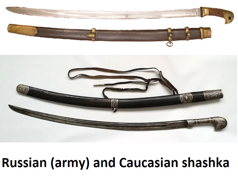

You inconsiderate. In the description of shashkas said that the shashka - a kind of saber.
Now compare Russian (army), Caucasus and Afghan shashkas.
Someone sees a copy?

As seen with the Turkish sabre with yataghan hilt, the blade is clearly a sabre, not recurved or deep bellied as with the true yataghan blade form.
The hilt does not have the same cleft character, it is more eared. But we see the point made.
