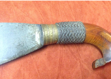

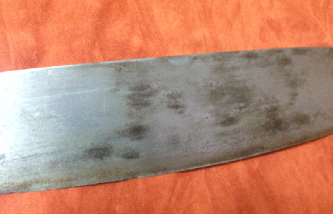

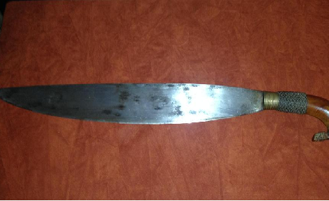

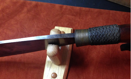

Default barong pics
Hello.
I'm back with pics. Finally figured out how to compress photos using MS Paint.
Most info that I read about rust removal or blade restoration was on laminated Philippine blades. Didn't know if etching also applies to mono steal.
I'm attaching my barong pics that I would like to clean the blade. It started to get dark spots and small pits. I would hate to ruin it by improperly cleaning the blade. I would like to get rid of the dark spots and don't know if etching it would ruin the blade or change to different color. I will use warm vinegar if I will etch it.
I never etched a blade before, I only apply oil to preserve it. Most of my info in blade restoration I got here and I think this barong is mono steel. One question is, When did the filipinos start using leafsprings? WW2 era or before that like in Span-Am War. Thanks again everyone. Oldschldude

Hello Oldschldude,
the blade from the Luzon sword in up I've cleaned with sandpaper only, by such a rusted blade you can start with 80 and can end with 1000 to get a nice smooth finish but know people which go higher.
Your barong blade don't seems to have bad rust so I would start with 120 or 160 paper. I bet that your blade will show lamination, look close to the spine if you can see lamination lines.
I wouldn't clean such a blade with any sort of acid like pineapple juice, the blade will get a grey/dull surface and it will need a lot of polishing to get it away again. The sandpaper you can use dry or with oil. Before you start to etch a blade clean it with aceton to remove all oil and grease.
