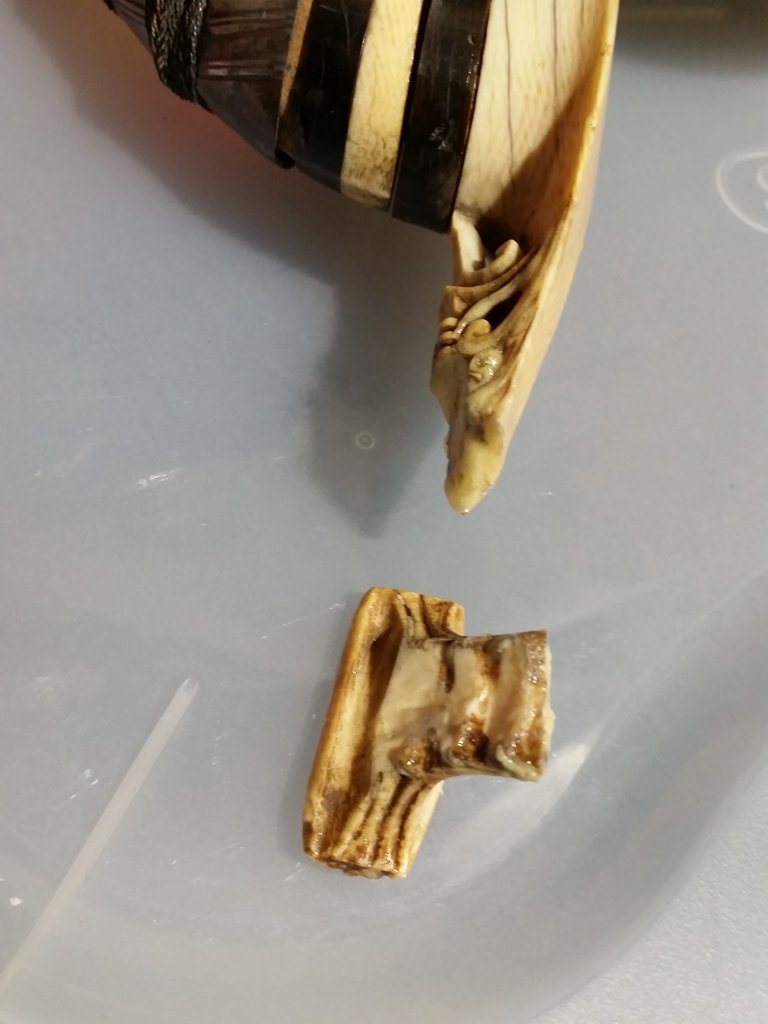

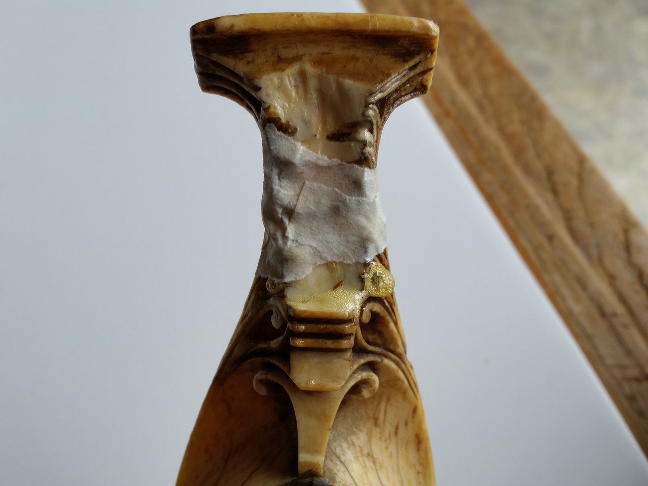

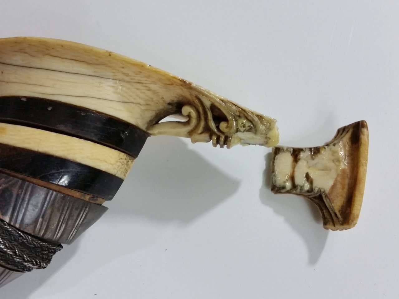

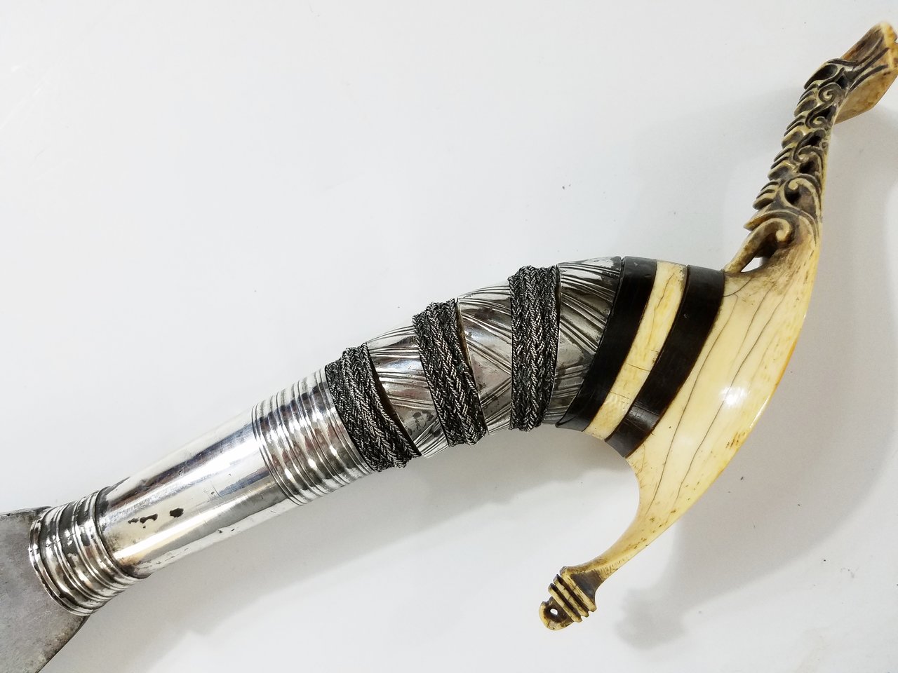

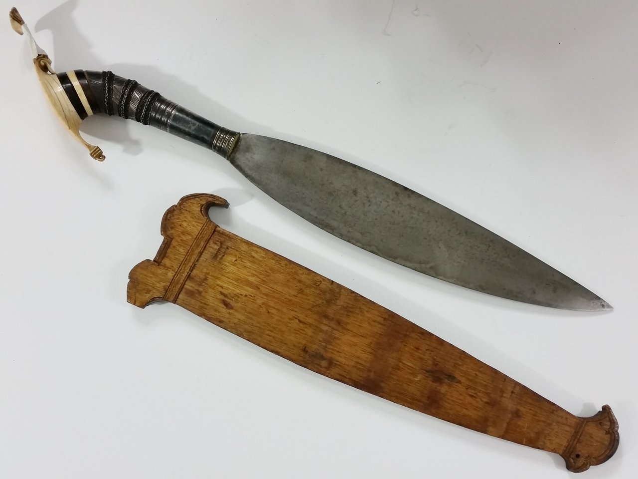

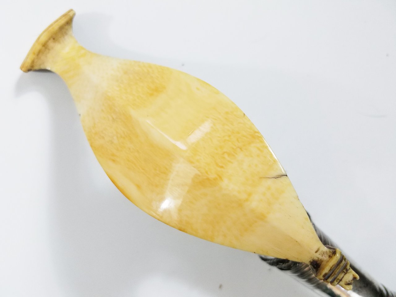

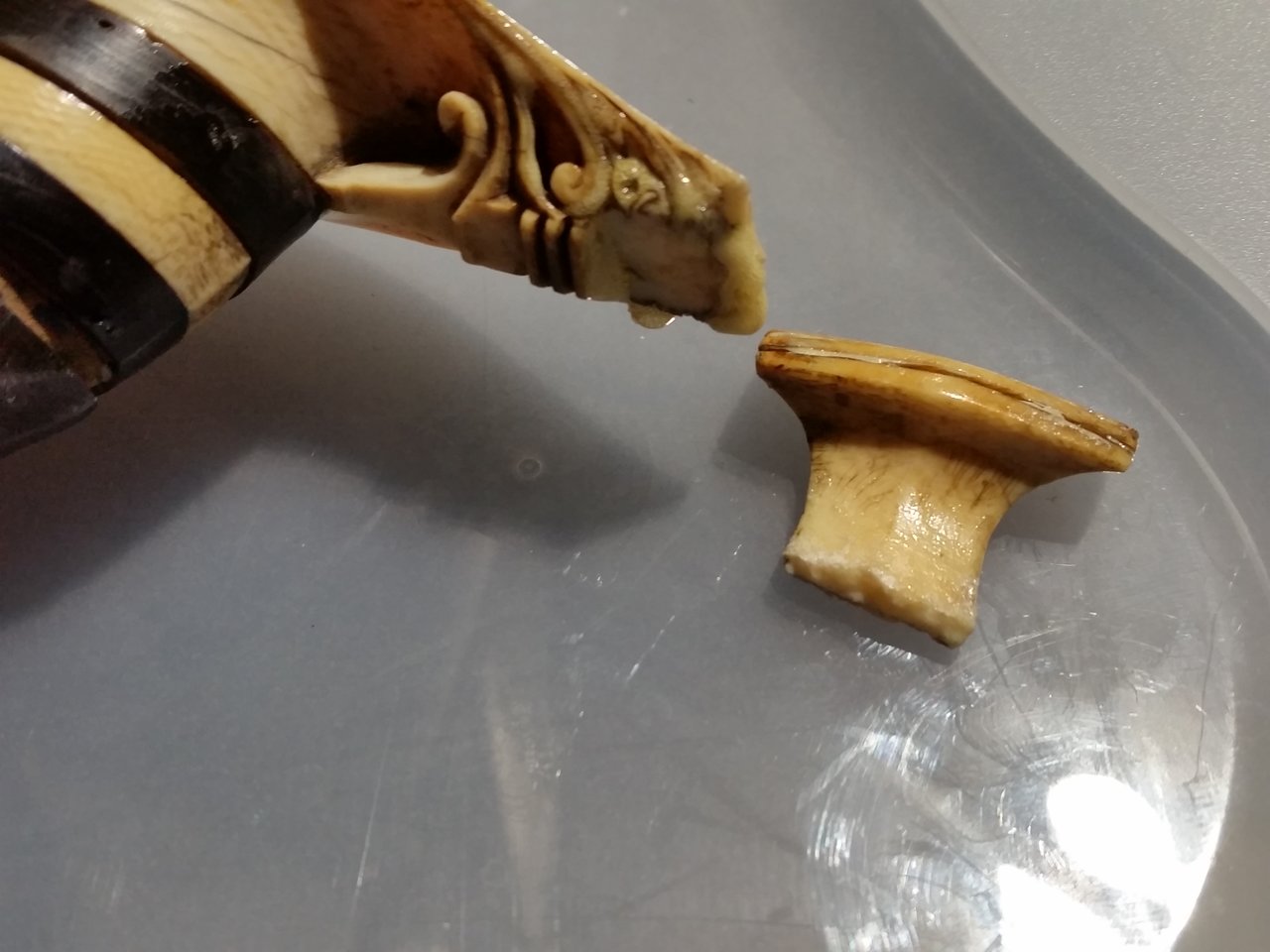

for years, i've been looking for a barung similar to this. not only are they hard to find, but when they do pop up, it's normally four figures...
well, my search is over. picked one up in Baltimore among European sabers. since it wasn't in the best condition, mr. seller decided to sell it for a song. whoever tried to fix it decided to use gorilla glue, and for some reason, decided to shave the ukkil at the bottom. fortunately whoever did it decided to leave a small part of the ukkil design intact.

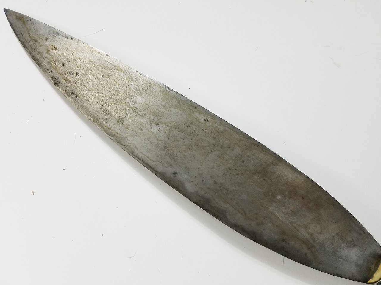

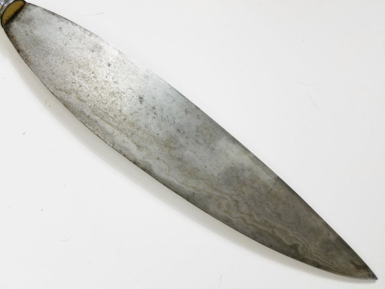

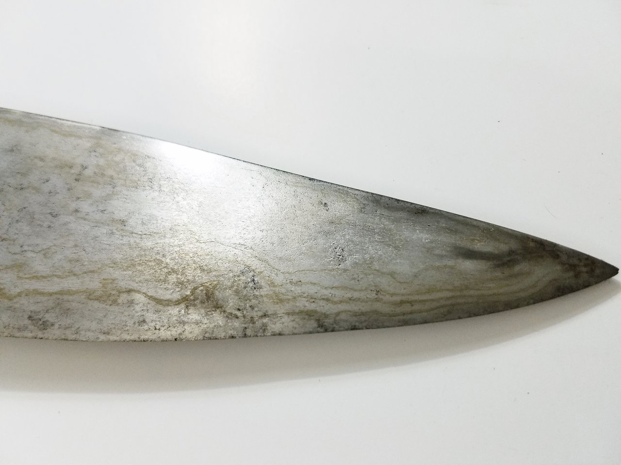

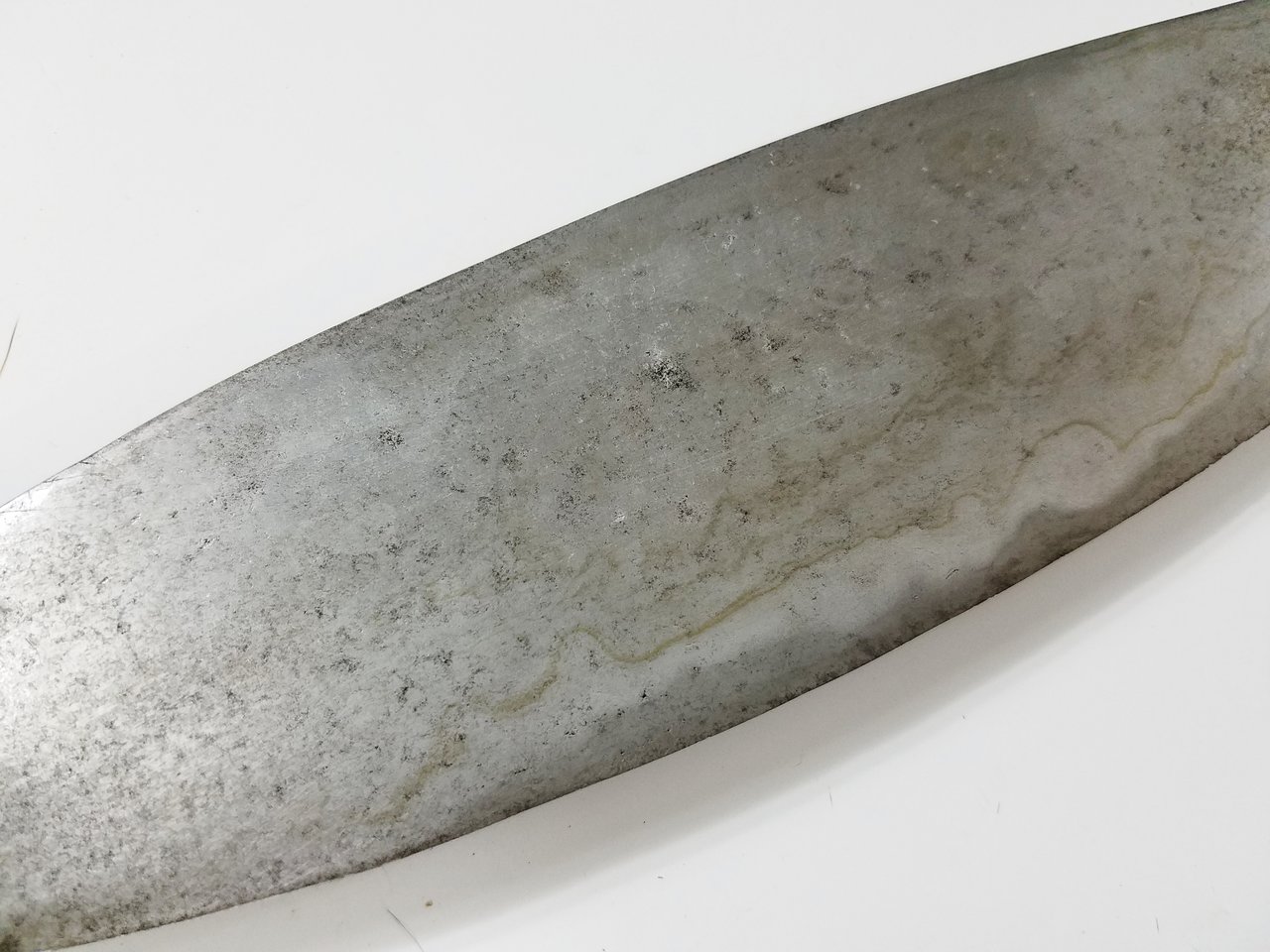

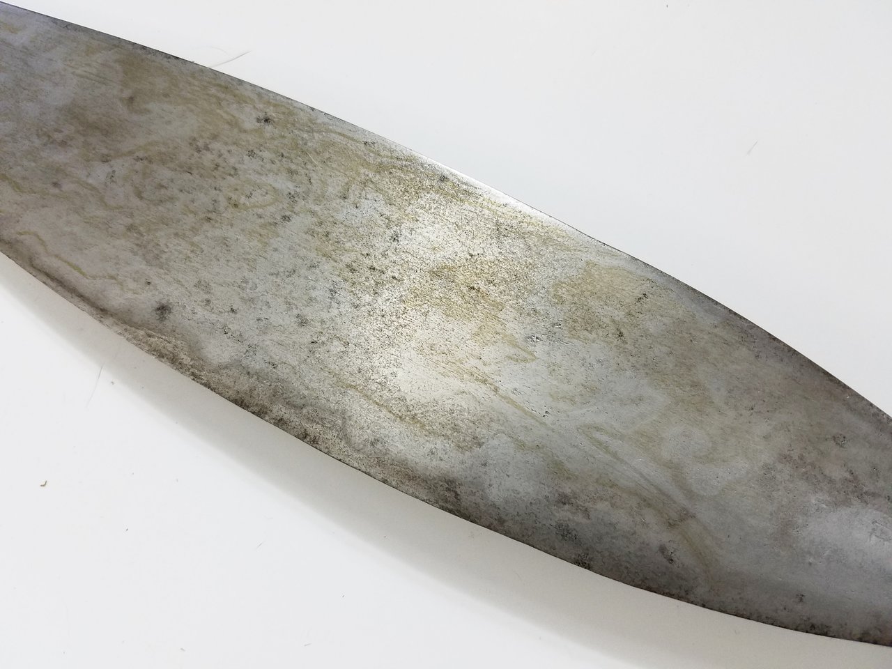

so first order of the day was to etch it....
blade is high quality, most likely chinese made. it has a real faint chopmark on side.
pleasantly surprised to see patterns pop out. what got me is the somewhat similar to a katana's hamon.

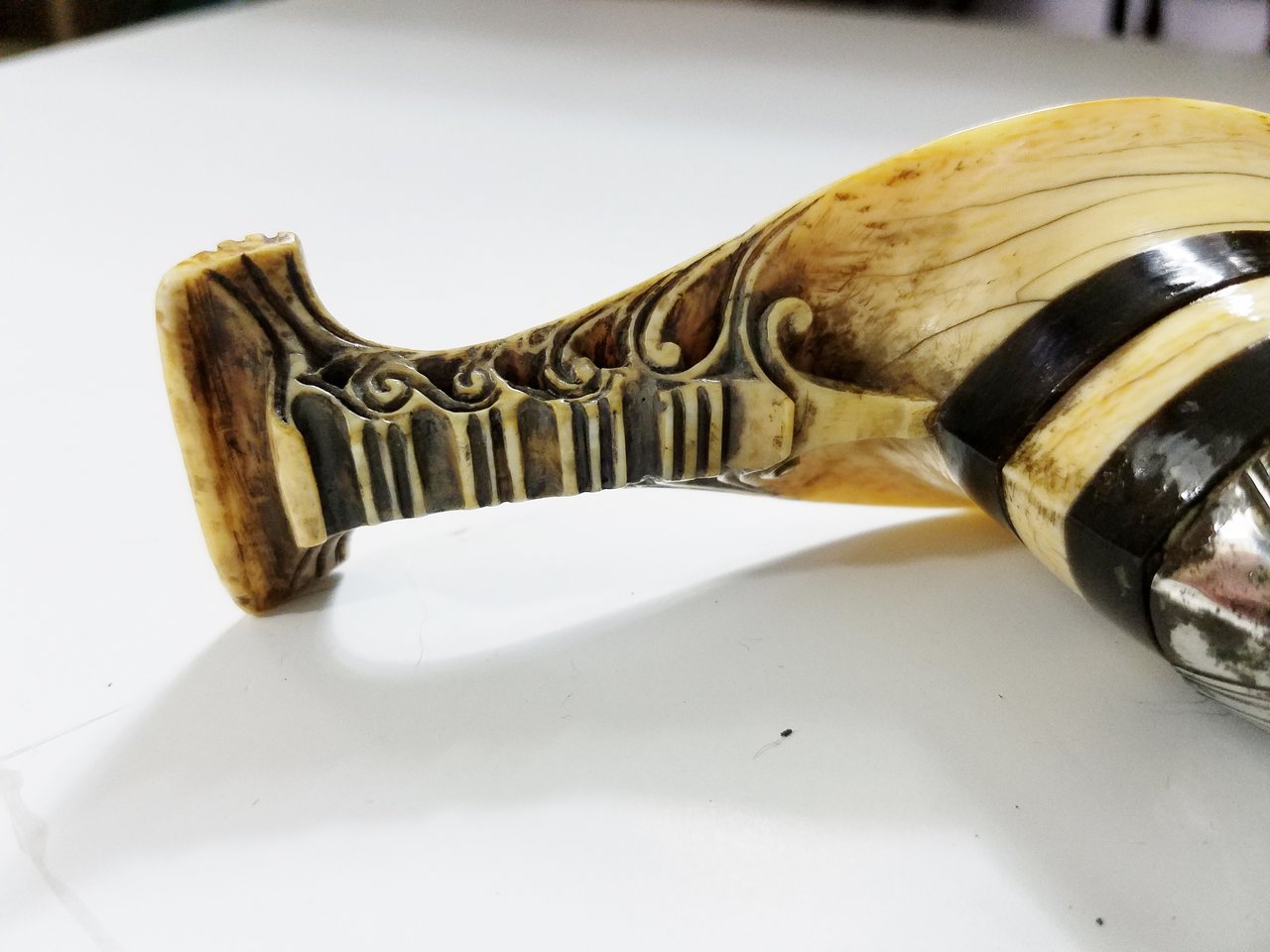

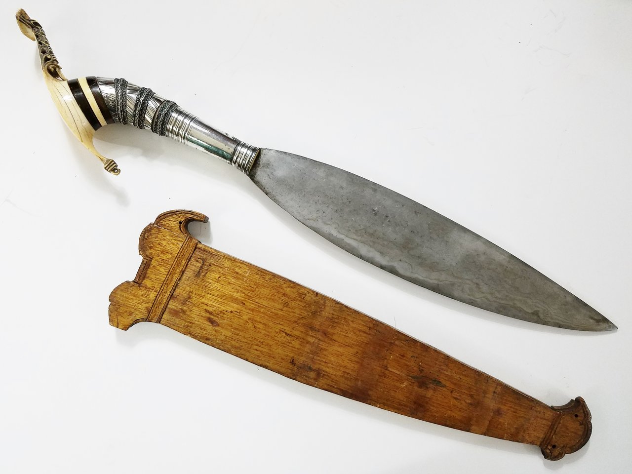

so finally it's back to it's former glory. ivory fixed, blade etched and metal shined. even found an extra scabbard that fit. it's just a matter re-wrapping it with rattan binds. as a plus, i found out using Weiman Silver Polish on ivory brings out the luster...

Very nice Ron, congrats.
Nice restoration as well...

thanks. normally, i'm not a big proponent of making up an ukkil just to make it complete. luckily, a set was left off close to the pommel and it's just a matter of repeating the pattern.

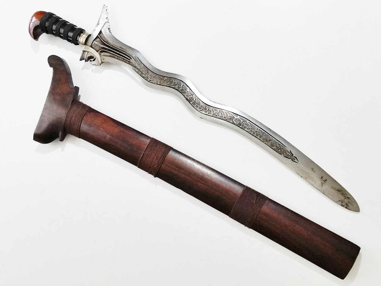

iskender, not necessarily. in the jungle, it's counter-intuitive to have a shiny blade. on some of the blades, they even have patterns, much like an indonesian keris. i'm posting one as an example. as far as barungs, kris and such, they weren't washed like the keris, although back in the old day, i was told that coconut oil was used to these blades. over time it etches the blade, bringing out the pattern. nowadays the most common acid that's used to bring out the pattern is your household vinegar...

thanks , it gives sense , that cleaning a patternwelded blade in coconutsapp will show the pattern over time . as for the aspect living in the jungle these people had a very highstanding culture with agriculture,fishing gold and ironwork, trade , the larger fightingknives and swords ,parang, piras.ect. where manly for war and robbery in large groups or families in a clanwar.It was surly also a big showoff item when these guys went to drink and gamble in the lokal hangoutplaces. i think , there was no intention of the moros to darken a blade for camouflage in the night.for so far a nice barong is always a enjoyment to the eye. thanks for showing your outstanding repair on a interesting nice piece ,complements for your skill iskender

What did you use to etch the blade? I am guessing you did not use a resist?

Harry, i used my wife's vinegar, lol. micro it for a minute, then add a couple drops of dishwashing soap. no harsh chemicals were used.

What a fine score and addition to your collection Ron, especially after the wonderful restoration work. You did a great job of carving and replacing the missing ukkil as well as bringing out the pattern in the blade.

CONGRATULATIONS ON A GREAT FIND AND KUDOS FOR DOING SUCH A GREAT RESTORATION FEW COULD HAVE DONE SUCH A GREAT JOB. I WAS WONDERING IF THERE ARE TWO SEPARATE PIECES OF IVORY AND TWO PIECES OF HORN OR IF THE HORN WAS APPLIED AS STRIPS IN GROOVES IN THE IVORY.? ITS UNUSUAL IN EITHER CASE. NOW YOU GUYS WITH IVORY HANDLED MORO WEAPONS CAN WEAR THEM AT LOUISVILLE SHOW AND PLAY DATU PERHAPS I WILL JOIN YOU ONE OF THESE DAYS AS I HAVE A IVORY HANDLED KRIS.

like all others have said already, very nice barong and great restoration at the ivory pommel. Would you willing to tell us how it was done? Which glue, reclacement piece ivory also, details of the new done carving and so on.
I personally would have polished the blade a little bit more but that is a matter of opinion. Great luck to find a matching scabbard. Congrats for this nice find and great job!
