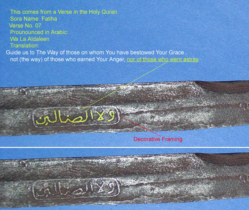

This would be a Lombok pedang no? Are the marks on the blade etched or inlay?

I am not sure if they are etched or inlay.They look as if they are on top of the blade as inlay maybe.

The marks almost look as though they were welded onto the finished blade.
I wonder if this blade may have started life as a sword cane.

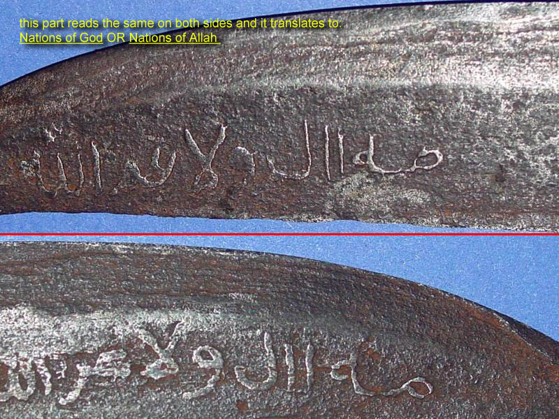

The last closeup picture suggests to me that the inscription is etched into the blade, or more accurately, the background is etched away from the inscription.

some translations that might help to id..
bj211 is offline   Reply With Quote

Arrow

Sorry Rick I will try to scale them down some. Thank you all for the information. Thank you Bj211 for the translation, It is very kind of you to translate in such an easy to understand way.

That looks like acid-resist etching. The design (text) is drawn out in wax or some other acid-resistant material, and the remainder of the blade is washed or immersed in acid.

This is a shot in the dark; but, the blade on this one looks as though it may have once been part of a Norwegian bayonet. The blade on the model 1894 would have been around 367mm long, 19.5mm wide, and 5mm thick. It is hard to see due to the extensive acid damage, but there seems to be a machine made fuller running along the top of the blade which starts an inch in front of the guard and ends just before the hook (clip point). Originally the blade had a spear point with a sharpened spine. This one seems to have lost a short section of point, which was corrected by rounding the clip point all the way down to the main edge.

If you look close at the details of the blade it seems to be layered metal.It is hard to see because of the "acid damage" and in the pics but up close in person I can see layering.
If I dipped a regular blade or bayonette into acid would it reveal layering?
Thanks again
Thanks again
Most likely not IMO .

My guess on this Pedang is also Sumatra.
The reason for this is that I have seen several Sumatran weapons with etched Arabic writing made in the same way as this - mostly Rencong and Sewar.
And so far none on the resembling Pedang from Lombok
Most of these etchings seems to have been done in the mid- and late 20th C.
Maybe the etching was done later on this Pedang to make it more according to the fashion of the day?
