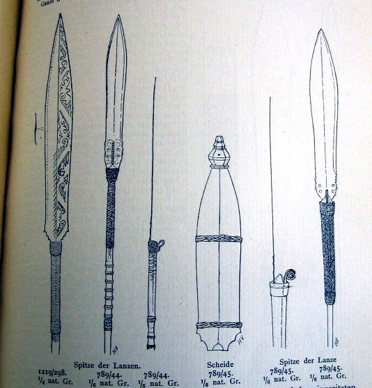

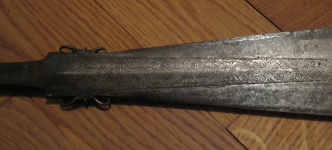

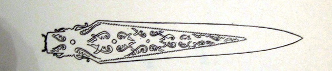

Just wanted to share my excitement with those of you who also are interested in Borneo spears.
Since I saw the reference picture in Bodrogi's Art of Indonesia below I have been looking for a Dayak spear with aso-motives on the blade.
Collectors of 50+ years on Borneo weapons told me that there is no such thing and Bodrogi must have made the drawing based on his imagination.
Then I noticed in the Juynboll Leiden catalogues (see below) that one of the spears had aso motives and this month I managed to find one myself.
Enjoy!

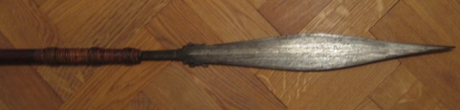

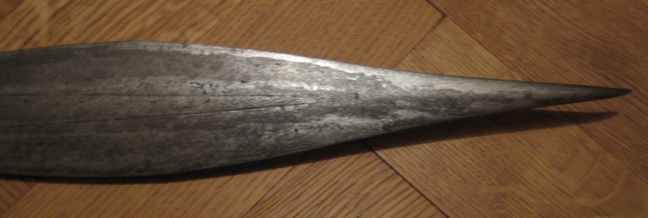

Vandoo,
The spear is 232 cm with its hardwood shaft and the spearpoint, without tang, is 40 cm.
So it has the lenght, size and traditional rattan sidemount as you described.
The spearpoint was loose when I recieved it and I don't dare to push in the tang all the way in case it would destroy the old rattan bindings.
