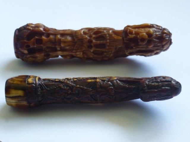

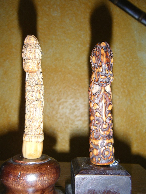

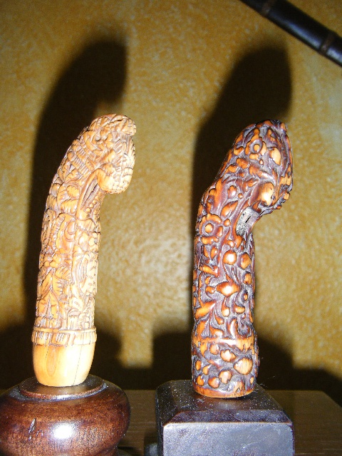

I recently bought a Kojuk Mrenges keris hilt, made in Madura Island and believed to be very old elephant ivory. I am very curious about his size. As far as I understand, there are basically 2 types of these Kojuk Mrenges keris hilts : one being much slimmer than the other. But the present one is even slimmer than the slim model.
Please have a look on the pictures figuring a "normal slim" model of Kojuk Mrenges and an other "much slimmer".
The measures of the 2 pieces are :
The "normal slim" one :
length 9.5 cm,
thickness of the piece without considering the base : 2.1 cm
measures of the base : 2.4x2.4 cm
The "much slimmer" one :
length 8.9 cm,
thickness of the piece without considering the base : 1.4 cm
measures of the base : 2.0x1.7 cm
So, as can be seen, there is a quite important difference on the thickness of the 2 pieces, 2.1 cm against 1.4 cm.
Would it be possible that this keris hilt was made for a woman or for a child ?
Otherwise, would it have an other explanation ?
Thanks in advance in helping me to learn from the experts ...

My immediate thought was that the carver was working with the amount of material that was available to them at the time. I am not sure that a hilt would necessarily need to be even slimmer than the already slim version you show to accommodate a small hand.

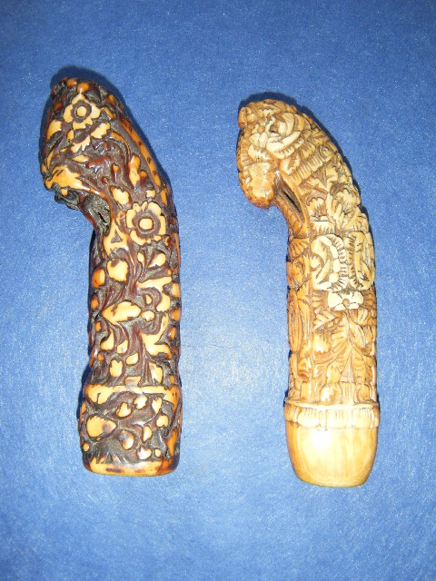

Here is my own "slim" version of this style of hilt.

As it seems, and I think it is absolutely correct, that the usual slim Kojuk Mrenges hilt will fit perfectly for small hands.
So, could this smaller model have been made for a very young child, not old enough to use it but as part of a ceremonial or festivities dress ?

This slim hilt has a normal lenght for a Madurese piece (about 9 cm) and a practical explanation for its small diameter could be that it was made from taring duyung (dugong tusk) which has a quite small size as compared to other local sources of ivory (elephant tusk and spermwhale tooth).

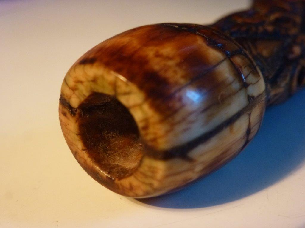

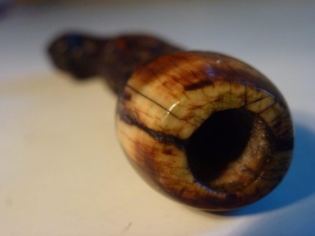

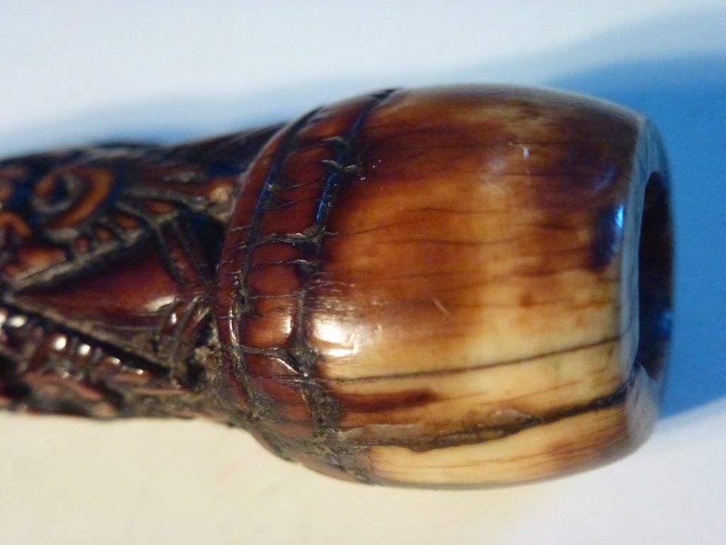

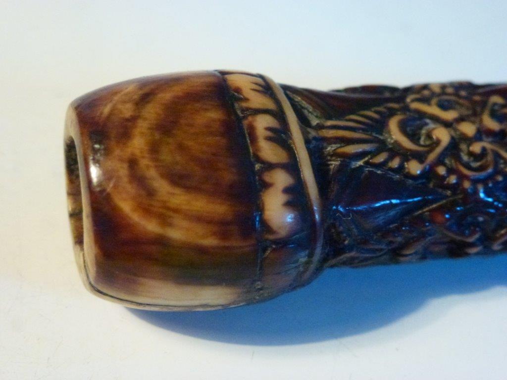

I am sending other 4 pictures that might help for identification of the material, marine ivory (dugong tusk or whale tusk or other marine animal..) or elephant ivory).
I could not see Schreger lines on the pieces but it may happen because the piece is old and has a very dark patina.
Other 4 pictures are being sent.
Thanks again.

4 more pictures for your appreciation.
If you need more precise pictures, please just ask me and I'll send them.

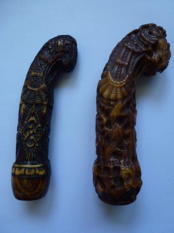

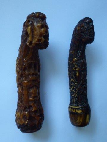

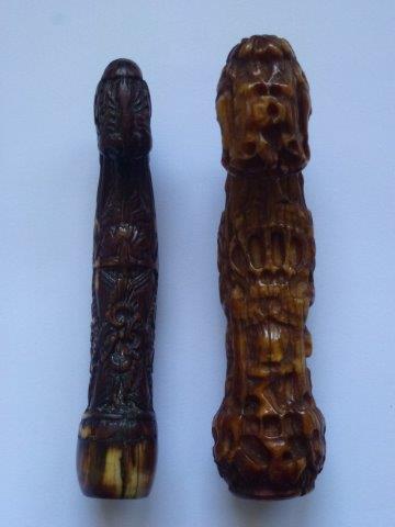

Hello Patrick,
like promised, here my slim example side by side with a "normal" sized example.
