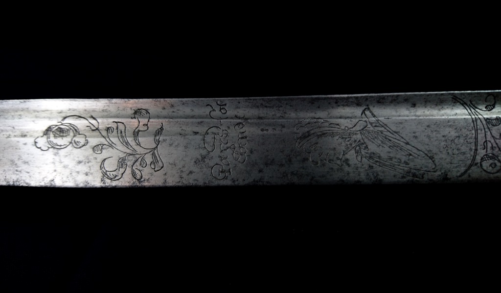

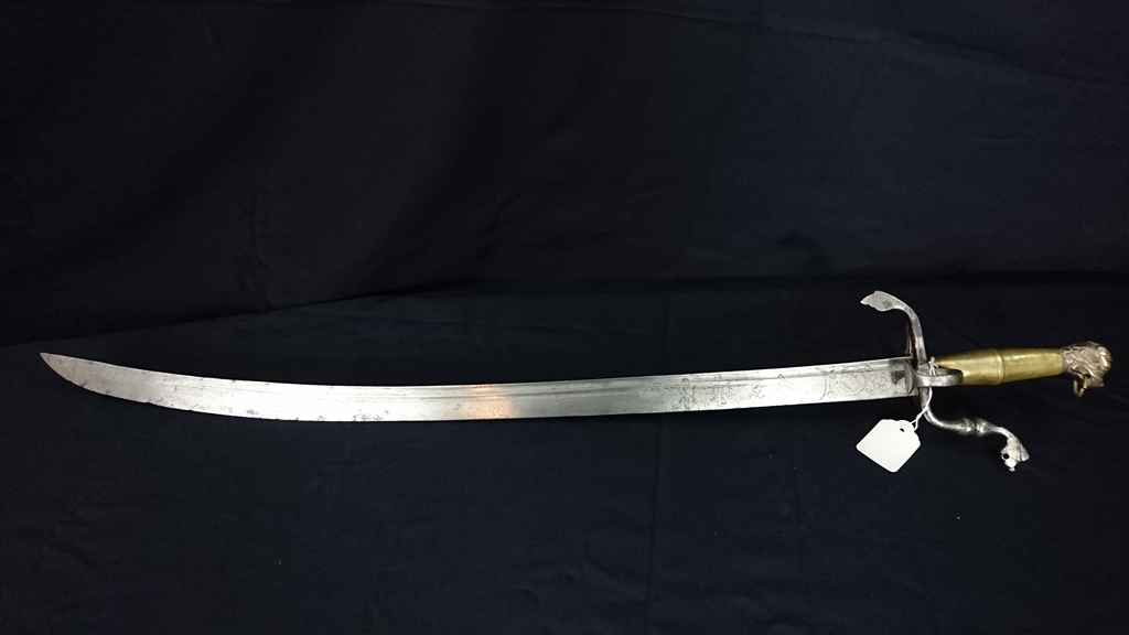

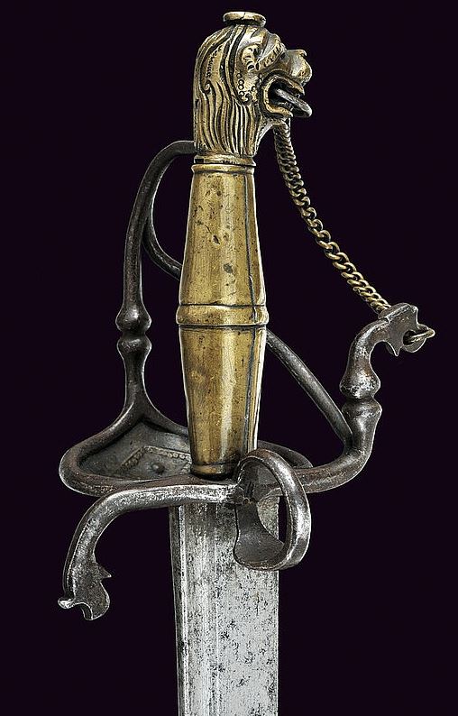

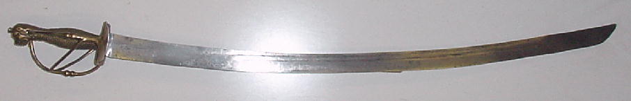

Default 17th Century Sabre with lion head pommel for comment.
Sold as a German sabre but I have also found a similar exemplar sold by Czernys as swiss.
Any comment on it will be welcome
Best
CERJAK

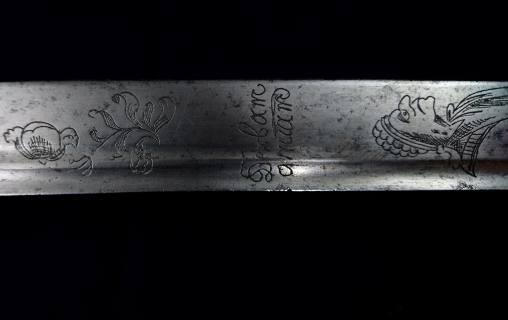

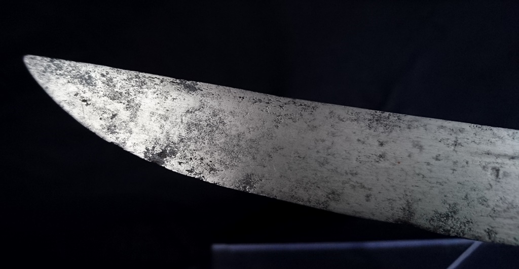

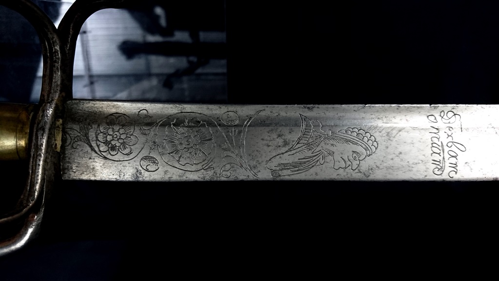

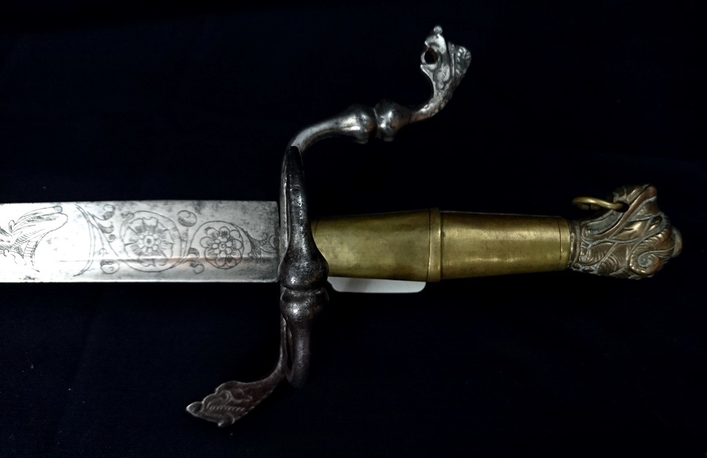

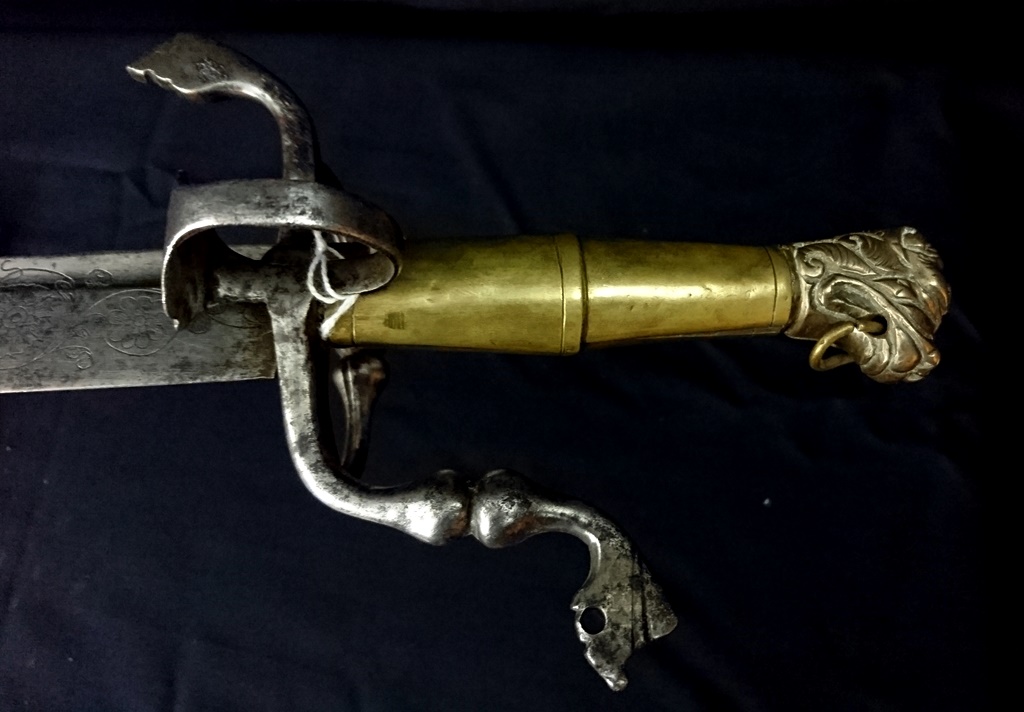

Default MORE
MORE PICS

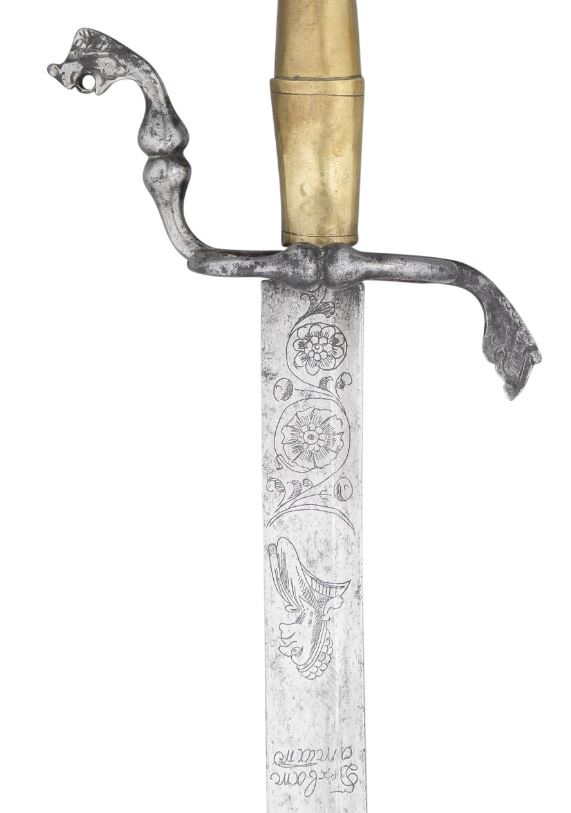

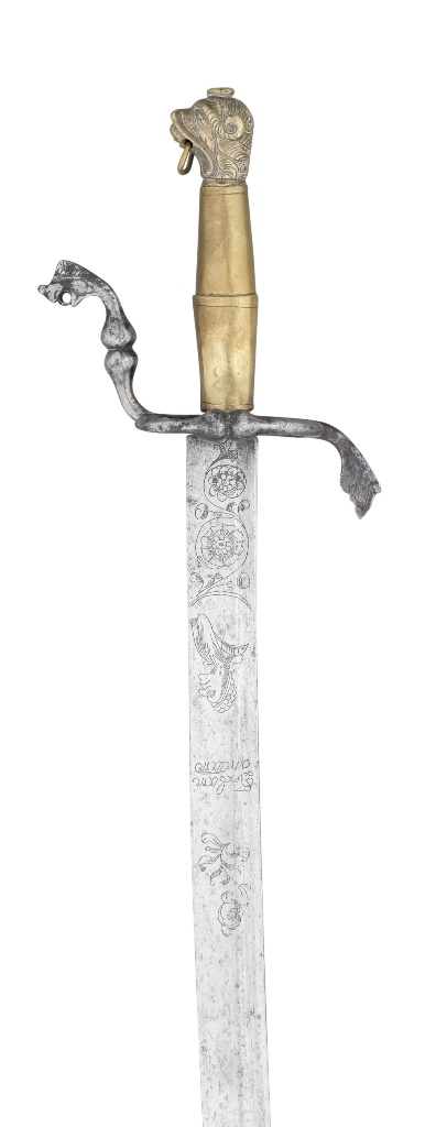

Posts: 1,065

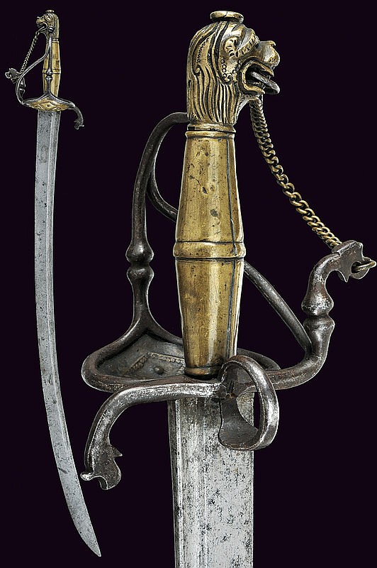

Default similar model sold by Czernys
sImilar model sold by Czernys

Hi Cerjak,
swiss one.
Jürg. A. Meier wrote and described a lot about that sabres
As example look that online collection ...
http://www.waffensammlung-beck.ch/waffe195.html
Texts are in german.
No to exclude, that bavarians and austrians were inspired by swiss style.
Unfortunately nearly all weapons of the Carl-Beck-Sursee Collection nowadays are in depot!
kind regards
enibas

Hello ENIBAS
Thank you very much for this interesting link.
I'm sure that you have oriented my research me in the right direction
Best
CERJAK

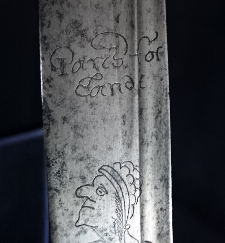

Old 10th January 2016, 05:59 PM   #6
Posts: 10,857
I just wanted to point out that this style of engraving and with these almost caricature head figure correspond to the French style of the mid 18th century known as Caissagnard situated in Nantes but seems to have extended into Parisian artisans as well.
The thumb ring seems to correspond to Austrian and German hilts.

Thank you for your input about the caricature head.
Best
Jean-Luc

Default Swiss Horseman's Saber
Hi this looks allot like a Swiss horseman's saber with the exception of the quilon and chain which could be more decorative for an officer or hunting model. The brass grip is a bit different than the wood turned examples I have encountered in Eastern Europe. I would suggest this is more of a dress saber due to it's ascetic alterations or an officers model. In field use other than dress or hunt the brass grip and chain would not be suitable in my opinion but it could also be a period custom variation/alteration for an officer. Wonderful find :-)
